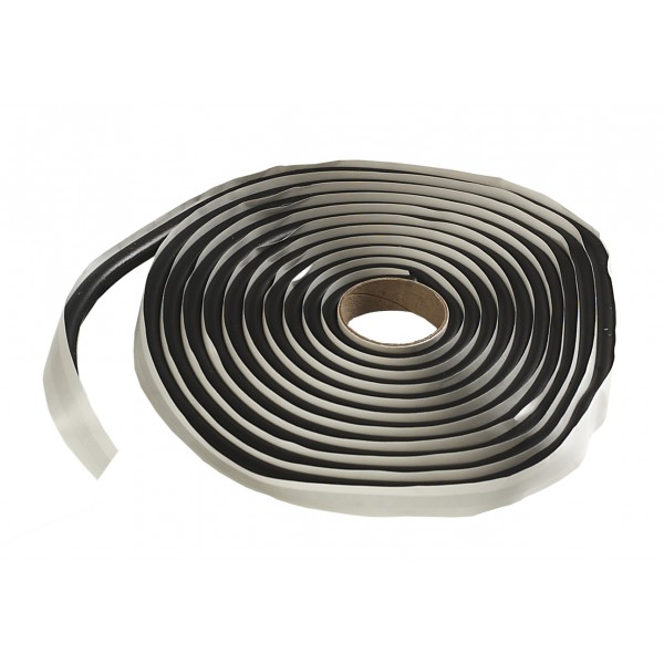

Butyl rope I got trough ebay, usually sold to seal all kinds of things on cars. I used it between my dual aluminium baffle around the drivers to create a sort of CLD effect.
Ooooo 'Butyl rope', that's a new one on me......might have to look into that!

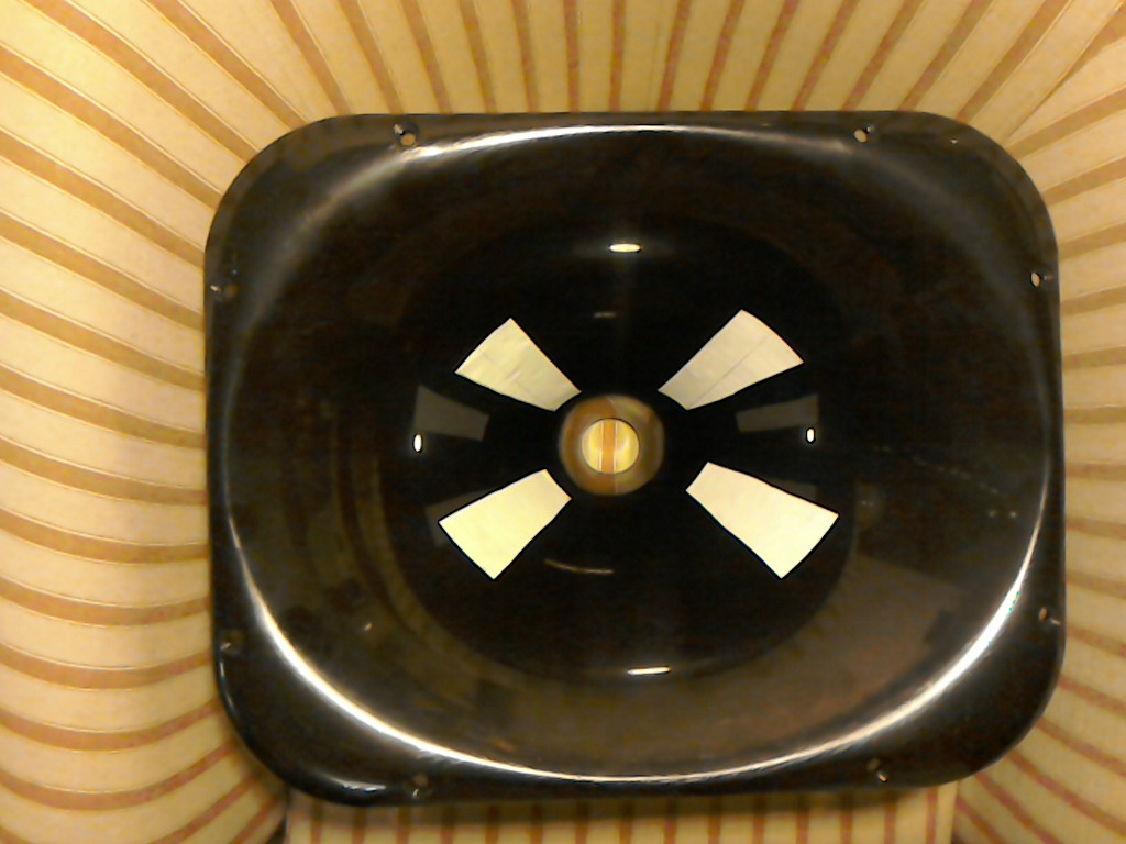

So. To keep me amused tonight I will do some sample port cut outs for your approval!
So I am going to cut some white paper ports.

30cm2 seems like a nice compromise looking at your sims to minimize diffraction and prevent port chuffing - so 3x10cm if cut in slots....
Photos to follow!
Photos to follow!
My sims with 6.5cm dia holes is same as 32 cm2 so yes 30cm2 is perfect. 10x3cm slots sounds like a good plan. Straight slots or arc'd?

Hmmm. So this is with 2x10x4cm slots. For a 30cm2 per port. Seems like a lot of horn lost. The start of the slot begins 10 cm axially from the throat.
Those look like they are in too deep. The middle of the slot should be 10cm from the exit plane meaning the end of it is 5cm from exit plane. I would not make them pie shape. I think just a straight parallel wall with rounds on end looks and works best. Hotdog or wiener shape.
How are you going to be mounting the SB23's on the board to get the cone to cover to two slots? You have to look at coverage of the 8in cone and how it overlays with horn wall to come up with the positioning.
Yep already cut a piece of paper diameter of driver to check!
