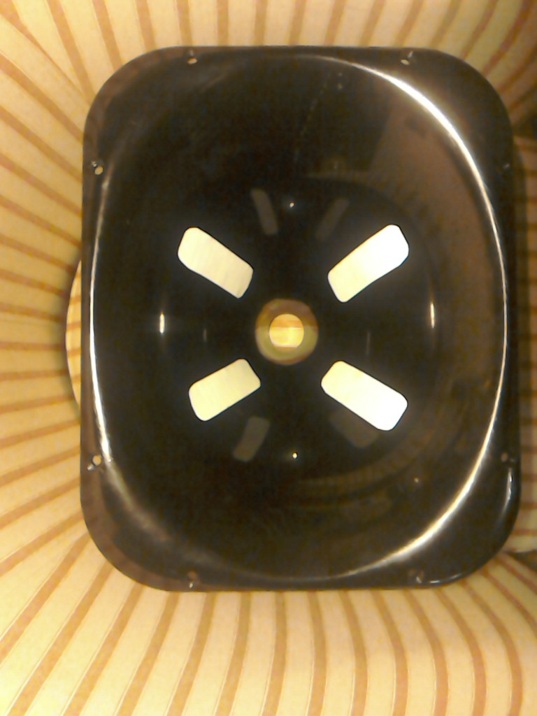

I like the slots better. I bet it doesn't ruin the waveguide performance as much as you think it might - it's all about staying away from the throat and once the slots are on the outer half, much less influence.
Having horn walls with ports keeps front profile of speaker much smaller in addition to it being a point source.
I agree Xrk. I have just looked through some of the other synergy builds and danley models - large holes cut in multiple places.
Because this horn is quite narrow - 60x40, those pictures look much worse than they are - the throat and first 1/2 of the horn is untouched.

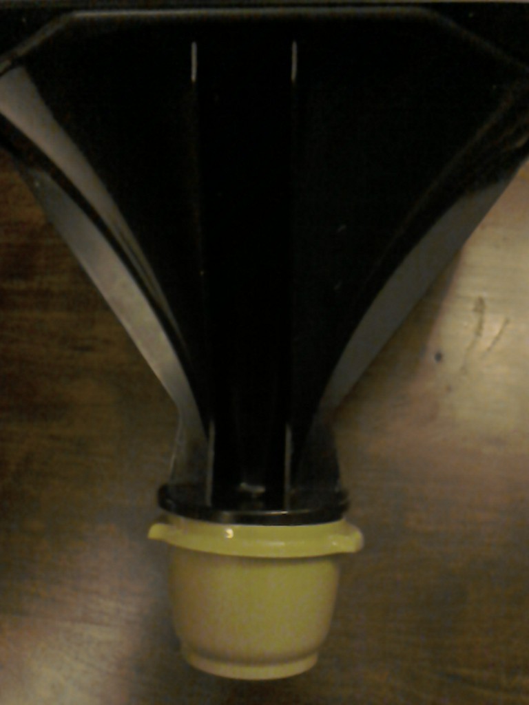

OK, for sb65 rear chamber found some old Tupperware bowls. About 3mm thick, seem innately well damped as plastic not rigid, volume of 0.8l for a sealed qtc of 0.8ish, which given our crossover at 500hz is fairly irrelevant anyway.
Nice internal hemisphere with enough room to stuff well. I think with silentcoat, felt and fibreglass these will make nice chambers.
Also perfect size to bolt onto horn with a compressible gasket for driver/stuffing modification.

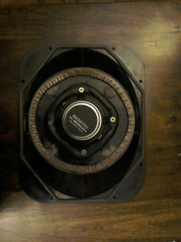

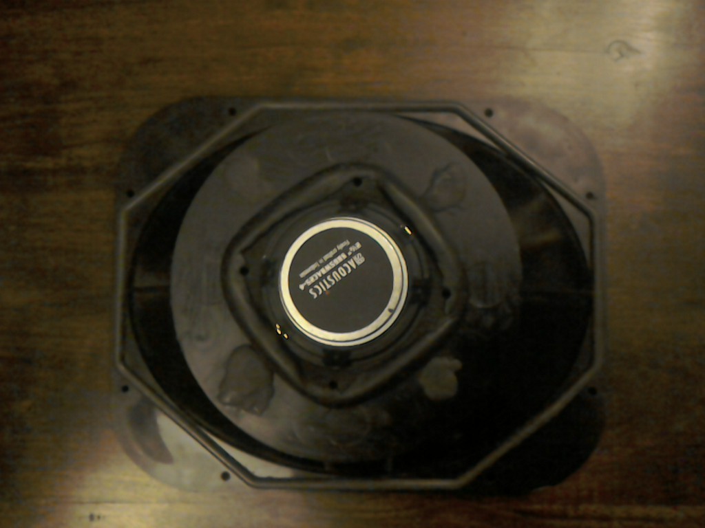

View attachment 524906 Sb65 mounted.
Nice! What is that gold colored crinkle edge that looks like a pie pan edge? That is the sorbothane sheet with some gold foil on top of it?
Looks solid though the work you did building up driver bezel with epoxy putty.
That WG must be adding reflections because what should be a solid black dust cap on SB65 looks like there is a central silver disc then black then the aluminum cone.

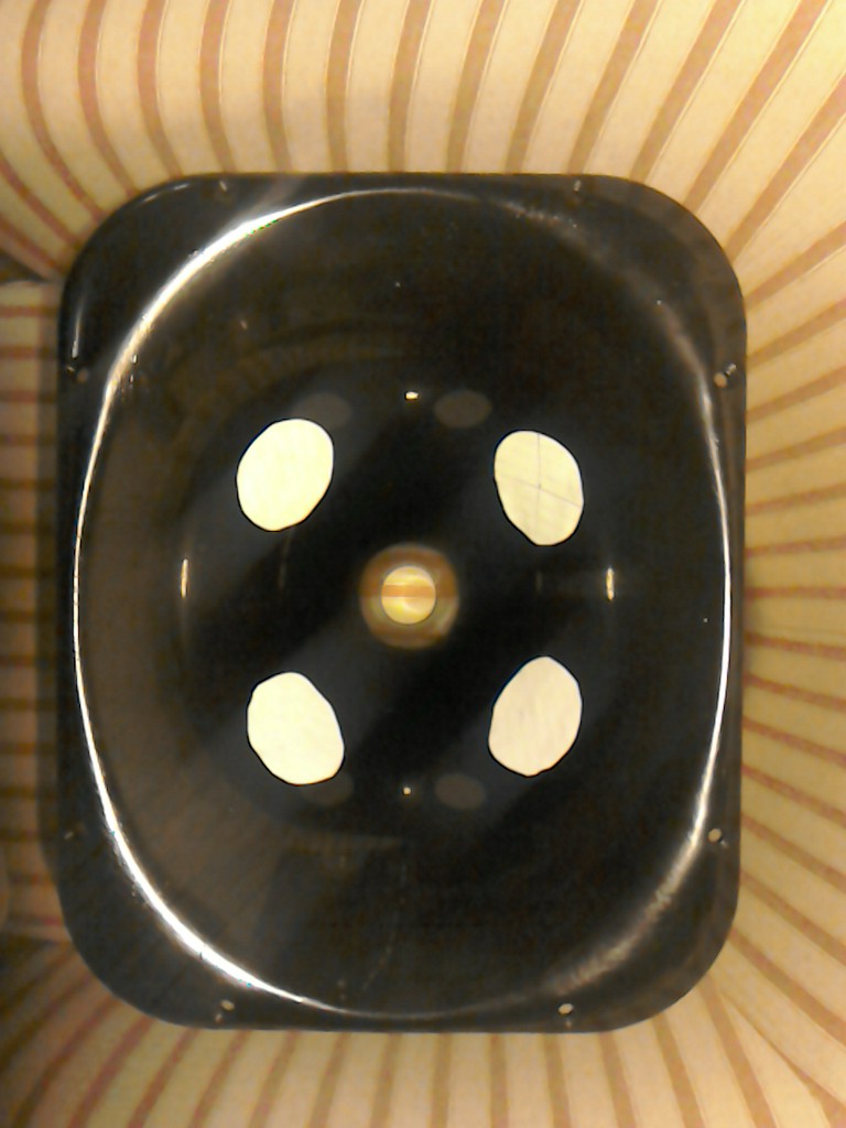

I have been looking again at the mounting of the woofers - I have just gone out and bought 2kg of epoxy filler, and my plan is to use the filler to build up the horn to make a flat mounting area, that the mounting board will then be stuck to.
I have also looked at the taps again, and whilst we both think the slots look better, I think the round holes may be better from a diffraction point of view, as they can be tapped in much further from the throat than the start of the slot will be.
I am thinking 60mm diameter circular taps, placed as far out as possible given the woofers cone area, will probably be the best compromise of factors...
But for home hi-fi use.......

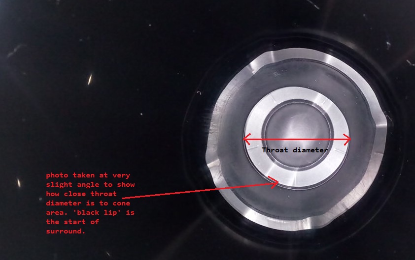

The gold edging is simple driver gasket foam - I am going to do this scientifically - so measurements first with normal gaskets, then with sorbothane!
The black/silver/black/silver is an optical illusion - it's a reflection of the overhead light in the shiny surface - I will try to get a better photo. (The throat is untouched at 1.4 inches)
Oh great photo with angle - I see where the alignment is now. That WG channels sound and does same for light reflections when viewed end on. Thanks for the photo - looks great and I have a feeling it looks very smooth at the radiused transition to the half roll surround. This may work very well right off the bat. Based on how smooth the lip is, the first characteristic cancellation dip may correspond to the diameter of the sealing gasket right beyond the surround diameter. Assuming that is 1.6in dia you may get a first cancellation dip at 8.5kHz. Not too bad because above main telephone band of 600Hz to 6kHz. We will see.
