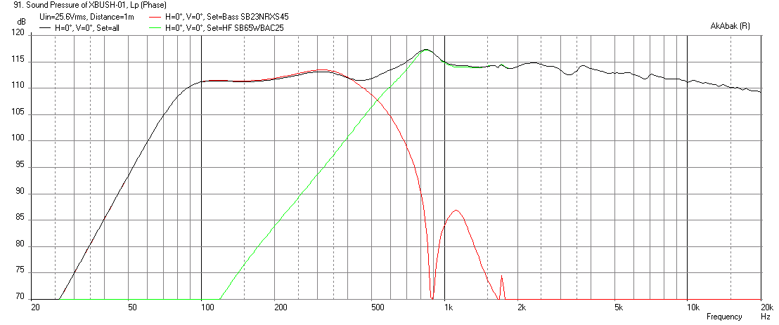

Thanks! Once I have the code written, little tweaks are easy. The main code writing this morning took a few hours but as I work from previous saved code it is much easier.
You can design a lot with Akabak - not the easiest SW to use but very powerful and fast as you have seen. Text based code has efficiency vs point and click dialogs which have ease of use but are slow to modify.
The SB65 was already cut -2dB so maybe -3dB would be about right. Less stress, less movement for lower distortion. The radial slot holes are fine however you work it out so area is about the same. But a thin thin high aspect ratio (10:1) slit is a different story as there are wall skin friction losses. If it is an elliptical waveguide, I don't know where the best places to put the holes/slots are. I think avoid directly having them on left and right walls (easy) and keep them towards the corners, if there are any in an ellipse.

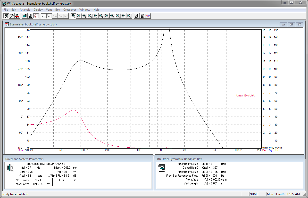

If for 8" woofer i set 8 liter back box and 0,165 liter front box with 1kHz resonance then with two 65mm diameter injection ports program says their lengths should be 54mm, if instead i change setting to two 50mm diameter injection ports program says their lengths should be 20mm, so think we have a variable that if horn material plus plywood at port entrance can be brought down to 20mm will lower entrance area of port inside horn. Is this doable or am i wrong, it was same i pointed out for 4" woofers that if length was brought down (horn material plus plywood) from 30mm to 19mm then port area diameter could shrink from 34mm to 29mm.

So if we assume we have a 12mm thick plywood driver board, and say the WG and glue is 4mm for 16mm length of inejction duct, we get 111.5dB. So yes we bought 1.5dB for free. Making the frustrum to reduce flow losses even more will only improve that.

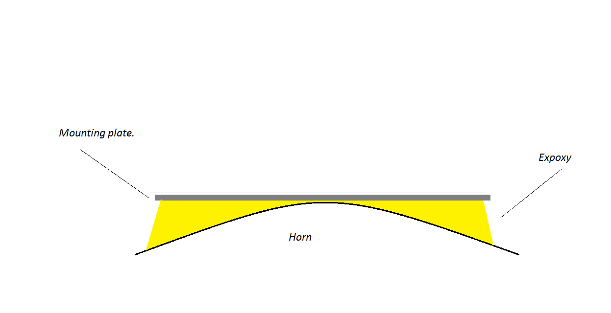

I have thought about the plywood thickness, and due to the curvature of the horn, the thickness of glue between the horn and the mounting plate will, toward the outer regions, probably be >1cm.
So if I use a dampening epoxy product, or structural adhesive, resonances will be no problem. The only point the mounting plate will be 'thin' - is the point I put the frustrum at.

Byrtt, I think your model requires a length for a flow resistance as it is assuming a conventional bandpass chamber and bandpass port. For a bandpass injection, the length of the port should be made as physically small as possible. The bandpass effect is accomplished by the flow pressure drop across an orifice, and that orifice can even be a sharp edged one like with a frustrum. This just lowers losses further for more SPL but has no effect on the band pass effect.....
Thanks explaining the thin lip and makes sense my program expect conventional concept although it can show when we enter a 1mm area.

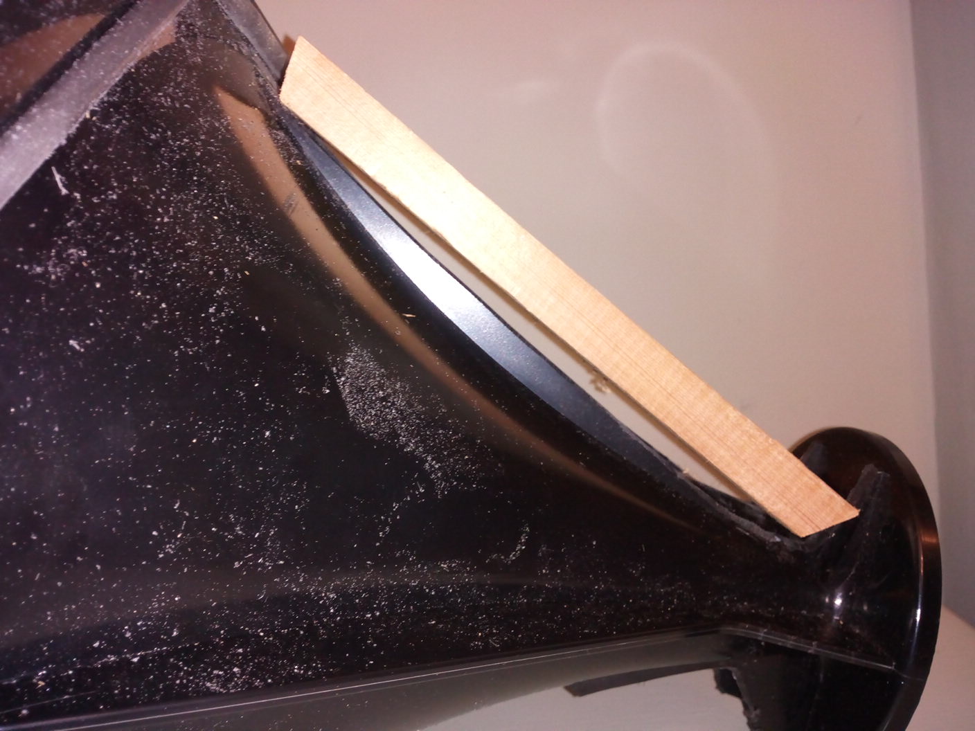

So here demos the gap between whatever surface I mount the woofer on and the horn - a fair bit of thickness there - esp with the curve and where we want to place the ports.
I have just ground the ribs right down - I reckon that gap is 1-2cm.
I am thinking a two part epoxy/putty type compound so I can grind down through the ply, and filler to make the frustrums. Really the top plate will just be to provide a flat surface for the woofer, and the strength will come from the epoxy/filler underneath.
PS - that piece of wood is 20mm thickness and the correct size to sit the woofer on.

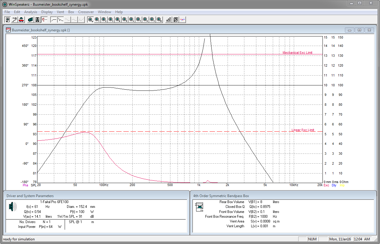

Looks like £23,21 6FE100 can do job same as SB23NRXS45-8.
Faital Pro :: Faital Pro 6FE100 6" Speaker Driver 100 W 8 Ohm ONLY 23.21
SB23NRXS45-8 needs two 37mm diameter injection ports per driver with 1mm frustum.
6FE100 needs either two 23mm diameter injection ports per driver with 1mm frustum, or with only one port a 32mm diameter.
Data used 6FE100 was 8 liter back box, 0,1 liter front box with 1000Hz resonance.

Well that could have saved me some money! I am surprised given its much smaller sd and lower xmax.

Given the much smaller port sizes, I may cancel my order and go for the faital pros. Would have less impact on the waveguide.

Smaller holes in waveguide is less problems for the HF to disrupt it. If it still hits SPL target, would it be a wiser choice?
