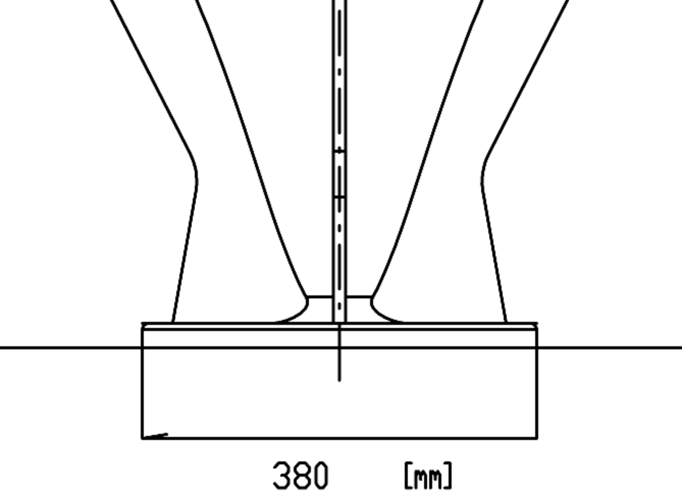

Not a measurement request but you might be able to answer this one. In the eighteen sound drawing it looks as if the waveguide narrows down from the throat entry before widening out again. Is this what you see or is this a weird drawing. I have looked at pictures and it is hard to decide.

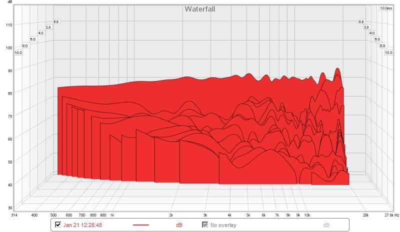

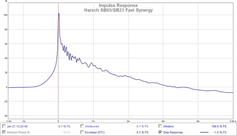

Just some view of the measurement already made. I'd like to see from that last plot, a waterfall view with settings close to this:
Just to see how that first wave front looks to about ~300 Hz. But You don't need more measurements for that. It will be fun to compare this to the final version with the extra woofer mounted.

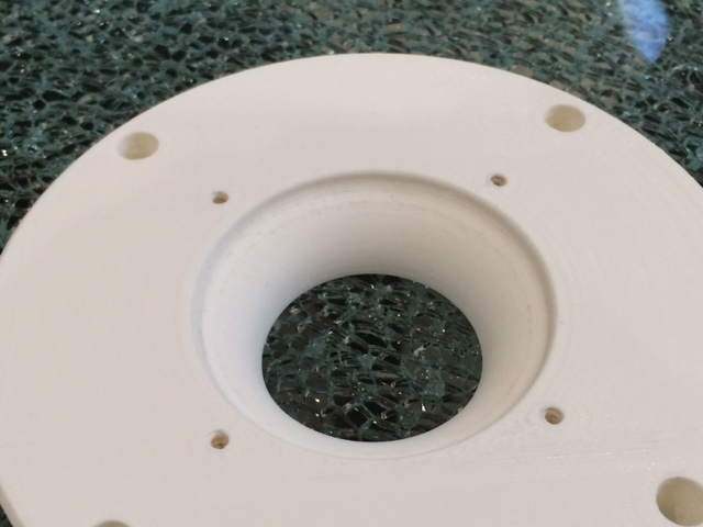

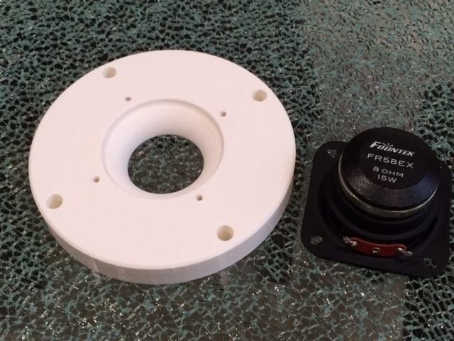

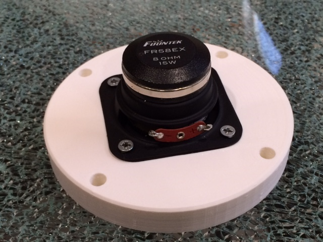

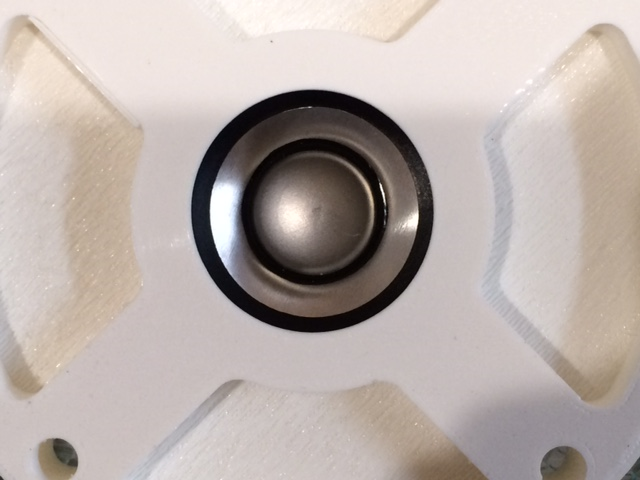

This throat adapter is 0.625in thick and has a 0.50in radius round throat. 0125in deep space provided for surround and damping foam clearance.
Overall dia is 4.72in.
526413d1453361307-bookshelf-multi-way-point-source-horn-xbush-throat-adapter-v1-render.png
3 hours and 51 minutes of printing and here is the object d'art I awoke to.
There really is a Santa Claus 🙂
526461d1453382198-bookshelf-multi-way-point-source-horn-xbush-throat-adapter-v1-photo-1.png
526463d1453382198-bookshelf-multi-way-point-source-horn-xbush-throat-adapter-v1-photo-3.png
526464d1453382198-bookshelf-multi-way-point-source-horn-xbush-throat-adapter-v1-photo-4.png
526465d1453382198-bookshelf-multi-way-point-source-horn-xbush-throat-adapter-v1-photo-5.png
I just need to find some long M6 bolts and nuts, and some thin open cell foam to stick in the chamber around the surround.
I am a little worried that I made the adapter too deep - but I wanted a nice smooth transition from 2.1in dia to 1.41in dia using a 0.50in radius roundover. We will see if it is too much of a bandpass chamber that will ruin my HF extension.
Hope this is right:
Yes this is the view I wanted to see. For your own reference you might want to limit the graph to about 30 dB down from the average value. That nice and clear ridge of sound is what I wanted to see. I'm expecting a second woofer to make a difference on the low end. The top pretty much stays as is. The bigger that instant drop gets, the clearer the sound. That's what makes line arrays good performers between 100 Hz and 5000 Hz.

Yes the throat narrows, you can also clearly see that in post #267.
Narrowing is required to get wide dispersion, the "pinched" width being approximately the wavelength of the highest frequency where dispersion equals the nominal pattern of the horn. Lateral reflections off the horn walls can increase HF dispersion, but the response is chaotic, varying in pattern with frequency depending on the phase deviations resulting from differing path length of the reflections.
Without the narrow throat, the HF dispersion is dictated largely by the native dispersion of the cone used. Of note, the cross sectional area must continue to expand through the pinched area or a band pass chamber will form, reducing HF level, and adding delayed reflected HF energy, "smearing" the HF impulse response.

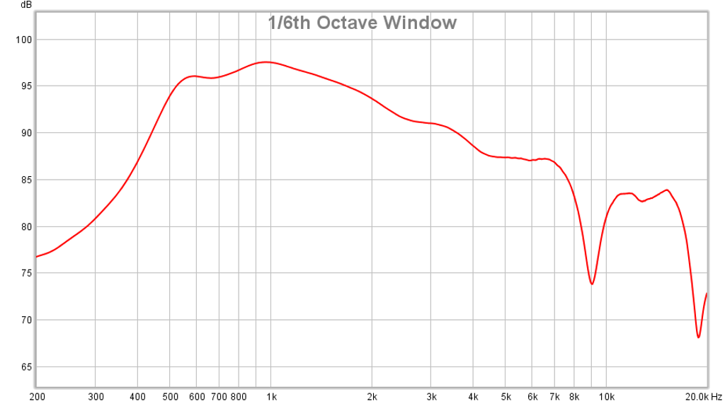

First measurement of FR58EX in LTH142

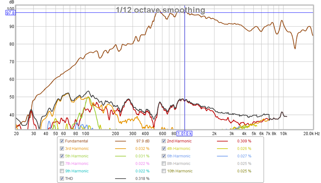

Here is a quick measurement with no damping foam in the driver chamber. Mic is 0.5m away and -6dB below 2.83v drive voltage (so it should give equivalent sensitivity at 2.83v and 1m, but distortion will be less). A heavy blanket is wrapped around the back of the driver (no rear chamber).
It looks like the smooth roundover is working and the chamber depth is not causing a bandpass dropoff. The gain of the horn appears to kick in at 500Hz and there is about a 10dB falloff towards HF. There are some peaks and dips that hopefully, with the damping foam, will smooth out.
Not a bad first try I think.

X, what does it look like with a 1/6 octave window? The distortion plot is mighty clean!
Is the transition from 3D print to horn seamless?
The part was essentially ready to use, I just had to peel off the temporary support structures underneath where the hollowed out areas are. I took some 150 grit sandpaper to the roundover for a little smoothing. Probably could have done without it. The biggest problem was an operator error. I use a base circle dia for the bolts of 4.150 in dia when it was supposed to be 4.015in dia. So the M6 bolts did not line up. I just switched to smaller #6 bolts to make it work temporarily. The throat dia matched perfectly to the WG and I used a 2mm thick sheet of EVA foam gasket between the WG and the adapter.
It was pretty good in general - and my printer behaved this time unattended print for 4hrs.
Here is 1/6th octave window (under IR Window dialog, frequency dependent window option):
526474d1453390828-bookshelf-multi-way-point-source-horn-fr58ex-lth142-no-eq-0.5m-1-6-octave-window.png
Looks like I need to work on the cancellation dip at 9kHz - corresponds to a half-wave distance of 1.5in.
It will be interesting to see if we can find a fool proof recipe to eliminate such a dip. Bushmeister's practice seems to work quite well and we don't need the
absolute SPL Art is looking for in our homes. Though in getting to the bottom of it the test data Art proposes is good to have. A foam core seal might work instead of the cereal box gasket. Do you have some of that stuff Jeshi used for enclosures?

did you seal the surfaces of the adapter?.......3d is pourous so there could be some rear wave interference through the adapter
