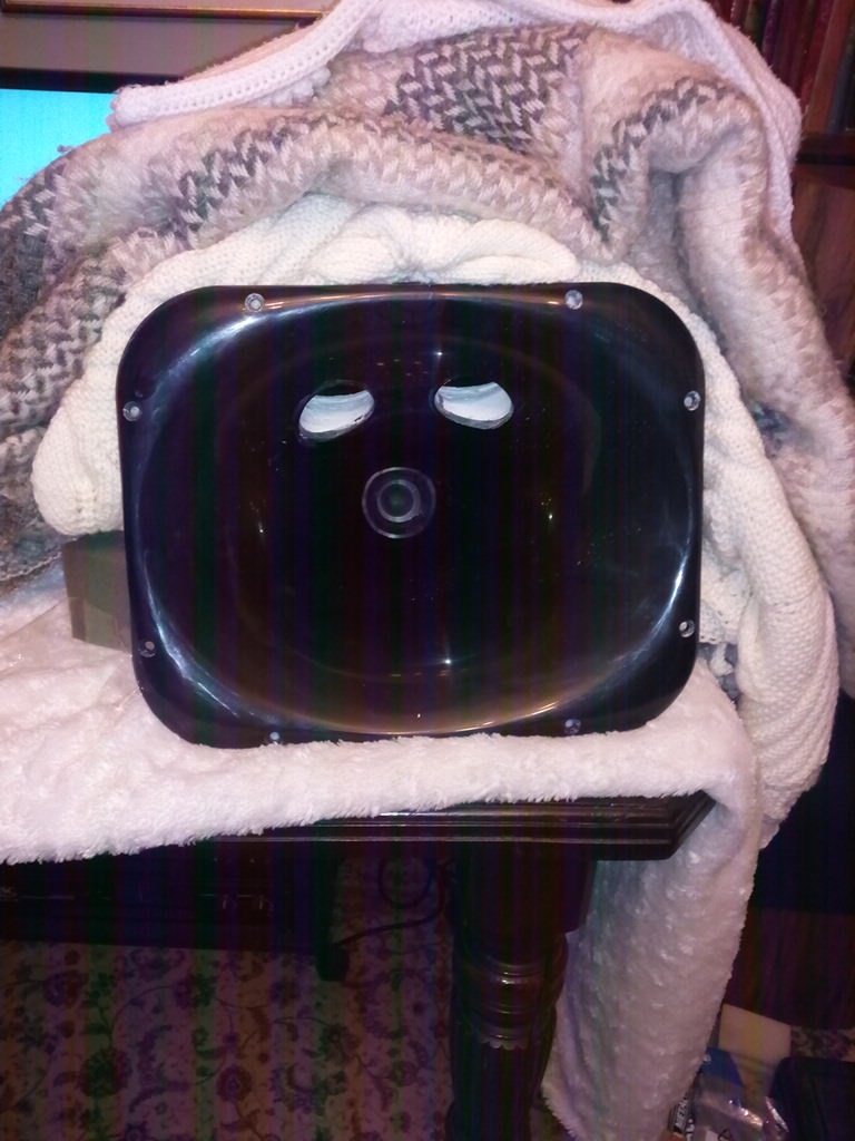

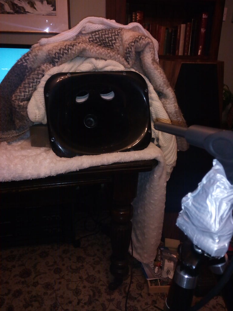

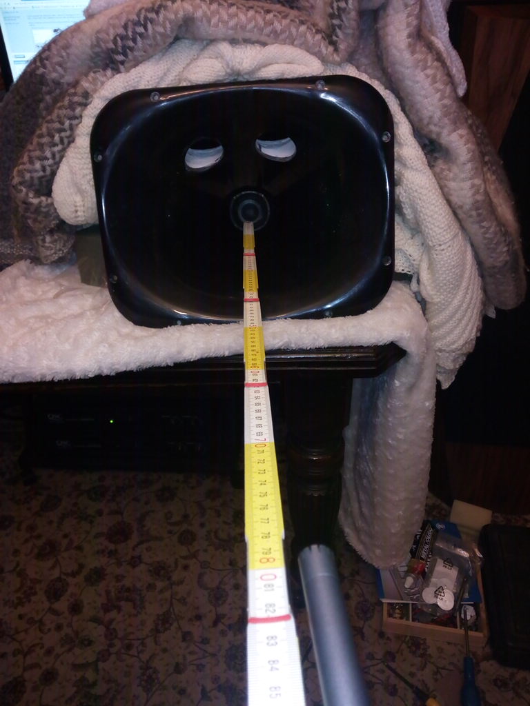

Oh balls to it, who needs sleep. Right here is PIC of measurement set up. Less than ideal I appreciate. Mic at 100cm in photo.

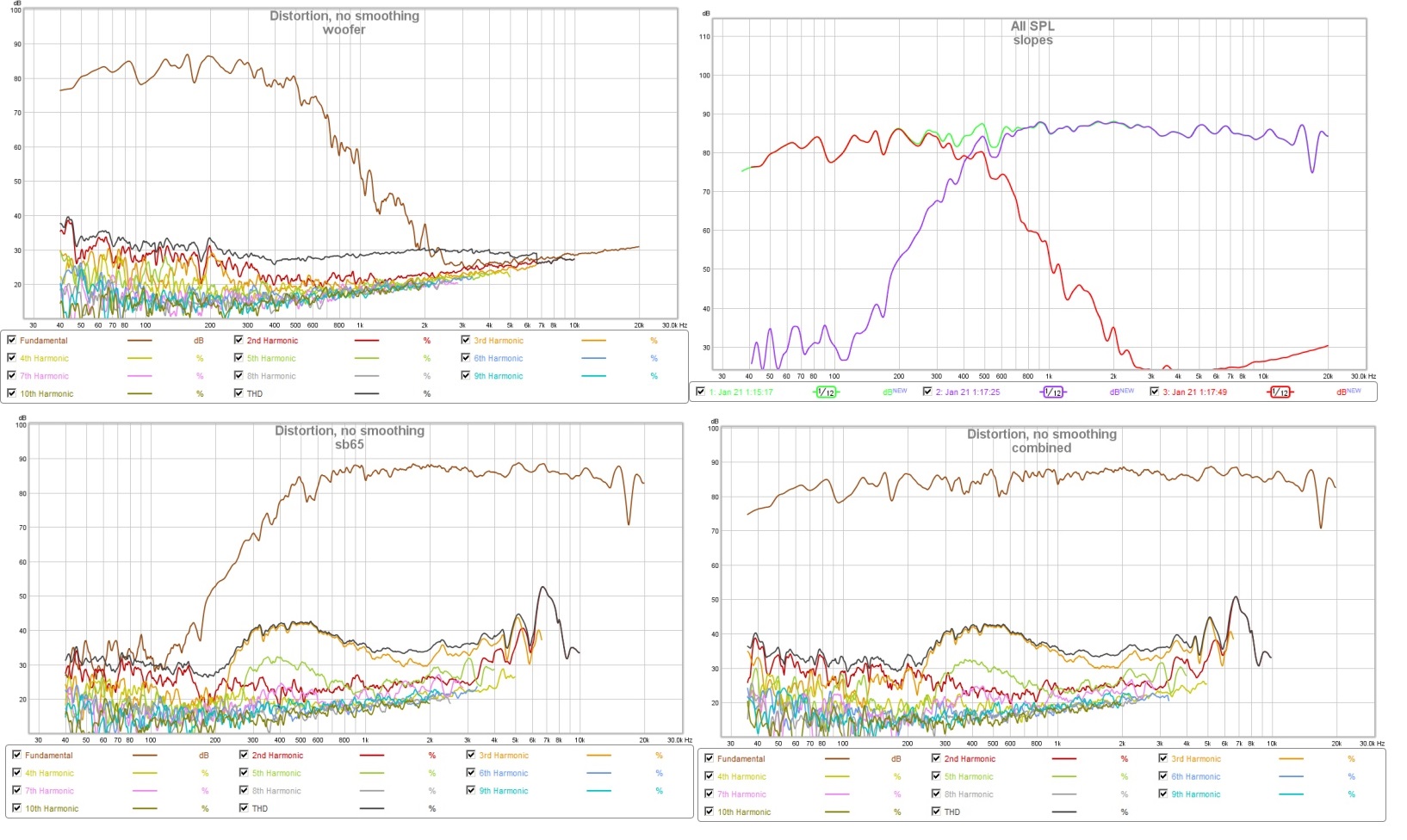

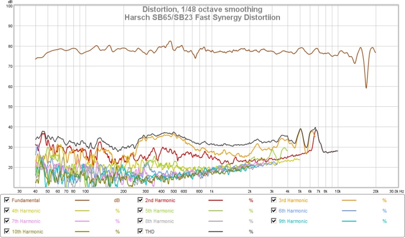

I just repeated the distortion tests - here is a montage for you. I think there is no doubting the very low distortion in the woofer - it must be a result of the band-pass taps. I have built many speakers and not seen anything as good as this.
There is nothing wrong with those measurements. Argue all you like - you can clearly see they have been taken together and the SB65 full range driver makes a nice control.

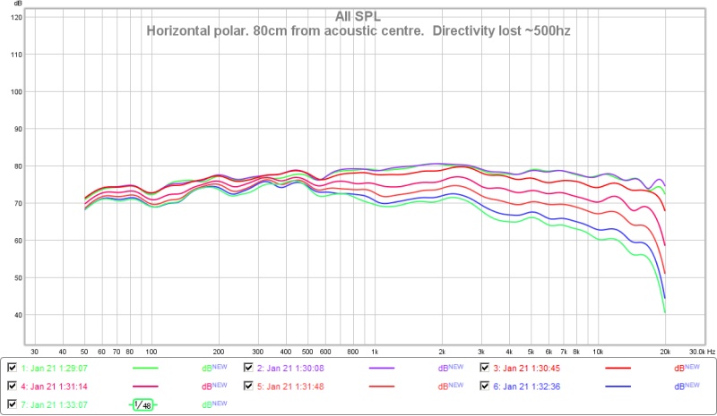

Here is a more accurate set of horizontal polars - all measured! Directivity is lost around 500hz which is correct for the horn specs. Just shows how inaccurate 'freehand' is, but I was only doing quick and dirty measurements first to look at the CD up top.

Thanks for the last set of plots. I have to say that the data is the data - especially if your mic is calibrated to absolute SPL and you have shown it is at 1m. The sims were showing a very low cone excursion at 2.83v of only 0.75mm. But that was with a sealed back. It's not unimaginable to believe that a high quality woofer operating at about 10% of linear excursion can't have -50dB HD.
Yes it is the bandpass ports and horn working together to do this. Very cool - and since you mention that you know this is special compared to most speakers - I tend to think you have it right.
Thanks for redoing polars more carefully. That looks better.

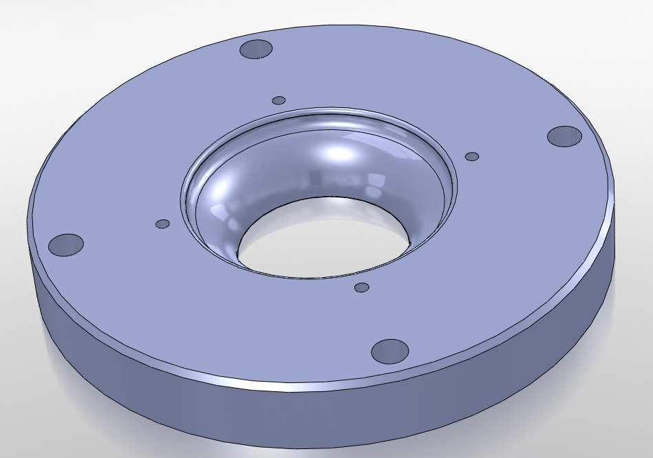

Nice X - I think you are going to be getting better results than me, giving my throat adapter was done with some epoxy putty and freehand routing!

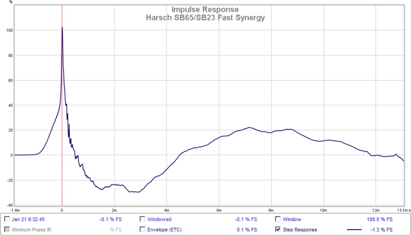

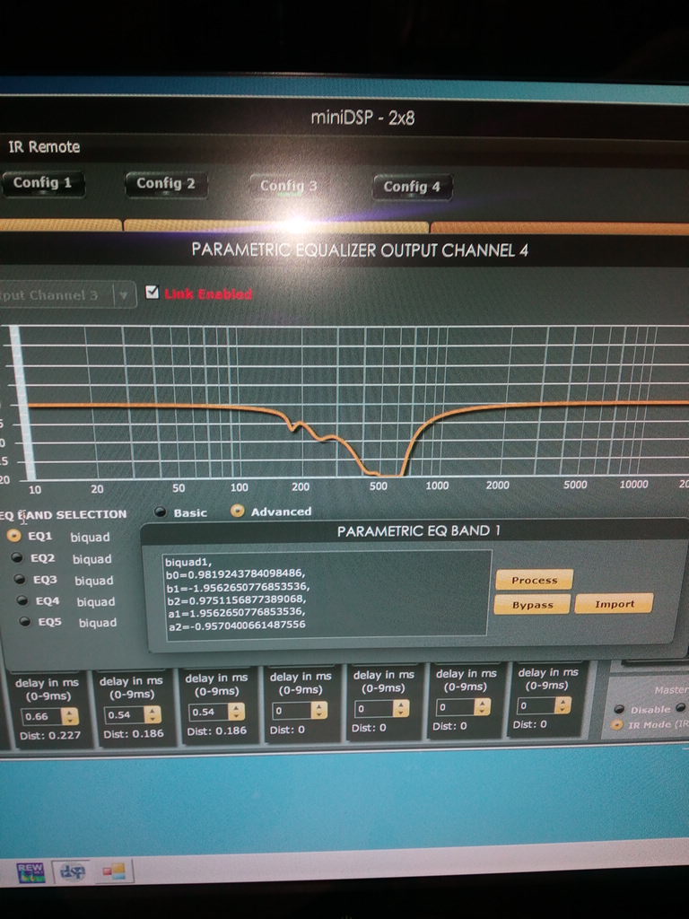

Right what shall we work on today? Shall we get the phase sorted? Given this 'Fast Synergy' has excellent point source behavior, getting the phase sorted too should give us some nice results!

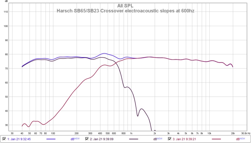

Have you read up on Harsch XO? Set the electrical lowpass on the woofer such that the electroacoustical slope is -24dB/oct Butterworth at 500Hz, I may even go 600Hz to get away from the SB65 distortion hump. Then set the electrical high pass on the SB65 such that the electroacoustical slope is -12dB/oct on the high pass. In practice I find that using BW24 LPF on woofer works well and BW6 HPF on SB65 will get you the -12dB/oct Bessel. Then adjust time delay so that tweeter is behind woofer by half a period of the XO frequency (assuming both drivers have no acoustic center offset). Given that the tweeter is already set back behind the woofer, you may need less. Both drivers positive polarity. The summation, when done right will drop about 1.5dB below the woofer only but then come up and flatten out. The phase will be flat about zero degrees with a 55deg hump at XO frequency.

X, having seen how the Faital horn mounts it seems you could get a very nice throat adapter by using a disc of acrylic to replace the steel and rout the same round over into the entrance hole as you have in your CAD diagram. If you want it very smooth then use a mapp gas torch to 'flame polish' the edge.
If you have a router and a disc of acrylic I would think this could be knocked up in a very short time.

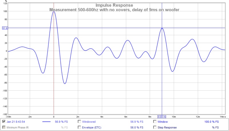

Using this techique I have discovered - purely by serendipity that the woofer taps and horn have almost perfect physical offsets for time alignment.
Here is an impulse response with 9ms delay added. You can see it is bang on 9ms.

That's how I find my sweet spot in my measurements. But, you have to be careful. The peak shown in an impulse measurement which is displayed by REW is showing a relatively high frequency peak. You've got to be sure that both of the drivers are actually capable of outputting energy there. For instance if the woofer cuts out at 4 KHz it's peak won't resemble the same frequency as the tweeter. Globally speaking you'd be alright. You might turn on a filter on the filtered IR tab, say 2 KHz 1/3 octave and go back to the IR tab, what does it look like now? Both drivers will now show the results filtered at exactly the same frequency. It won't look like a small impulse peak anymore though.
