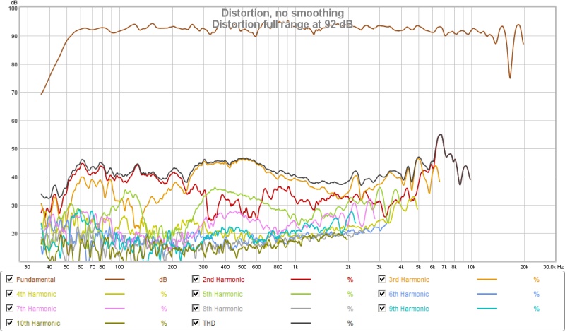

Dudes, I can't stop smiling! The HD of the single woofer is utterly amazing. Lots more measurements to come!

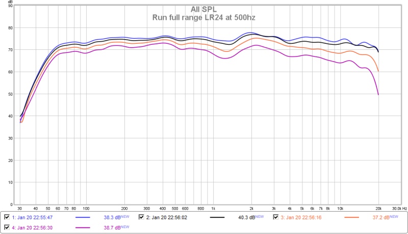

Here's a few full range!
Is this with the SB65 or is your SB23 running up to 20kHz?!

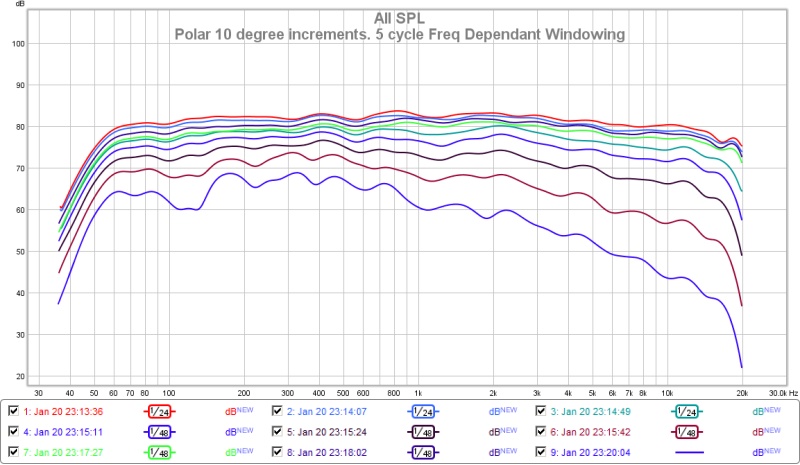

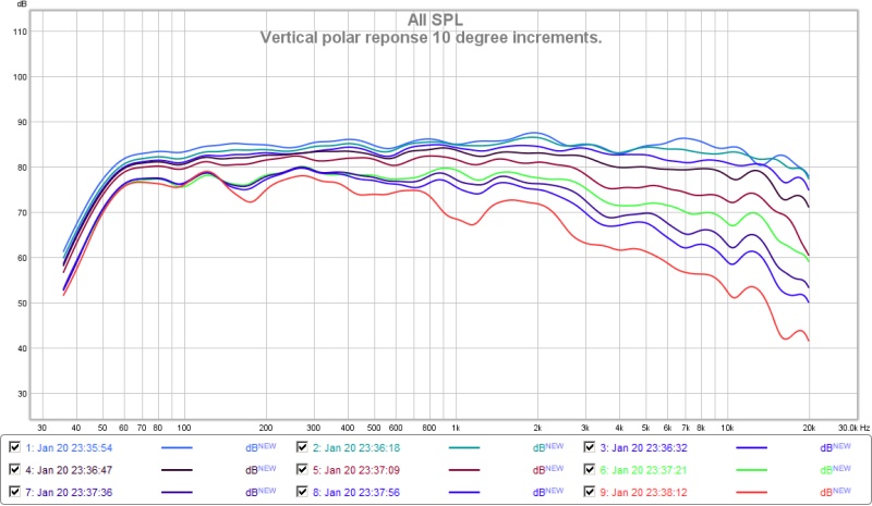

X - last measurements of the night:
These are horizontal and vertical polars measured with both the SB65 and SB23 crossed at 500hz standard LR24 crossover with EQ.
I think you will agree - the synergy approach give pretty amazing results - virtually lobe free!

I can tell you based on the graphs that listening to it will sound fantastic. With more time to tweak XO to Harsch quasi transient perfect will improve sound even further. Any speaker with well controlled directivity high sensitivity and low HD like this is guaranteed to sound good. But let's have Bushmeister answer that first hand.
My prediction that the port holes would not mess up the polars was good I think. It actually almost looks better with the holes.

Bushmeister,
Something is wrong with the way you are measuring your polars, there is no way that pattern control can extend evenly all the way down to 40 Hz with a horn the size you are using. Below around 1200 Hz the cabinet should start becoming omnidirectional, the lines should overlay within a dB or so by around 200 Hz.
Also, the low frequency dispersion should be omni in both the vertical or horizontal charts, but the vertical reads tighter.
Can you describe your measurement protocol?

No way a single 10" quasi cardoid digs flat to 40hz. Something's wrong with the measurement procedure or he's working near the event horizon. I've measured 18" woofers down 30db at Fs cardoid an OB.
There's good.......and then there's too good.

OK then I must go to bed! Those are quick measurement taken with a mic stand. I didn't measure from tip of mic to acoustic centre so there is undoubtedly inaccuracies. But this can't account for all of it cause I must only be out by a cm or two tops.
I think wesayso is right, some of this will possibly relate to the fact the woofer is just wrapped in blankets and we are seeing some cardoid behaviour. I thought it was odd too, the main points to note are the single point source behaviour, and excellent CD.

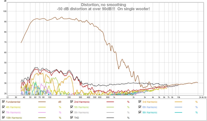

I agree that a single 8in woofer with 85dB output and -45dB HD is rather special and difficult to realize. Should be perhaps -25dB at best. So we will have to wait for more details of the measurment.
