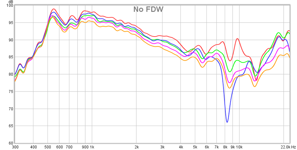

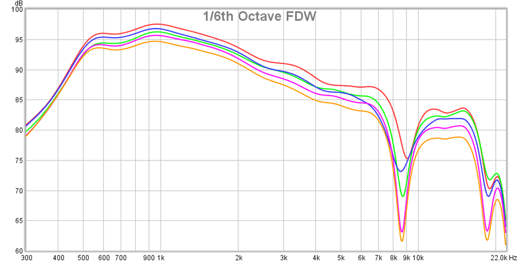

Effect of foam, felt, and polyfill in chamber
The baseline is nothing in the chamber or bare (red).
I made a small 2mm thick ring of open cell grey foam that I stuck in between the gap created by the adapter and the surround. That was the worst notch (blue).
Then I made a felt rim gasket (green) that extended about 3mm into the area where the surround is from the outer sealed perimeter, that produced the smoothest response - similar to how Bushmeister did it.
Then on top of the felt rim gasket (magenta), I added a small ball of polyfill to fill the chamber where the cone is but not beyond the throat. The smoothed out the IR but it made the notch a little deeper.
Finally, I added even more polyfill (orange) beyond the throat and about 2in out into the main waveguide. This attenuated the sound level some and seemed to smooth out the IR even more. In the frequency response space though, the felt rim gasket seems to be best.
However, if we look at all of these with 1/6th octave frequency dependent window (FDW), it would appear that the bare chamber (red) is best.

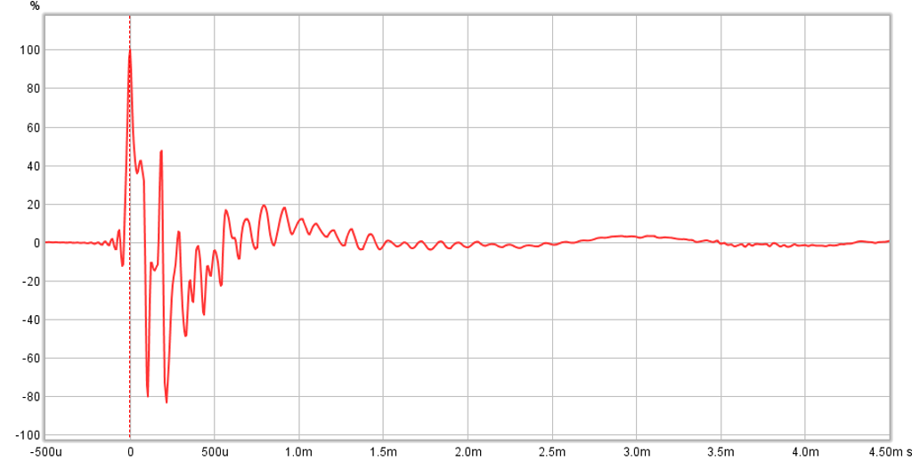

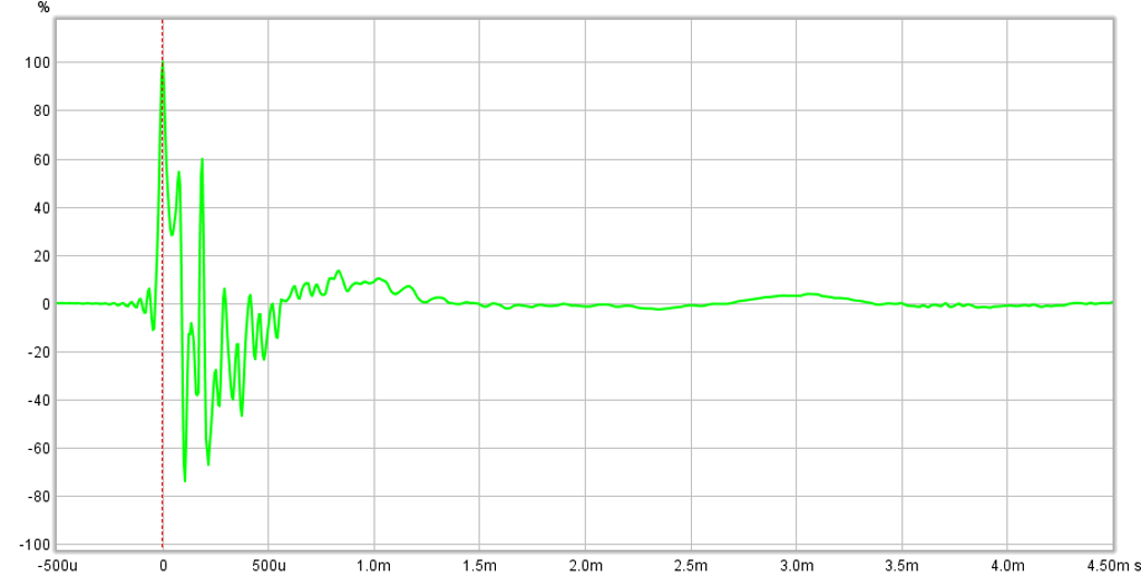

Here is the impulse response for the bare chamber:
IR for the felt rim chamber:

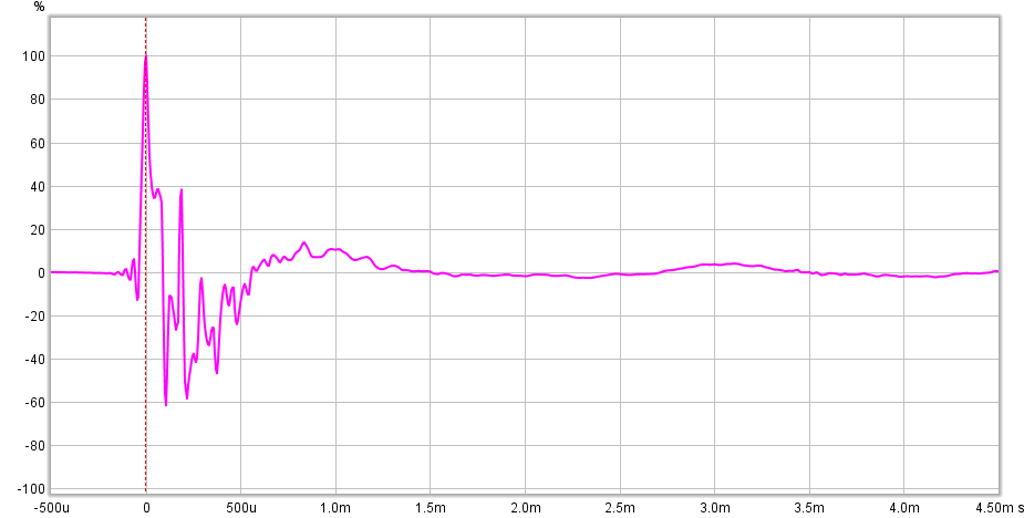

Ir for the felt rim chamber with poly ball:
I am wondering if some of this is the WG ringing itself. It is rather thin ABS plastic and when I tap on it with my knuckles it rings like a bell sound. Covering the whole horn with latex caulking or Bondo would probably not be a bad idea.
All of this ringing action, I fear, are echoes inside the front chamber. Perhaps it need to be as thin as possible?

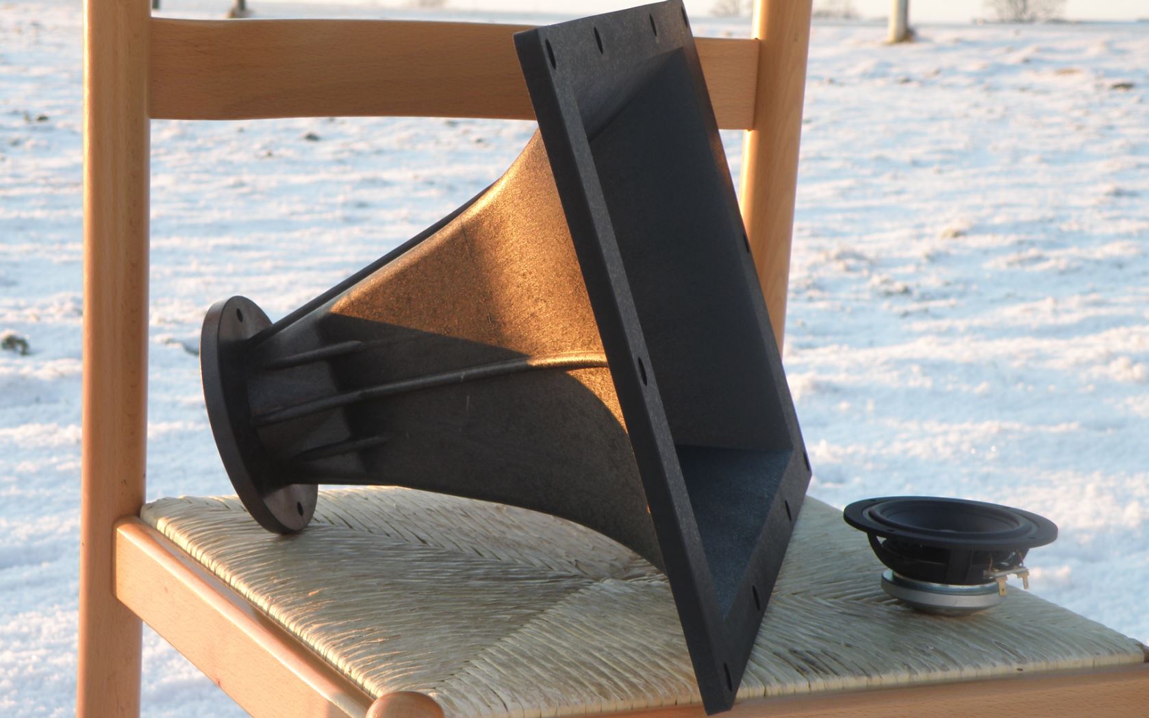

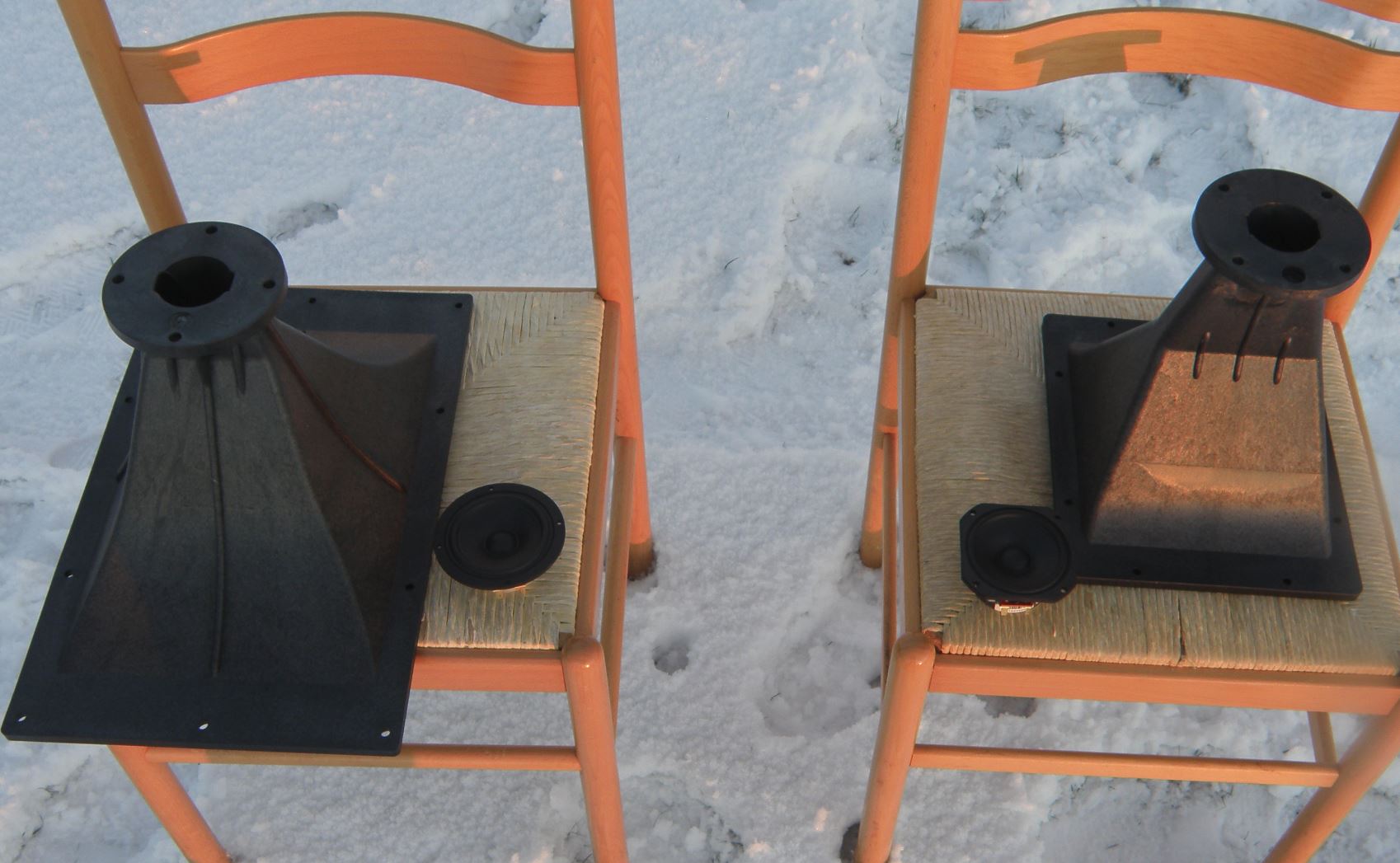

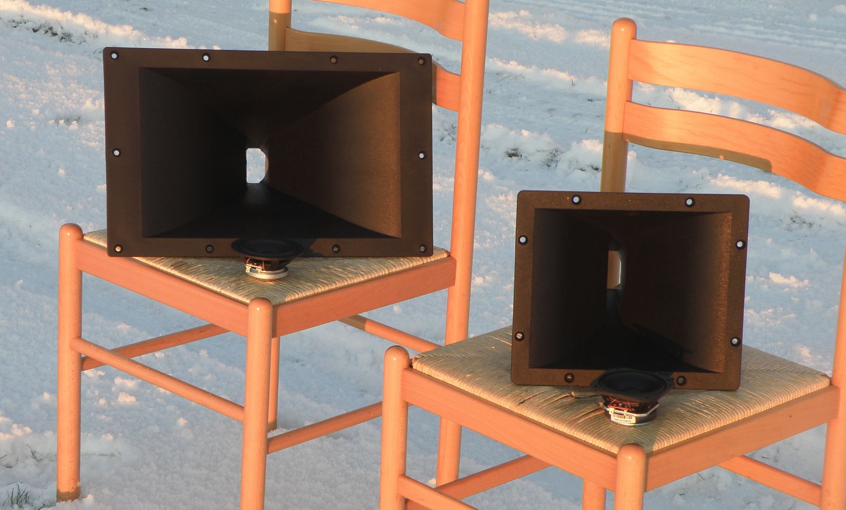

Horns arrived P. Audio PH-2723 PH-4528 one of each and if one of them works will get a partner. Have 2" entrance and hope will partner with 10F/TC9 because have them else order SB65/FR88.
Those look really nicely made Byrtt. The material appears to be thicker and denser than my LTH142. Almost like high density polyethylene with glass fiber filler.
Thanks also think they look nice for low cost GBP £25/32 and plenty of material to have cylinder bored : )
But will really need all the guidance i can get if serious mod is needed, for me they look like weltersys land and glad he contribute alot here.
SEOS guides look more anti diffraction streamlined for hifi but lets see if they bad then nothing to loose and they can get some clay or epoxy in corners.

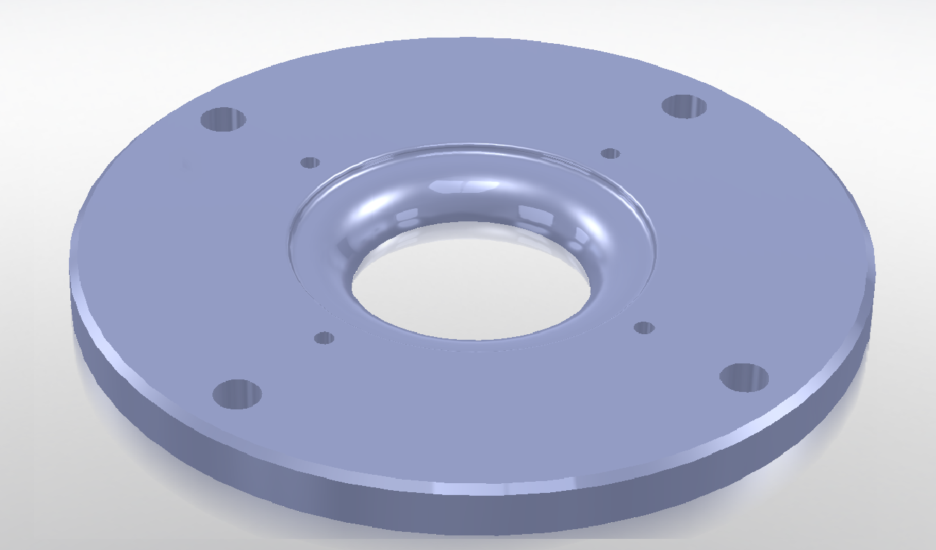

Perhaps a shallower adapter plate will work better?
Run an impedance sweep and let's see if we can't find a wiggle centered at the notch frequency. Maybe the driver needs to be loaded? Fountek doesn't mention their measurment conditions but does mention a small sealed chamber in the driver notes.

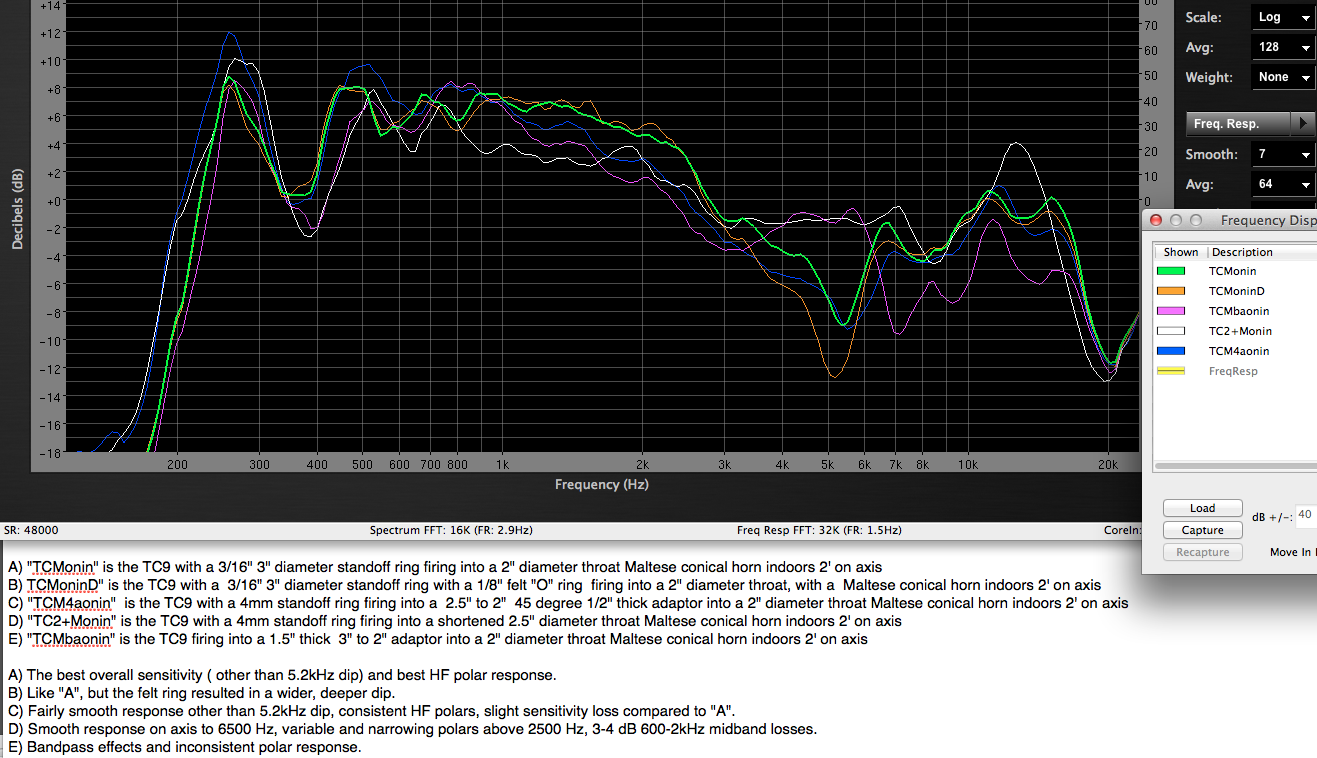

Your various attempts at smoothing the throat transitional area (which would be occupied by a phase plug in a traditional compression driver, reducing problems inherent in the "full range" beaming piston range) have resulted in a serious reduction of sensitivity, twice as much power would be required to overcome the drop, and excursion would rise by 50%.
The aspects of the throat transitional area require an iterative approach, as each change can result in different polar characteristics, simply looking at the on axis response tells only part of the story- fairly deep, high Q holes can be fixed with EQ, but if the off axis response does not track, the EQ creates worse problems. Beware of using much smoothing when making iterative decisions, looking at "trees" rather than "forests" is important when considering tradeoffs.
That is why I suggested comparing the original flange with a standoff (the cereal box gasket would provide an adequate air seal) to compare with your deeper throat transitional adapter- if my results are indicative of the various problems, your horn will then will have better sensitivity than your "red" results, and only a single deep notch that will remain largely the same off axis, so is correctable.
The chart below shows the various iterations I have tried thus far, which should be indicative of results with horns not using an undercut (pinched) throat.

1) That is exactly the same ratio of the TC9 3" cone and surround mating to a 2" throat as my project, 2.1/1.4 = 3/2. The dip frequency simply is also raised according to the throat/cone diameter difference.1)The cone and surround is about 2.1in dia and that has to go down to 1.4in dia.
2)So you are suggesting that let the cone push all that air sideways and through the throat with a sharp corner.
3)I have to imagine the rounded corner is better.
2) Yes, my tests so far have found that to have the least compromises.
One thing to consider is that very high frequencies are similar to light waves in that they reflect off surfaces like ray tracing at the angle of incidence, so an extended rounded throat adapter results in multiple reflection paths between the cone and throat. Without the deep roundover, the gap between the cone and the flange is small enough for the HF waves to diffract around, though this still results in a path length difference, and resultant cancellation.
3) I rounded the aluminum flange on one of my Maltese horn to 1/8" round, the response was almost indistinguishable from the hard edge version.

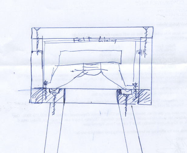

As a temporary test, you could simply use clamps to hold the compression chamber/driver on to the standoff ring between the driver and horn flanges.
Tomorrow I will be making compression chambers which will allow the TC9 drivers to be rear mounted, which will allow a single surround clearance ring around the driver. This will will minimize the percentage of the cone that must diffract into the throat, I expect the HF dip may reduce to less than 4 dB.
The sketch below shows the plan, which could also be applied to your horn. The sketch shows the chamber depth a bit short, a .25 liter chamber keeps excursion at Xmax with rated power below 250 Hz.
