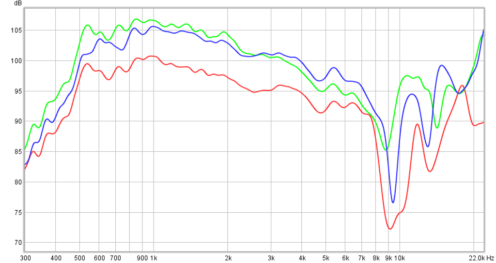

This WG and FR58EX are more sensitive actually - now clocking in at 100dB at 2.83v 1m. The shorter adapter seems to have less power falloff as frequencies go higher. From 100dB at 1kHz to 93dB at 7kHz is not too bad. However the notch at 9kHz is now worse.

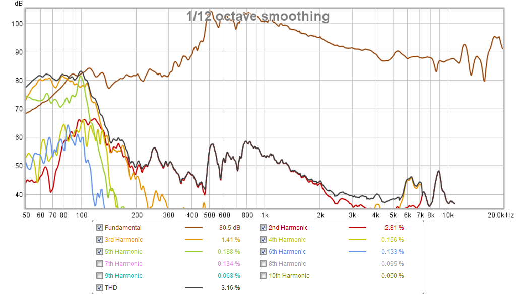

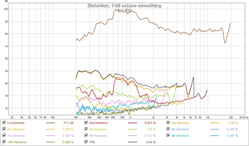

Here is data from two different drivers with and without throat adapter. Without the adapter, the notch is deepest. This reaffirms the requirement for as smooth of a transition from cone to throat as possible. Need to make it longer and more gradual - basically the throat is a pinch point but mild. The W2-852SH has an impressive 106.6dB sensitivity - but I can hear the distortion at lower frequencies due to excessive cone travel.
Data with short adapter for the FR58EX (red) and the W2-852SH (green), and W2-852SH clamped directly onto the WG flange (blue) using C-clampss (and a 1mm thick EVA foam gasket):

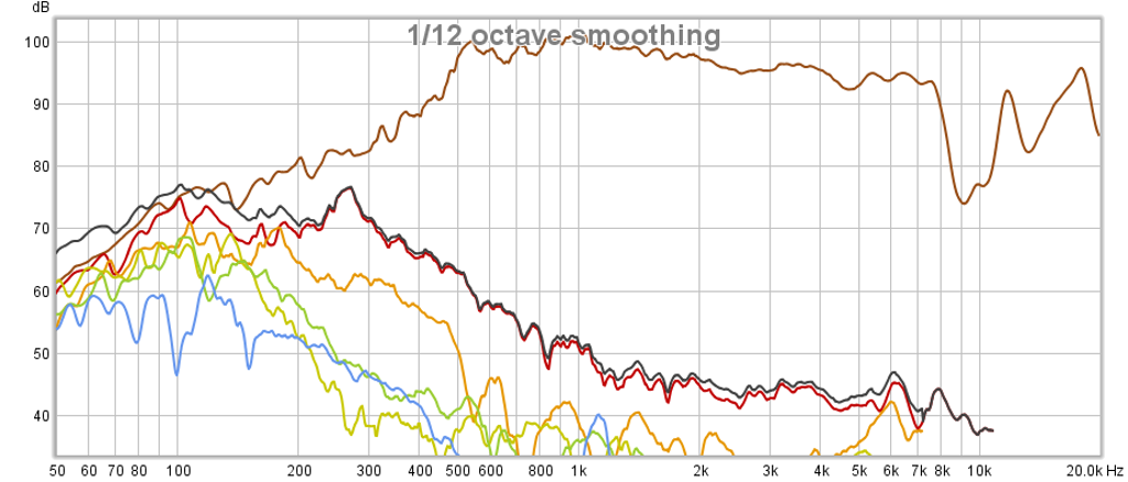

This weekend, I am going to get onto fitting a woofer onto the other horn. I am desperate to hear them in stereo...

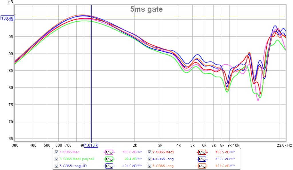

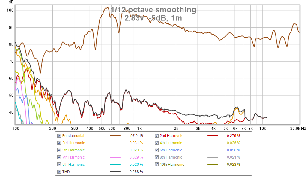

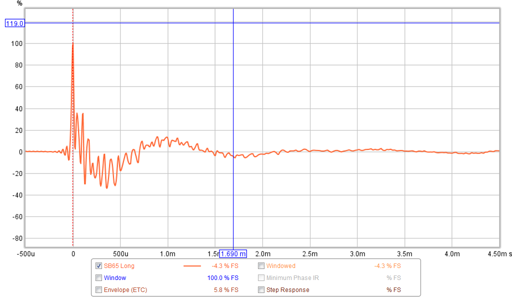

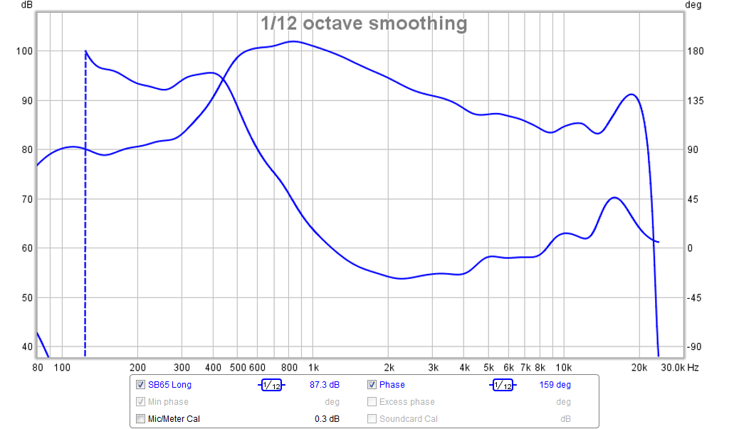

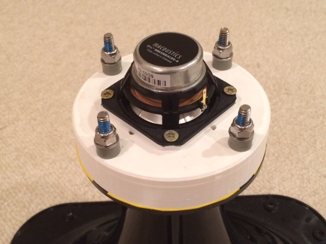

After many tests with a short (0.30in), medium (0.625in), and long (1.00in) throat adapters with the FR58EX, I could not get the 9kHz dip to go away. I should have realized it probably was a cone resonance thing going on as the impulse just looked horrid.
Finally, switched to the SB65 in the medium adapter using a simple foam core gasket to keep the surround from bumping the adapter and the results looked promising as the 9kHz dip went away. The gasket was a bit small so the surround was rubbing the gasket at lower frequencies and causing the distortion to really increase.

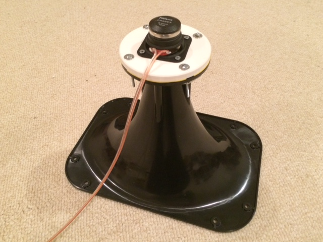

Here is a photo of the SB65 as mounted to the long adapter on the Faital Pro LTH142 wave guide:

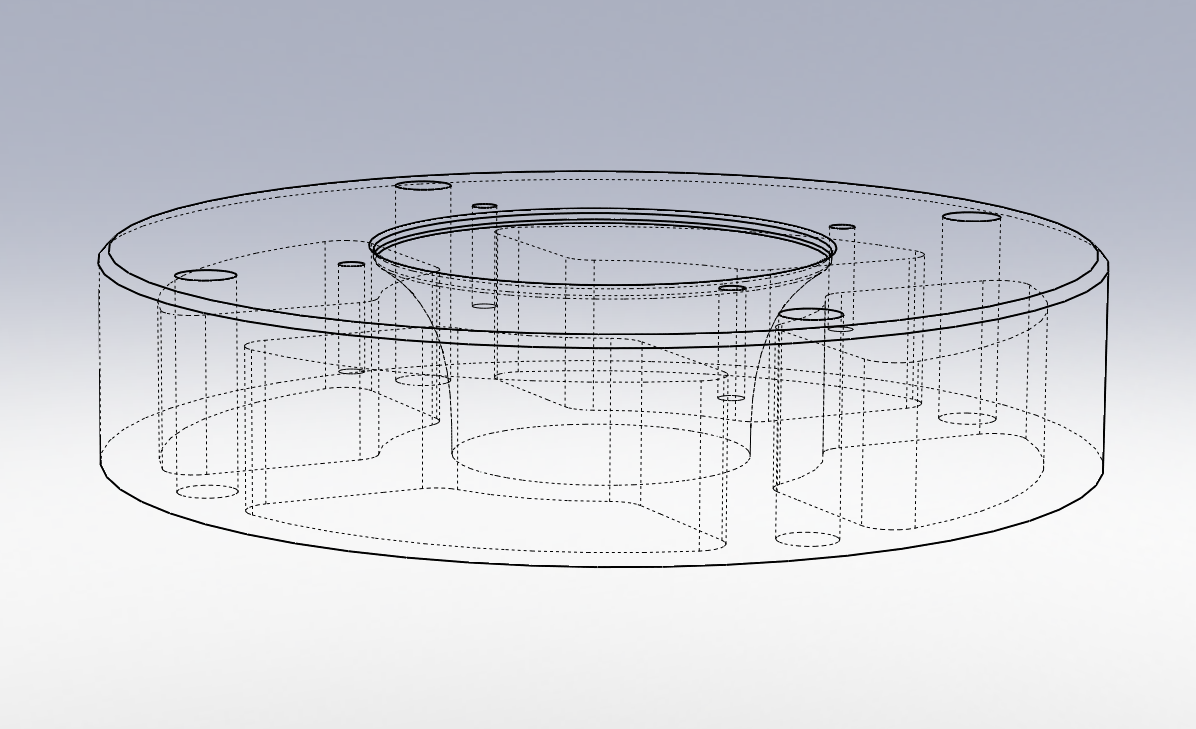

Here is a model of the long thhroat adapter so you can see the profile:
Here is a comparison of the various throat adapters, there is still a small dip near 9kHz, but it's only 5dB, and when viewed in frequency dependent gating at 1/6th octave, the dip is not there:
I then switched to the long throat for the remainder of the measurements. The long throat adapter uses a gentle spline curve rather than a radius, I also made a new gasket so the surround doesn't rub, and the test shows it has the smoothest performance and best looking phase. The phase, although not flat, is well behaved and once some PEQ is applied, I expect it to flatten out substantially:

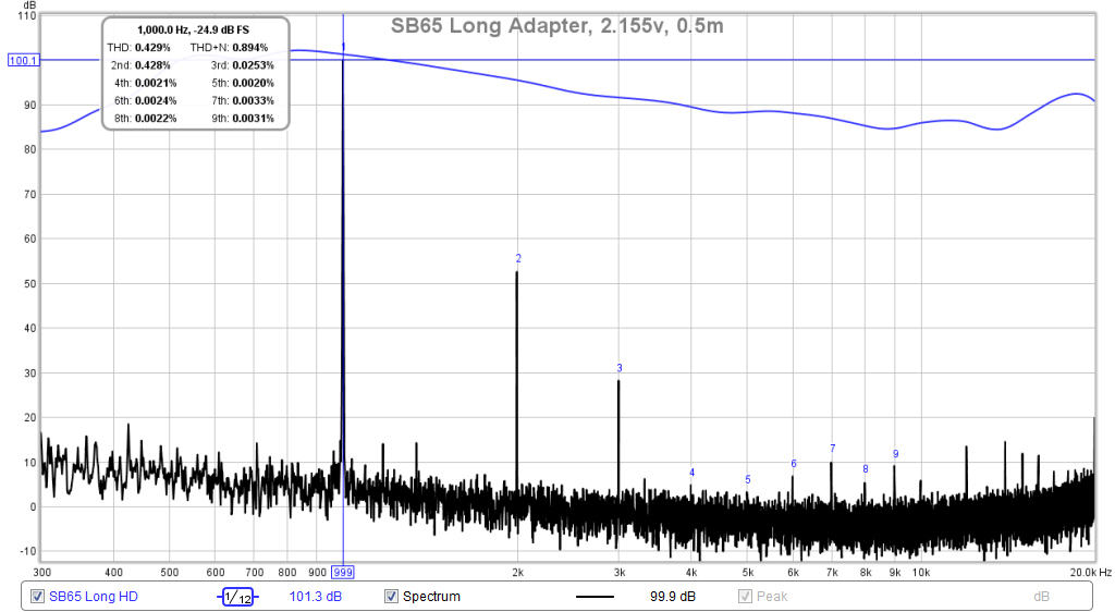

Here is the harmonic distortion of the SB65 at -6dB from 2.83v at 0.5m:
Here is the harmonic distortion measured at 1m, and -5dB down from 2.83v (the cursor was on some random spot, the THD at 1kHz at 97dB was about 0.5%):
Here is the RTA looking at a 1kHz sine wave to see the distortion components with horn playing at 100dB (be sure to wear ear plugs when testing):
Here is the impulse response of the SB65 with the long adapter:
