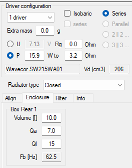

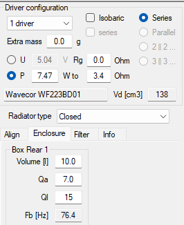

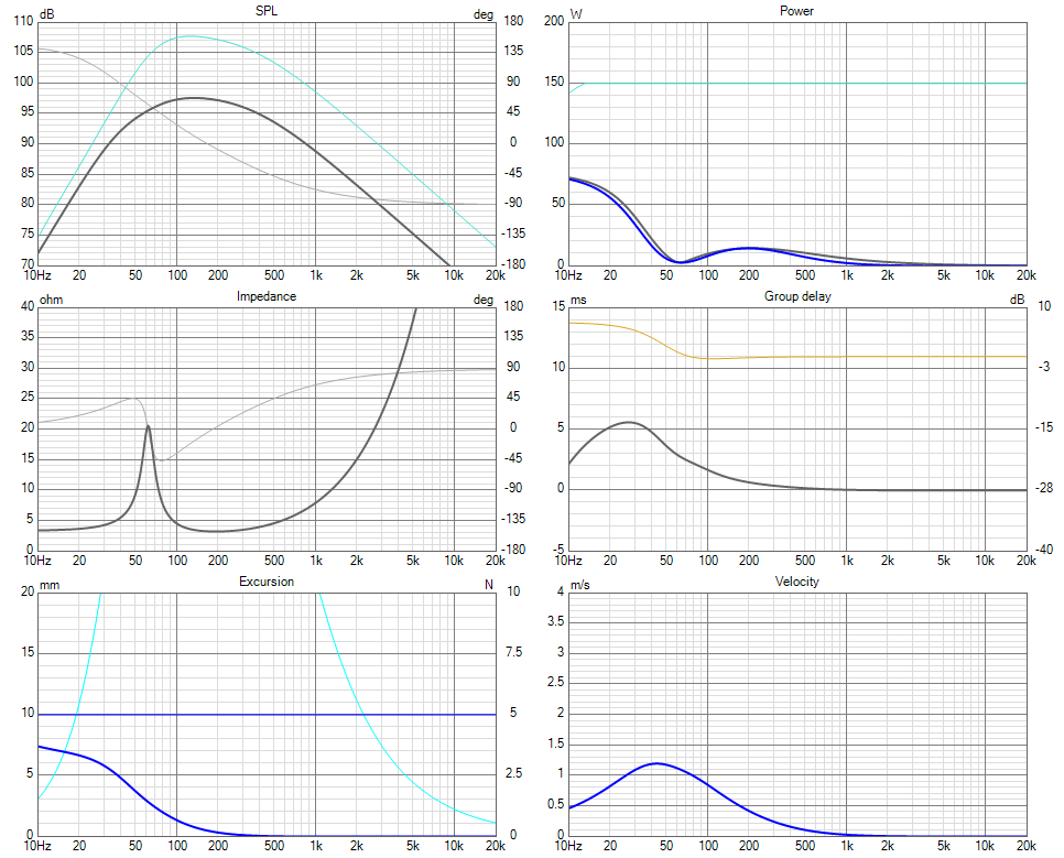

How does this wavecor driver look? (Has the same kind of xmax as the SB23MFCL and is 20mm smaller in diameter)
https://www.wavecor.com/html/sw215wa01_02.html

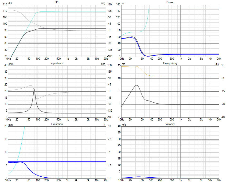

I can get these drivers at a reasonable price (2/3rd) that of the SB driver. The intended crossover to the Sica coax is somewhere above 200Hz.
I did a simulation including the effect of inductance & some linkwitz transform in a 10L enclosure and this is how it looks. Is it any good for this application?
Reactions: 1 user

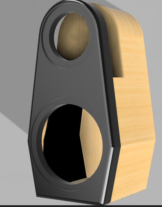

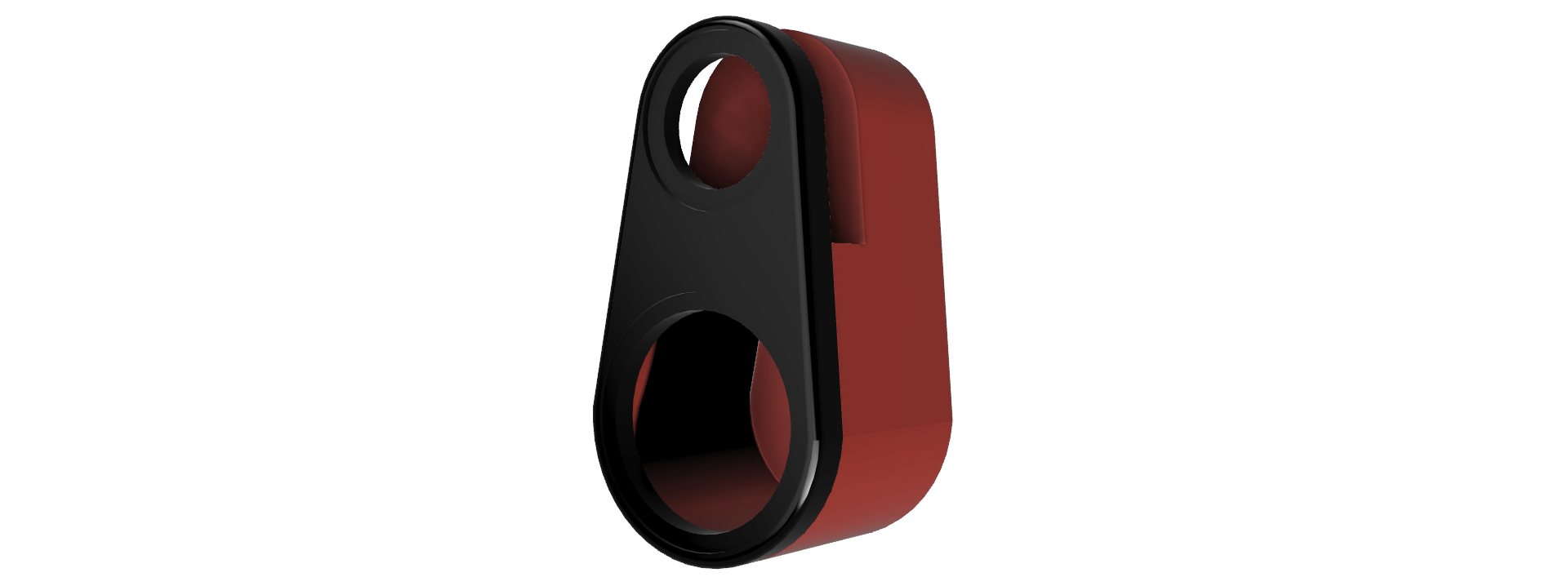

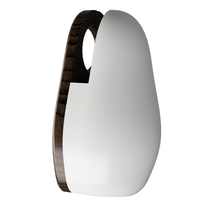

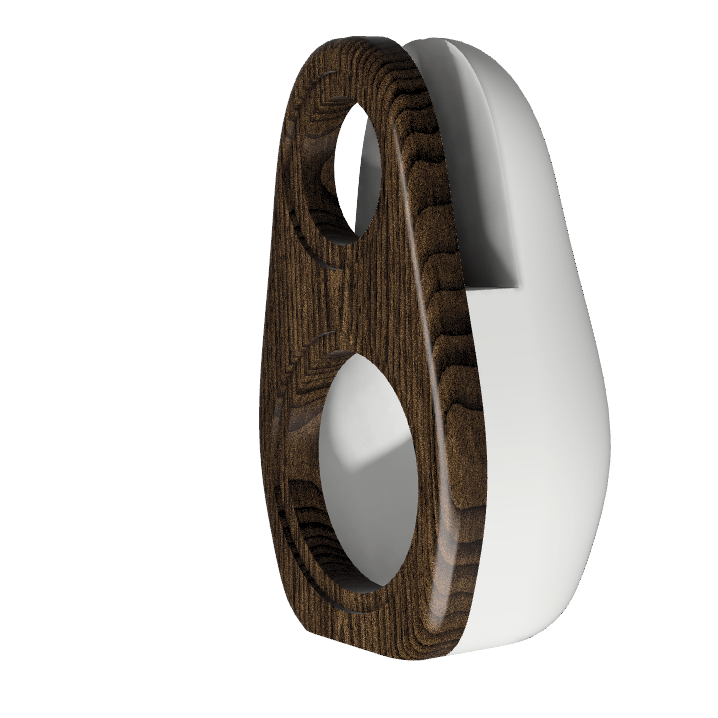

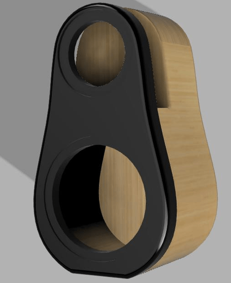

I am slowly opening up to the possibility of an 8inch and make a box like below (from Mabat's original sketches):
Unfortunately, these days, the only Dayton drivers I have access to are RS180, RS150 and RSS265HO. The RSS265HO being unjustifiably costly here.
Most drivers are either out of stock here or not available at all. And because of the import duties, driver cost doubles if I buy it from abroad.
Some of the wavecor drivers & selected SB and Hivi drivers are the ones that are available here.
If the wavecor SW215 works, I can easily get them at a reasonable cost...
Reactions: 1 user
You can leave edge of the woofer rounded and make rest rectangular for better stability...
Old Revel Performa was very successful similar design...
Amazing directivity you get with this simple slot...I wonder what will main difference in sound be like in comparison with closed box of the same shape...
  • Thank You
Reactions: 1 user

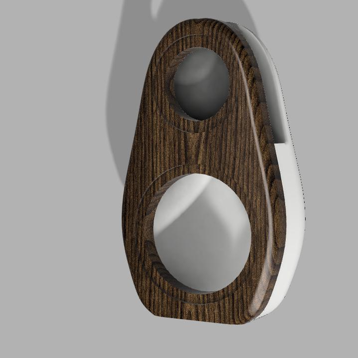

@vineethkumar01 what material are you planning on building these with? Take that into consideration, if it's wood then your cost goes up to make those curvatures. Baffle isn't the problem, the top and the side curvatures will escalate costs. something to think about, if on a budget.
I think I like this one the best so far... :D
