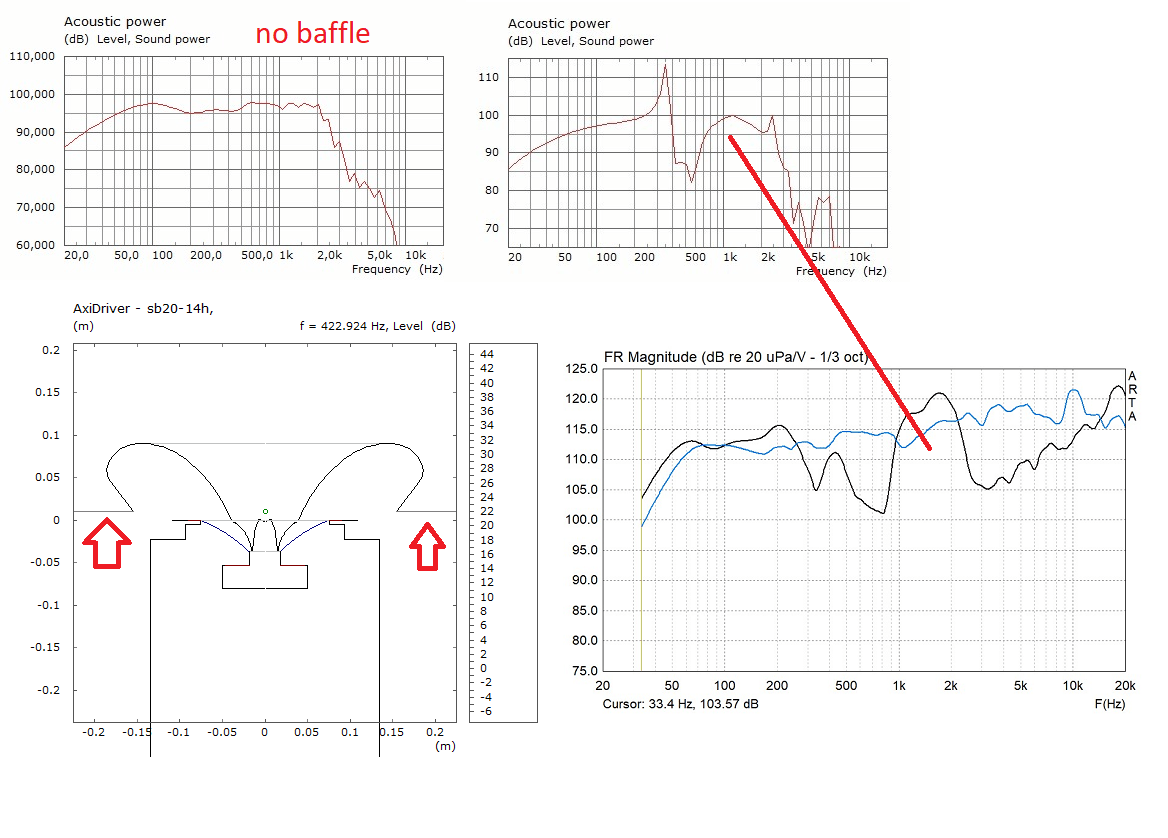

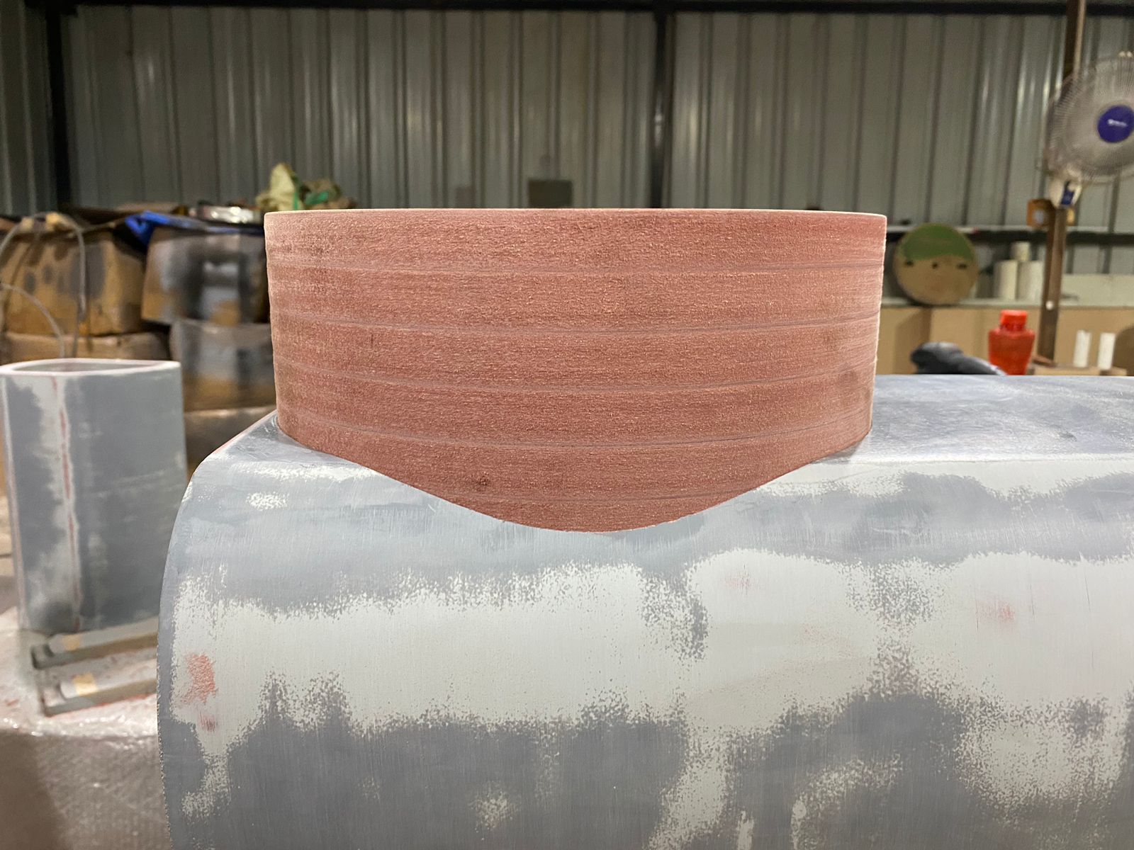

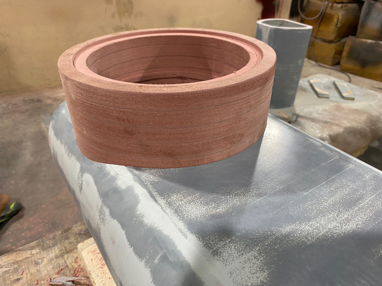

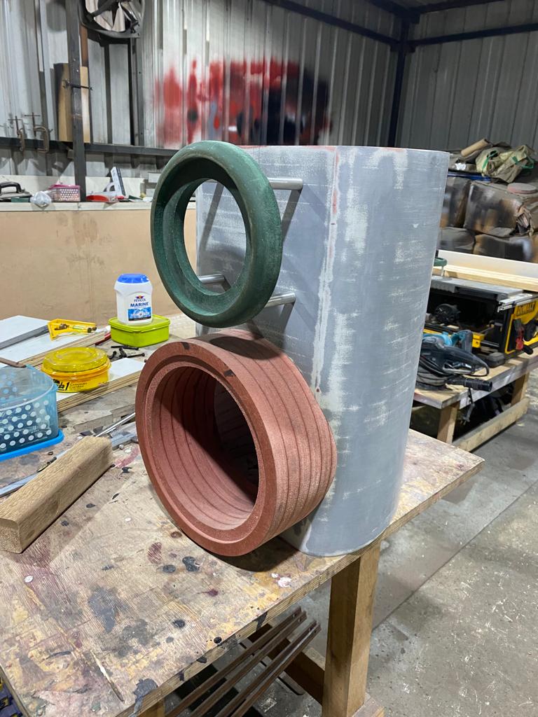

Protruding waveguide is an extra bad solution.
Just a reminder from today's excersise: baffle arround horn is not a good thing so horn/waveguide should not protrude from a baffle.
@VoxCelestial Thanks a lot for pointing out this potential issue. 🙂

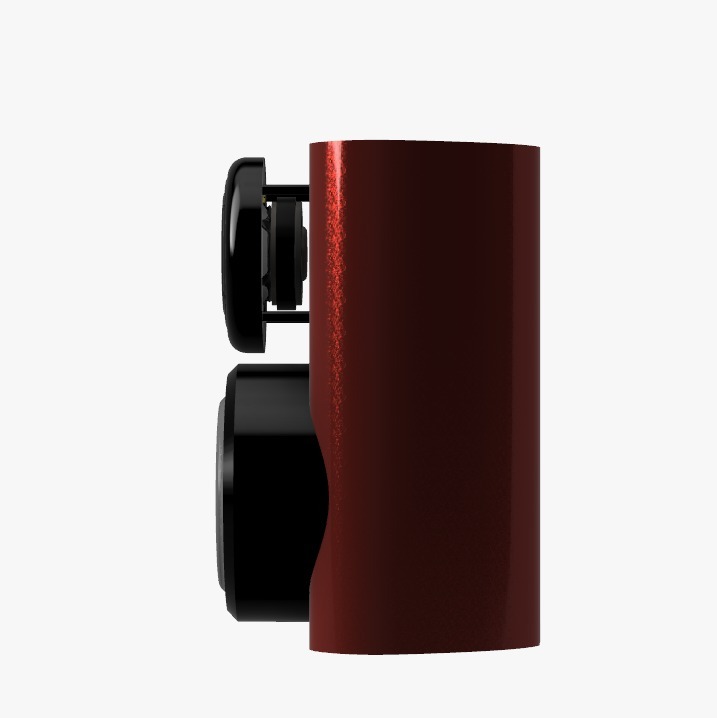

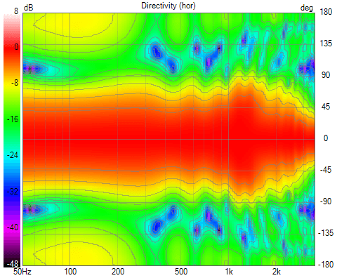

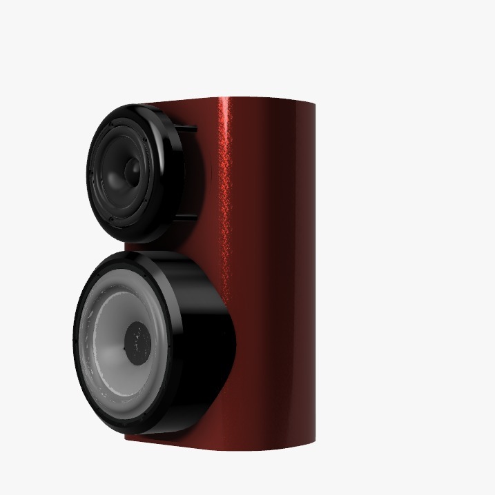

In thr above case the horn mouth rounding seems to be protruding out of tla baffle which is about 6-8 ish cm behind the horn mouth. And the issue seems to be around 300Hz to 1kHz.
I guess that it the region where the horn doesn't have much control over the pattern as even the mouth diameter seems 40cm max. So the radiation might be widening and secondary sources might be forming and interfering from what comes out of the horn.
In my case, if this issue is to be present, I guess it will be affecting my mid driver's output. I was hoping that if I get below kind of pattern control in the mids as I got in the prototype, It wouldn't affect much as the cardioidish radiation beyond 90 degrees is attentuated by more than 16ish dB (all depending on the resolution of my measurement, which is low anyway in this region)
The other thing that I wad hoping will work is that my enclosure is rounded at the edges starting right from the edge of the waveguide such that it doesn't form that 90ish degree boundary with the protruding mid driver. waveguide as shown in below figure
But this is a valid concern and I really need to do something about it. I want to explore the effect of mid driver radiation with this kind of cabinet in ABEC or Akabak.
@fluid: Could you please let me know if such an analysis is possible without a lot of difficulty with ABEC? Could you also point me to some help or guide (if any such thing is available) about how to do cabinet impact simulation with ABEC like you did for my first 3 way design. Till now I have only been playing around only with ATH generated ABEC projects. So my knowledge about creating an appropriate mesh setting etc for such a simulation is rudimentary at best, as of now 😀
Requesting others also to chime in if you have any other suggestions...

The design you have drawn is not the same as the one with the odd baffle mounted freestanding shape waveguide. It is still similar to the BEE, it won’t be quite the same but it won’t suffer the problem shown above.
Anything can be simulated, the basic structure of the BEE design sim can be used and different meshes used to represent the cabinet. I assume that you will be planning to use a ring of foam in the gap. That can be a cylindrical surface with damping applied. The same problems of getting accurate damping simulations still apply but it can get you in the ballpark to see how much damping is needed.

In this cabinet design, I tried to ensure (roughly) that I have the same area for leakage behind the mid driver as I had in the BEE enclosure prototype I did with xps foam.
Yes. I am planning to add the same 50mm thick melamine foam in the entire open volume behind the driver where the leakage of radiation from the back happens.

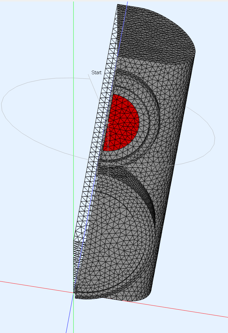

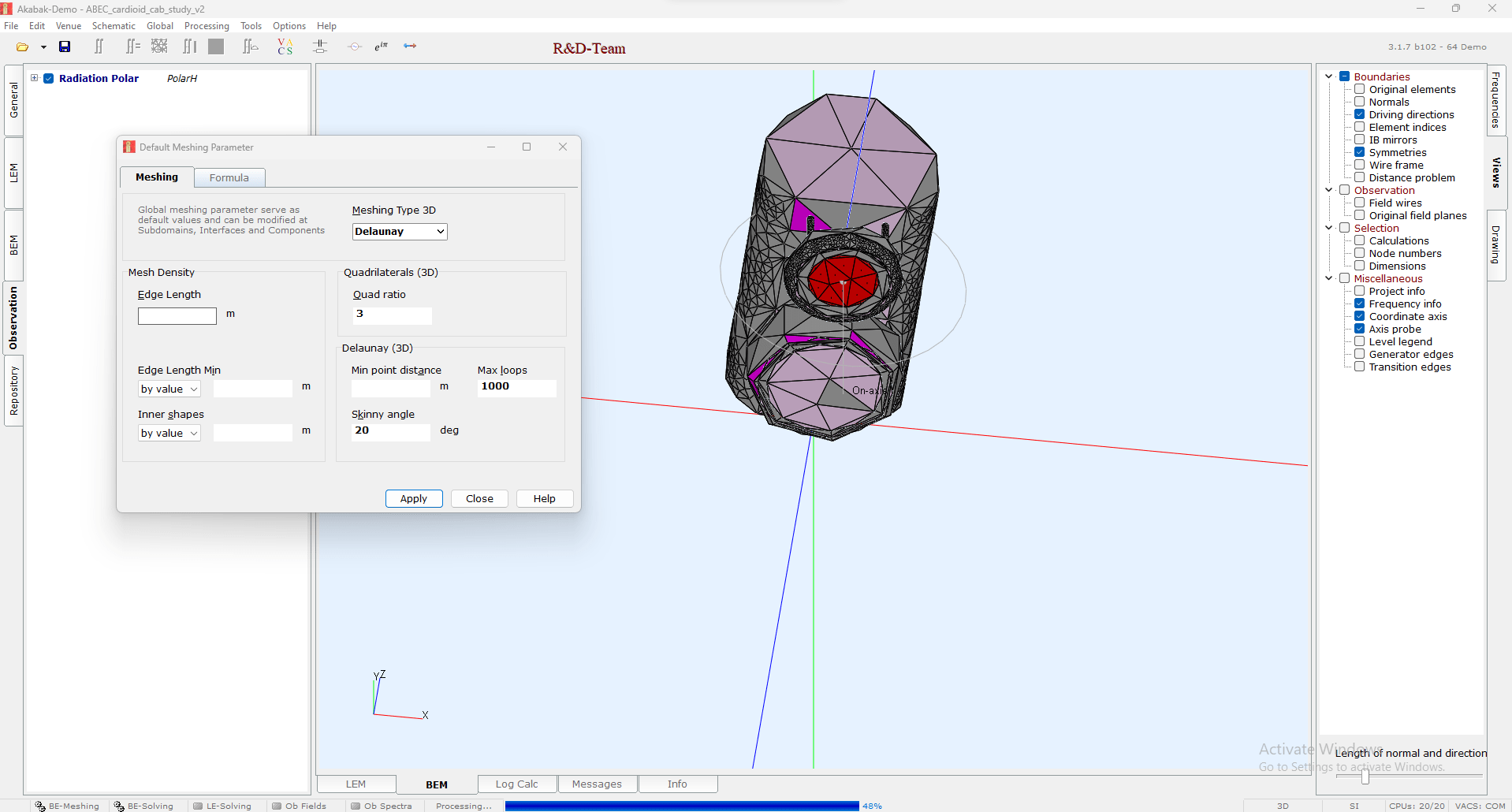

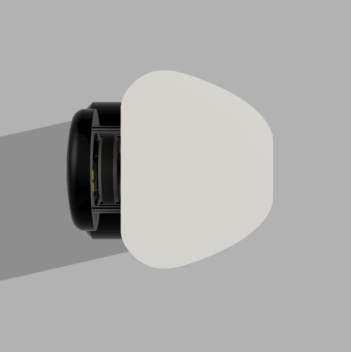

I was trying to simulate the cabinet impact in AKABAK (without damping applied to the back of the driver) just to get a starting point. I don't know the correct terminology yet so I am trying to describe issues below based on what I know so far.. 🙂
I defined only one exterior subdomain, no interfaces and didn't use any symmetry. I defined two element meshes, one for the driver and one for the cabinet.
But when I try to run the simulation, at the start itself I am getting an error saying edge length missing in Global parameters or something like that. It still runs but I dont know if it will give any useful results.
I see pink color traingles in the mesh. Is this bad?
Here is how it looks:
I dont know where to proceed from here. Do I have to redo the meshing part or do something else to solve this issue?

This is a bit of a trainwreck. The Pink triangles indicate that elements of the mesh are too close to each other and will not solve properly. In this case it is because the mesh is way too coarse in some parts. Send me the akabak project and the files you used to make the mesh and I'll see if I can sort it out for you.
I was able to get something more reasonable looking for you, but unfortunately this is still not going to simulate very well. The CAD file needs to be made so only surfaces that are needed are there and that there are no gaps in between them. Your CAD model needs some work to simplify it to just the required surfaces. For a dipole simulation there needs to be a mesh to represent the rear of the diaphragm. You can see this in the BEE model. Most of the Akabak things you did were fine, the mesh needed to be made at a higher resolution. This can be tricky if you include all the parts in the same step file as it isn't super easy to make different parts have different resolutions. When doing things manually like this is would be better to have the mid driver and its baffle in a separate file. I got rid on the mount points as they are fairly irrelevant. A cylindrical surface would be needed between the back of the mid baffle and main cabinet to be used to simulate damping.
I made it half symmetry and the fixed driving to divide by jw to represent constant acceleration.
At this resolution it is over 8000 elements which is going to take a long time to solve, the mesh can be made much bigger in some areas to save on elements which would be needed to make the solve time reasonable.

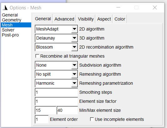

What software did you use to generate the above mesh? Is it Gmsh? It looks super clean compared to mine.. 🙂
And what settings & Algorithm do you use. I just left it to the Gmsh tool Meshadapt to generate the meshfile. Now I understand it is not the best way.

I use gmsh this is an example of the settings, the min and max element sizes are important. In the image before I had used 0 and 10. You can change these reload the script and mesh again to see the effect. On the advanced page there is an option to mesh via curvature I use that some times and set the number of elements for pi to 12.
There is also the option to define size at points on the step file which can be helpful and using trans finite curves or lines. Those can be saved in a geo file and the text edited.
Some or all of these in combination might be necessary to get the mesh as you want it.
I would generate new surfaces that are simplified versions of the outside shell. To start off with use chamfers instead of round overs as you can get away with a lot less triangles and the result is quite close. Get a basic low enough resolution model to start as it will solve quickly, then you see if there are issues or problems without wasting hours solving high resolution meshes where you screwed something up without realising.
