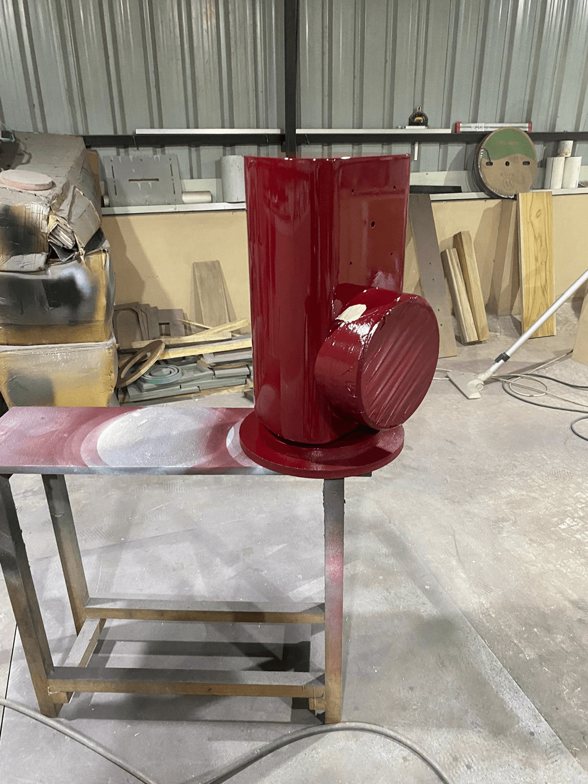

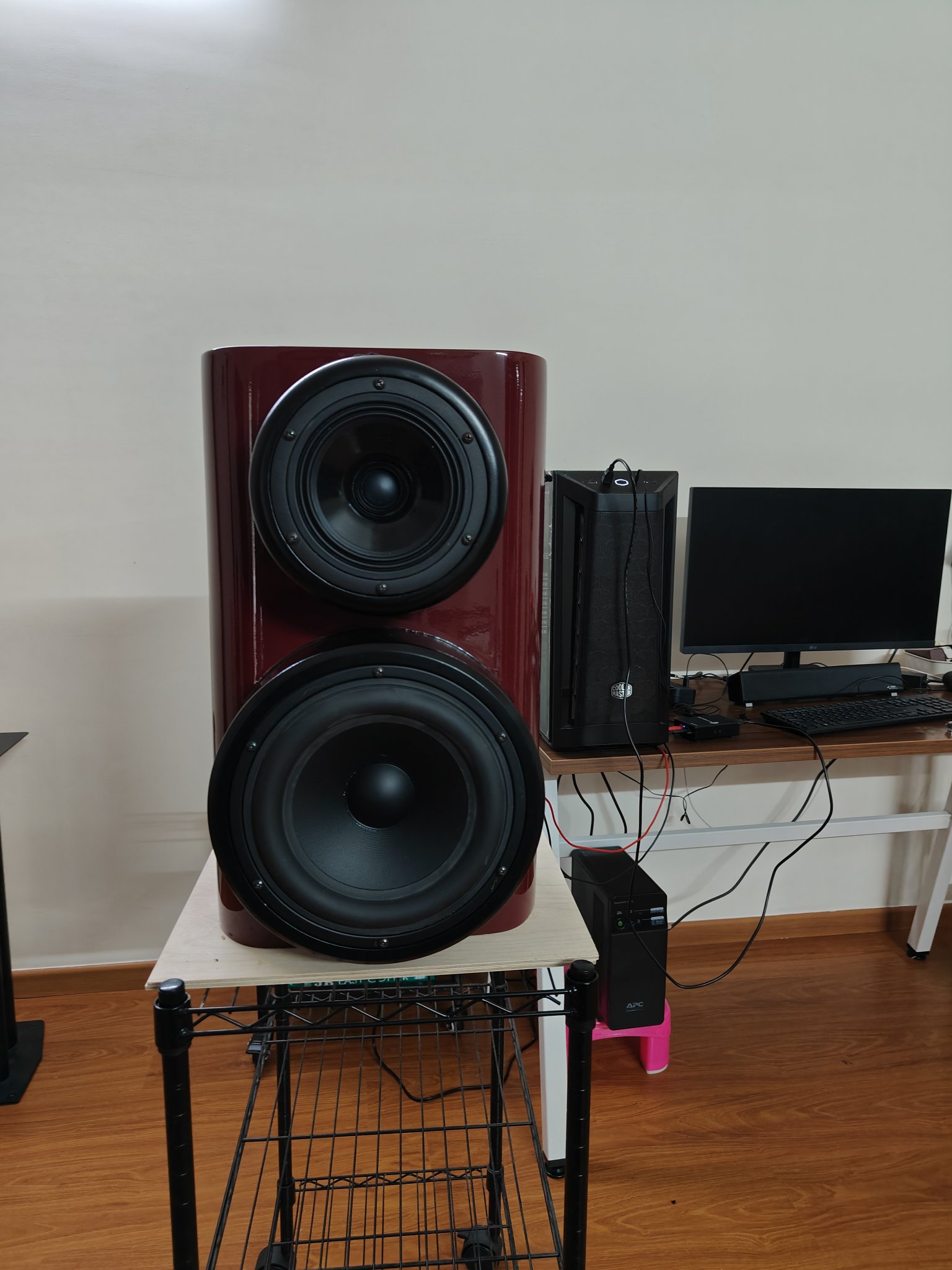

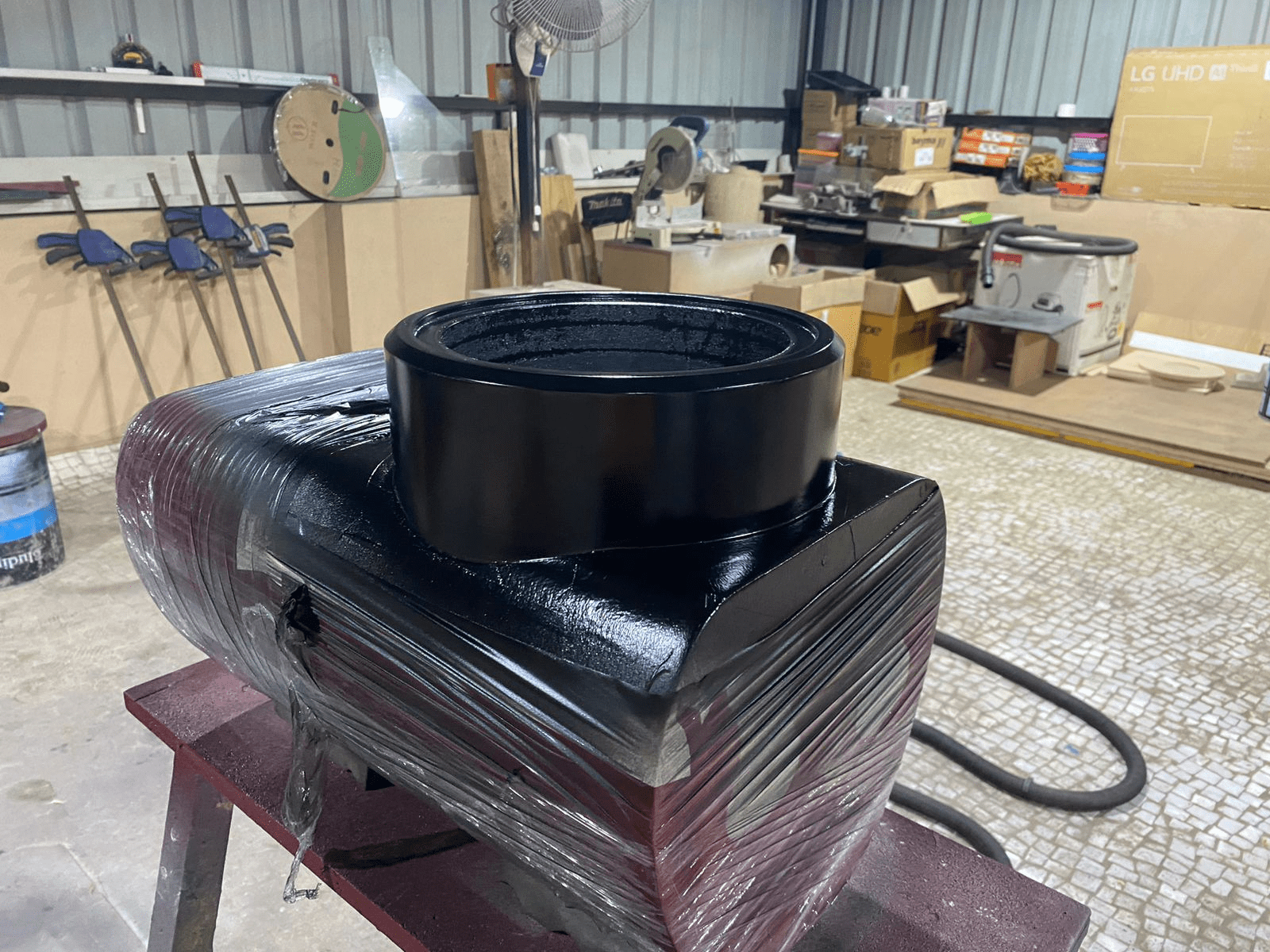

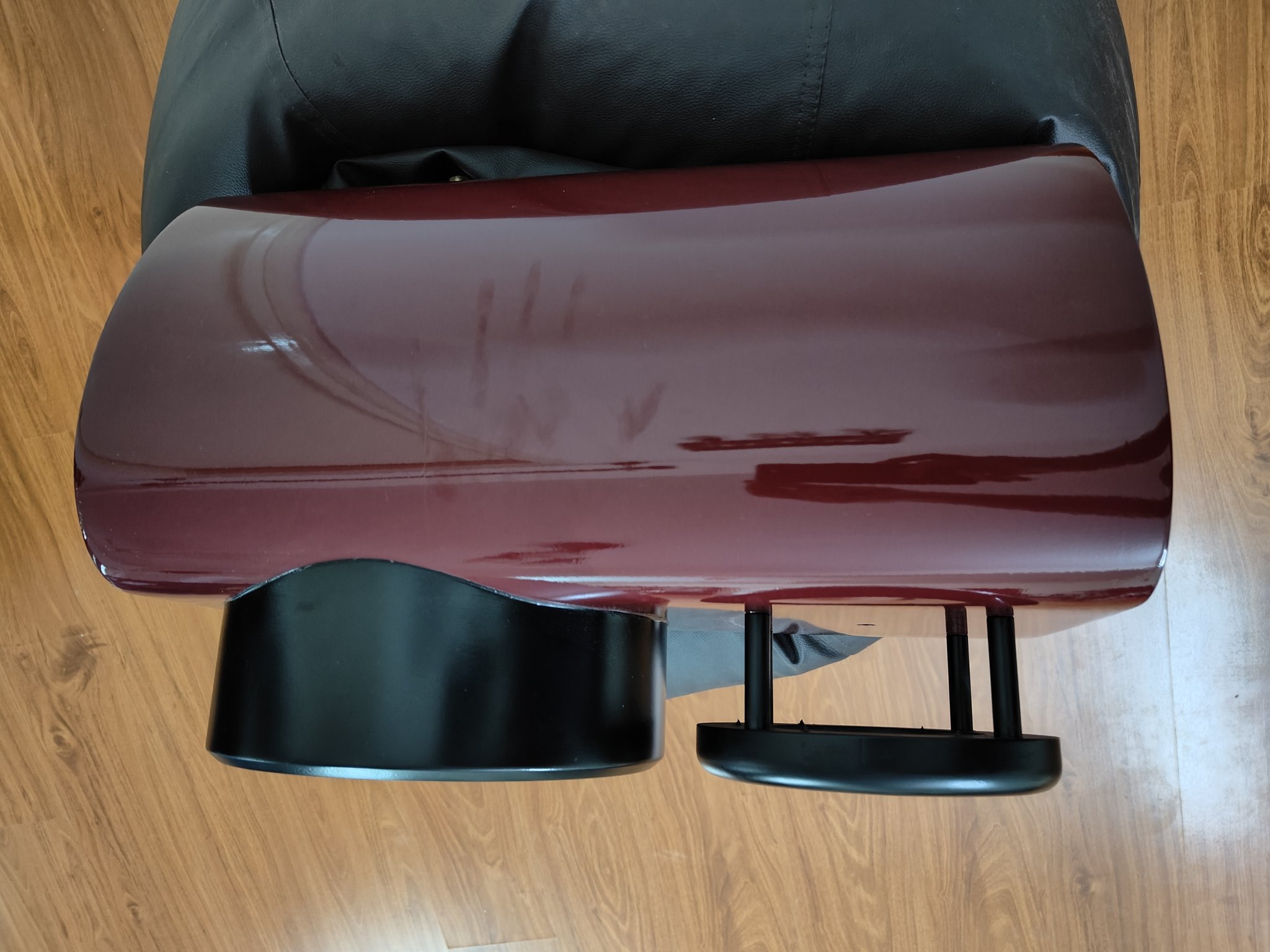

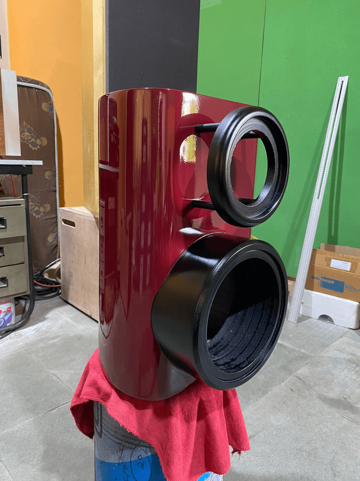

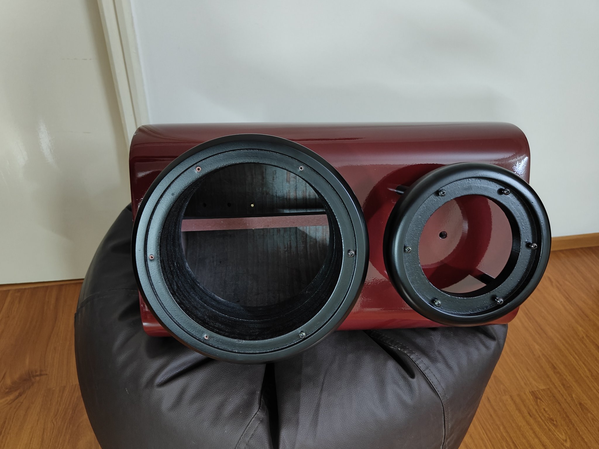

A 3 way design study

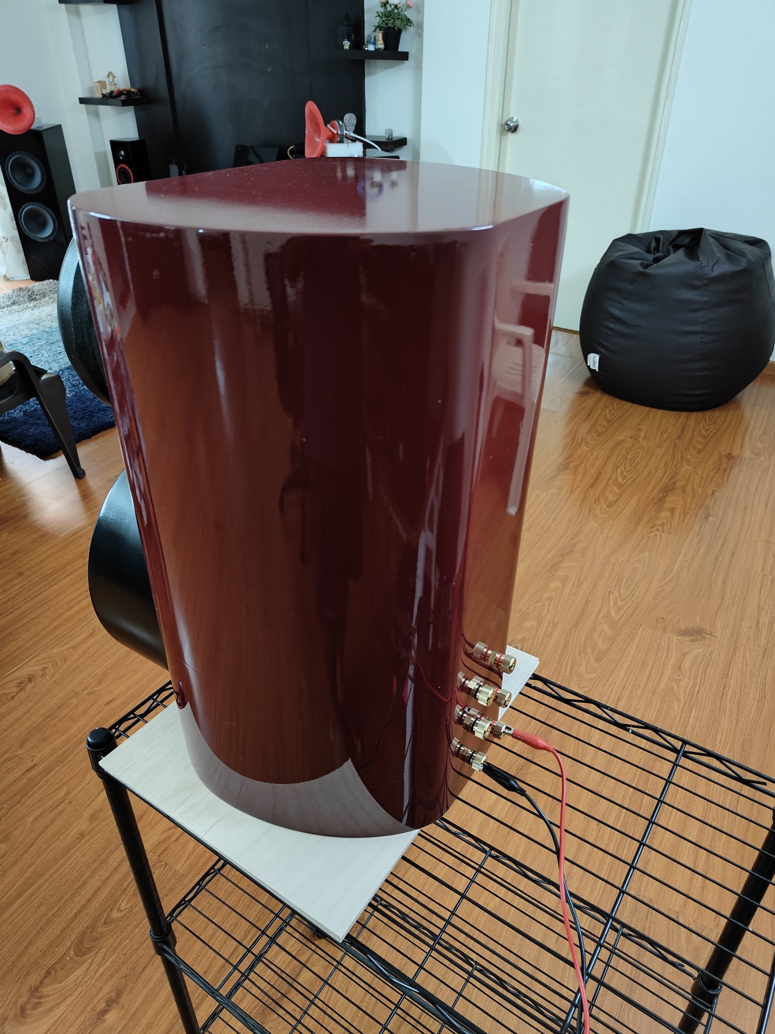

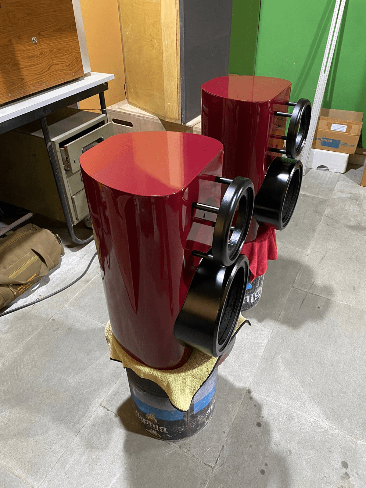

After a lot of hard work by a friend
And the result is 😀
I think it looks really nice now.. 😀
If only the performance could match the looks now.. 😀

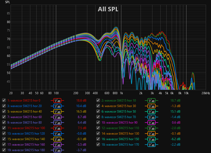

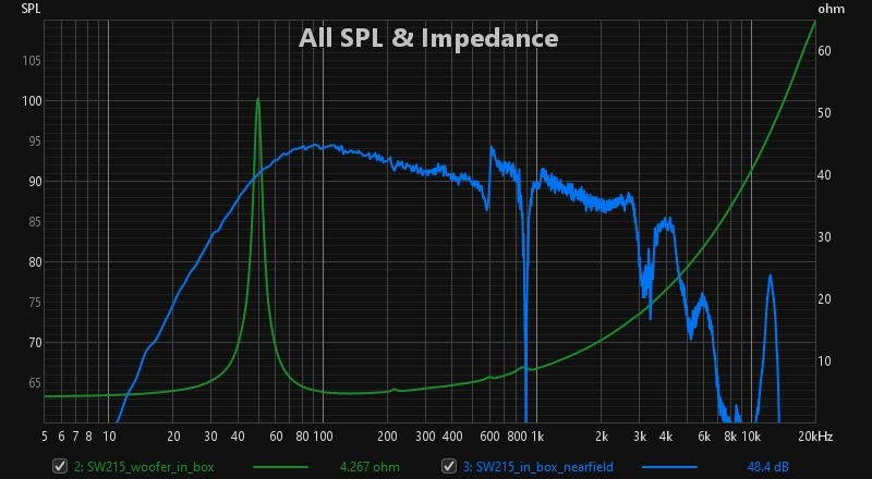

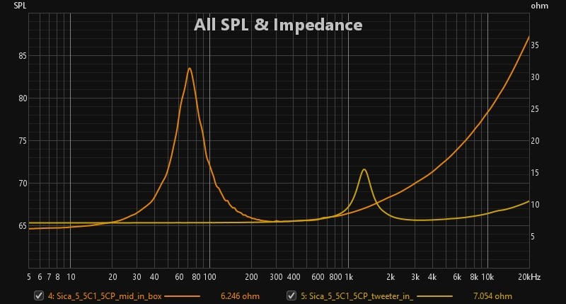

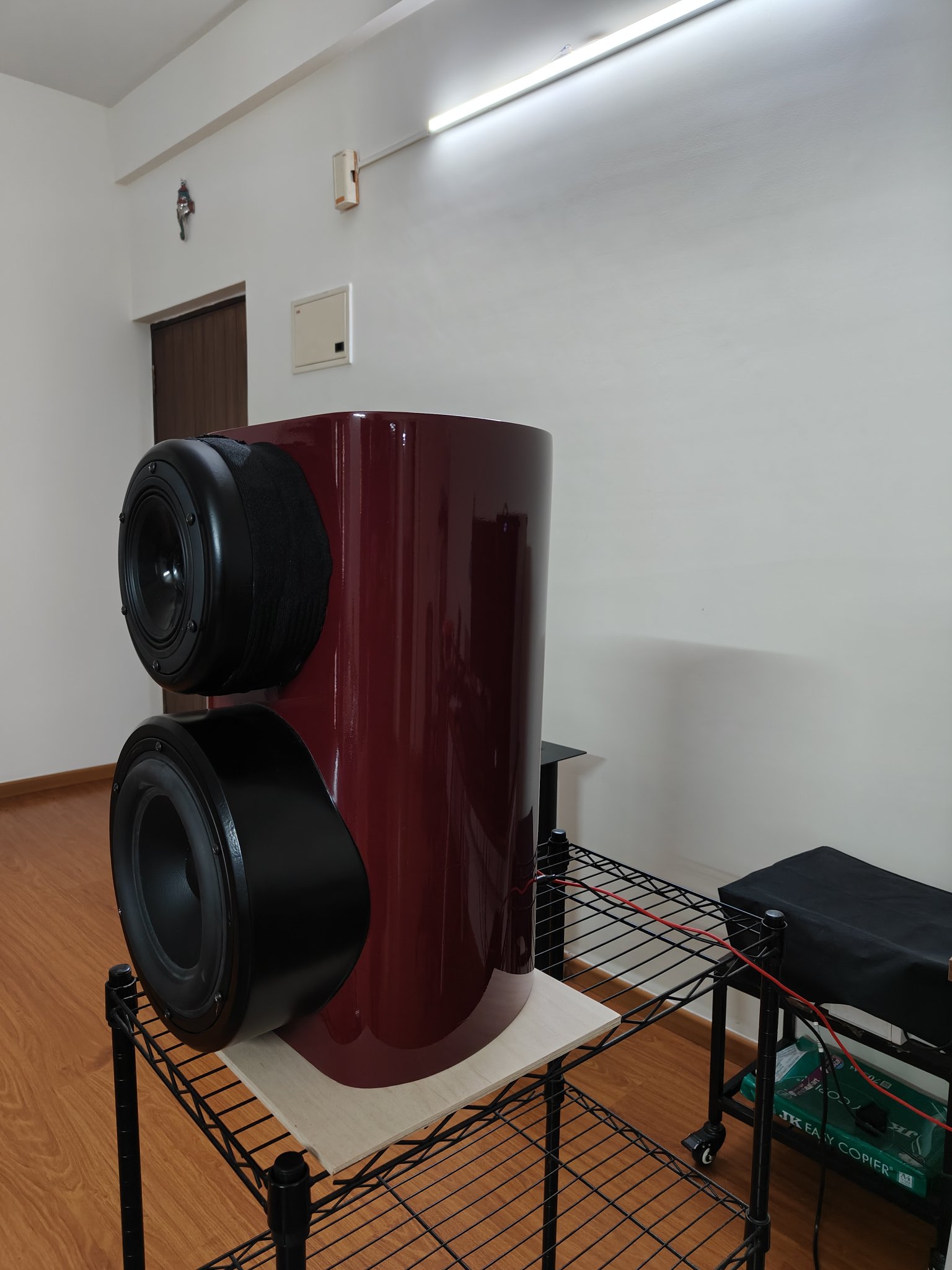

Some starter measurements 😀
Woofer free air vs in box impedance measurements
Woofer nearfield + impedance in box (not baffle step adjusted)
Sica mid and tweeter impedance (in box)

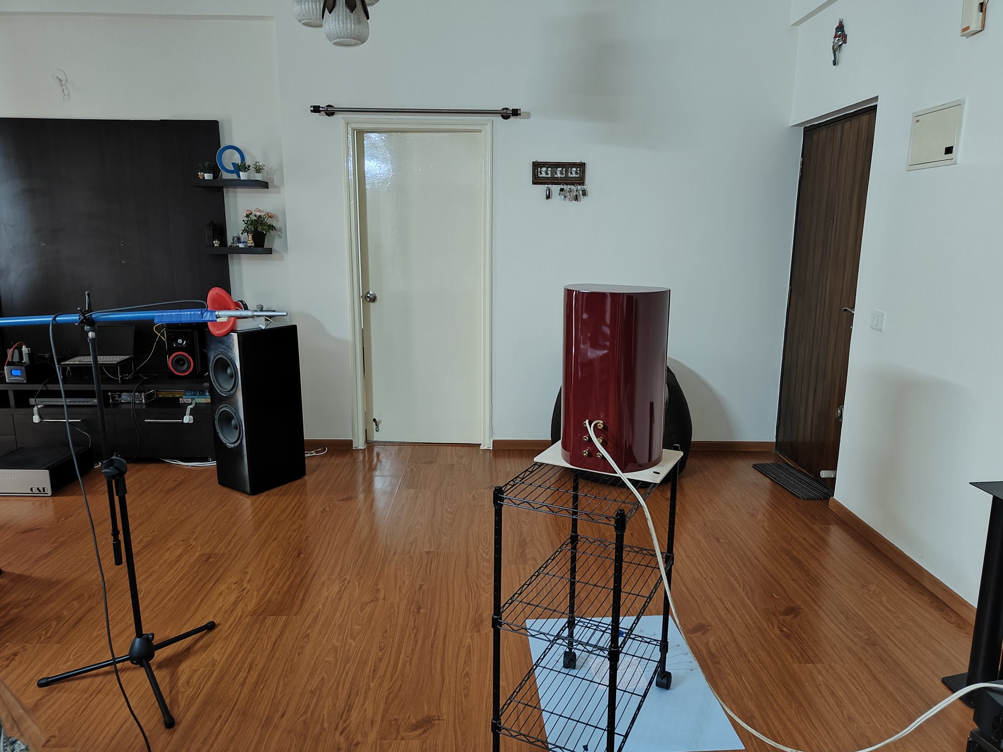

This much is all I have got today.. The farfield measurements will tell us whether the cardiod midrange works (or not)... Waiting for that exciting/ heartbreak moment 😀
Whatever happens, I really love the looks of this speaker 😀
Very nice, big plus for the shape idea and execution...👍
Please show us horizontal and vertical measurements with completely open back side of coax and if you can - only with left and right opening....I mean to block upper part above and below coax.
It would be interested to see dispersion difference between all 360 degrees leaking behind the driver and only left and right (like dutch n dutch is leaking just a little bit on sides...).
I hope you will be satisfied with sound. 🙂
  • Thank You
Reactions: vineethkumar01
Tell your friend who painted them he/she did an amazing job. Lines in the paint reflections are sharp and clean. I'm certain they will sound great because you simulated them. In my very limited experience simulations do a great job. However, your design is a lot more complex than anything I've done so you'll have to spend time on working out the resistance media in addition to the crossovers before you're completely happy with them.
Also, they're visually stunning. You'll have a lot of fun listening to those and showing them off to your friends.

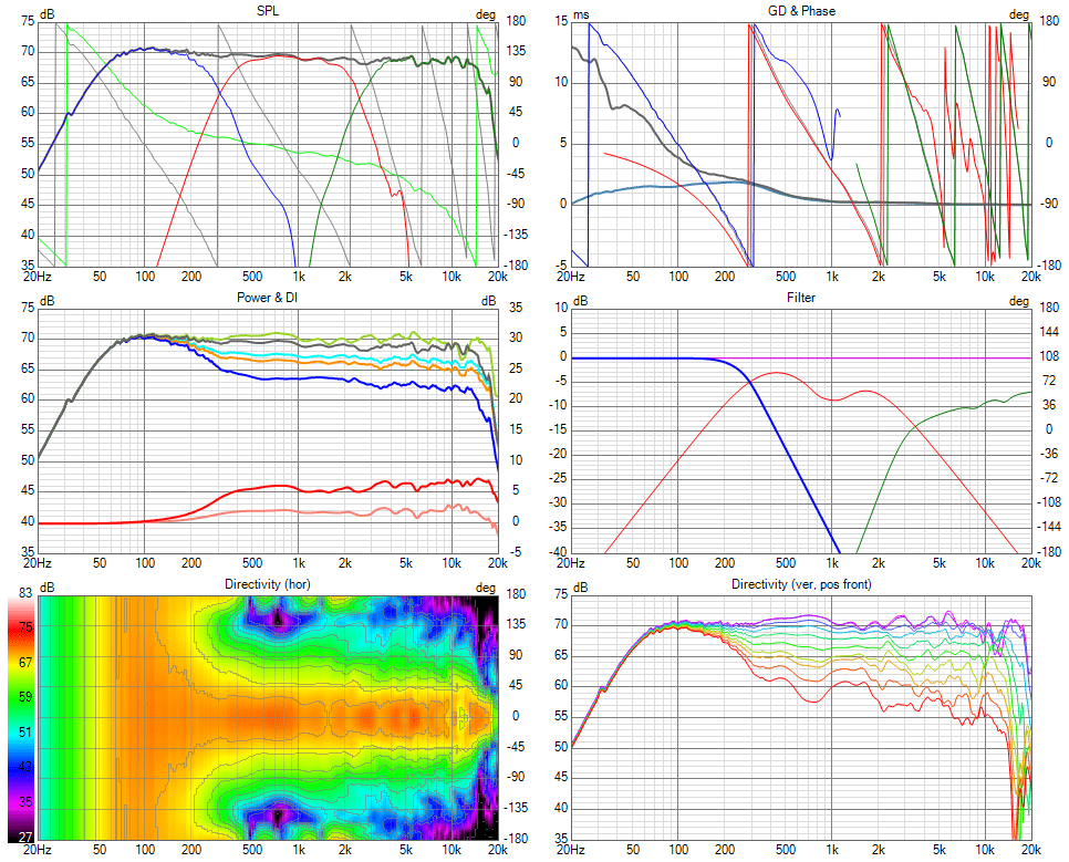

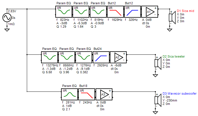

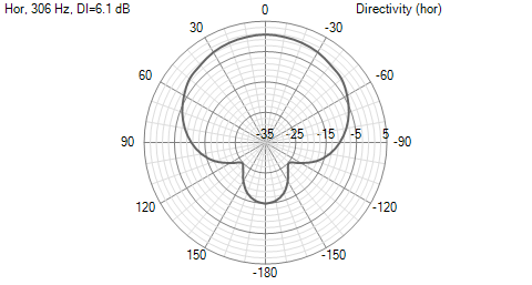

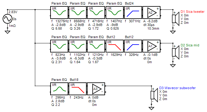

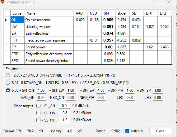

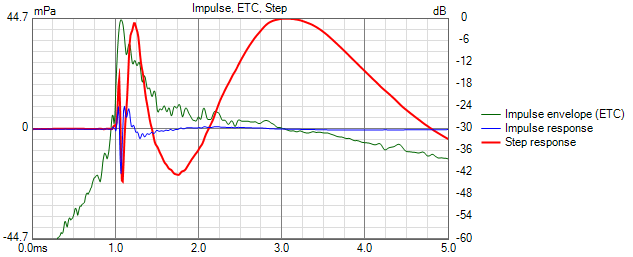

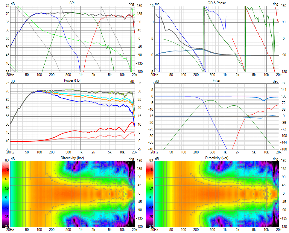

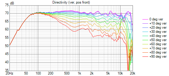

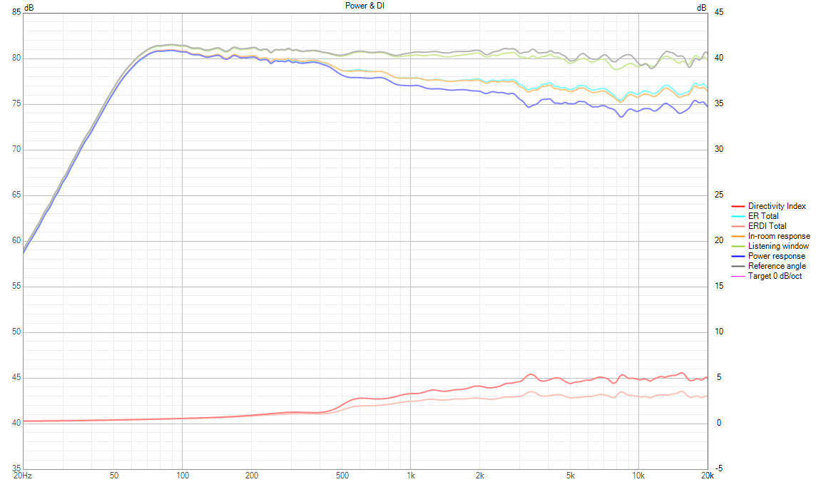

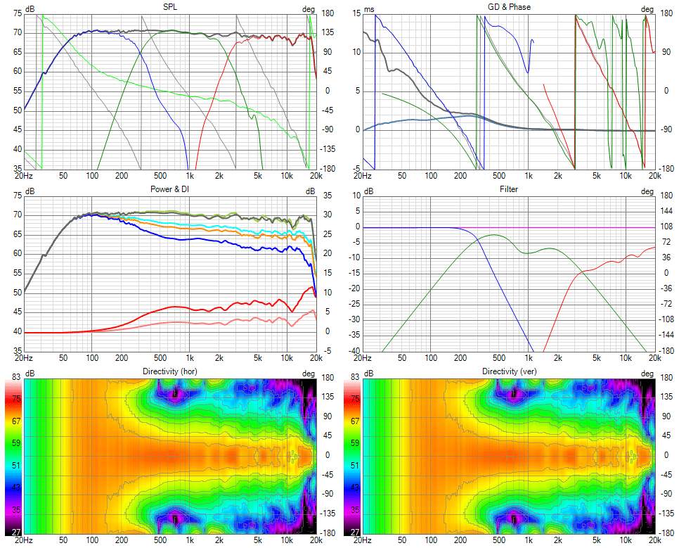

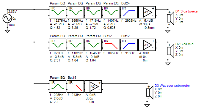

I did one more iteration of the crossover. Here is it
Reference axis is 20 degrees off axis
Now I have a few questions. 🙂
1) What should be the target for optimizing the responses? (The application is relatively near to mid-field listening)
2) Is it possible to remove that excess group delay bump of 2ms around 300Hz? (I have heard that getting it under 2ms above 100Hz is good?)
3) Can we improve the timing response curves?
Any improvement to frequency response curves is always welcome while doing the above 😀
I have attached the vituixcad project files here (due to the large file size): https://drive.google.com/file/d/1Ynzzac-tJfbAaezGuehd63ZGNzwcVu4C/view?usp=sharing
Please take a look at it.
I am also wondering about a passive crossover version of the above speaker. Given the relatively less EQ needed, I think it is a possibility.. 🤔
You are already inside the window of paint by numbers to get a reasonable response. Try some different options and listen to the differences. There still seems quite a bit of dipole in the mid response.
Make the slope of the crossover less steep in that region. Zoom in on the filter and phase response window and you can see where they line up.

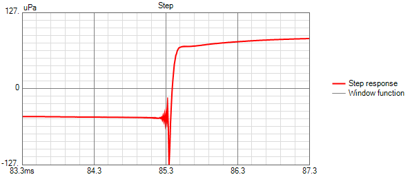

Passively or actively you can invert the tweeter, use a single order filter combined with a deep notch (below or above) the crossover to steepen it up further away from Fc. That way the tweeter can rise up at the same time as the mid and step will look better. This is what Joe Rasmussen does in the Elsinore. The filter will then look a lot like an elliptic. Use a lower slope crossover from woofer to mid. It is unlikely that either of these will make the frequency response better. Or go linear phase, that does work better with fully complementary acoustic slopes, to cancel preringing so sloping the response down breaks that somewhat.

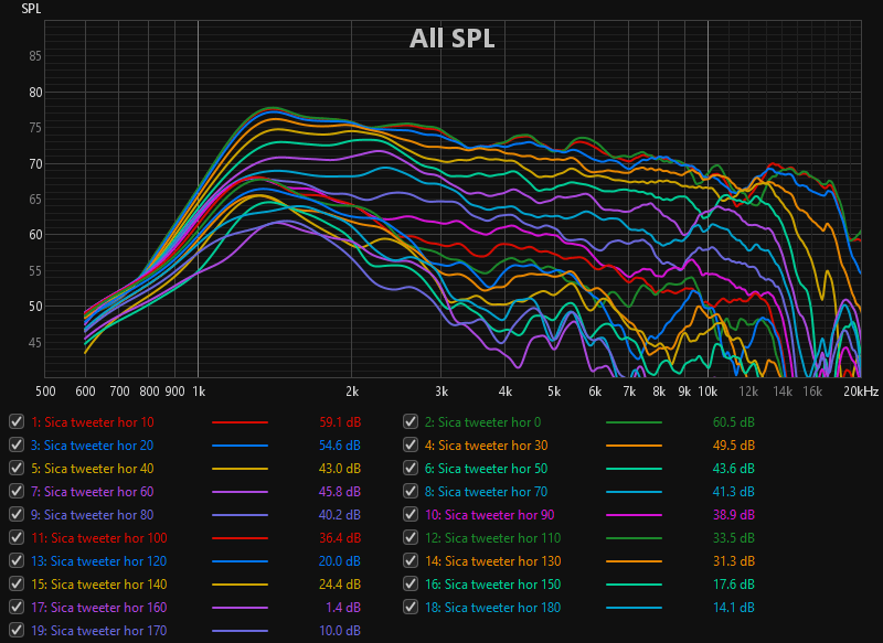

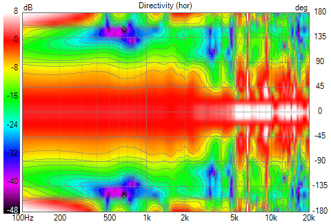

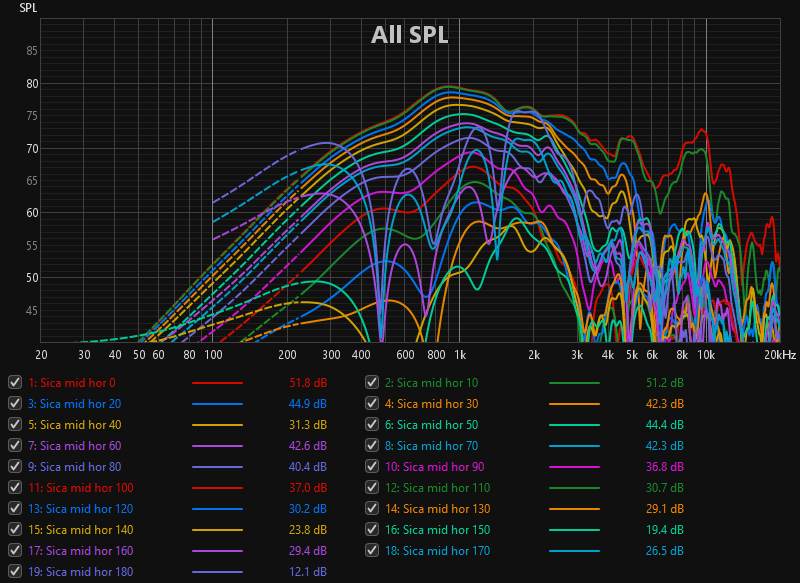

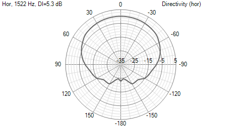

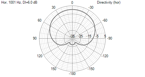

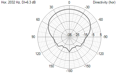

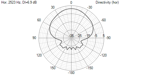

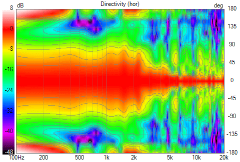

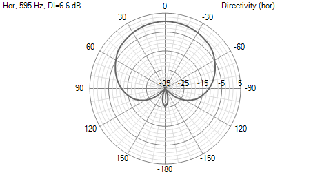

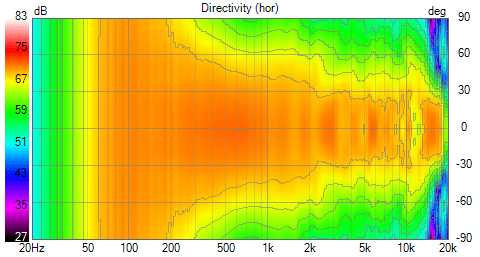

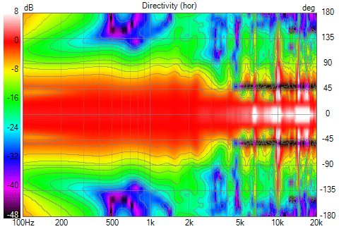

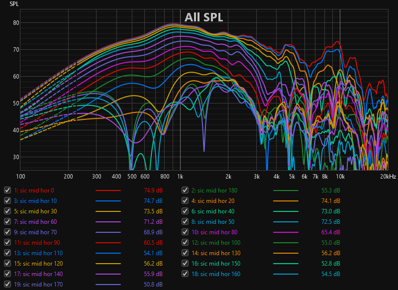

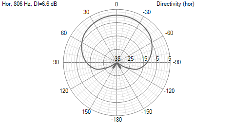

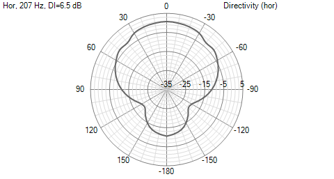

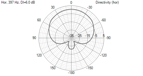

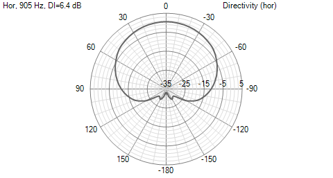

Motivated by @fluid's comment about hints of dipole radiation in the mids, I went and measured the mid again (0 to 180 degrees horizontal polar). As I suspected some measurements from yesterday, beyond the 150 degrees angle was garbage. Here is a snapshot of today's polars for the mid. It looks much cleaner now than yesterday's and more cardioid than dipole 🙂
Directivity based on Measurements from today above responses (measurements are 4.4ms gated)
Measurements from yesterday showing more energy at large off axis angles (measurements are 4.4ms gated)
