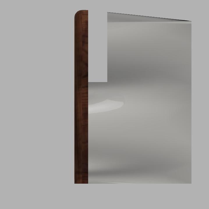

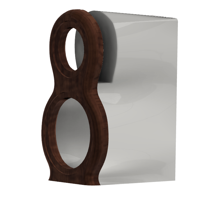

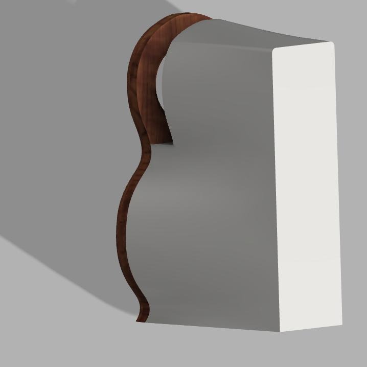

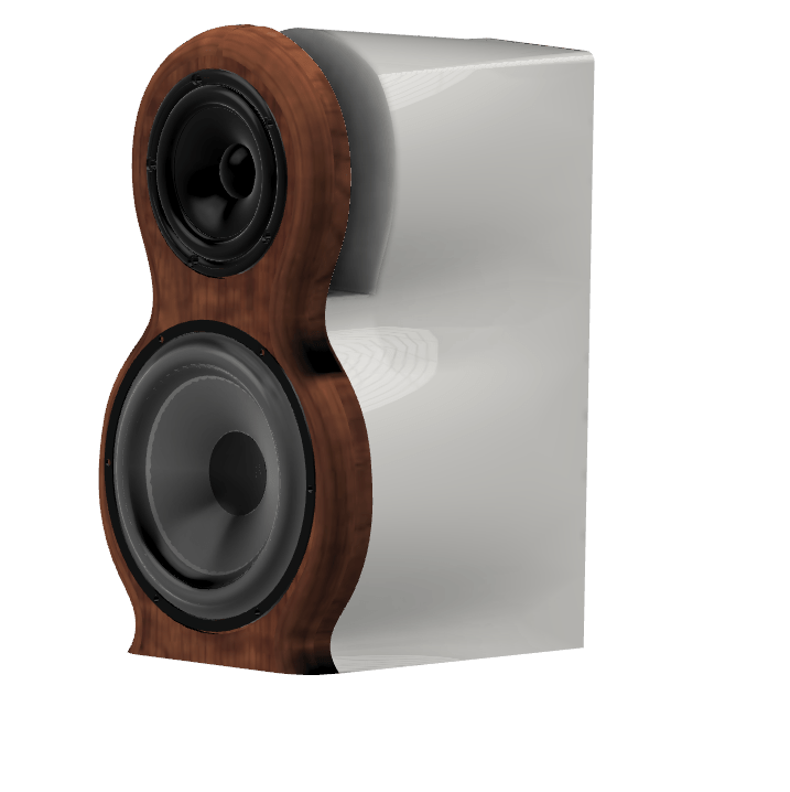

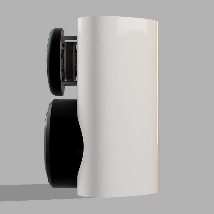

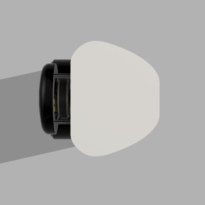

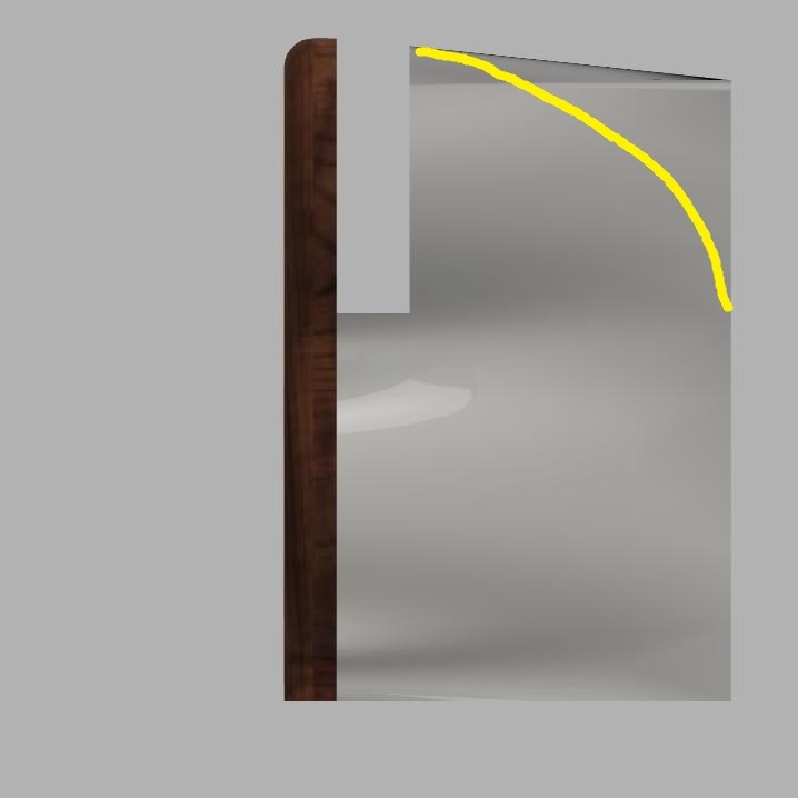

A 3 way design study
I really like this iteration but it is probably impossible to make one that looks like this here.. 😀
I will probably try to flatten out the back and sides and go with that......

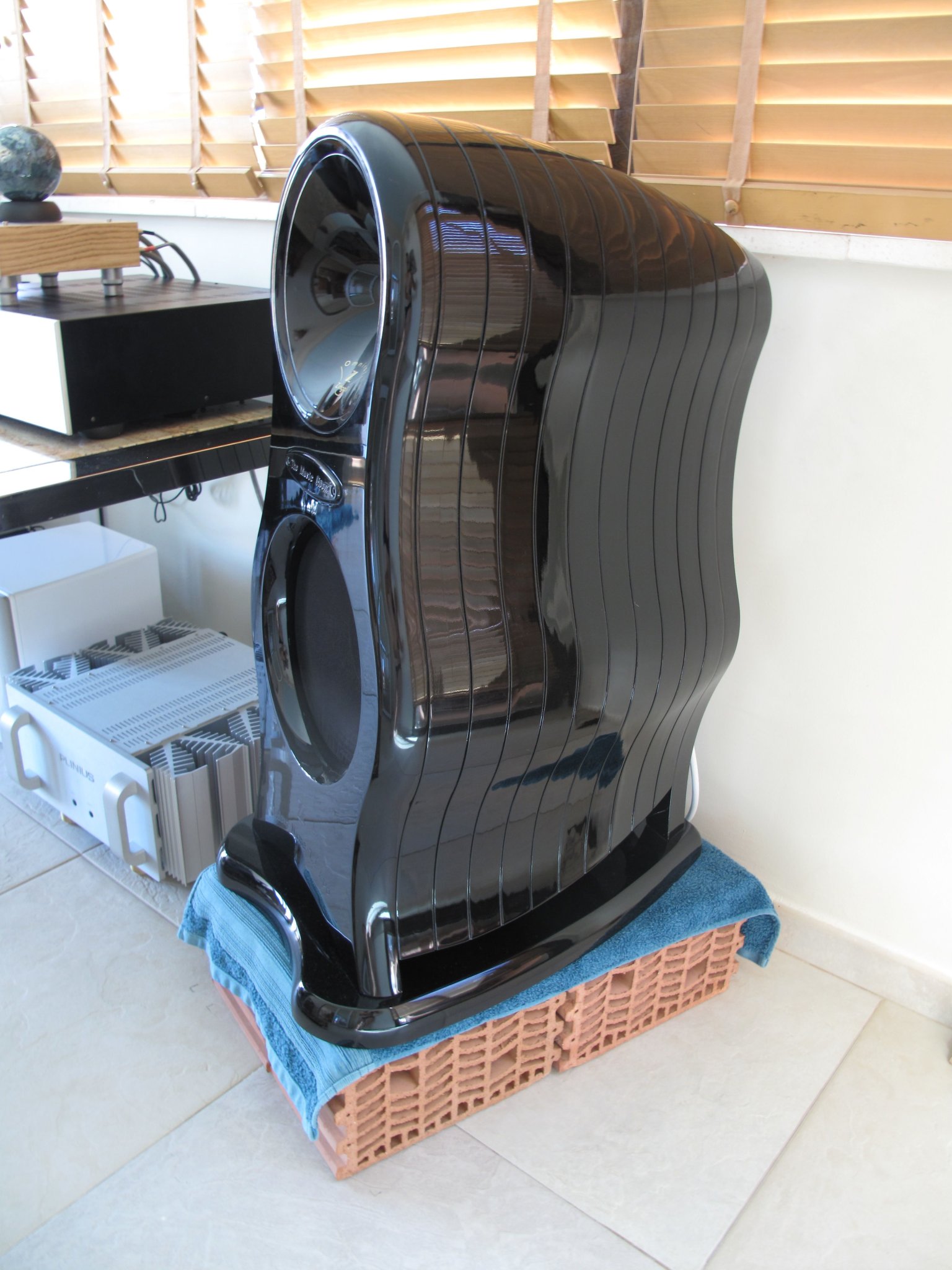

Why not? People here really love industrial precision, which I find is relatable, but you could easily create this at home if you combine a number of MDF sections and remove the edges by hand:
Diffraction wont care if the geometry is slightly off here and there and when working carefully after some filler, a very nice looking result should be possible.

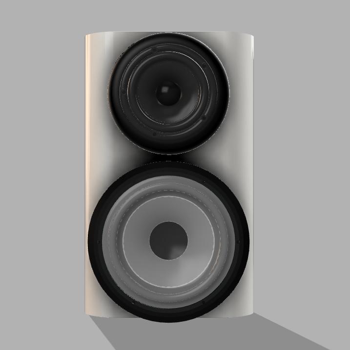

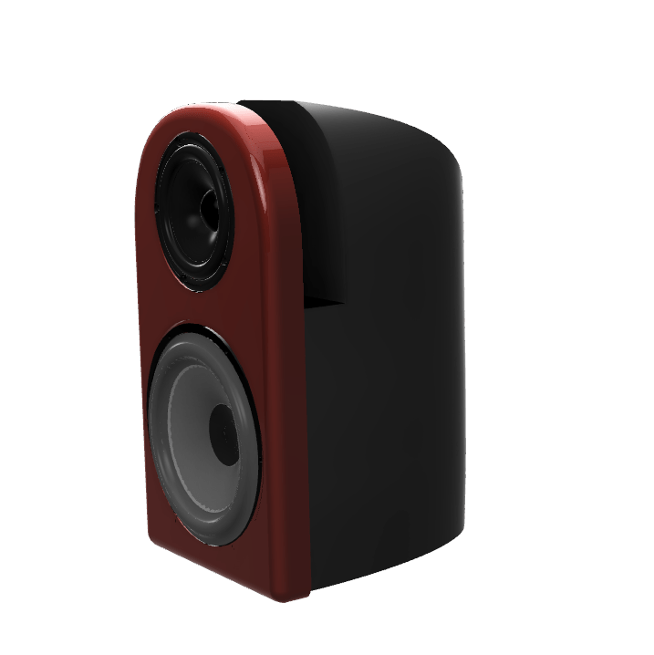

@mabat: Is it possible to simulate a normal cuboidal kind of box in ATH (with the slot) instead of the current top & bottom rounded enclosure (with the box shape looking like an oval from the front)?
Also how does the top &bottom rounding of the enclosure play a role in the overall diffraction reduction? Was it primarily meant of reducing the woofer cabinet impact on the waveguide kept above it?
At wavelengths where the open midrange structure was supposed to be used, i.e. up to ~1 kHz, I would expect the effect of a different shape to be only mild. Maybe the biggest effect will be on the coaxial tweeter's response, after all, but that's just my guess.
I'm working on that, as I want to try it myself. The round top was simply what occurred to me first (and I believe it does reduce an interference with a waveguide above it).

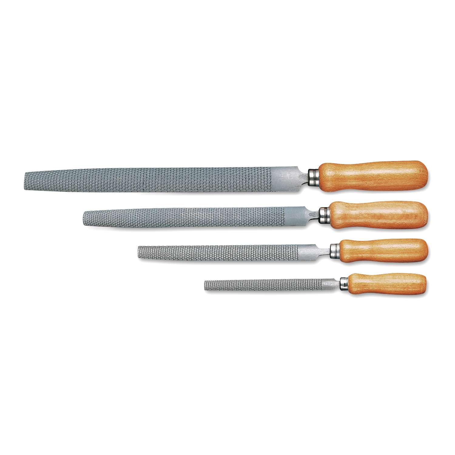

Yes, with CNC you could then easily produce few layers and glue them together. Then some sanding and sealing and voila!
If you are enough persistent (and we can see that you are) you could actually cut MDF layers with small handheld jig saw...

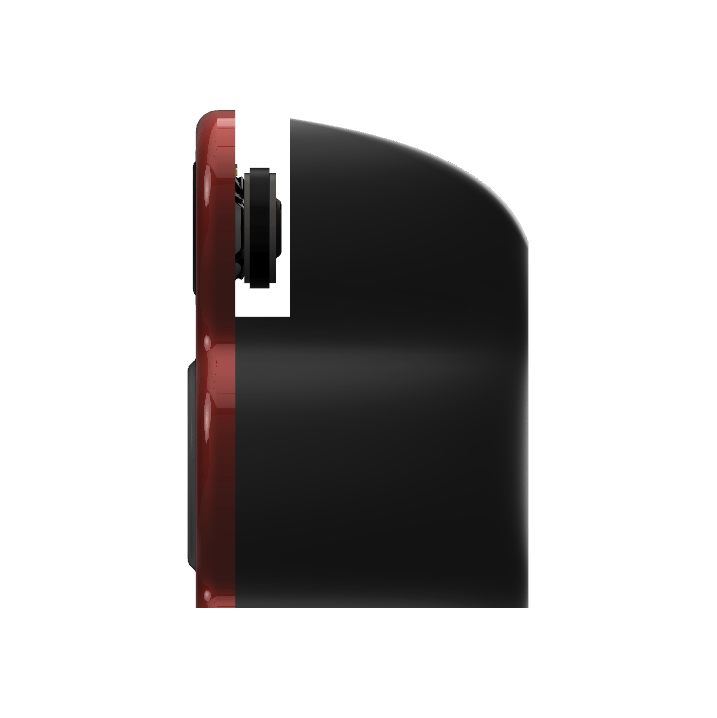

Would you get any changes in directivity if you make back of the coax also rounded and not so rectangular? Also box would appear smaller on desktop...
This was a fun technique to suggest but quicker, easier progress will be made with an electric palm sander and coarse grit sandpaper. I no longer have pictures but back in the day I hand sculpted curves/rounds on solid oak that way. Unfortunately, a couple of years later, the solid oak had drying cracks.
Being lazy , I wonder if the desire curves as in the latest images can be achieved with a step-wise approximation using MDF layers parallel to the baffle. Glue the layers together, smooth the steps flat with bondo, then palm sand it to a smooth curve?

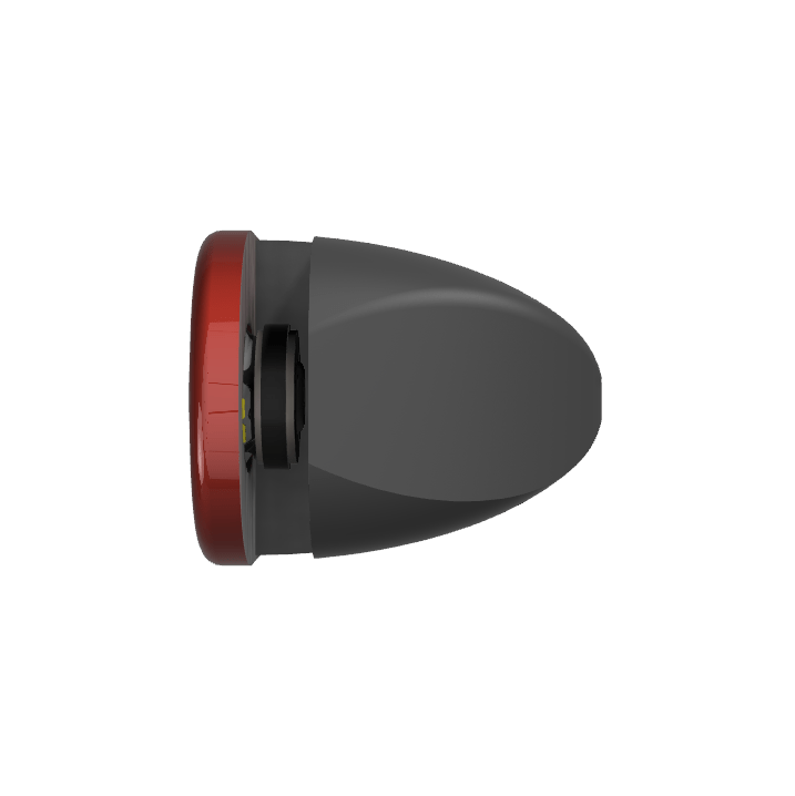

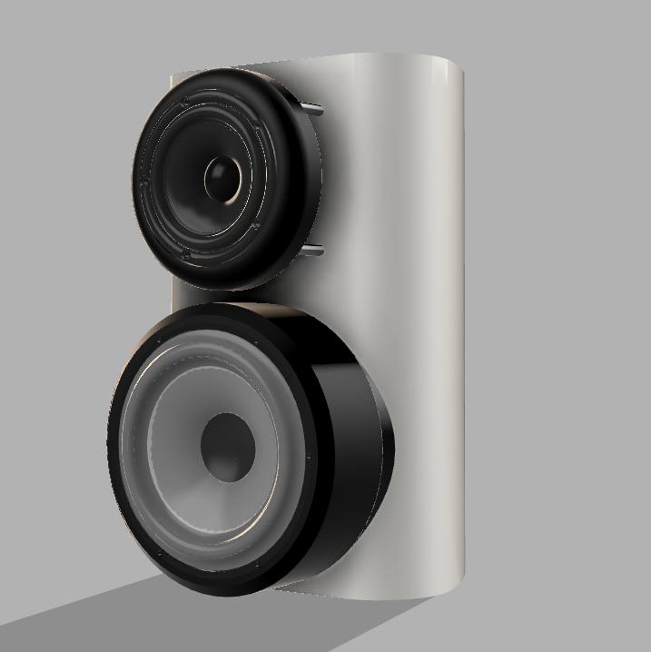

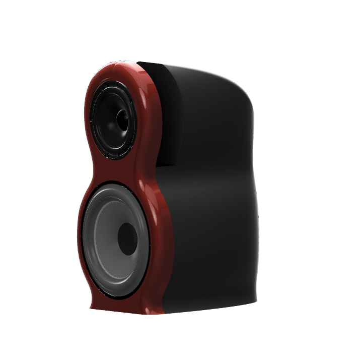

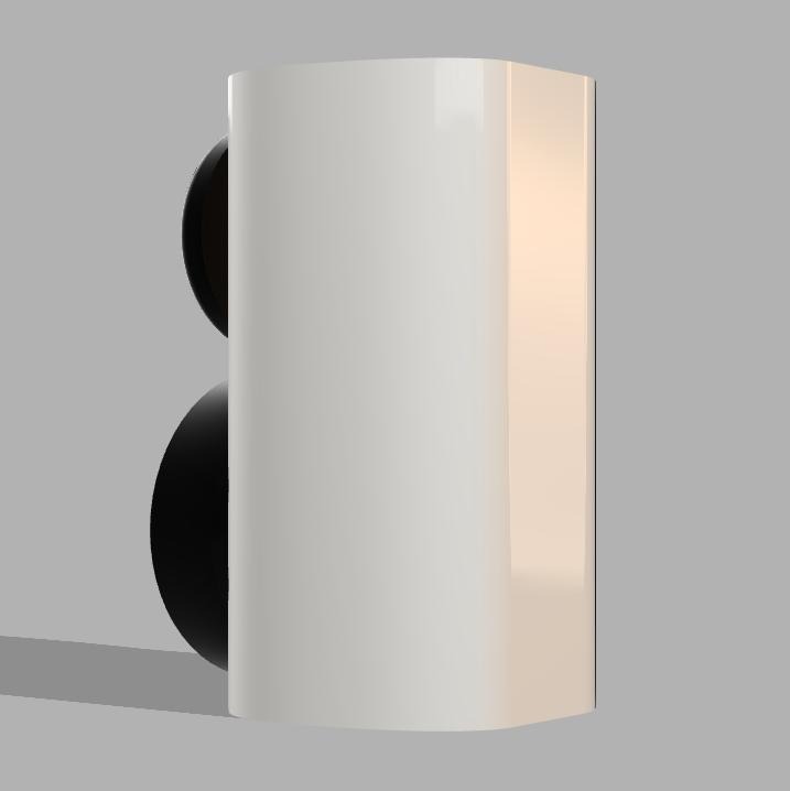

I just couldn't keep myself from not doing this.. 🤓
Latest iteration which I like a lot
I need to use something like hornresp to see if the 8ish cm long tunnel at the backside of the bass driver forms a transmission line and does something unwanted to that driver's response I think..🤔 But other than that I like the looks. Speaker has probably gone out of "desktop placement" category I think.. 😀 But I have dedicated bookshelf speaker stands lying unused so I can even use that.. 🙂
I know it has that one eyed minion looks.. 😛
But still I like it.. 😀
Manufacturability is also easier for this one I think, due the constant curvature bodies everywhere... CNC cut and atcked MDF can be used probably.. in 3 parts. One for the main box. Two separate pieces for the top and bottom rings that hold the drivers..
