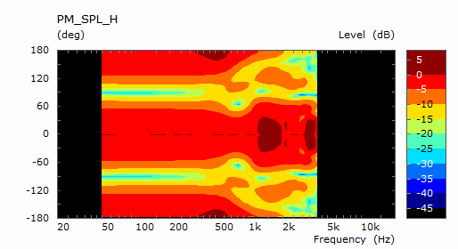

Yeah, basically the process is to make simulation and measurement and try to match them, which gives some confidence to rely design with simulation only. The cardioid pattern is kinda tricky to get working in a way that seemingly small changes (in real DUT and measurements) seem to affect the pattern a lot. Same goes for the sims, with its own quirks. For example the ImpType=Impedance doesn't seem to work if the material covers a hole but Admittance seems to get better match to reality. Can't load data on ImpType=Damping as you found out. The data is also hard to come by, would require impedance tube to make your own. Then, it takes some time to figure out the simulator, domains, normals, data, ABEC in general, million mesh files, 3D cad and so on. In short, took me quite lot of hours to get anywhere and still not there
I've tried to match sim to reality on quite a complex model, and got close but not quite mainly because the damping. I'm having also another material within my box, for which I don't have the impedance data. And have been lazy not to build and measure with the melamine only to really nail on the simulation.
Things like magnet size, aperture size, internal volume, all change the results and its a lot of work to get sims match reality until hopefully someday they will and you can design a box in the simulator, but until then its a lot of work and uncertainty.
Based on this, if you want to get deep into it I would suggest to come up with some "simple" structure with the melamine foam playing a role, measure and simulate until match measurements. Build another / change the setup, and see if sims still matches. You could also try to find data for some other material and try with that as well. Lots of unknowns. Best resource for any ABEC related stuff is its help file, while some bits and bobs here on diyaudio.com, otherwise its just unexplored territory, which is fun, but heck of a lot of work Not the typical "Google finds it" problem solving.
You are right @fluid
I had expected that the measurements will look exactly like the simulations as it had happened with wavegudies. But this has given me a reality check...
I will try to do a little bit more experimentation to see where this goes and whether the results can be made little bit better. I have some melamine foam in hand I will use it in the cavity/cover the outsides of the cavity with it and see if something changes for the better.. I tried searching around for polyester wool (like akhotherm) but haven't got any yet.. I will update here once I get some results.

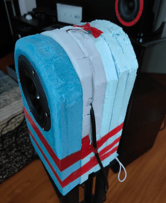

Yes try a half donut of melamine foam. Maybe 1cm depth of melamine, then use other material in the half donut gap between melamine and driver.
Vineeth you could route within one or two of your layer of xps to enable the driver's magnet to go through the hole then created. This way you could approach Mabat's initial gap value.
I'm not sure to be clear in my explanation, so take a look at how Kimmo did with the MTM section:

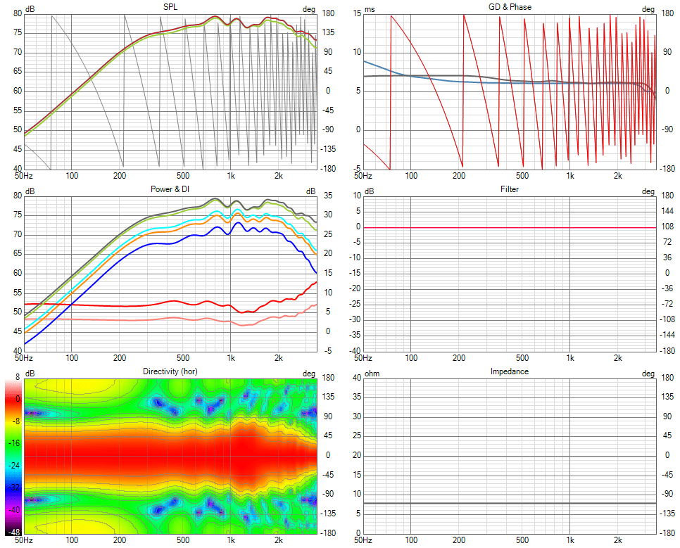

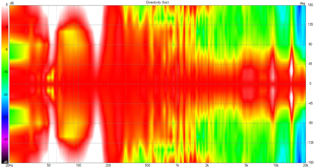

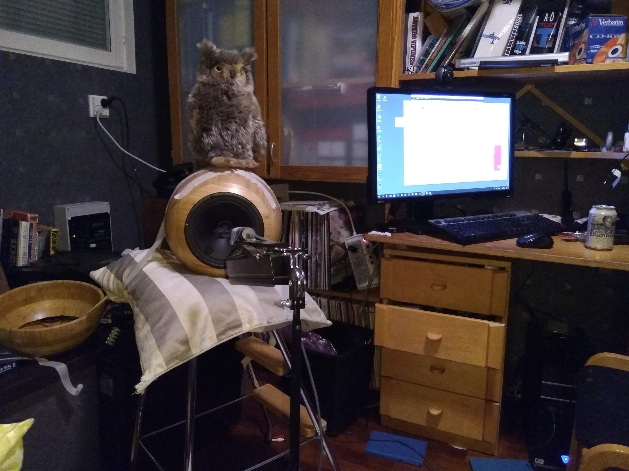

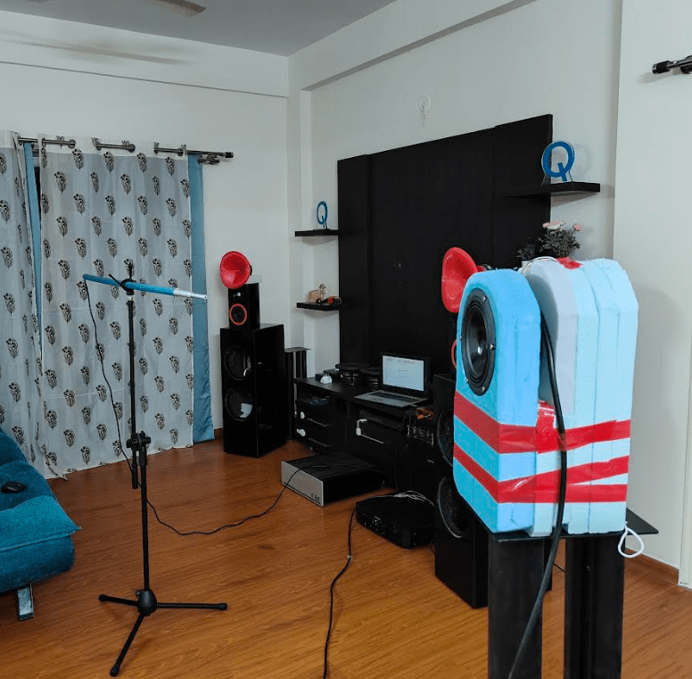

Here are the next round of measurements with damping
My room height is about 290cm. The driver centre and mic height were at 132cm.
I was able to get a window size of about 5.1ms
Measurement set up

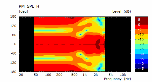

Following are the VituixCAD graphs

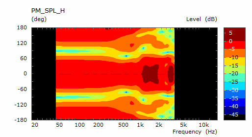

Comparison between ABEC simulations with 16mm damping for which tmuikku gave the impedance data
Measurements I got now with 25mm melamine foam
The latest iteration looks much better than before I think..
I did something very similar to what krivium mentioned. A pad of melamine foam directly behind the driver. A pad of foam below the driver in the slot But the thickness of it was 25mm instead of 16mm. I also thought that 16mm was not much effective at lower frequencies. So 25mm might help there. The other reason was that I was lazy to cut it even finer since the material i have came with that thickness.
Measurement set up

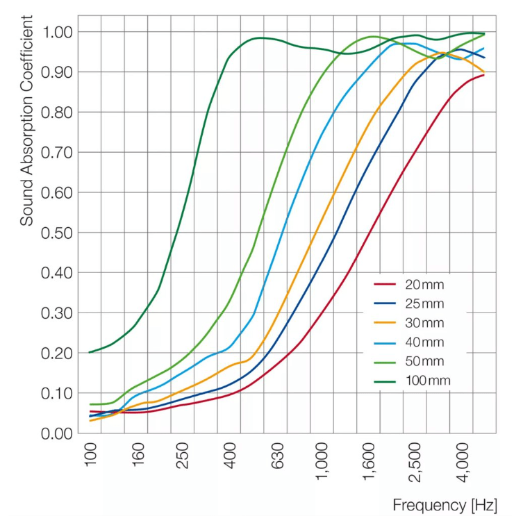

I am using this material for absorption (25mm thick)
https://www.auralexchange.com/product/nankarrow-proflat-4-nos-2ft-x-2ft-basotect-g-melamine-acoustic-foam/#:~:text=Nankarrow ProFlat™ acoustic foam,and ensures a quiet surrounding.
It is supposed to be Basotect G+ I think. They give the following graph on the page:
From the above graph, I think the absorption properties of the material is pretty bad below 1.5kHz..

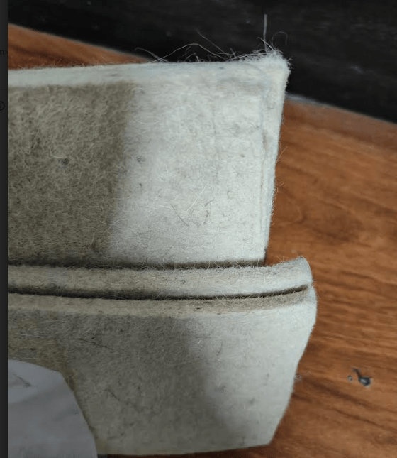

I have some sheep wool material with me that is sort of pressed into sheets. Each sheet is 10mm thick.
I don't know if this will be better at damping than the melamine foam.

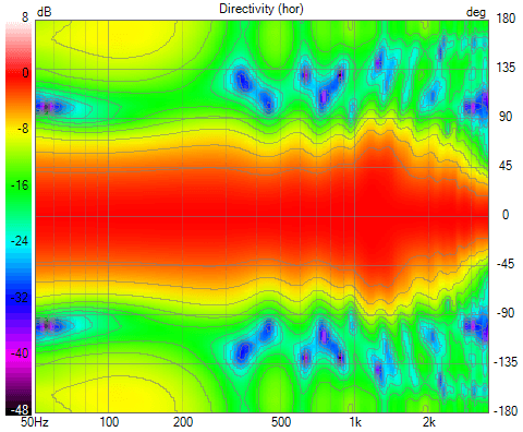

The simulations with 16mm melamine foam doesn't inspire much confidence regarding increasing the depth of the 'box'

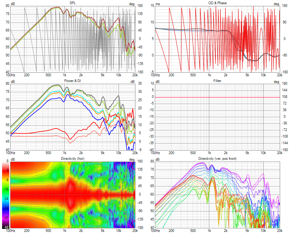

Here is the polars with above damping material on a 300mm deep enclosure:
Same measurement with 170mm deep enclosure that I currently have:
There are only marginal differences and that too around 500 Hz to 1kHz.
So I probably have to manage things with the slot area & damping.
Now comparison between enlcosure of depth 170mm above damping material used in a 30mm deep slot vs 50mm deep slot (that I currently have)
30mm deep slot
50mm deep slot
Again, only marginal differences in the 500Hz to 1kHz region I think.
30mm deep slot
50mm deep slot
So that sort of narrows down my option to filling the slot with some damping material I think

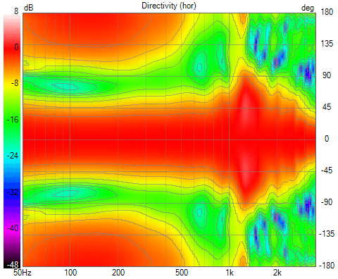

Seems like we are there at a fully cardioid response..
Fully "filled" slot with melamine foam (2 x 25mm thick pieces filling the slot between baffle and the backside of enclosure)
VituixCAD responses:
The pic of the day
PS: There is some vibration of the entire measurement assembly & the prottoype at a very narrow frequency range. I could hear this while measuring. That resonance's impact might be there somewhere in the frequency responses.
It would go away with a proper construction I think...
Very exciting results though..
The pic of the day

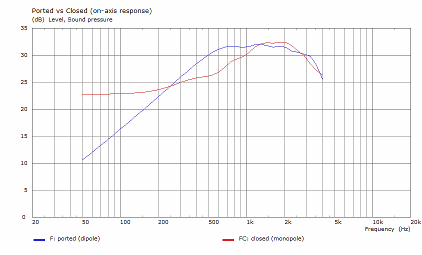

Passive cardioid with attenuated side slots was one of kimmosto's challenges about 10-15 years ago. Baffle width, internal panels, slots' dimensions and damping all are important variables. D&D developer keysir reported his experiments here at diyaudio.
Lowest bass has same loss as dipole, as we can see in Vineeth's measurements happening below 500Hz. A coaxial unit seems to do pretty well in matching patterns! Just add bass unit below 200Hz.
Here is my SEAS MR18 in IKEA Blanda bowl ball with backside opening, eq'd and without bass module. https://www.diyaudio.com/community/threads/seas-mr18-3-way.322839/
