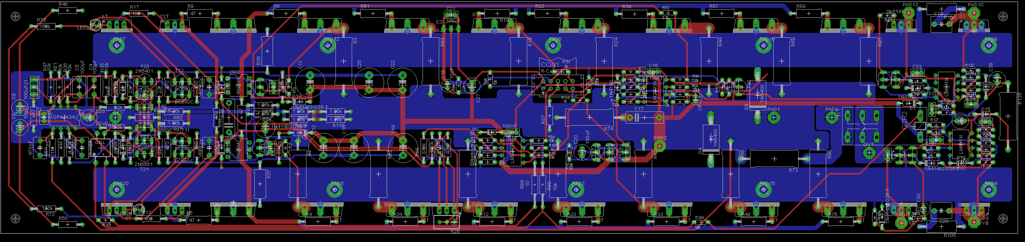

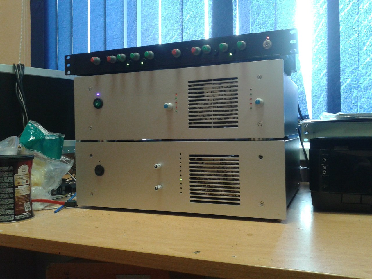

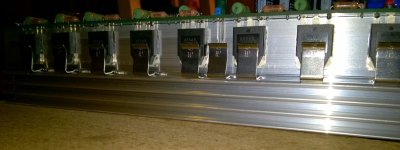

Discussed device. 4kW.
Are there any internal details available?

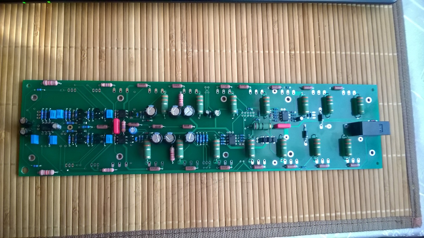

AB class prototype pcb. I hope that i can test it on next week...

Nice job!AB class prototype pcb. I hope that i can test it on next week...
Sajti
Waiting for results.
thank you!
It was a lot of work to put together. The board including:
balanced to unbalanced konverter
dc servo
cfa topology power amplifier, with 7 pairs of output devices
real clip detector with limiter
v/i limiter, which optocoupled to trigger the output relay (retry to start the amp in 4sec)
thermal shut down at 95C (restart at 85C)

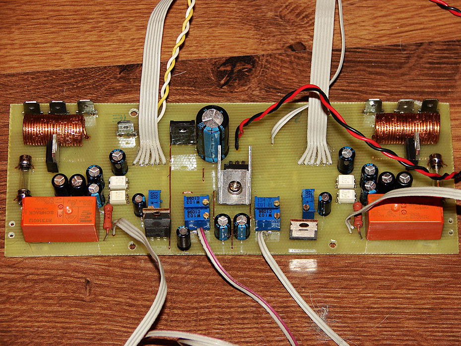

Sajti, looks nice !

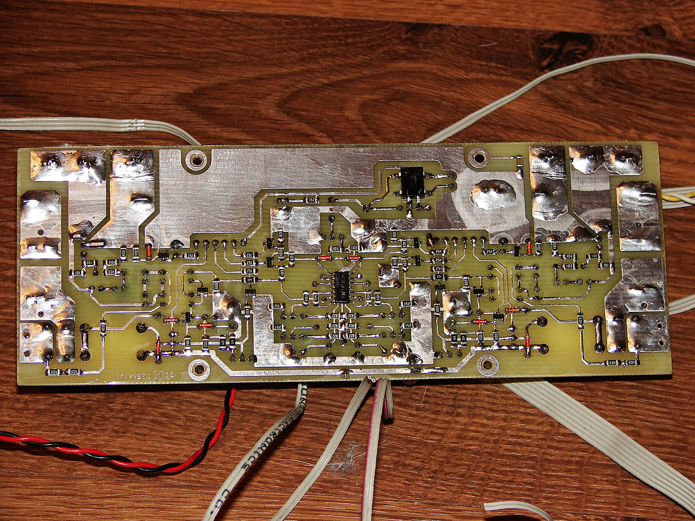

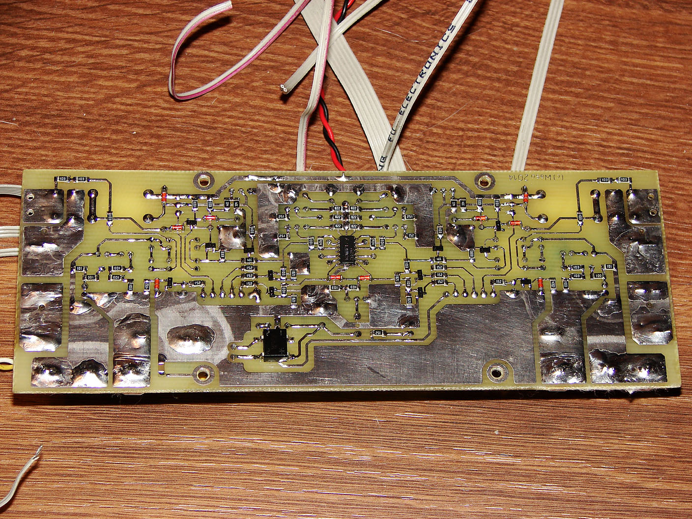

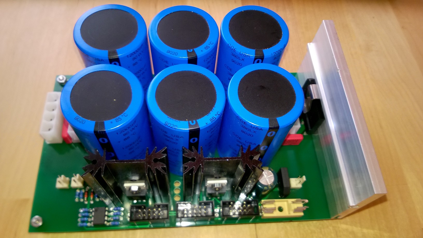

My protection system on SMD details. Board coated with acrylic lacquer from moisture.
Sajti, looks nice !
It's a good idea. Is it same, as the protection You show at the beginning of the topic?
Sajti
Yes. On SMD it's smaller.
Yes, I compared it to the first version 🙂 I did a lot of work, to integrate the protection to the amplifier board....

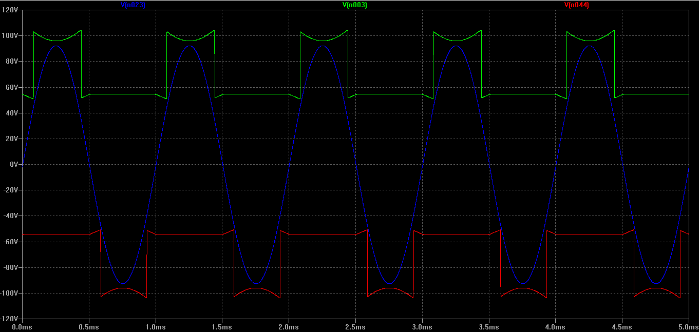

- 900W Class H Power Amplifier
