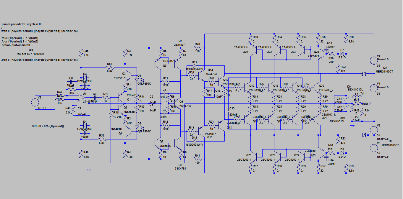

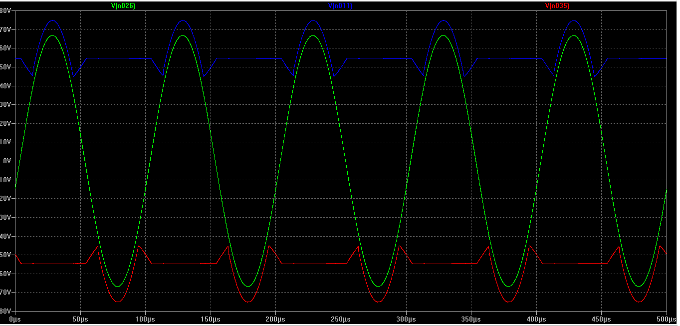

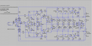

Modulated rail version under simulation. The schematic, and the output waveforms.

quick consult

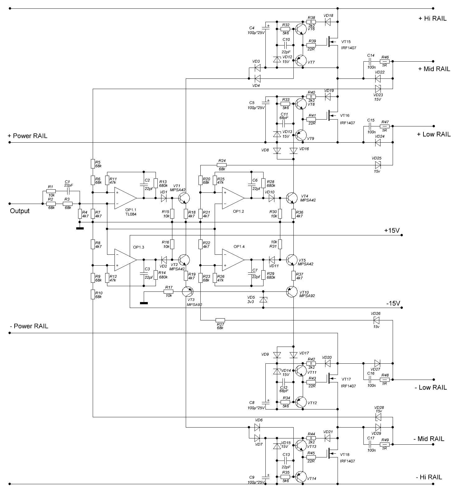

hi waso .! i have failed to register in the russian vegelab forum .
i wanted to use irfz44 or irf1010 n channel mosfets only without complimentary . will this circuit work the one you posted using 3 steps using only tlo84??
can replace lm339 directly without any modifications . on 3tier class h +/-45,90,135 in the above schematic ??
