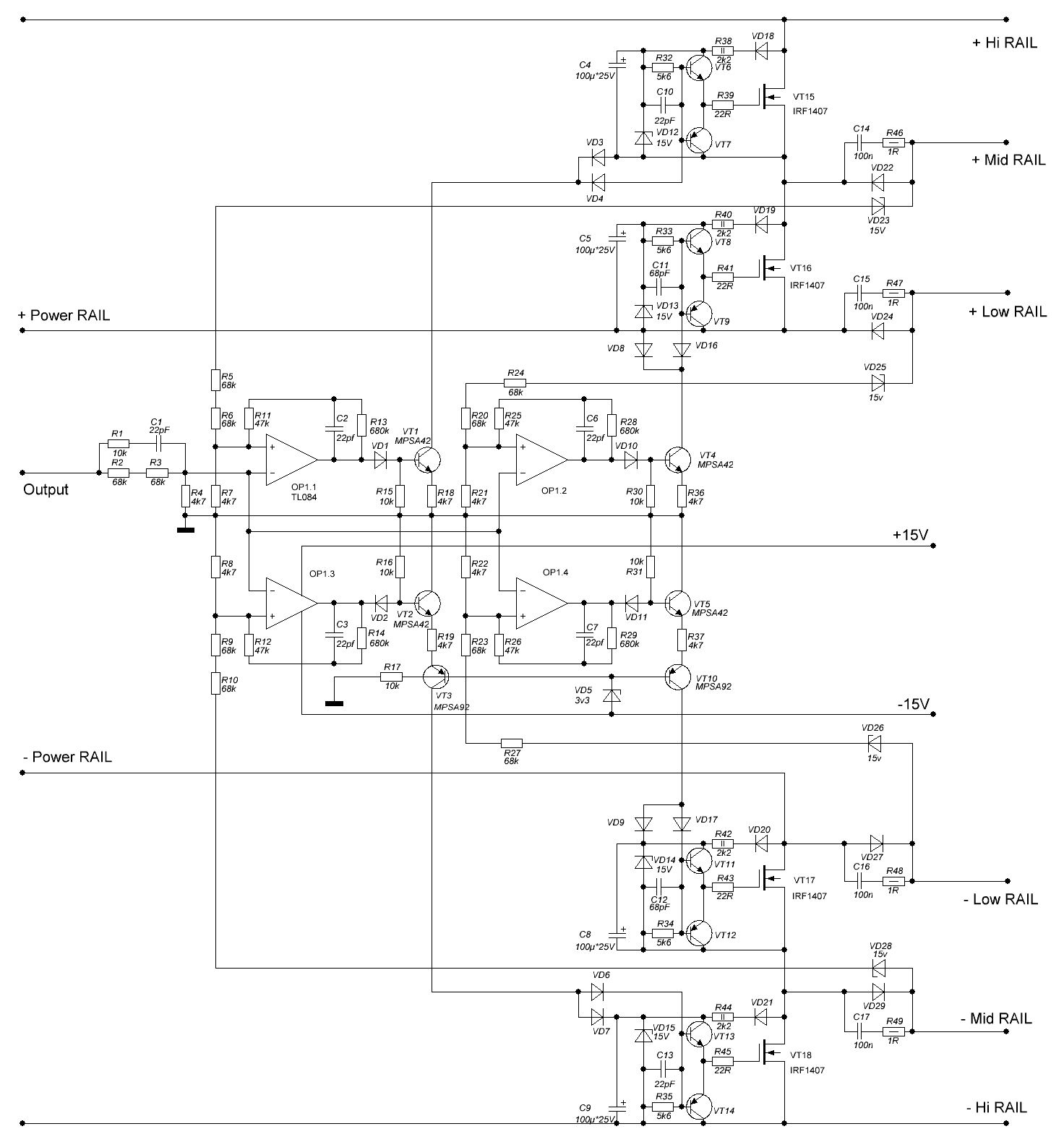

i am going to use the below scheme by waso

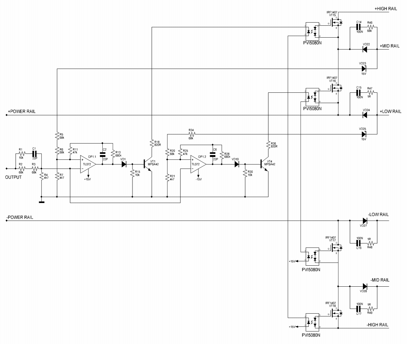

i convert it to photovoltaic isolator base on waso schematic.. will it work?
No. It will kill Your amplifier. The basic idea can be interesting anyway...
Sajti
hi sajti, can you explane why it will kill the amp
Because it turns ON the +HIGH rail, and the -High rail same time.

If you're not going to use true comparators, the right op amp to use is the TL072/4. Or LF353/347, basically the same thing. Slew rate is high enough to make sure the FET can get full gate voltage in under 1 us, and you can drive them outside their rails without killing them. This will happen - maybe not in "normal" operation, but in abuse, square wave testing, or just driving them into slew limit - and certainly during the development phase getting the bugs out of the PCB.
Sajti
you are right sajti.. forgot to consider the negative swing.. cheers!!

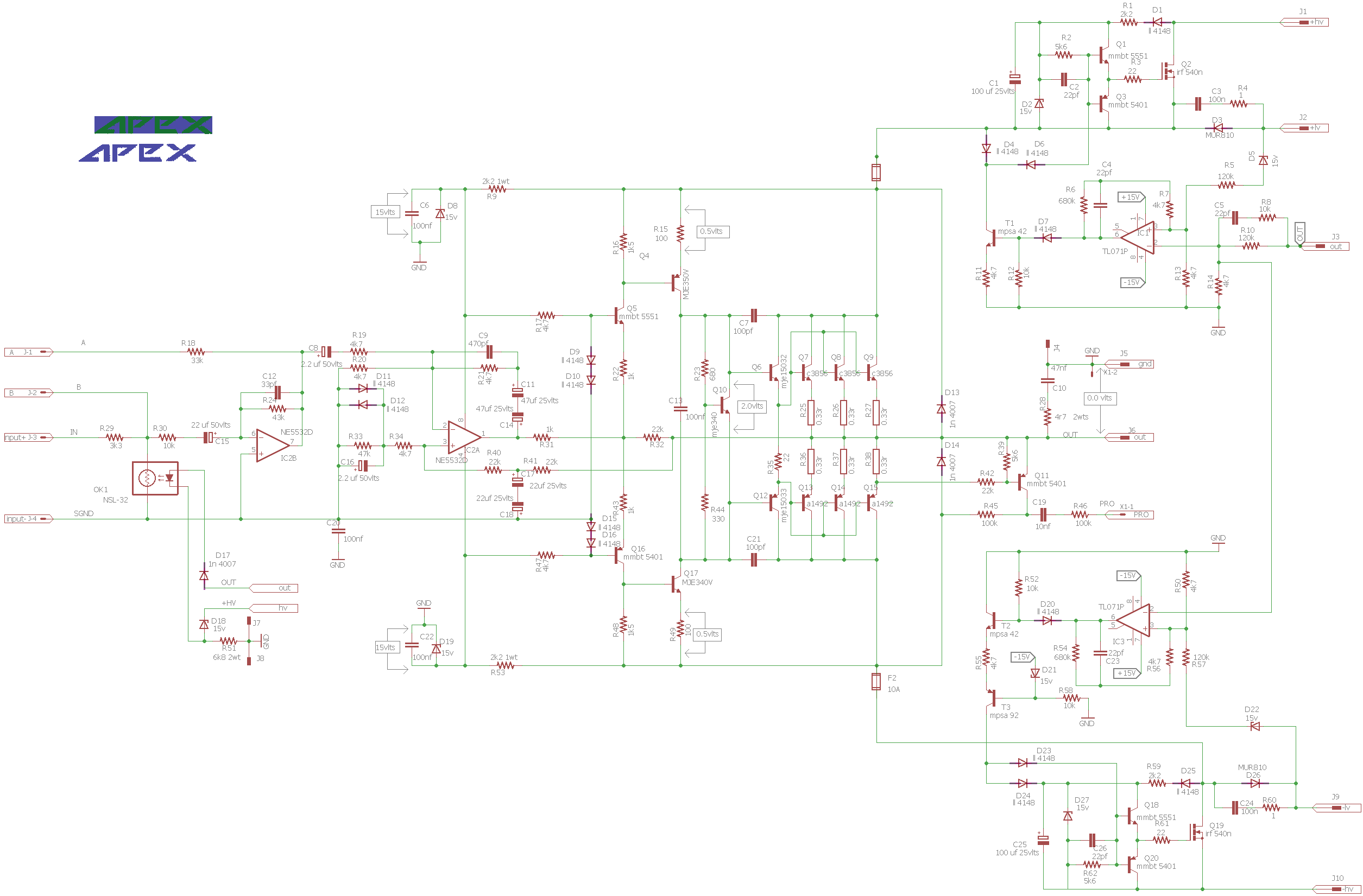

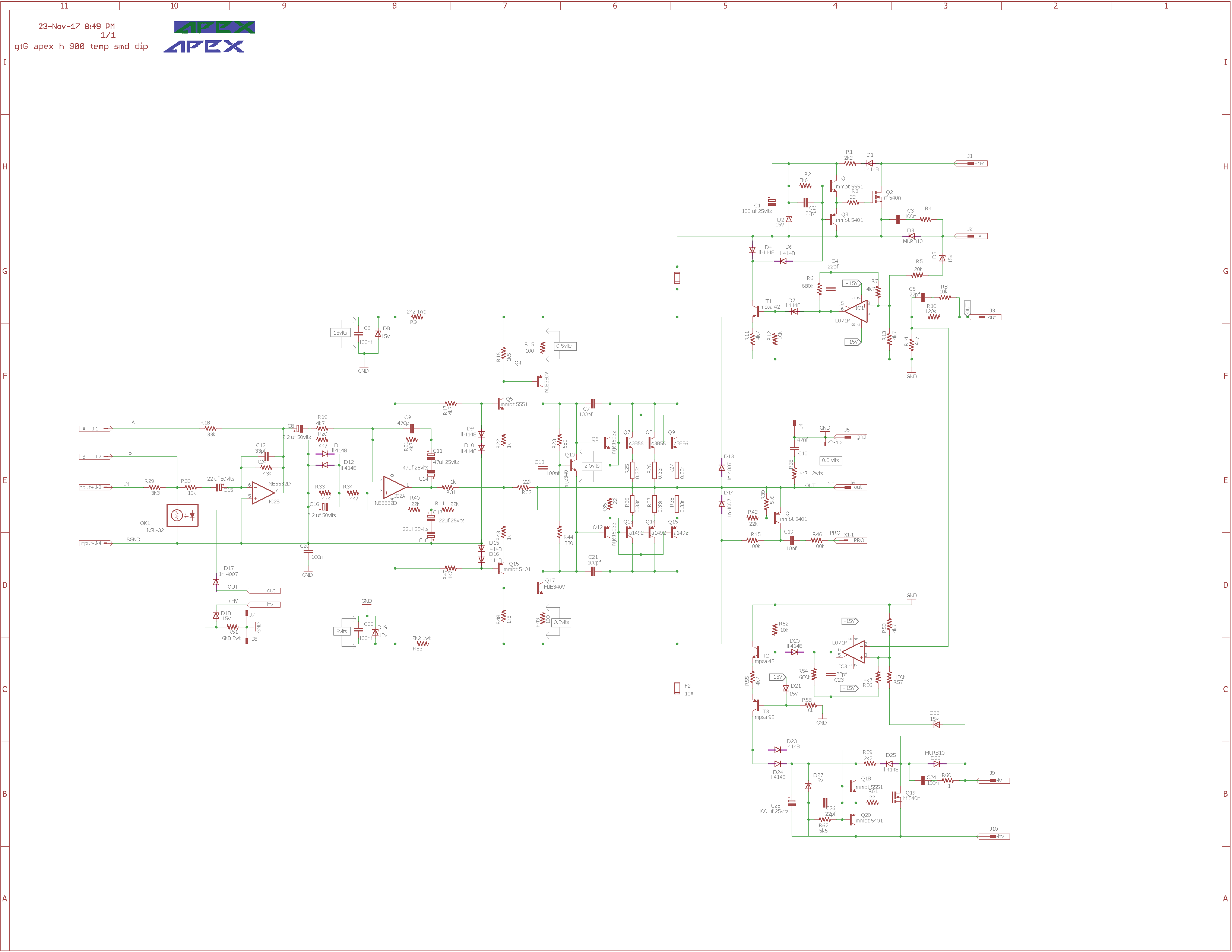

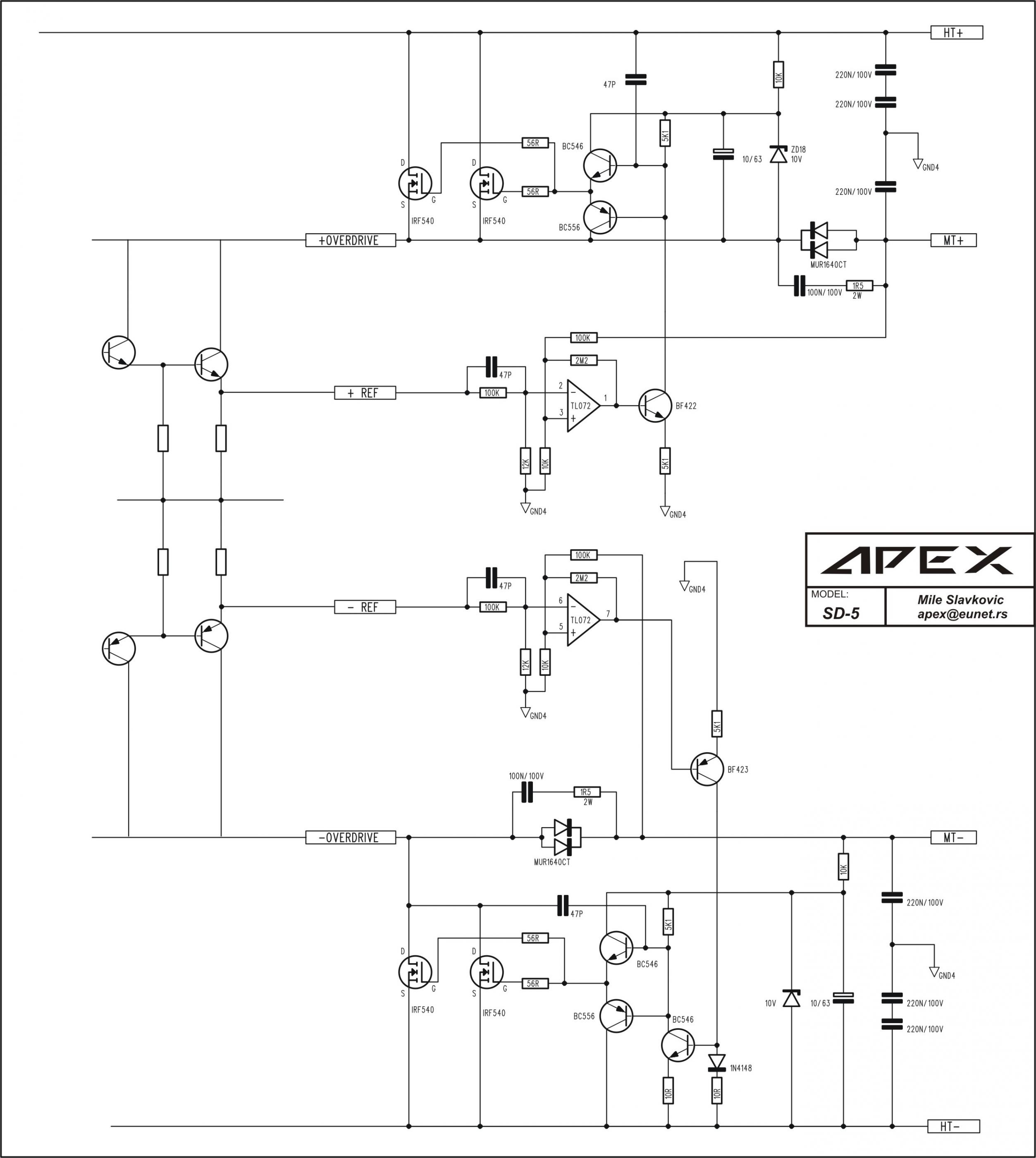

2 tier based on waso step up and apex vas input . please check for errors three tier based on the above tech loading...............😀😉

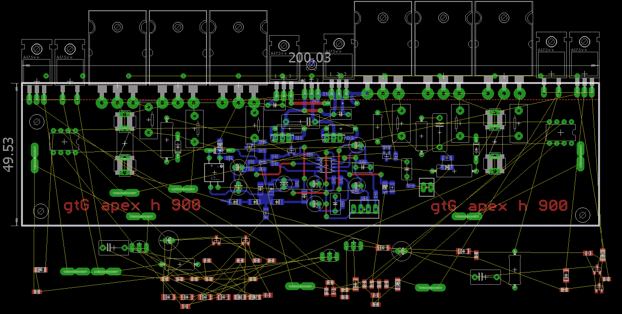

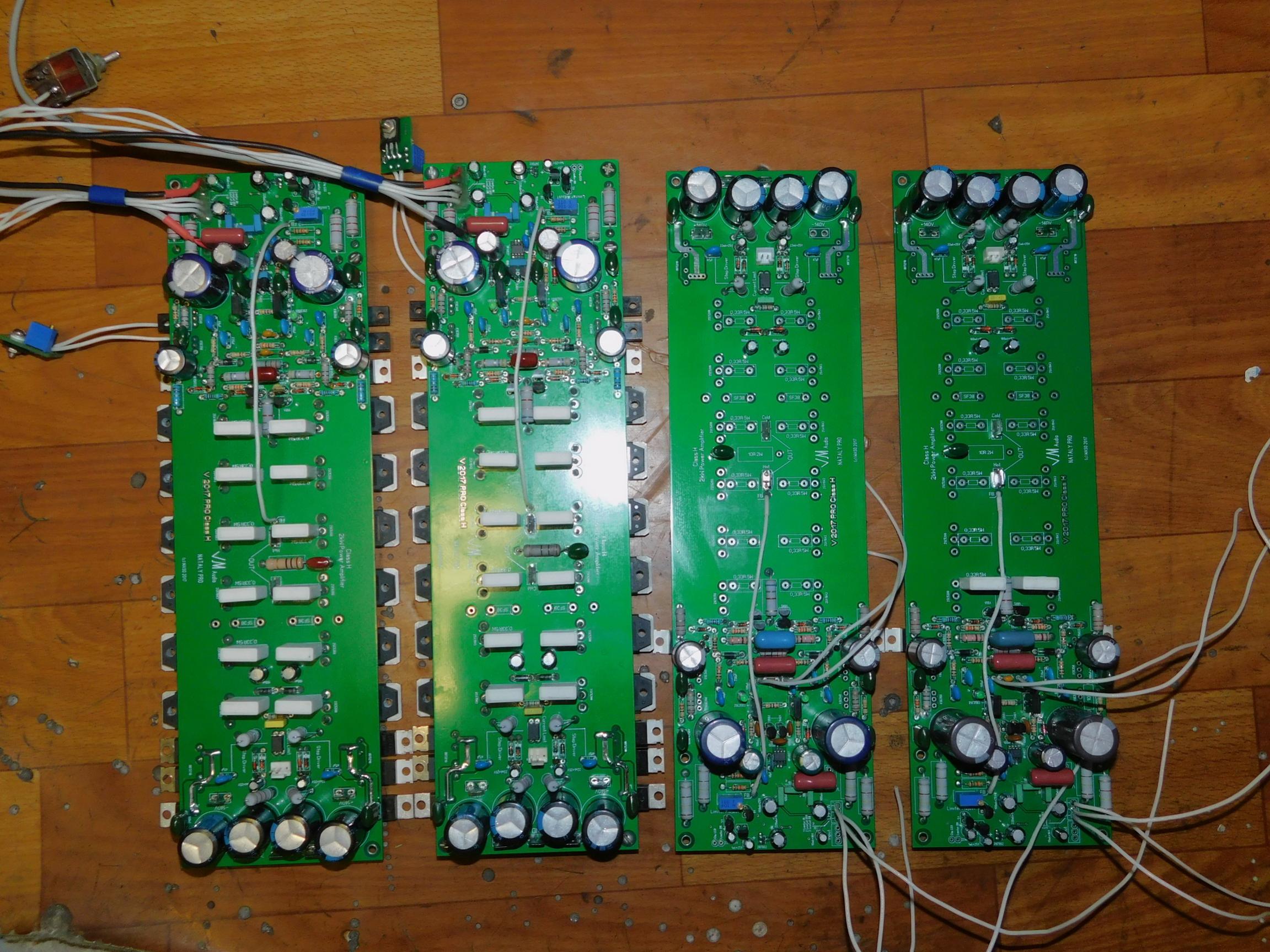

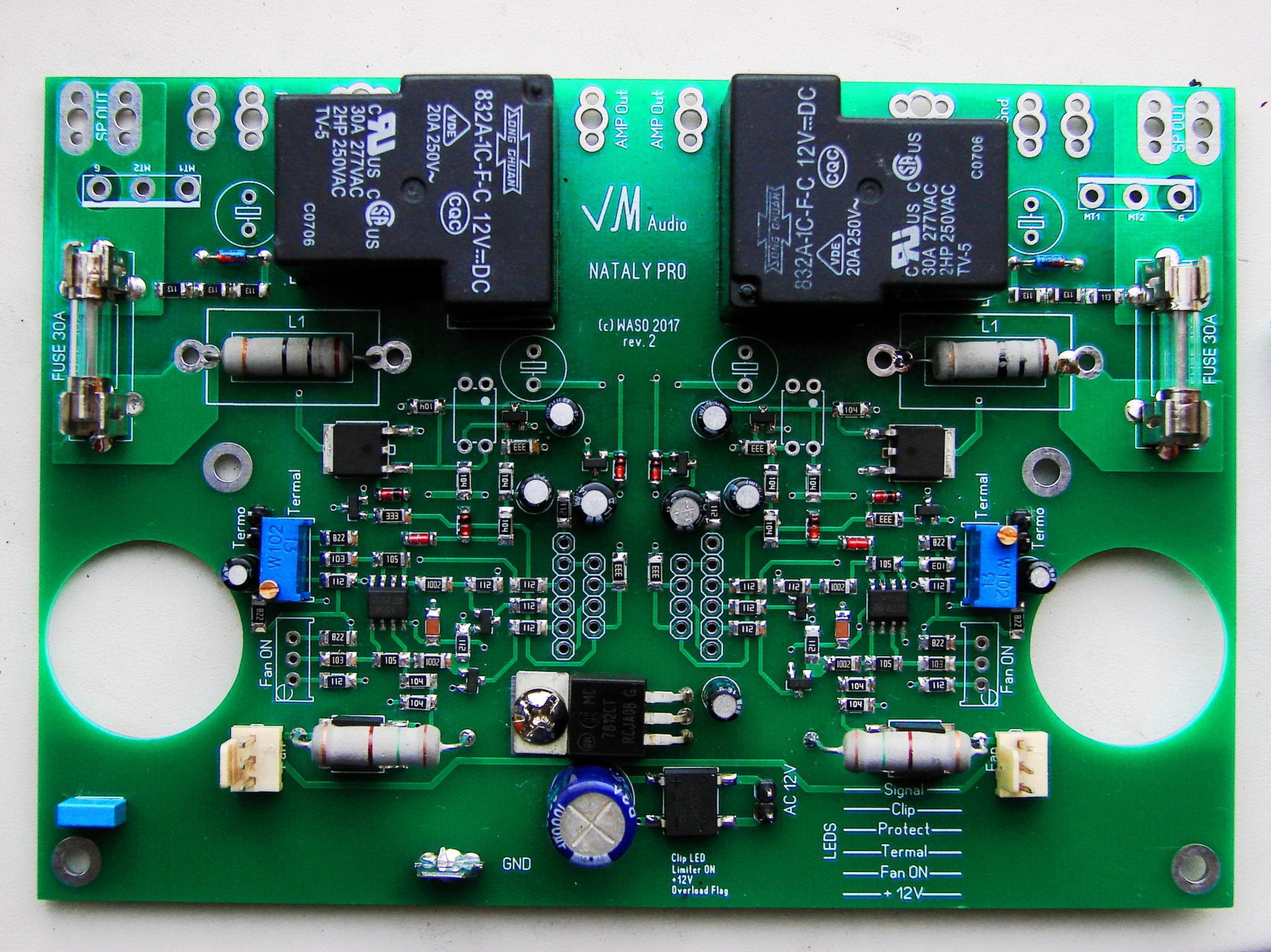

hello mr. satji ...The pcb of the modulated rail version. Version 1.0. Still need to check once again...
Sajti
best regards for you and your family

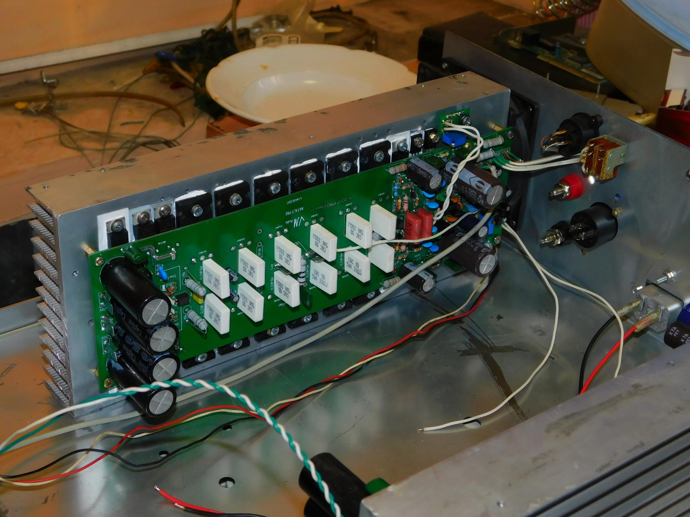

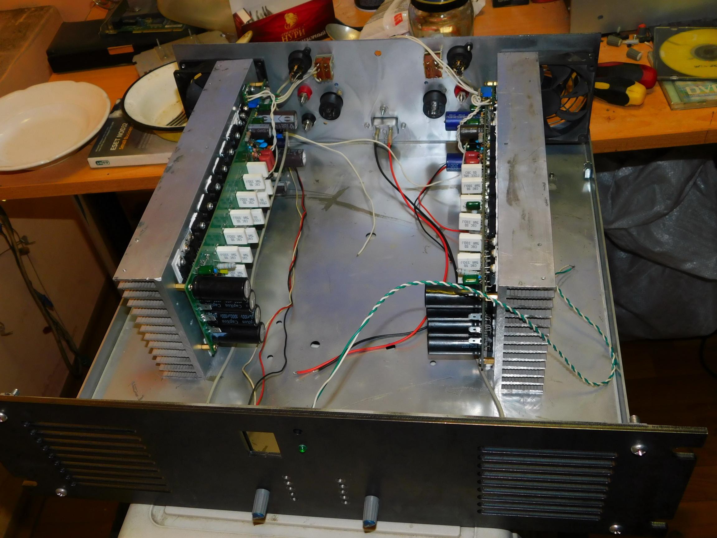

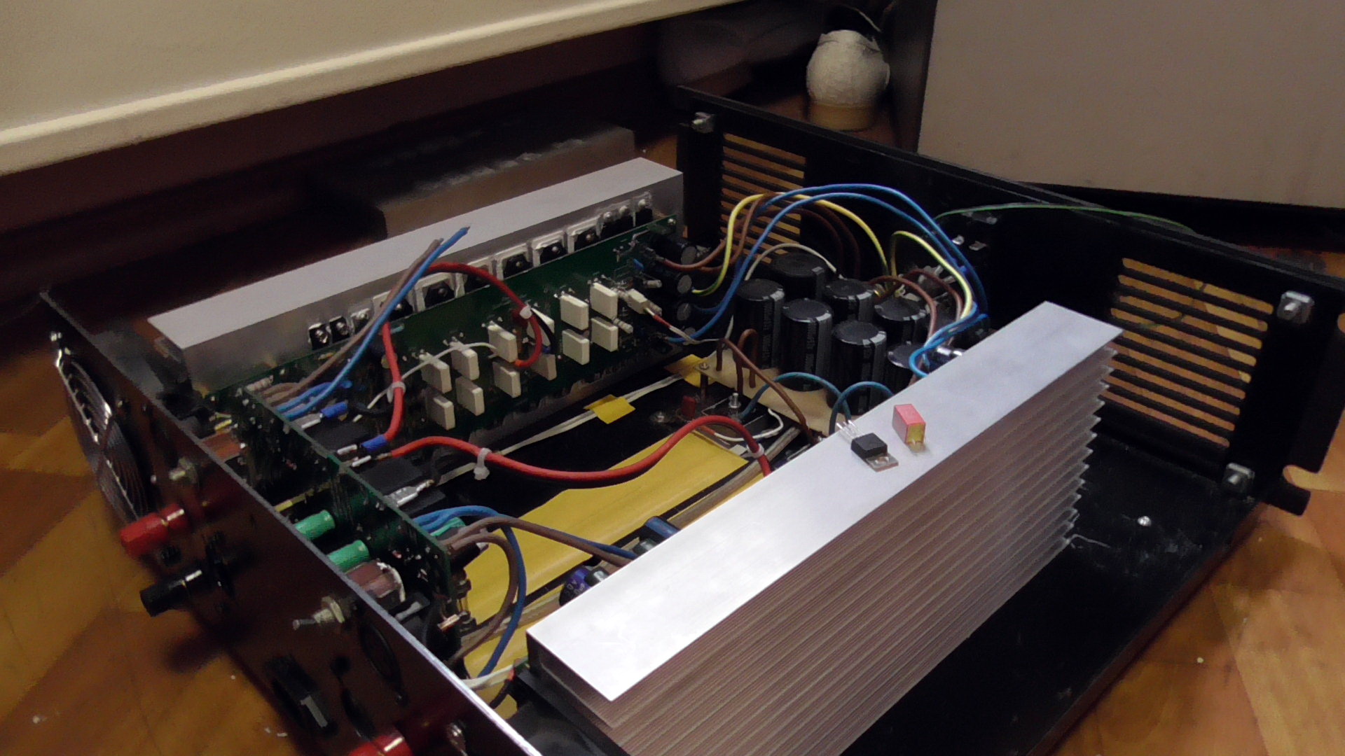

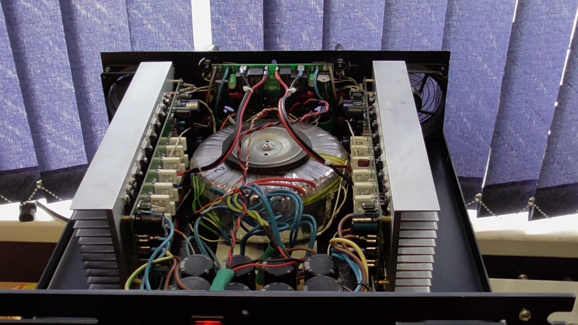

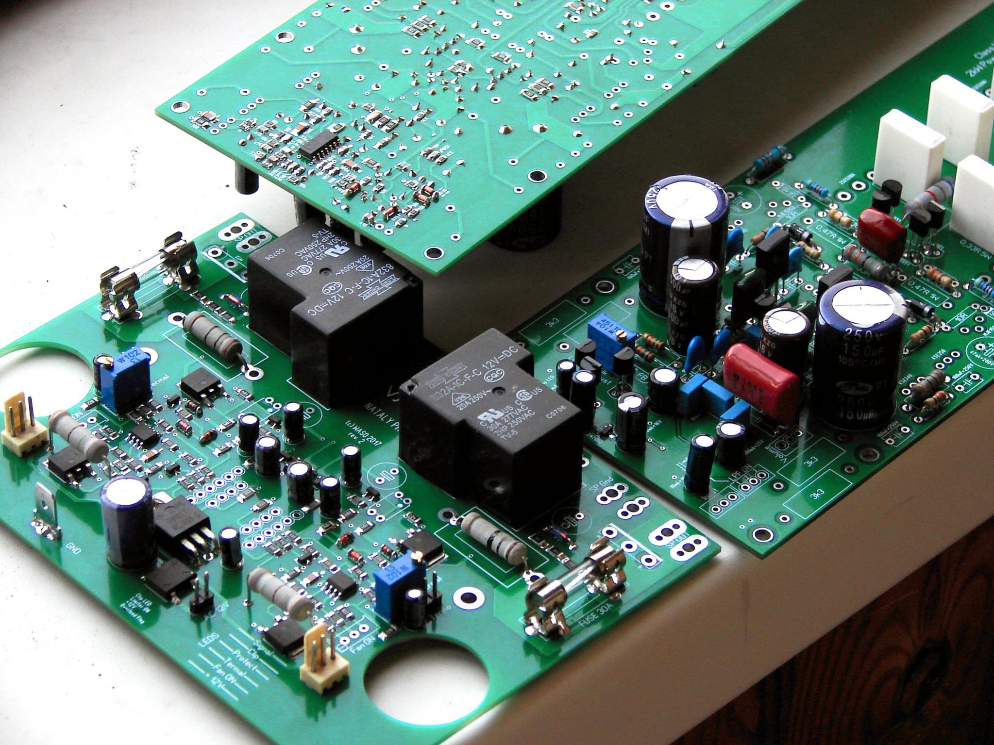

Hello Waso, I'm interested and I liked your project. I intend to install it inside a subwoofer box, so I want to build an active subwoofer. Can the amplifier handle the work of a professional sound, for events?
Of course, my amp can work for PRO sound. But for subwoofers i don't see the point of using a Class H amplifier today when there is a class D. This is significantly less heated.
For full-range speakers it works nice.
