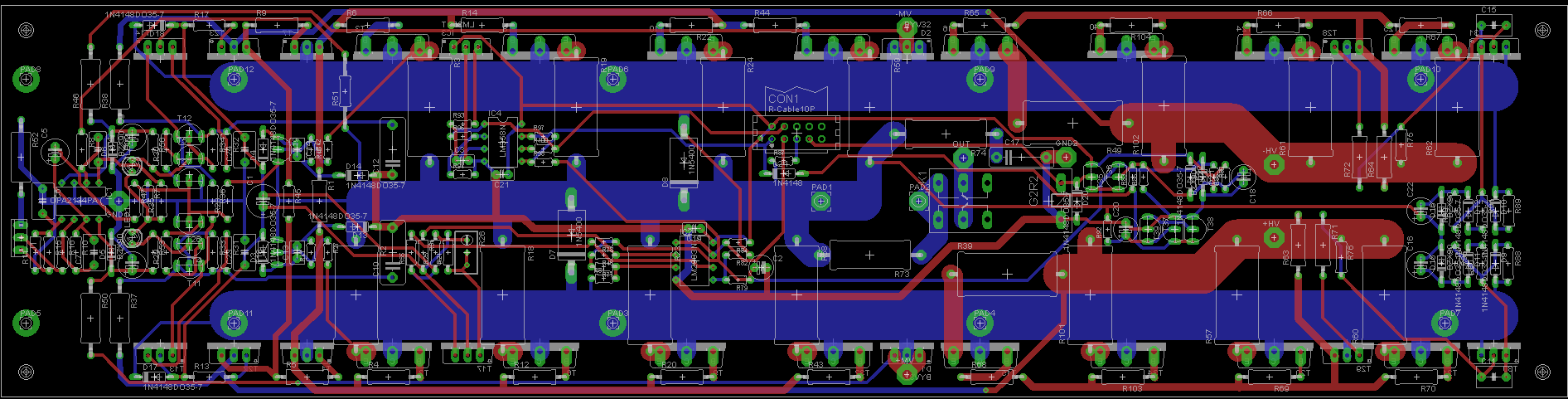

hi waso cool stuff
my 900h version based on apex design
http://www.diyaudio.com/forums/solid-state/162408-900w-h-class-pa-amp-limiter-315.html
very nice design
Thanks! Single board design, including the input, the protection, clip detector, temperature sensor, turn on delay.
expected output power 800-900W depending by the power supply.
