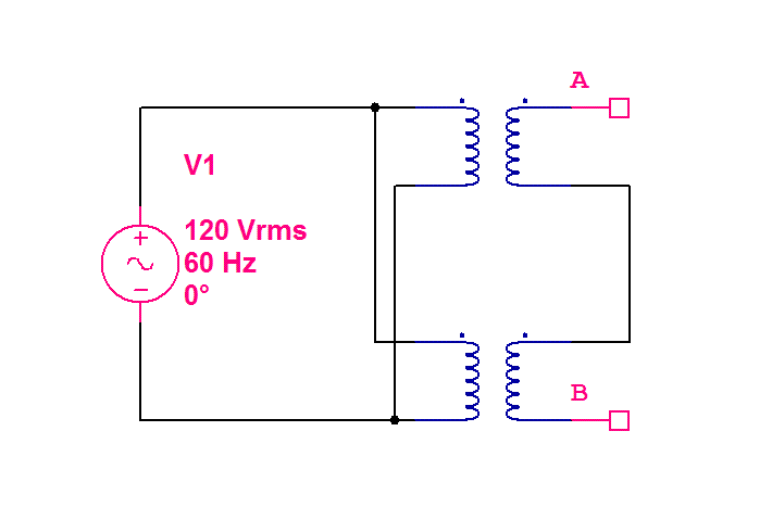

You should already know this:
To determine phase:
Connect one each of the secondaries together. Measure the voltage across A-B (in attached graphic).

krazatchu said:
MJL21193: I figured that would do, however if I connected them wrong, I was thinking it might pop the breaker...
With the magnetic field cancelling out... it would appear as a short, wouldn't it?
Connecting as illustrated will not trip the breaker as the two secondaries are not completely connected together. Measuring across the A/B wires will give one of two possible results: double the single transformer voltage or ~0 volts.
This for future reference if you are not using two transformers.

The toroid has 3 windings ...
Primary is labeled (0,220) ...
The secondaries are labeled (0,50) and (0,50) ...
I'm hoping the secondaries are set up 180 out of phase of each other ...
Same test as before to determine phase. This time connect together two of the toroids leads, and measure across the other two.
This transformer will provide +/-70 VDC. Amp will provide ~500 watts into 4 ohms. (I have a subwoofer amp with this voltage power supply)
- ~700w ampifier
