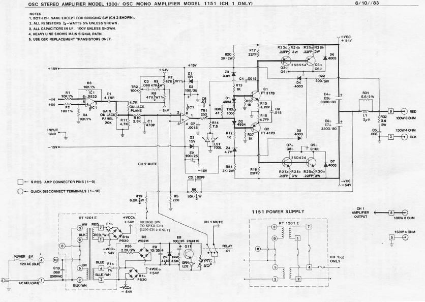

The cascode is the same idea as the Leach superamp. With 20 outputs per channel, a full 105CFM 4.5" fan and two feet of heatsink per channel there's enough SOA to drive a pair of lab horns 6dB into clip on peaks all night. If the plug doesn't melt off the extension cord It's failrly easily converted to class G (not H) by replacing the lower bias resistors for the slave banks with a zener and boot strapping the upper resistor to make a CCS. Then add the necessary commutation and steering diodes and the lower voltage supply. THAT's not a project for a first-timer, however.

The power transformer needs to be a low-leakage type. The QSC has a screen over the primary, and another between the two secondaries.
An inexpensive split-bobbin E&I type works quite well. For inexpensive toroids I would recommend one per channel.
I would recommend building a small one for evaluation purposes to see if it is good enough for your hi-fi needs. One pair of outputs on ±40V would be easy enough to do. The basic drive circuit may be re-used with more outputs as desired.
A class G output stage, QSC style:
http://www.qsc.com/support/library/schems/Discontinued/MX Series/MX2000.pdf
Note that the cases of all the outputs are still grounded.
Also note that this current limiting scheme does not sound good.

I like the looks of this amp design djk.
Since the cases (collectors) of the outputs are grounded, that means they do not have to be insulated from the heatsink, and the heatsink can be bolted straight to the case?
Also, you say one pair of outputs (as the schematic shows) will run on +/-40vdc. How many pairs would be required for +/-60vdc operation? I'm guessing three pairs?

I prefer to use a seperate supply.
Using zeners from the main rails requires extra diodes and resistors from the signal output node of the amplifier to the zeners to provide the low voltage supply when approaching full output .
It's easy to add the extra low voltage windings to a toroid, many come with them.
These show up on eBay with a BIN of $70 + $10 ship (USA).
http://toroid-transformer.com/AN-8458.pdf
"How many pairs would be required for +/-60vdc operation? I'm guessing three pairs?"
Yes, I would probably use three pair to allow for low impedance loads.
"Since the cases (collectors) of the outputs are grounded, that means they do not have to be insulated from the heatsink, and the heatsink can be bolted straight to the case?"
You can, but don't think you can get away with not running a big buss wire to all the outputs and the speaker ground terminals. I used inexpensive stamped heatsinks mounted direct to the PC board with a fan.

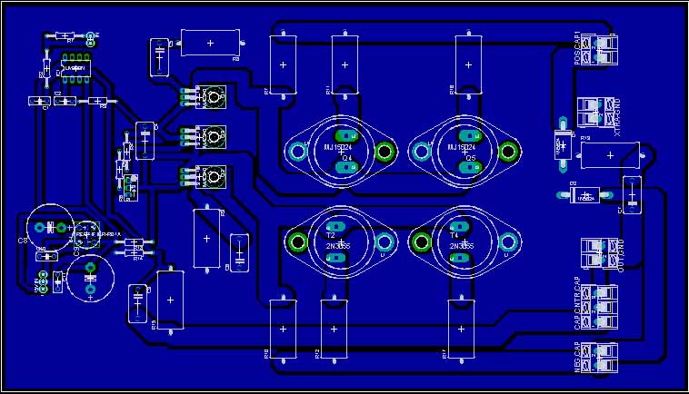

Hi~
Thought I'd do layout with eagle...
Forgot the voltage regulators.. and I'm not sure about the heatsink yet...
So I will have to make numerous changes...
Some of the parts weren't in eagle so I sub'd a few things...
Well, here it is so far....

how do you connect the To3 output devices to the heatsink without the heatsink touching/shorting all the other soldered pins on the back of the PCB?
To247/264 would be much easier to implement, particularly if the devices are near the PCB edge.

"1) What is (x3) on R13, is that 3x 15ohm resistors in series for a total of 45 ohms...
Or is it 3x 5ohm resistors for a total of 15ohms... ??"
R13 is about 5 ohms (3x15R) . It needs to be noninductive and the power rating proportional to the ±rails of the amplifier. 3x 3W may not be enough for sustained use at high frequency.
"2) I'm assuming for my purposes (200watts) I should double the output, so 2x mj21193 and 2x mj21194... "
For sustained use at high frequency the design should be de-rated, I would use at least four pair.
"3) Other than caps c7 and c8, is there a general voltage rating for the rest of the caps?"
C8 and C9 are the power supply caps, and actually represent the transformer, rectifiers, and filtercaps (with bypass caps). The center tap of the transformer is the speaker output.
C3 and C9 need to be rated at at least 250V, in your case I would use 400V.
I would probably consider some form of resonant drive, paralleling the piezo with an inductor.
"4) Regarding themal stability... And since q1, q2 and q5 are TO-220 package, whereas q3 and q4 are TO-3 package... Should they all be on 1 heatsink..."
Yes. For your use I would turn down the bias to about 340mV across R7 and R10 (optimal class B bias).
I would probably not use this design for your application.
I will try and draw up something more suitable for your use this weekend, it will be even simpler and use one IRF hex-fet for the output.

krazatchu said:Hi again~~
Please excuse me for being a newb... I have loads of questions, I tried to simulate the design but it didn't go well...
Anyhow... I'll play with the simulator and see if I can get it working right....
My questions are....
4) Regarding themal stability... And since q1, q2 and q5 are TO-220 package, whereas q3 and q4 are TO-3 package... Should they all be on 1 heatsink... or can I put the TO-220's on one, and the TO-3's on another?
If they have to go on the same heatsink, I could machine something, I have a CNC mill at my disposal..
Thanks, And sorry for asking so many question 🙂
Michael
