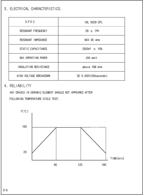

ESR would be the impedance at resonance, wouldn't it?
The data sheet says this is 30 ohms max.
The static capacitance is labeled on the transducer,
It says 2.620pF.. this must be wrong, it should be 2.620nF... the pf is part of the label and the number is written... the data sheet says 2500pf...
I will keep in mind the Crest amp, if this doesn't work out, I may take you up on that offer~~
Attached is the data sheet for the transducer...

You need to measure the transducer on a bridge and find out how much C and series R it looks like.

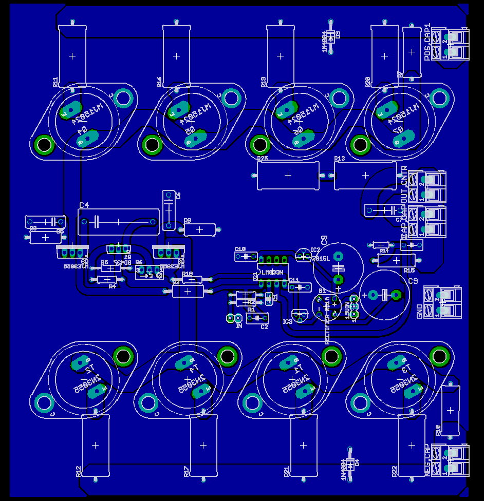

I did a little work on the layout...
All the transistors are on the copper side...
I'll use two heatsinks, suspended by bolts and use a nut for a spacer to keep the heatsink off the copper...
The to-220 and to-126 transistors will fit between the heatsinks, and will be bolted to one side...
I didn't have a footprint in the eagle library for the output resistor, but I left enough space using two resistors to make it fit...
Can anyone see any problems with this layout?
