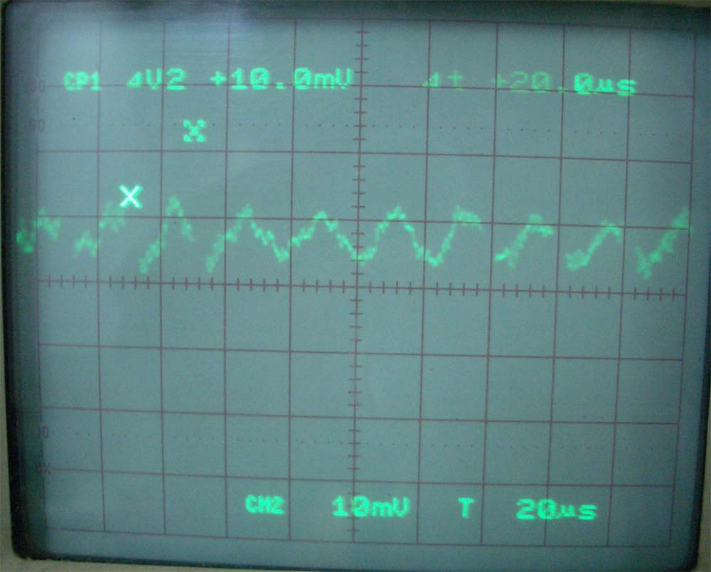

Here is the output pic....
It seems to decrease as I bias into A... about half the amplitude...
I'm assuming it's A, the dim bulb gets brighter which would indicate more power consumption and hence class A, right?
It seems the oscillation is still there with the power off...

Lid makes no differnce...
It's about half when it's turn off..

krazatchu said:Here is the output pic....
Thanks!!
Then it's just the lack of electrostatic shielding. 😀 Oscillation at 40kHz would be a bit unexpected. It's probably coming frome some switching power supply somewhere. It could be the computer.
I'd follow djk's advice on biasing:
"For your use I would turn down the bias to about 340mV across R7 and R10 (optimal class B bias)."
Gives class AB+B and low dissipation. Unless sound quality is important for ultrasonic welding. 😉
After adding chassis gnd and tiding wires, no noticible change...
Shorting input cuts amplitude in half and causes a negative offset of about -15 mV..
As its occuring with the power is off it seems to be coming in thru the gnd...
