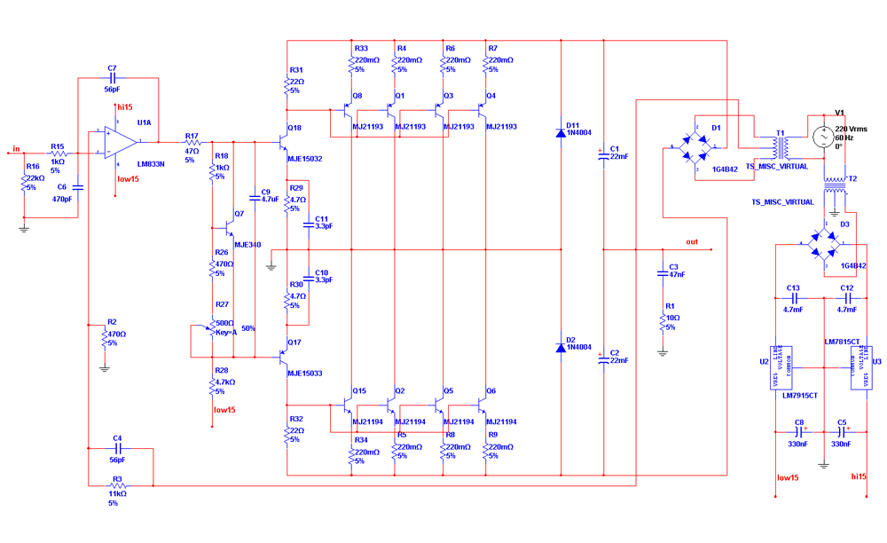

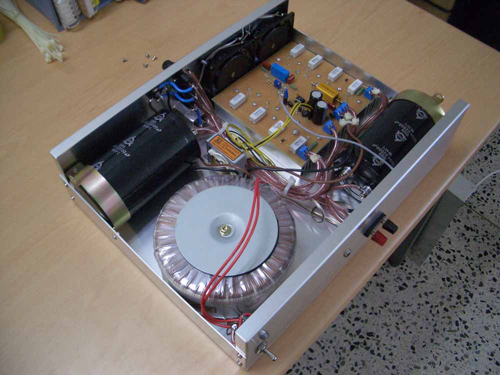

krazatchu said:Here is the whole schematic...
Only thing missing is power switch, power light, fans and fuses...
Sorry it's a little squished...
If you really have only a 330 nF (film?) cap from the regulator outputs to ground, that is a problem. The datasheet says that a larger cap (with higher ESR) is required there, for stability. (Maybe one of them 'oscillated to death'. 🙂
The output cap should also be as close to the regulator pins as possible, or soldered directly to the pins.
They suggest a minimum 25 uF aluminum electrolytic (or, 10 uF in another part of the datasheet), OR, a minimum 1 uF if using solid tantalum.
Note, too, that if you use around 100 uF or more on the output, you would then want to add a high-current protection diode across the input and output pins.
I would probably keep the regulator output caps fairly small (e.g. 33 uF to 47 uF aluminum electrolytics), to try to make sure that the opamp gets powered-up before its inputs become active.
Also, as someone else suggested, the TO-220 versions of the regulators would probably be much more reliable.
And, I'm not sure, offhand, if this applies to fixed-voltage regulators. But, with adjustable regulators, you would always want to run the conductor for whatever is connected to the regulator's reference pin (ADJ pin, but GND pin for the fixed regs) to the load SEPARATELY from the main ground for that dual supply, so that the opamp's return currents, which cause dynamic voltage drops across the ground trace's parasitic impedance, wouldn't create a 'bouncing' reference point for the regulator.
If you did use adjustable regulators, you could also bypass the adjust pins' resistors and get much quieter power supply rails.
P.S. If that is a bypass cap lead showing, near the opamp, in your photo (difficult to tell), you definitely need to fully insert it, so that the leads are as short as possible.
The 330nF caps are polarized tantalum... I had them from an AVR project I did before...
The label says u33, so I'm asusming they are 0.33uF..
I put them as close the the opamp as possible, as that is suggested for microcntrollers...
I guess this rule doesn't apply with analog....
The regs are fixed.. .they are lm79L15 and lm78L15...
I will up the cap values and change the regs to T0-220...
I didn't consider using any special grounding topologies ...
Since I'm just using it for ultrasonic, I'm not too concerned about THD...
edit: you can see one of the caps (yellow, tantalum) by pin8, there is another by pin4 but it's behind the +/-18VAC wires (black and yellow)...
I tried to keep the leads short but I used the wrong footprint, the tantalum caps were an after thought....
Thanks!
Thanks!
Michael
follow the decoupling recommendations in the manufacturer's datasheet. If it needs tweaking after that then make what seem appropriate adjustments.krazatchu said:The 330nF caps are polarized tantalum........I put them as close the the opamp as possible..........I tried to keep the leads short
Similarly add decoupling to the input of the regs. Again most manufacturers tell the users this.
There already is a pair of 4700uF caps on the inputs of the regulators...
I will read the datsheet for specifics...
Thanks,
Michael
Thanks,
Michael
Interesting...
The regs I have are national... So I just checked the datasheet...
LM79L15 T0-92
Under typical applications, fixed output regulator 100mA ...
The output caps are 0.1uF... so the tantalums I have should be ok then...
For the TO-220 package, it recommends 1uF tantric, or 25uF electro...
I will swap the regs to To-220 and change the caps...
An extra cap on the input isn't nesscary according to he datasheet since its less than 3" away...
Thanks!!
LM79L15 T0-92
Thanks!!
