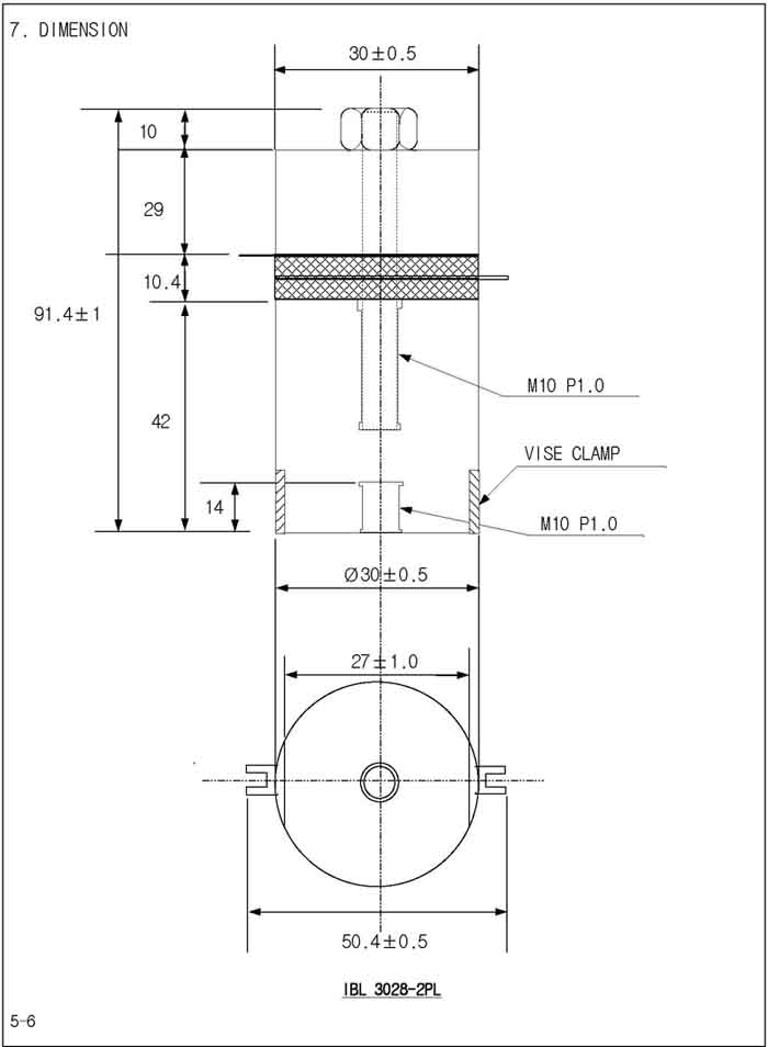

It's a BLT (Bolted Langevin Transducer).... Pzt material is c-203...
It should be driven bi-polar as unipolar may over stress the pzt...
Attached is jpg, material is alu 2024-t6 (aircraft grade)...
There are two pzt donuts (shown by cross hatch), between them is a thin piece of metal for connecting the ac power...
The gnd connects to another thin piece of metal above the donuts or anywhere on the body...
The two halves are bolted and the bolt is insulted from the donuts by a teflon insert...
