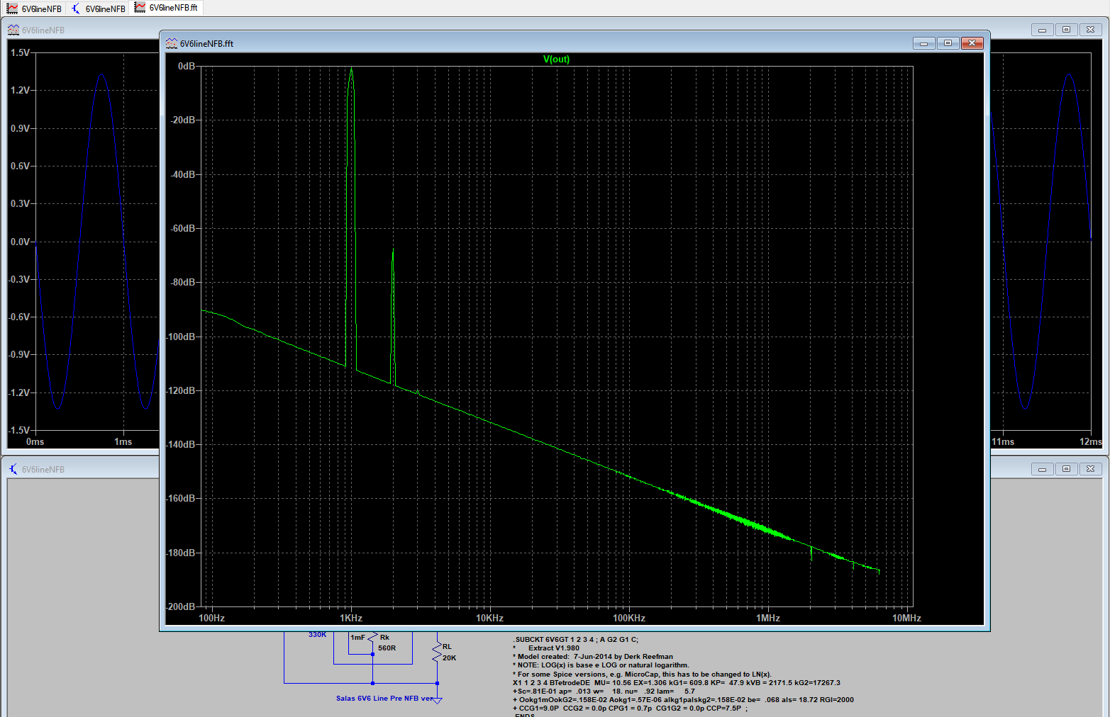

By increasing the B+ to 450V, increasing the Ra to 15k, and then adding plate-grid NFB, I was able to get the 6V6 circuit down to below 0.01% at 1V output, with about 4x gain -- in a simulation, of course.

Keep in mind that some tubes will have bit better or worse THD and hiss. You could see the RCA was different to the Russian tubes in my cathode follower FFTs (#4054 #4055).

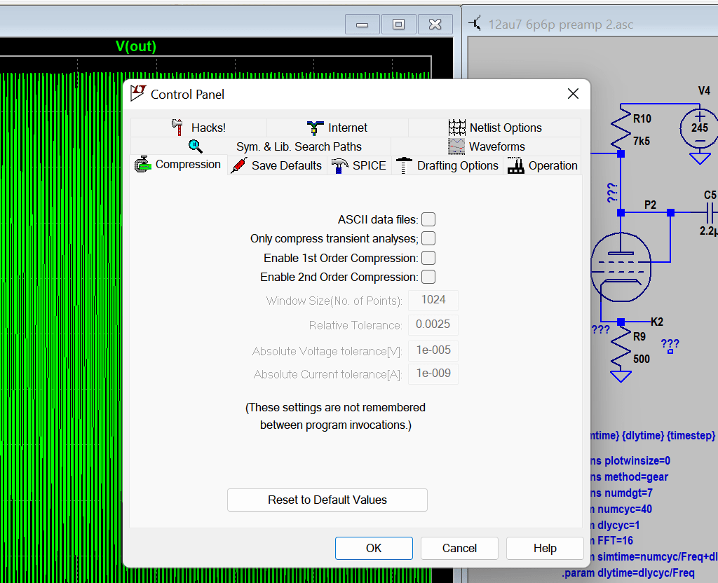

As compression is disable, simulation is slow, use ".save V(out)" command to speed up simulation. Ensure that all compressions are turned off.I settle for these settings, it's about as much details one can hope to see, with Bohman Windows.
Code:.tran 0 {simtime} {dlytime} {timestep} .options plotwinsize=0 .options method=gear .options numdgt=7 .param numcyc=150 .param dlycyc=1 .param FFT=18 .param simtime=numcyc/Freq+dlytime .param dlytime=dlycyc/Freq .param timestep=(simtime-dlytime)/2**FFT .four {Freq} V(out) .param Freq=1k
I tried both sets of directives.
The end result is very similar.
The output voltage is ever so slightly different, by about 1mV peak.
The THD is very close to the same for both; 0.126% at 1V rms out, using the Ayumi 6V6 model.
Unless I'm misunderstanding something, it looks like both serve the purpose well enough.

I had simulated this design once. I found it in my files. It adopts NFB. Showing 6dB & 9dB gain options (x2,~x3) but uses more moderate B+ and plate load values than what you plan. Maybe useful to you.
*Rser 5k is a classic series type volume pot's worst case output impedance. Occurs at half voltage divider setting for 20K nominal value pot. RL is for simulating the preamp's THD when driving 20K load like a solid state power amp. Its not an actual output capacitor DC discharge termination resistor.
