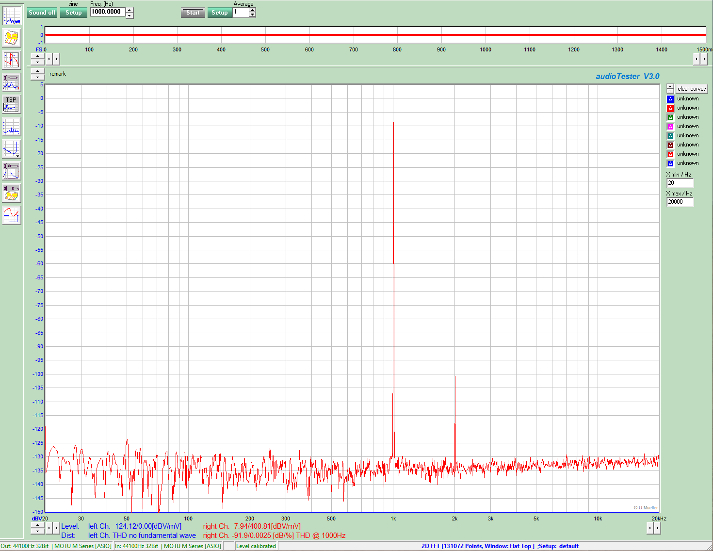

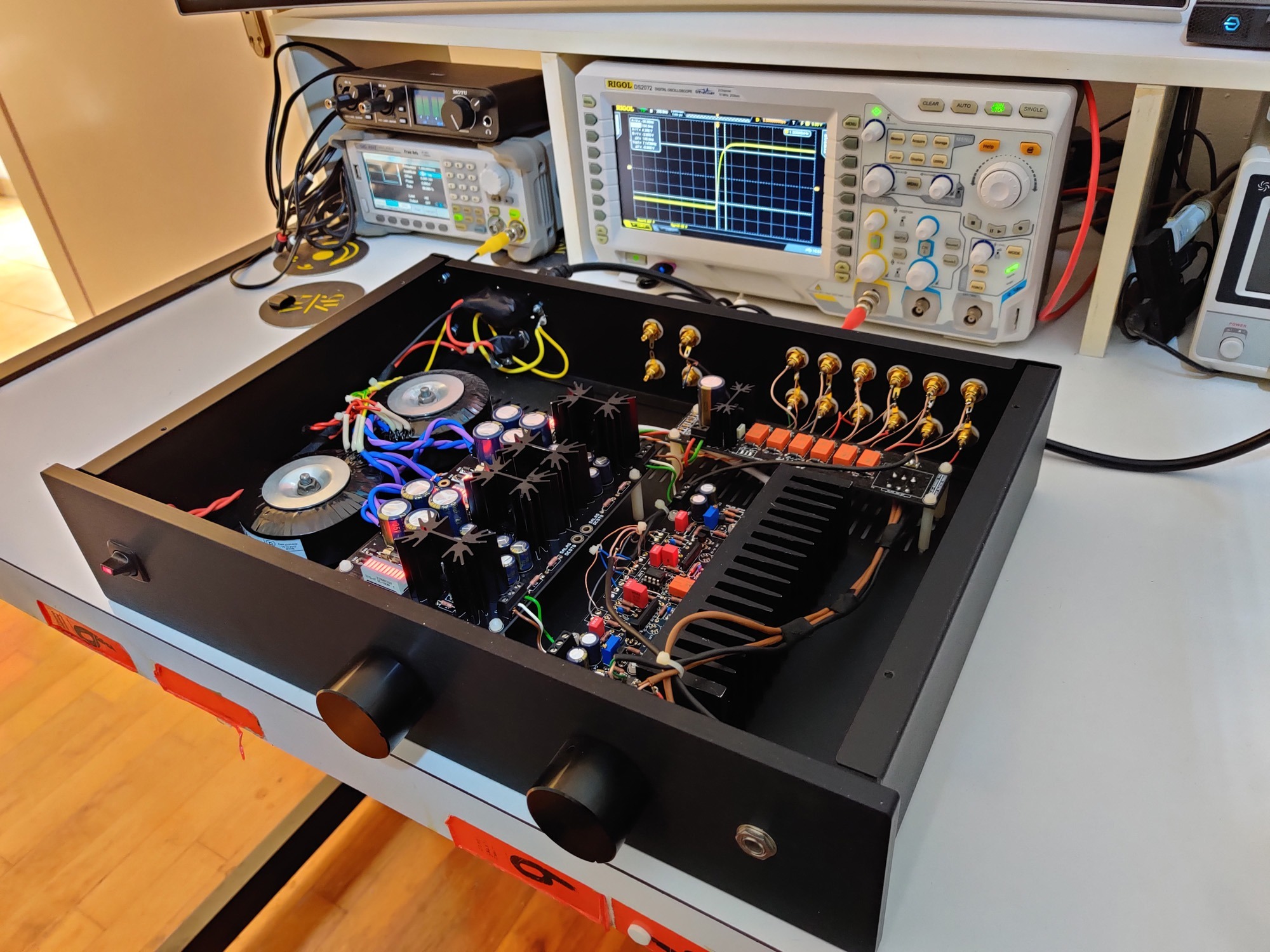

I once measured a friend's DCG3 FET preamp with 20k Log TKD CP-2511 in it and it could photofinish a MOTU M2 audio interface's self loop for THD so it should be good enough for tubes.
DCG3 does three zeroes after decimal through higher resolution test gear but I just had the M2 when the particular build was checked. Will find that FFT to post it here too.
