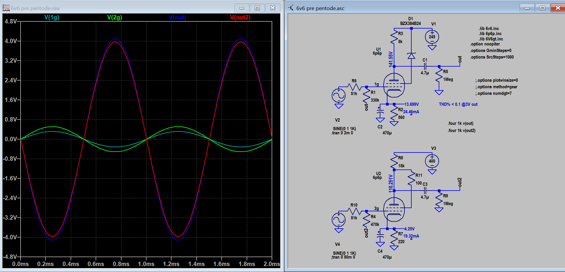

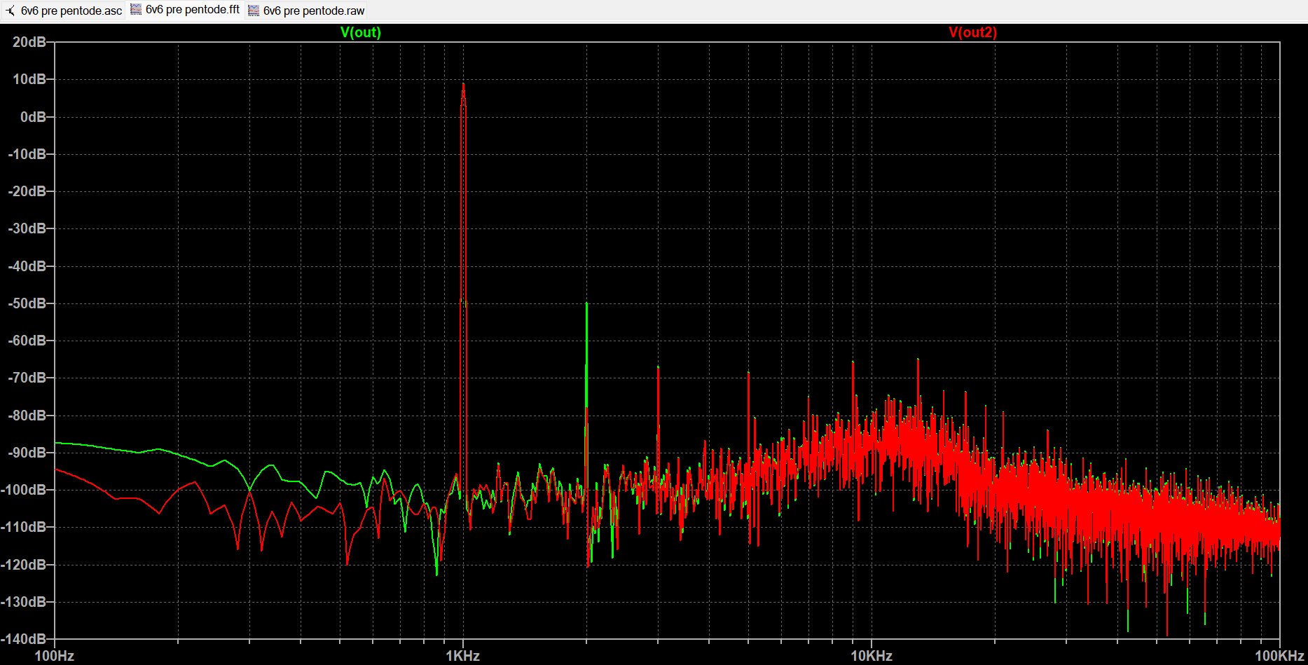

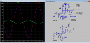

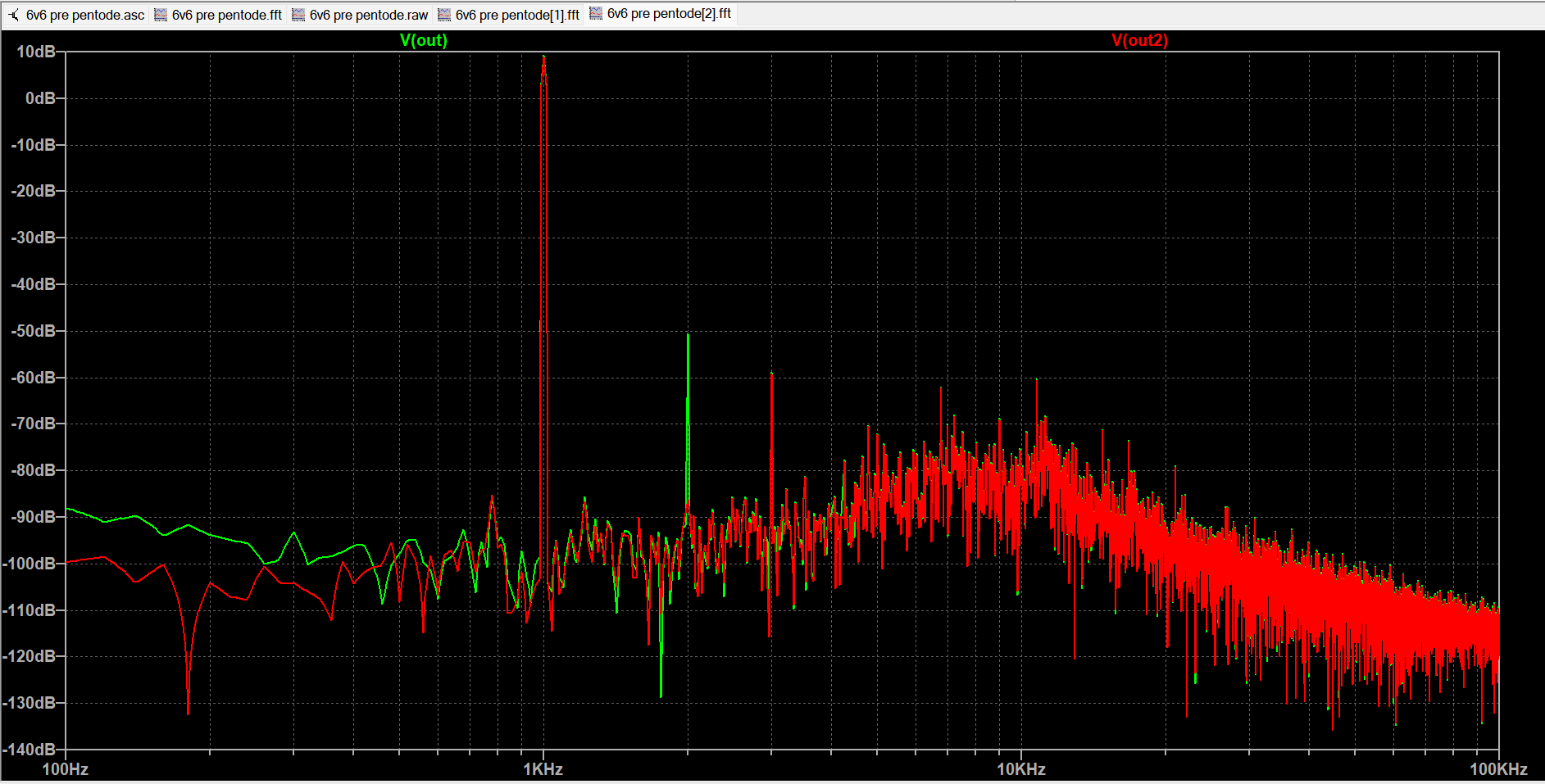

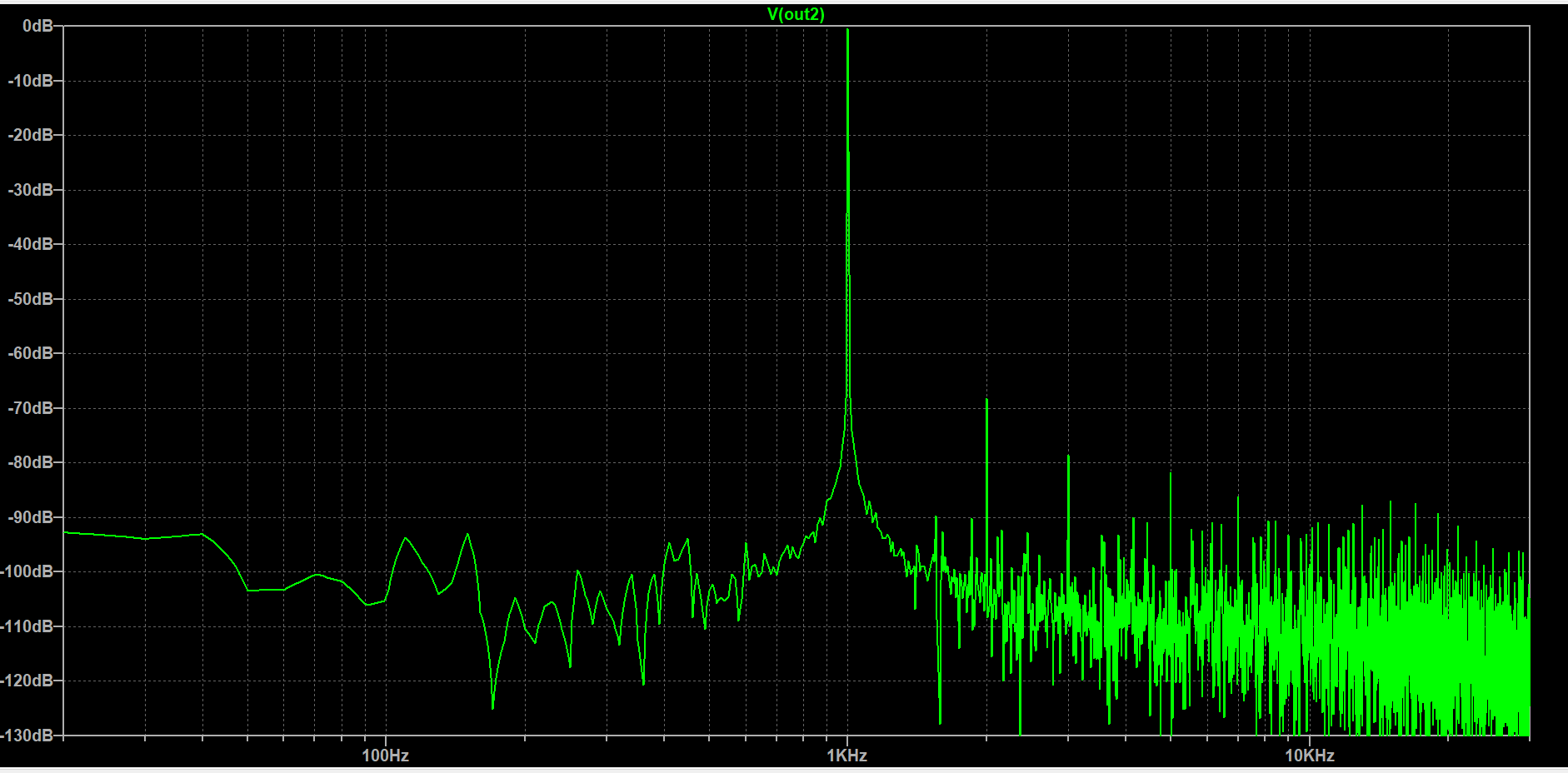

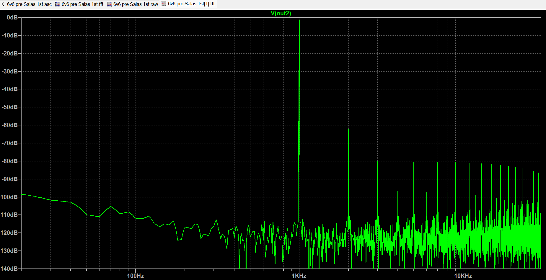

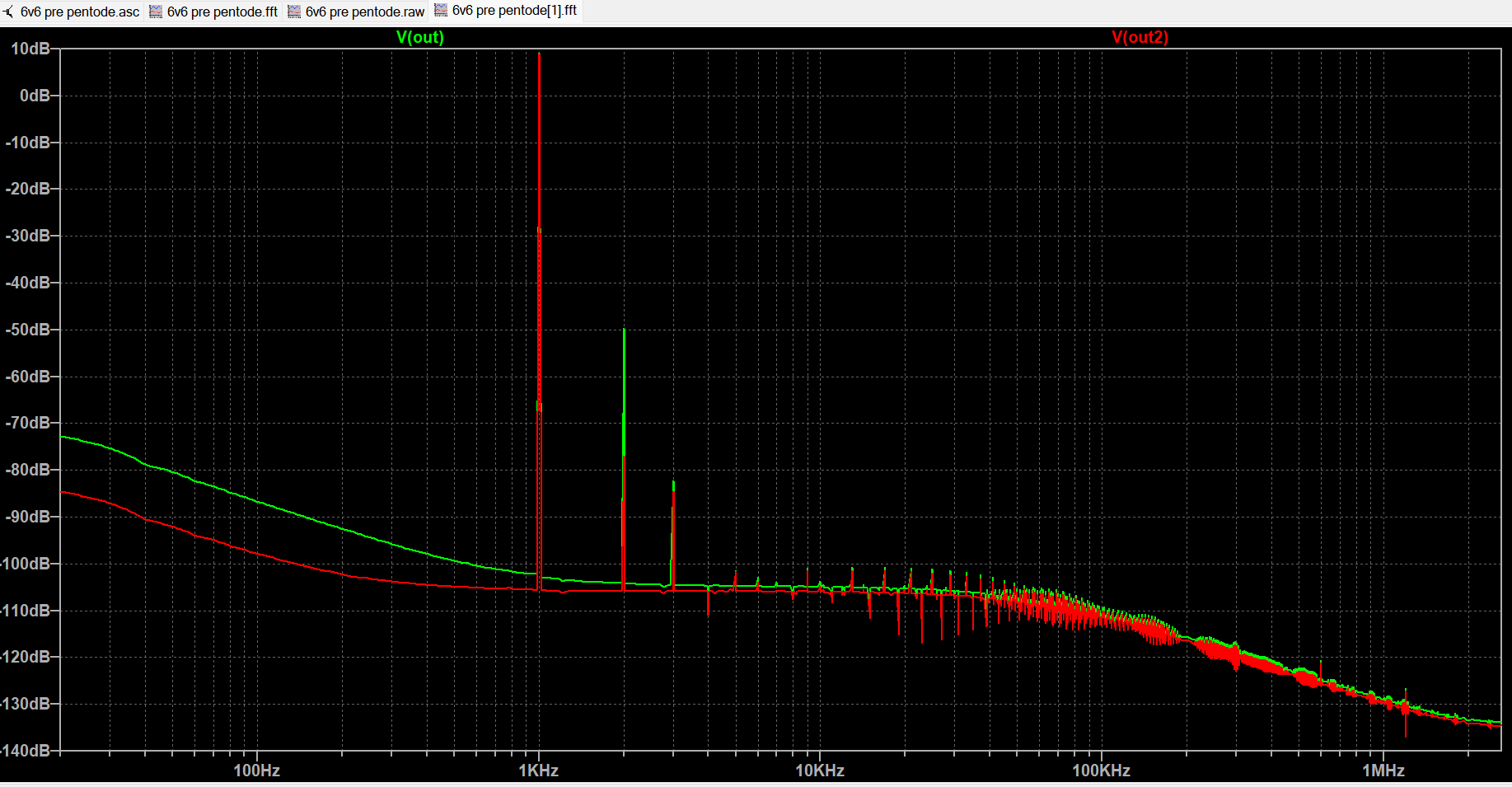

I did a FFT comparision of your sch in triode and pentode mod. The FFT of triode mode is missing H2 while the pentode mode is quite normal.
Did you run those simulations using 1M ohm loads? If so, maybe try running them into 100k ohms or even 50k ohms. That's more like a real world load. Perhaps also put 500pF or 1nF from out to ground to simulate a long cable run of not-so-great interconnects.
I'm afraid I don't understand what exactly LTspice is doing when it creates the FFT and THD readings.
I use the following SPICE directive for the simulation, and take the FFT from that:

It would be very surprising if a triode stage, even with NFB, made more H3 than H2 at small signal levels.
Some of options are causing the FFT plot to slop a lot, so best to not including them. With the same rules applied to both modes, triode FFT mode appears more deviated from original (Salas's), and as it has less H2 to start with, apply more fb brings it down further (according to normal logic).

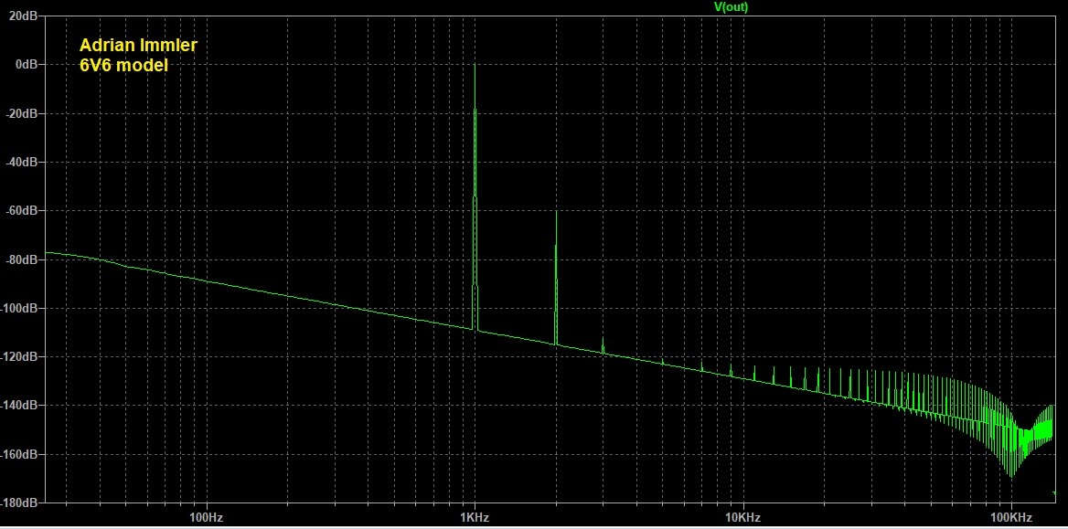

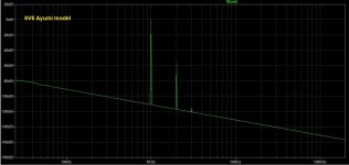

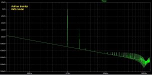

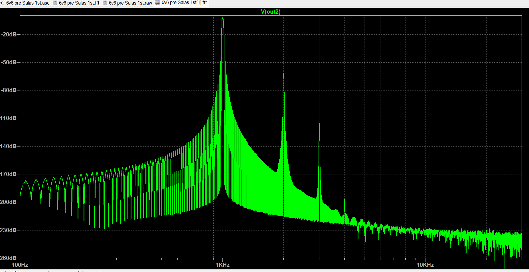

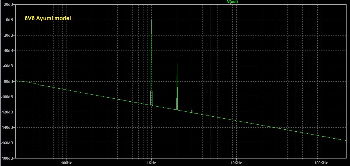

Here's the circuit from post #1 simulated in LTspice with the directive I've been using. One graph is the FFT using an Ayumi N. 6V6 model, the other is using Adrian Immler's model.
THD at 1V rms out into 100k ohm load:
AN model: 0.126% (-58dB)
AI model: 0.085%
Those predictions look a bit rosier than what happens in real life. The real thing looks like it makes H2 at -53dB down. which would be about 0.15% THD, I think. (How does one calculate that...?)

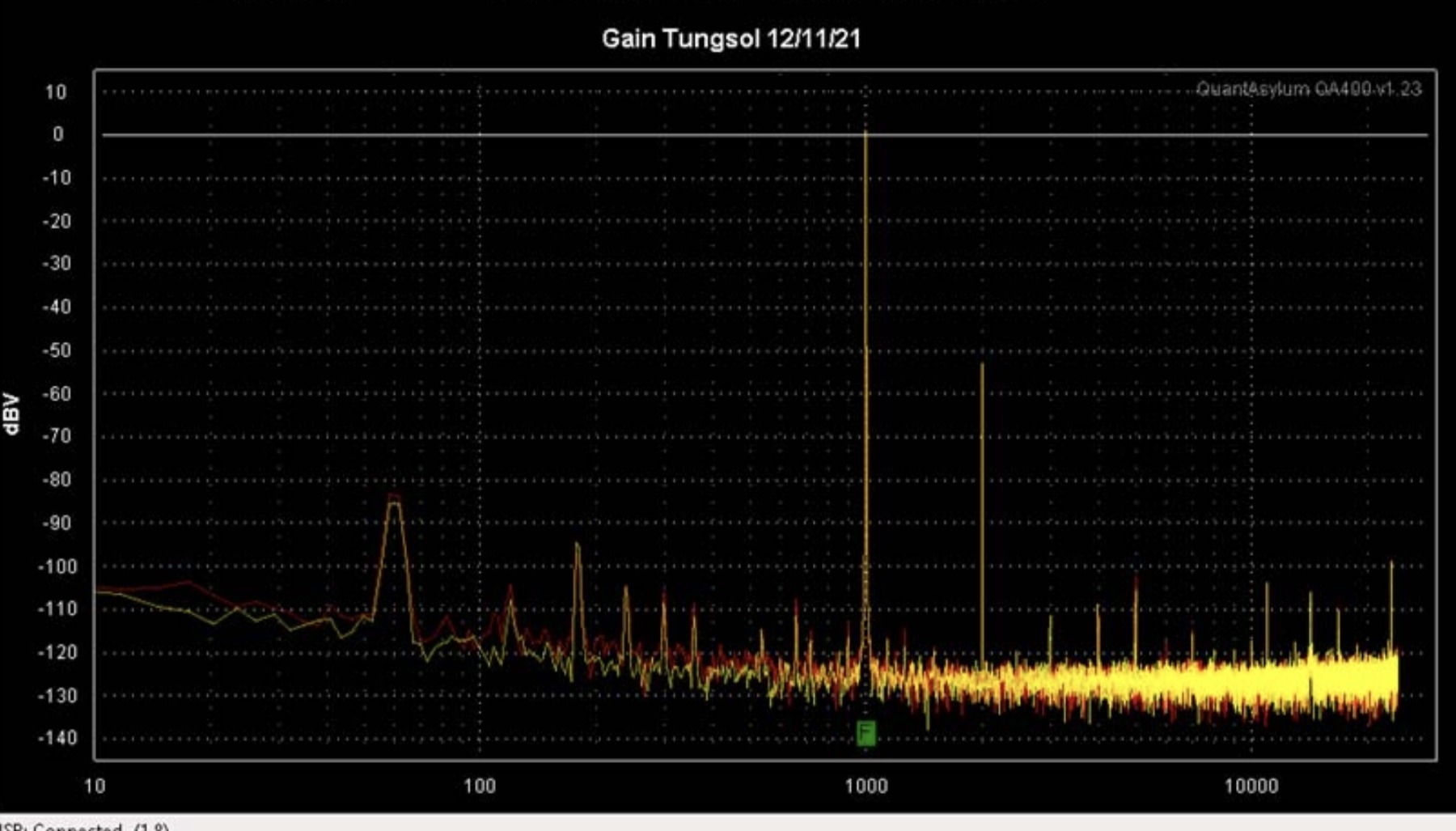

Real life version
some of the spurious stuff below -105 could be the analyzer. That’s about at its resolution.

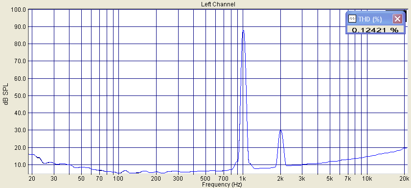

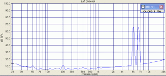

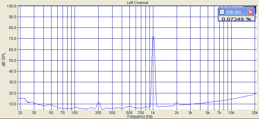

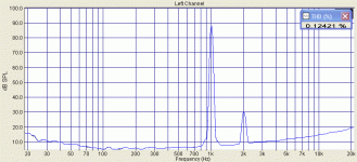

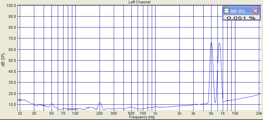

I dug up three charts from the original gain version preamp. Took them in 2007-2008! Not a today's performance measurement rig and wrong Y scale (SPL) but you get the numbers.
Thanks Salas.
Any idea what the output signal voltage would have been at half volume?
I usually quote fantastical SPICE predictions using 1V rms output as the reference point.
That FFT was obviously set up for measuring speakers at the time hence the octave smoothing and SPL scale. As far as I can remember I was normally using 1V RMS for full DUT output because the common man's audio cards of old would quickly build up own harmonics around 1.5V and fully saturate at 2V.
Half volume pot must have been the physical knob's mid position. As we see something like -16dB difference between full and half in the charts, that gives 150mV RMS. In other words -1dB below unity (In=Out test signal level) on the pot when we consider the preamp's 15dB gain. One O'clock should have been unity when "half_vol" chart was 12 O'clock.

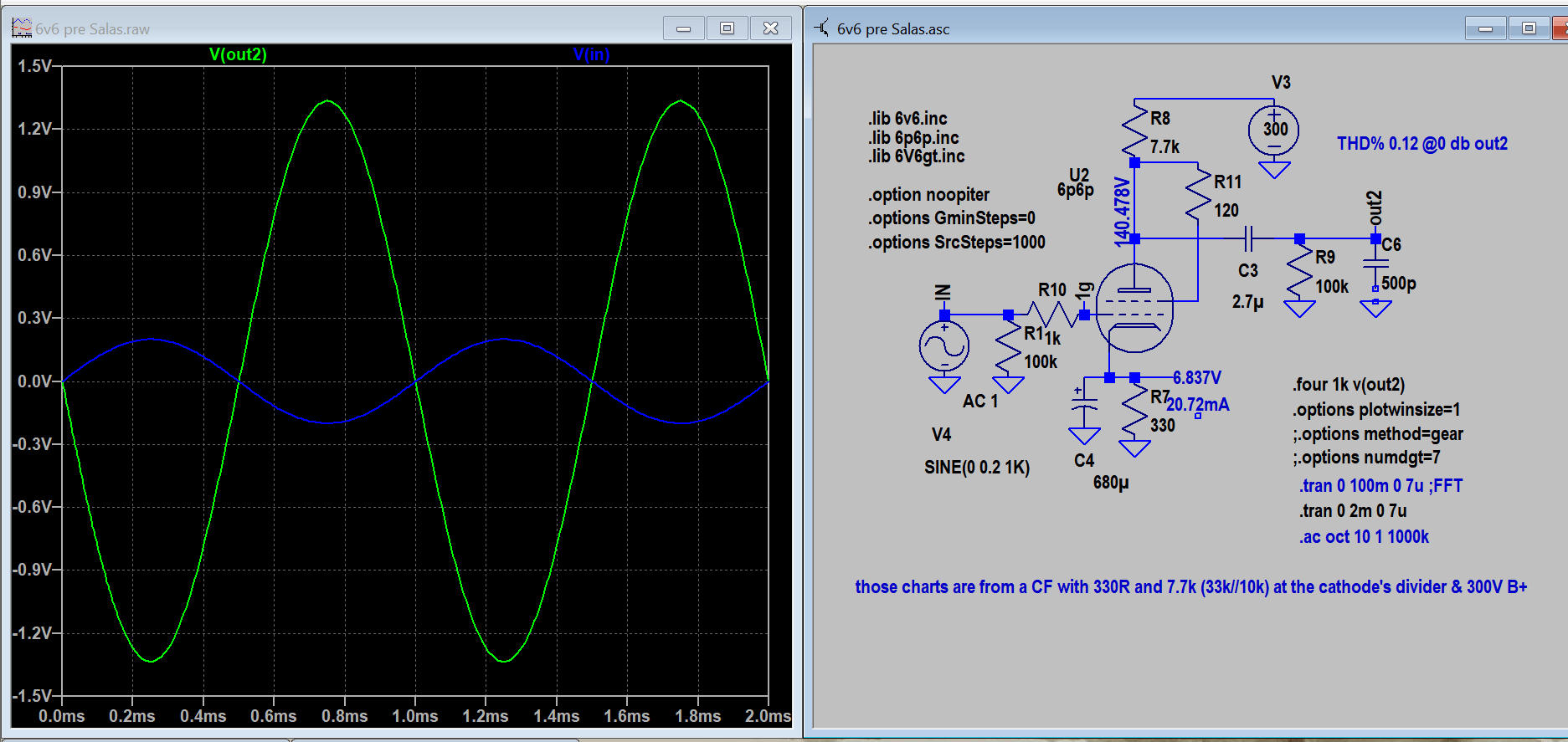

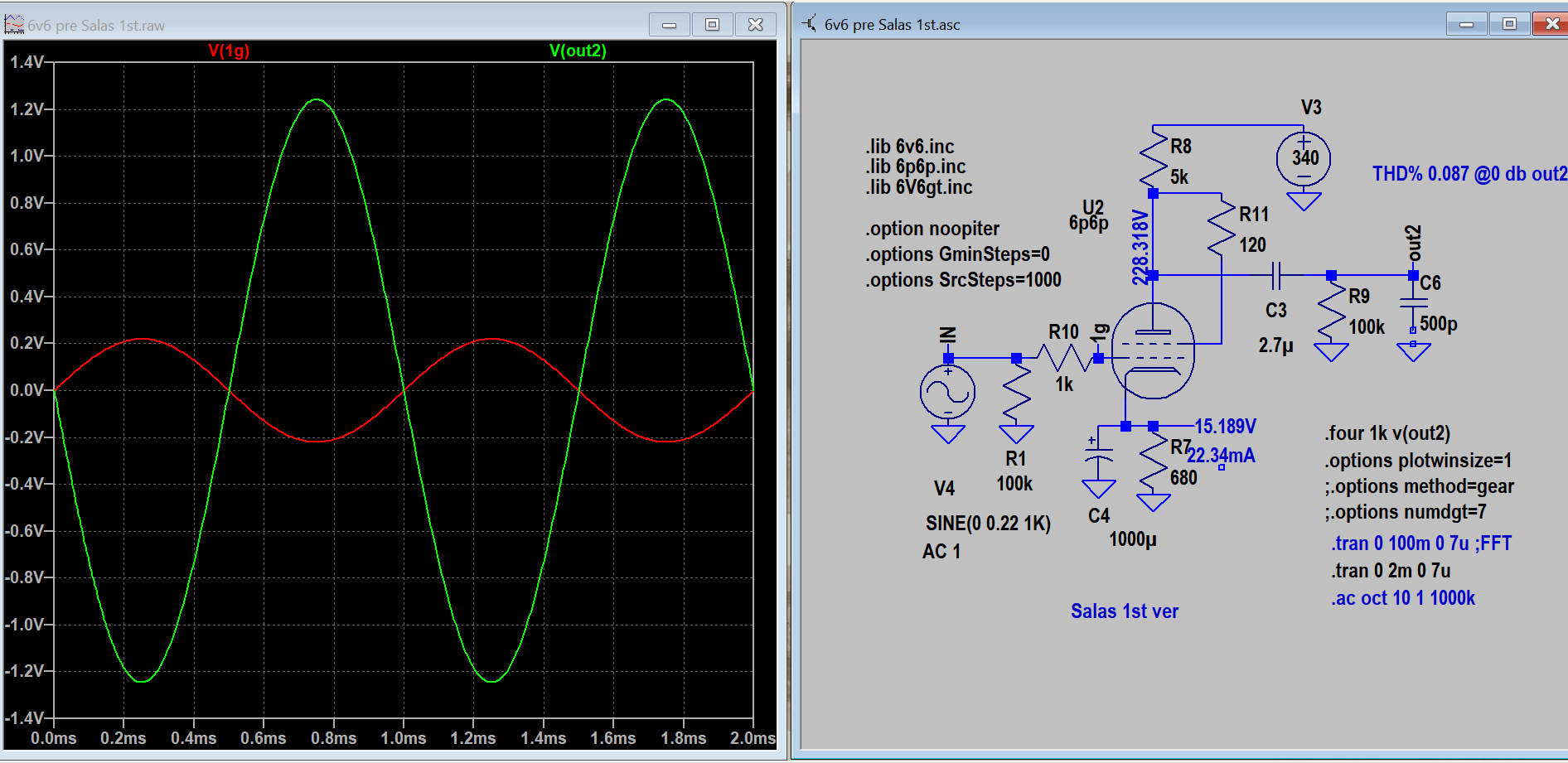

I settle for these settings, it's about as much details one can hope to see, with Bohman Windows.
Code:
.tran 0 {simtime} {dlytime} {timestep}
.options plotwinsize=0
.options method=gear
.options numdgt=7
.param numcyc=150
.param dlycyc=1
.param FFT=18
.param simtime=numcyc/Freq+dlytime
.param dlytime=dlycyc/Freq
.param timestep=(simtime-dlytime)/2**FFT
.four {Freq}  V(out)
.param Freq=1k
