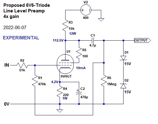

I was doing some simulations and loadline calculations, and came up with a simple common cathode version 6V6 line stage that looks quite good.
I found that THD is very low if you can employ a 400V B+ and a 15k ohm plate resistor (preferably wirewound 12W).
I adjusted the value of Rk to get Ia = 20mA.
Has anyone tried crazy operating points like this?

Well, the idea is that if the ra of the 6V6-triode is about 2k ohms, raising the anode load to more than 5x the ra would make a more linear circuit (also increase gain, but that's a different story).
A 5k ohm load is 2.5x the 6V6-triode ra, which would allow for more power out, but not as linear.
The question is, of course, how does it sound? Well, that I don't know, which was why I was asking.
About there indeed. Closer to 1.6k ra I think.if the ra of the 6V6-triode is about 2k ohms
many seem to have preferred the original 5K 340V B+ load line which is more second harmonic rich with a workable 15dB gain

True. There is a catch though, less THD comes along with higher plate load & more gain in the common cathode version which also adds more noise. Best is to arrange the system gain structure with low voltage gain in the power amp. Adequate to reach max power after three o'clock on the knob.
So perhaps... Apply a little NFB?
I only need a line stage with about 3x gain for my current setup. I had some PCBs made for a noval twin-triode (12AT7, 6DJ8, etc.) as a stereo pair of 'anode followers' (common cathode with shunt NFB) each with a MOSFET source follower. The NFB goes from the output of the source follower to the grid of the triode. I need to wire that up with a decent PSU and see if the NFB destroys the sound quality (as so many claim it will).
Why not take a 6V6-triode with ca. 9x gain and reduce that to 4x gain by employing plate-grid NFB? Will the magic disappear? What exactly is the magic?

I like it Even if it's wasteful.
I would follow it though. This is where it could get interesting. Replace the 15k resistor with a 6SN7, and use the other half as a follower... How about that? Maybe lower the B+ to 350V as to not beat the crap out of the 6SN7 or parallel the sections and use two... If you're going to use a 6V6 as a preamp tube, why stop there?
I think the reason to use a 6V6 as a preamp tube is for its particular, and presumably desirable, 'sound'.If you're going to use a 6V6 as a preamp tube, why stop there?
