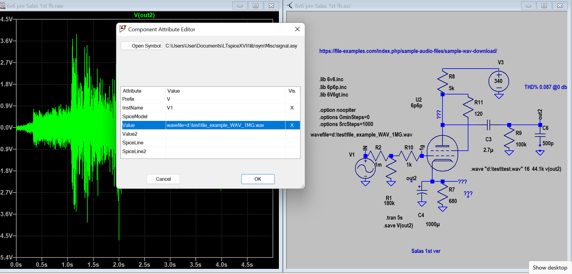

  • file_example_WAV_1MG.zip
Yes, listen on real thing with you ears! I build OTL amp for last 10 years, I never listen to a wave file until now 😉 I wish I knew this earlier but is very subject, it maybe worse like you say. But I have hard time to get as good sound wave with all versions of 6v6 preamp, it's time you pull out your solidering iron, I can' help you any more.
