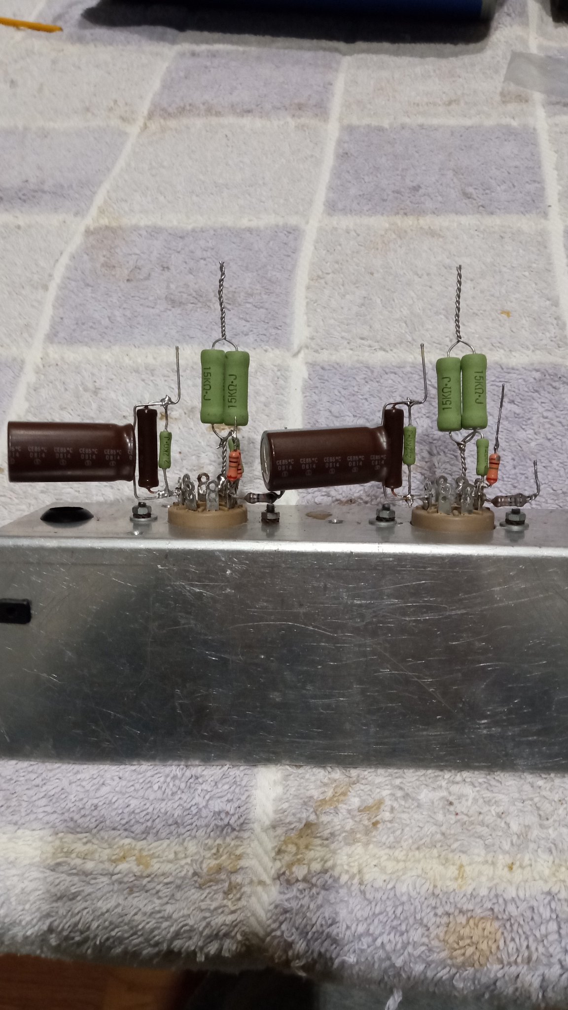

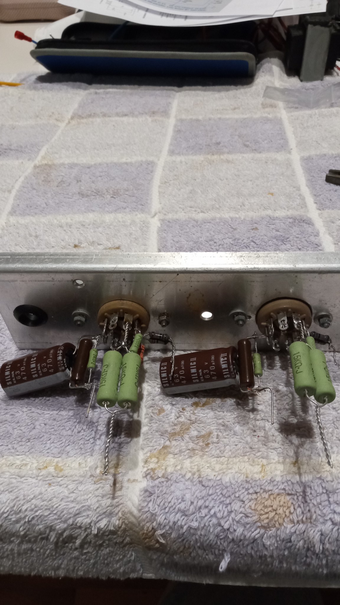

Brown resistor // green is 470Ω // 2k2 for 387Ω i.e. 390Ω Rk?
Those 470μF 63V Silmic II measure very good on the LCR by the way. I used them in my mod too.
Good work so far, my favorite construction style, just difficult to repair later.Thanks, attached files work in progress
