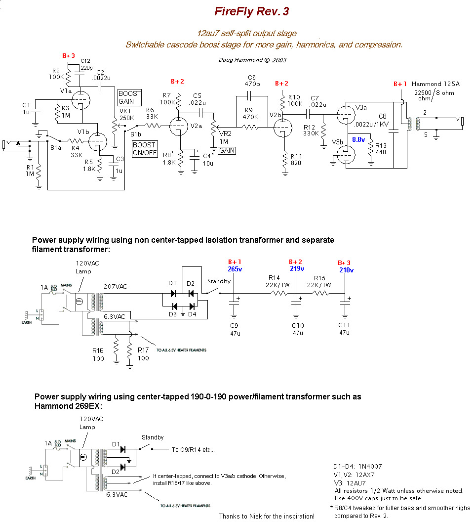

For those who may not be familiar with the Firefly here is the original circuit by none other then Doug Hammond himself. Not meant as a regular amp but for guitar effects. Notice the self inverting final stage, makes lots of even order harmonics, 2nd, 4th, 6th & so on.🙂
The 12AU7 Hammond uses in his circuit is not far off the characteristics of the 6SN7.
Beginning in the late 30s there were several of these self inverting PP stages built into various amplifiers for one reason or another. None of them are able to deliver more than one half what the same PP pair could do with a regular drive stage.

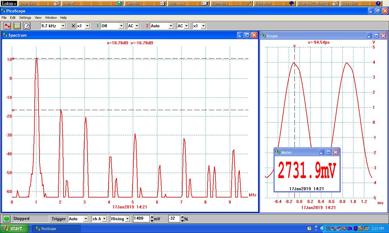

I did an exhaustive series of tests a couple of years ago, complete with distortion tests with an HP334A THD Analyzer & Pico Technology Spec A. The results were not good at all. Anyone wants a copy of the paper let me know, all in a PDF.

With your analysis, are you saying not good for the intended purpose (effects pedal) or for audio purposes?Beginning in the late 30s there were several of these self inverting PP stages built into various amplifiers for one reason or another. None of them are able to deliver more than one half what the same PP pair could do with a regular drive stage.

The cct is very good for effects. But makes a poor audio amp.🙁 In spite of that there are examples over many years of it being used for claimed Hifi, even recently. And found one in WW2, a couple more published in the late 50s & early 60s.
All covered in the paper. The example here is out of WW2. Could have made a real amp simply by stuffing in a 12SC7 diff amp, a real phase invertor instead of that 12SH7 pentode.
The Hammond 125A would be AOK in a small PP amp.🙂 Looking at the taps selected in the Firefly, could easily go to a higher load impedance, thus improving for fidelity.

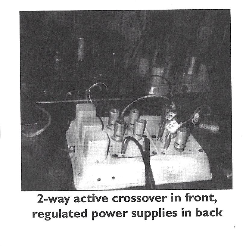

The Betty Crocker Special
Use of a cake tin as a chassis was inspired by an article in Sound Practices magazine, Issue 11.
Al Bryant was named ‘Home brewer of the Month’. One of the article photos shows a cake tin complete with electronics of some kind. Much lower cost than the purpose built thing & works very well.

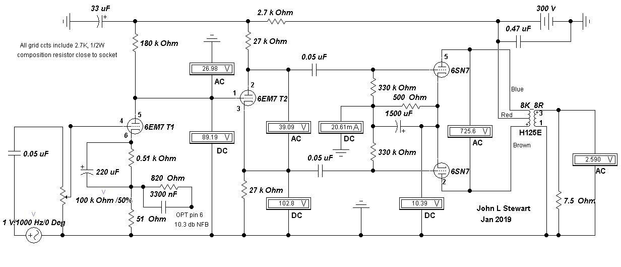

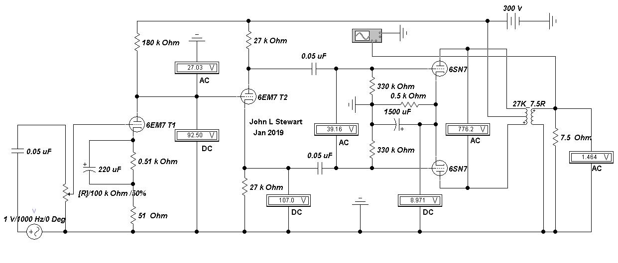

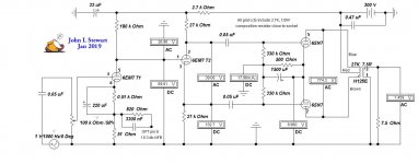

This amplifier is a PP 6SN7 driving into a Hammond 125E. Taps 1-3 connected to 7.5R result in a plate to plate load of 27K. Trying other close tap ratios confirm this to be the best option. The maximum audio looks like One Watt at which point the cct is clipping. The distortion is 4.3%. At 0.5 Watt the distortion is 2.2%.
The power supply is a regulated lab supply set to 300V. The driver circuit uses a dissimilar triode, the 6EA7. The high mu section is used in the first stage for gain. The other triode is low mu & makes a very good driver for the PP 6SN7 triodes.
When using twin triodes such as 6SL7 or 6SN7 the driver cct is never optimized for one part of the cct or the other. Using a dissimilar triode solves this problem. The 7247 was developed to overcome the problem but never caught on. One section is high mu like half of a 12AX7 while the other side looks like one half of a 12AU7.😀

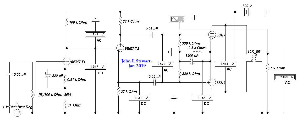

Corrected schematic here this time.
Hammond 125E with some impedance data extended.
Dissimilar twin triodes 7247 & 6EA7 (same as 6EM7).🙂

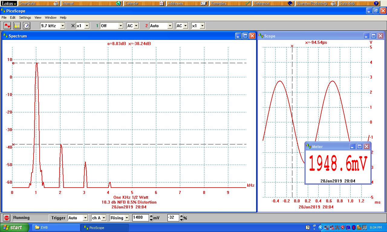

With the Hammond 125E OPT the measured 3db points for the 6SN7 vers are 65 Hz & 26 KHz. So Bass would be a little thin.
A degree of NFB would help that. Something to try tomorrow.🙂

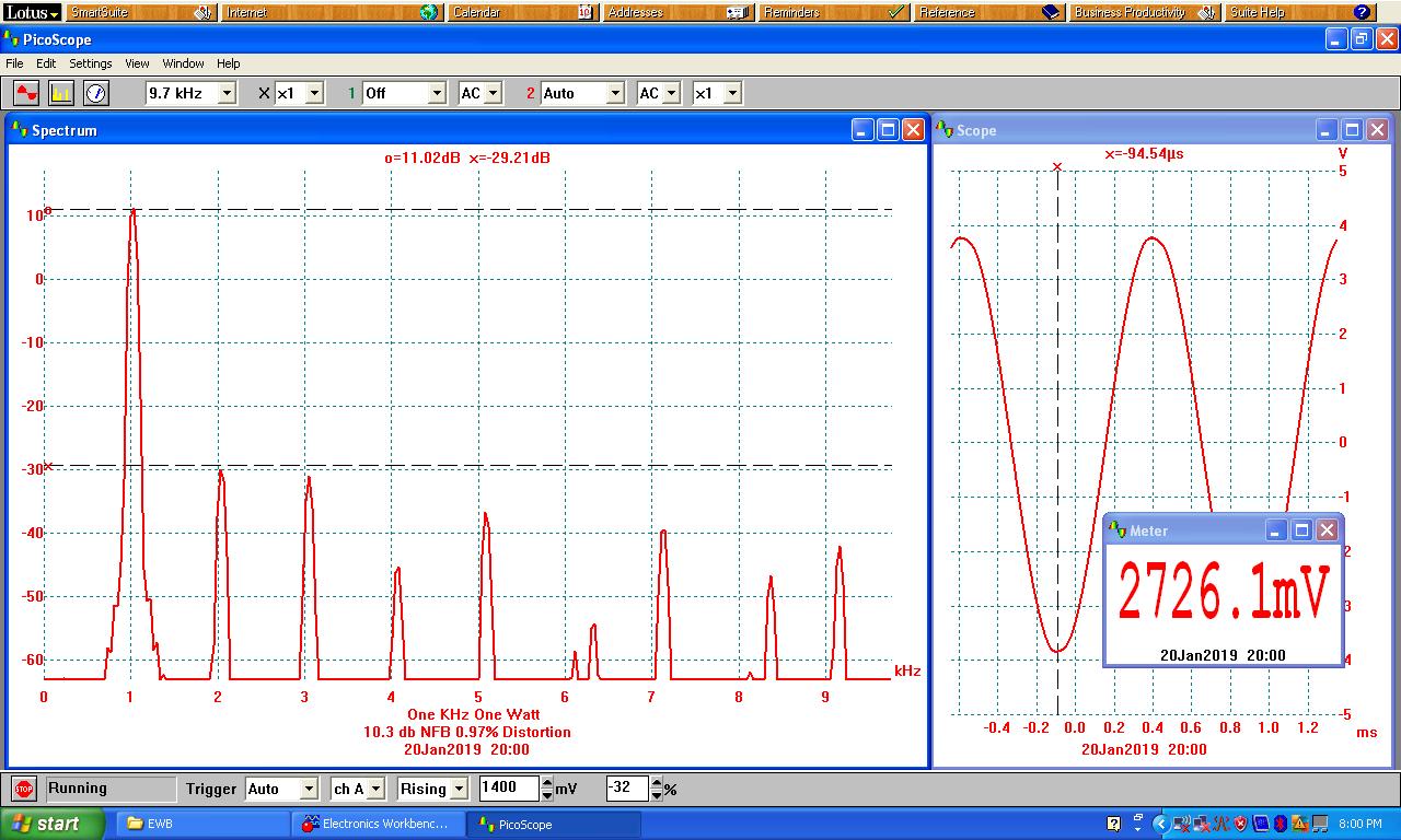

Another Episode of the 6SN7 amp, this time with NFB. A lot of work for one watt of audio but could be easily scaled up. The NFB is 10.3 db thru an 820R resistor from pin 6 of the Hammond OPT. The correct connexions are on the schematic. The 3300 nF cap in parallel corrects overshoot on a square wave.
3db down freqs are now 26 Hz & 63 KHz.🙂

Just noticed again there was still another error in the schematic, I had mislabeled the OPT again. So finally fixed.
