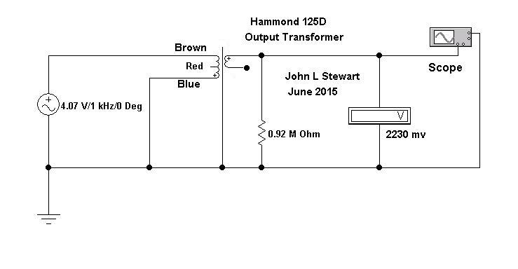

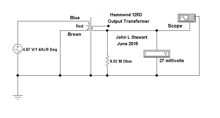

For the keeners in the audience here is more useful info related to low cost OPTs. In this case a Hammond 125D is subjected to a test to determine potential wdg capacity problems.
Low cost OPTs are wound serially, no sectioning or other fancy stuff. So the secondary ends up wound around one end of the primary. There can be as much as 150-200 pF more capacitive loading at one end of a PP cct than at the other end.
Attached is a simple way to discover which end has the most capacitive problem.
Doesn't matter much until NFB is connected. It might be one of the factors causing HF instability in the resultant cct. Worth knowing about, I've used a cap at the opposite end to equalize the load.🙂

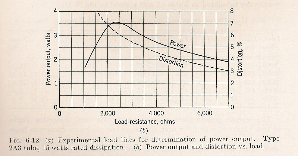

🙂where do you think the rolloff will end up?
LF rolloff is 3db down when inductive reactance equals the source resistance.
Rl = 2*PI*f*L
So if Rl is taken as 3X the series of the 6SN7 plates, 2 X 7700rp by 3X
Plugging the numbers in we get 2(7700) * 3..........46200
Low rolloff would be ~621 Hz.
If Rl is taken as 2X rp, the LF rolloff is ~ 415 Hz.
The cct needs an OPT with somewhat more primary inductance. Typical triode distortion curves lifted from EE text books.🙂
