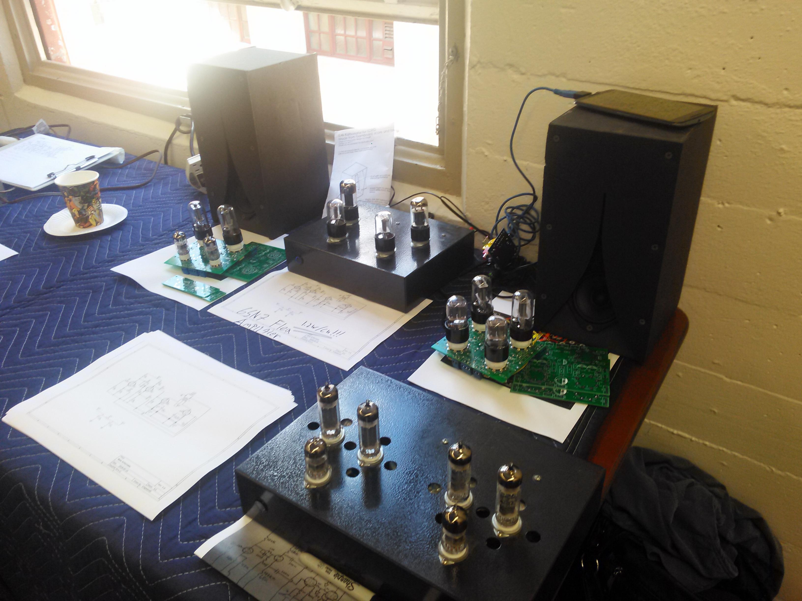

Also of note, I've requested the day off for Burning Amp 2018 in San Francisco, and will be taking the prototype and a few boards with me, as well as some basic info and a schematic for those interested. If anyone else will be attending and has a set of speakers that sound suitable to pair with it, just let me know

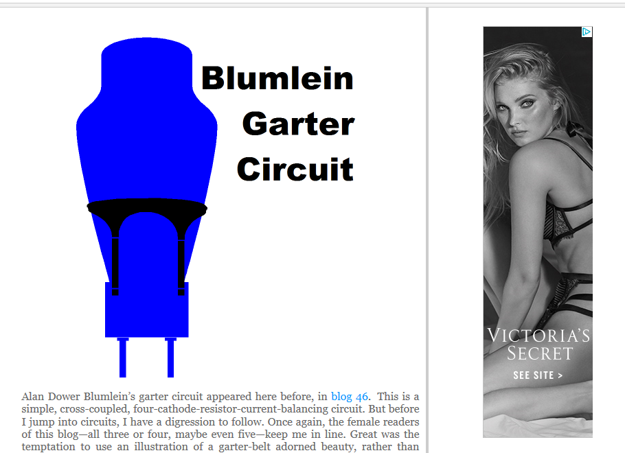

Pick up this thread after an absence, think I'll build one with the noval inputs, 12AT7 likely. I too like them and the Tung-Sol Russian reissues are quite decent. Anyway had to share this screen grab with you of what came up when I clicked on Garter circuit link. I could say that my wife was using my lap top but that would be a fib. Don't you just love cookies?

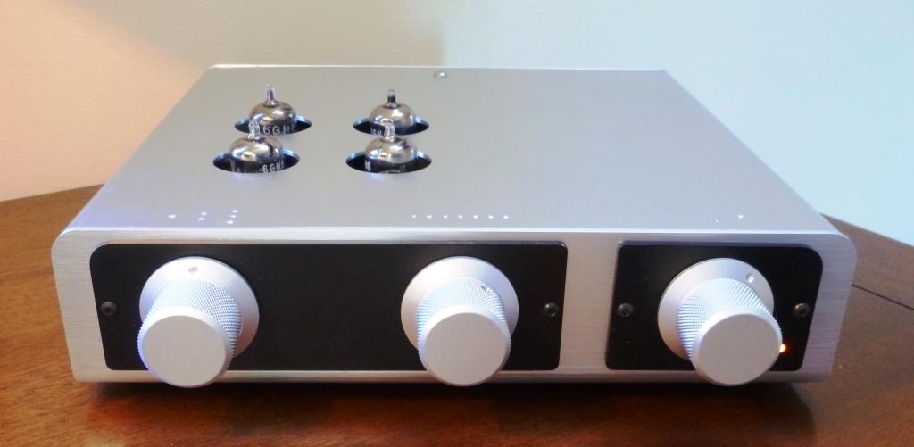

I'm going to build one using turret boards so component changes can be made easily. A chassis like the one in the attached line stage picture will be used.

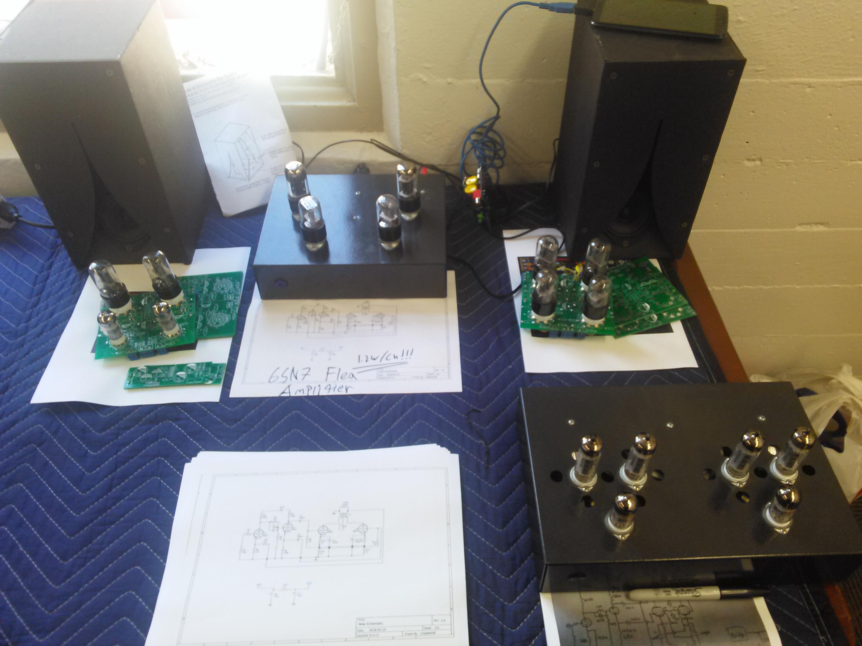

I've got an octal one fully populated and ready to go, and a half-stuffed noval one to finish. I just want to do a smoke/function test before I send any out! I just need to find an evening to do so, and I would like to have a decent chassis to bolt it all down to as a finished amplifier too, so I don't have to have a big mess to disassemble after testing. I'm thinking of just drilling some holes in an ATX computer PSU case and going with one of them for the first prototype, It'll likely all fit just fine, and already has an IEC power entry on it to save time...
For everyone patiently waiting on PCBs I'm sorry it's taking so long. Life is keeping me pretty busy. Taking yesterday off for burning amp was the first time I've had more than one day off per week in probably three months!
