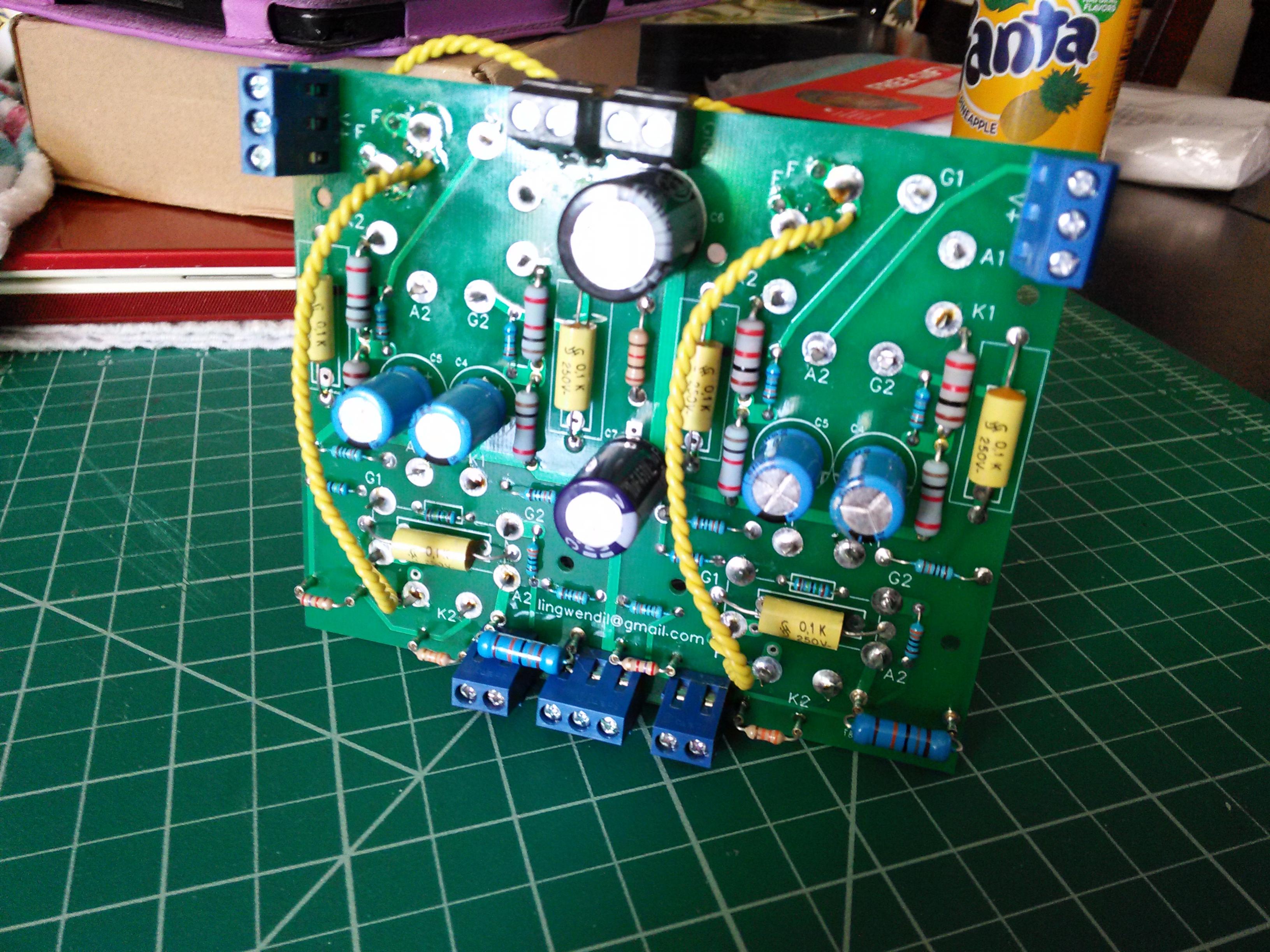

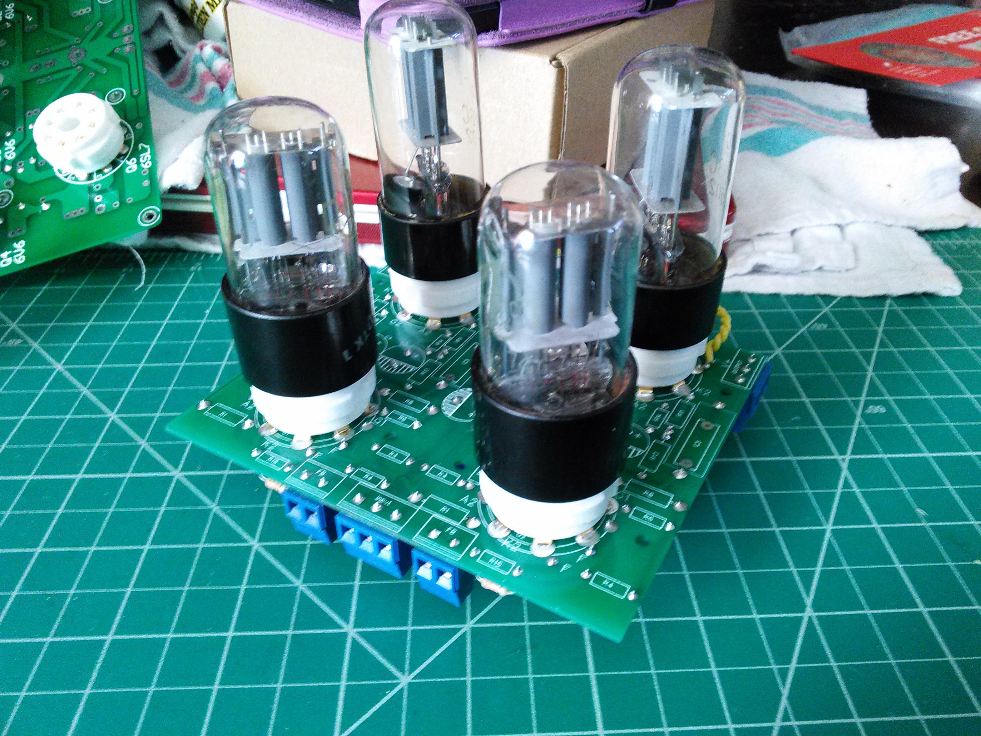

No real updates to speak of, other than I have stuffed a board without any issues whatsoever, and I have to say that they are pretty darn easy to build on. I can already see where some improvement with regards to layout and filament wiring can be made, so some of those changes have been implemented in the noval version. The input stage cathode resistors on the octal board aren't at the same area of the board, but on the noval version I was able to scoot them over for a more user friendly/symmetrical layout.
Overall I'm quite surprised at how compact these boards are! fully assembled it takes up less space than an octal Aikido preamp kit, so should make a great base for a small desktop build in one of the affordable bud industries chassis.

Sneak peek at the fully populated board, pretty nice! Don't mind the flux that I need to clean off, I need to grab a grubby toothbrush to scrub it off.

Alright, got the next set of boards in hand, I'll stuff a mosfet board and actually test the thing this weekend hopefully. The noval boards look good, other than a minor goof on my part, I've got a few holes going through my email address on the underside of the board 🙁 I don't have any noval pc mount sockets on hand, so I'll have to wait to stuff one of the noval boards, but the little mosfet boards look handy already for these types of projects 🙂
