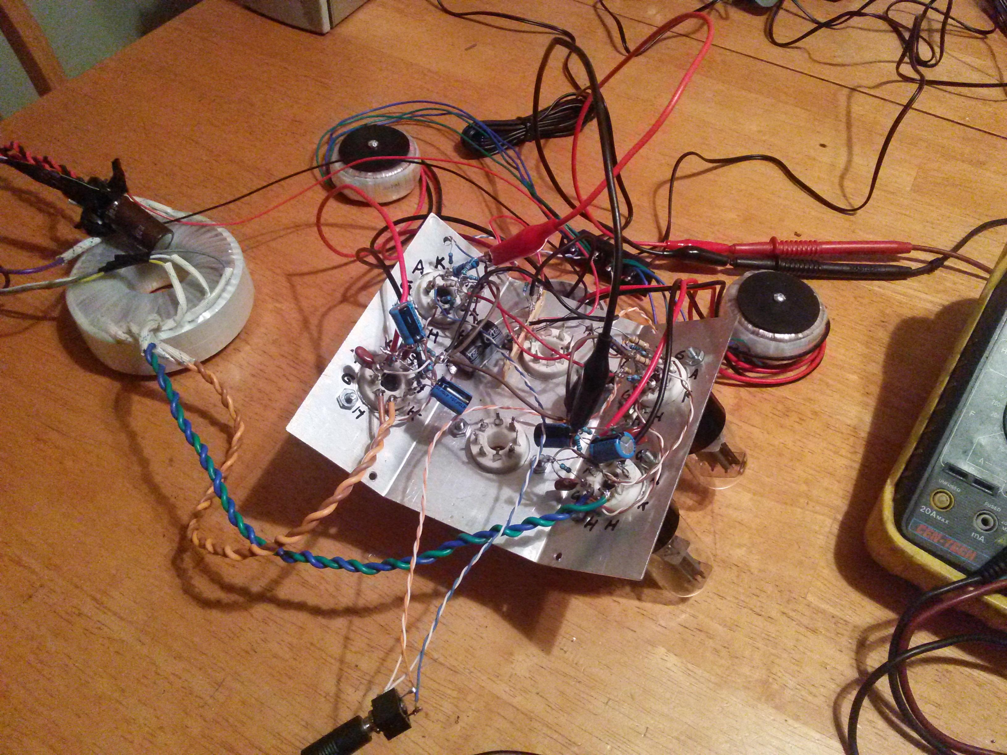

Finally got a few hours to lash together a design I've been playing with, and I am extremely proud of how it turned out. The very messy prototype is surprisingly hum free, and can be driven to 1.4w clip, but can sustain a clean 1.2w continuously, using a ~300 volt supply. My calculations point to around 2w would be possible at higher voltage around 400 or so without too much change.
Now here's the goofy parts- I am using Antek toroidal power transformers as outputs, and due to the low current and power, 10VA units work great, and are very affordable. In order to keep the current balanced, I'm using the garter bias arrangement, which works way better than you think it should, and at such low current and voltage is not a big loss at all having extra cathode resistors. I drop 9.2 volts across each 1k resistor, so my tubes are running at 282 volts, sitting at around 2.6w idle dissipation per triode, 5.2w per tube, not counting the heater. It's got NFB too, just to make everyone upset 😀
Here's a messy teaser pic of the first rig, but I'll get up a schematic soon. I've got an aluminum box coming tomorrow and will work on a layout for it too.

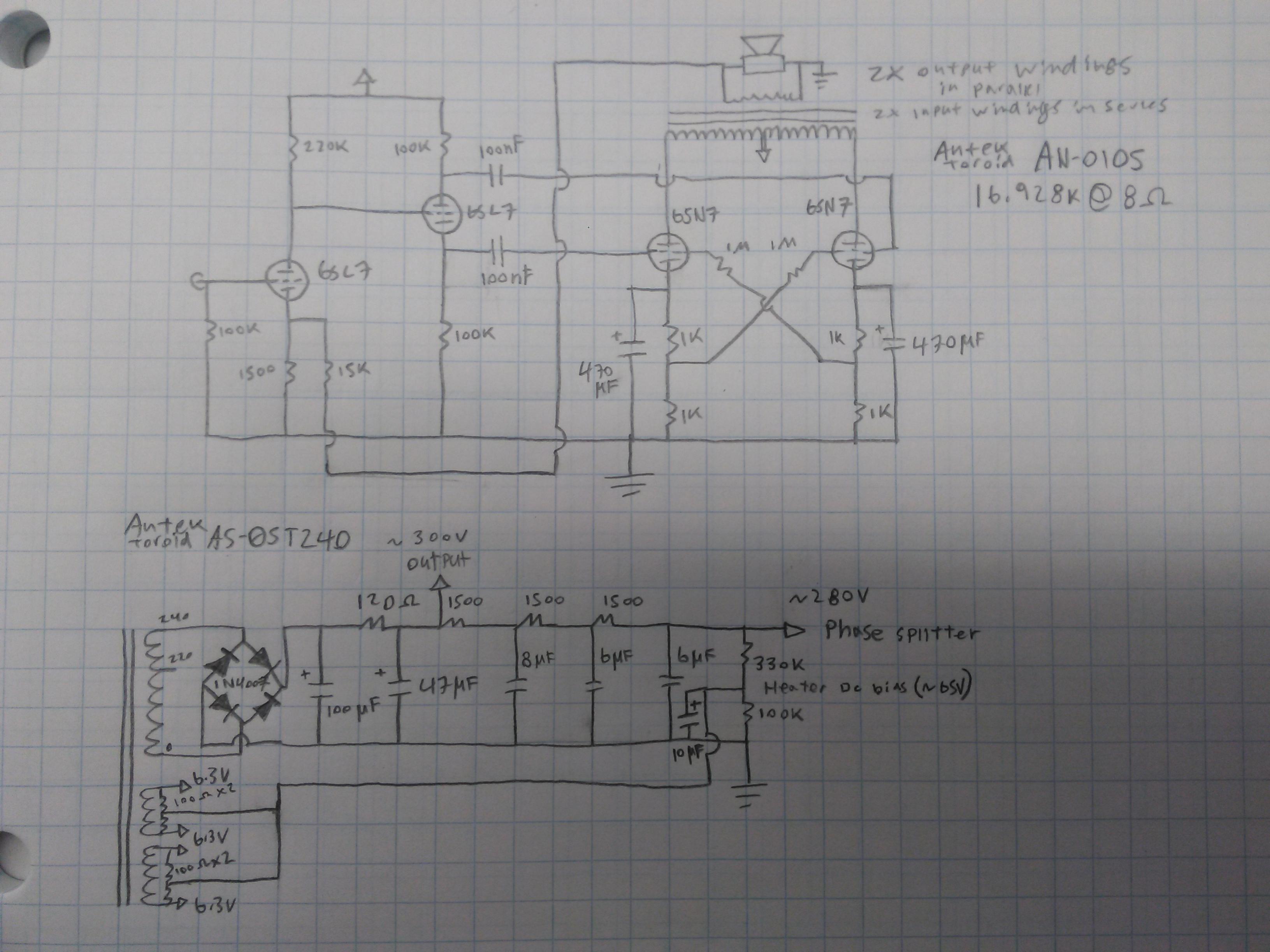

As promised, the schematic and more details. You may notice I'm not one for exotic parts values, I like easy and simple if they work well.
The power transformer used for the psu-
Antek AS-05T240, $28
The power transformers that I'm using as output transformers-
Antek AN-0105, $10
The primaries are wired in series, and the secondaries are wired in parallel. Since impedance ratio is the square of the turns ratio, 230/5= 16928 ohms for an 8 ohm load, 33856 ohms for a 16 ohm load. Output tubes are Russian (6H9C) 6SN7. While this sounds great and works fine at 8 ohms (especially considering we are using negative feedback to keep everything in line) it would likely work with better THD on a 16 ohm load. Since I plan on building a nice pair of speakers, I think they will be running 16 ohm in the long run. They will eventually drive either a pair of Karlsonator or Cornu style designs in my bedroom, depending on which sounds better once I get around to building some...
Input/phase inverter tube is a russian (6H9C) 6SL7, although a 6N1P, 12AT7, or similar would work as well. I arbitrarily set the feedback resistor at 15k, considering that I am running a 1500 ohm cathode resistor at the input stage, although I might play with increasing the feedback resistor to increase the overall gain. I found when plugging directly into my cellphone that the gain was a little low. I might try replacing the 15k with a 39k or 33k pair in parallel with a switch to swap them in and out to deal with different sources. The capacitors I used for the output stage bypass are 35 volt rated electrolytics from a local Radio Shack that is going out of business. Use whatever brand snake oil you prefer if you must.
Power supply is pretty basic, and built using parts on hand. The smaller caps are some film caps I have in my parts bin, electrolytic capacitors should work as well. Make sure you mind the DC bias for the heaters! On the next build I wil likely use a higher voltage secondary, as the AS-05T240 is only giving me 305 volts rectified. The Antek AS-05T280 would do very well in its place, and has a 280 volt secondary with a 260 volt tap. This would give more room to play around, and let you squeeze a little more power out of the outputs with just a few component changes.

Well, like a goof I left my circuit a little bit unoptimised. With a change at the input stage of just a little more negative grid voltage, I should be able to increase the gain and maximum swing available a bit. The cathode resistor will be changed out to 2700 ohms, with a corresponding change of the feedback resistor out to 27k. I want to leave in the option for less feedback, so I may experiment with something like a 33~39k feedback resistor(or a couple of resistors of 56~68k switching in parallel). I could always go with an LED and a small resistor underneath for feedback, and this would increase gain even further, so that might be my next experiment if I can find an LED in my bin that is close to the needed voltage. Of course the mail came right after I left for work, so I wont get to mock up the chassis until tomorrow.
Instead of 2 x 470 lytics with same if not better result you can use a single non-polar one between cathodes. For 2Wa 10 uF will be well sufficient, smth like 2 x Murata 4,7uF 50V WLCC would do.
I have had a similar SHAX flea power project on my breadboard singing for already 6 weeks, waiting for some parts to put it in final incarnation.
I've got a handful of 6~8uF film caps I may try in the cathode then. My 6AS7 garter bias arrangement used back-to-back 470uF caps, with a 1M resistor at the junction shunting to ground, and a nice 8uF film from cathode to cathode, and it worked very well in that application. Poor man's nonpolar cap of sorts 🙂
Yeah, back-to-back-with-1M I tried in my previous project, those were 1000uF, matched. I specifically tested this poor man's trio against a non-polar 82uF x 100V, the latter won giving slightly less THD, about 0.1 difference, no brainer.
82uF turned out be sufficient up to 10-12Wa output. The voltage should be twice of cathode Bias value for the particular used quiescent current.

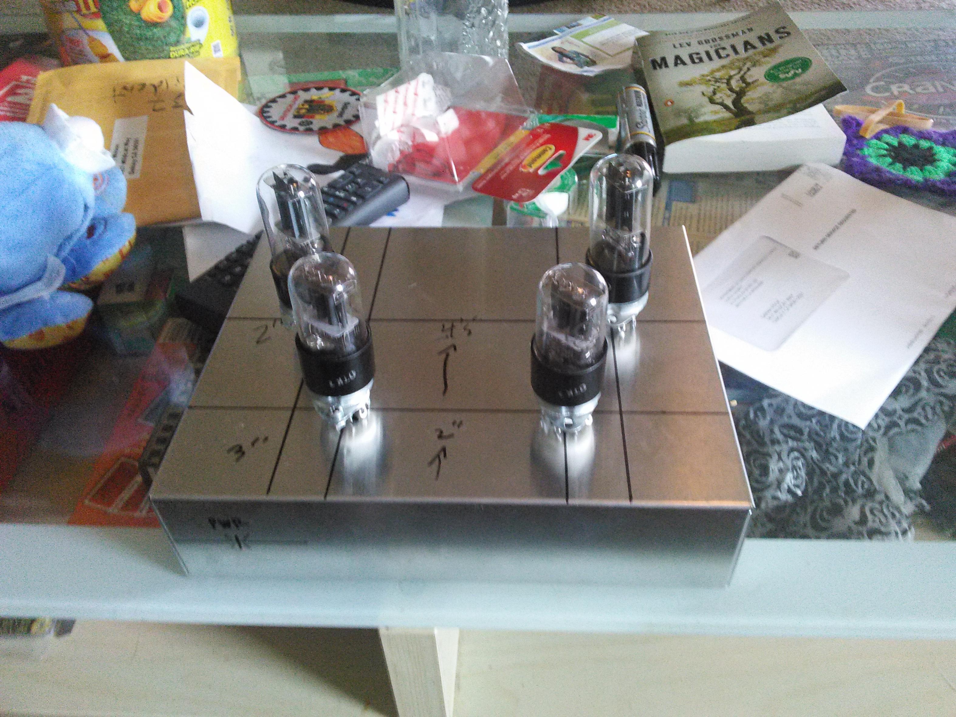

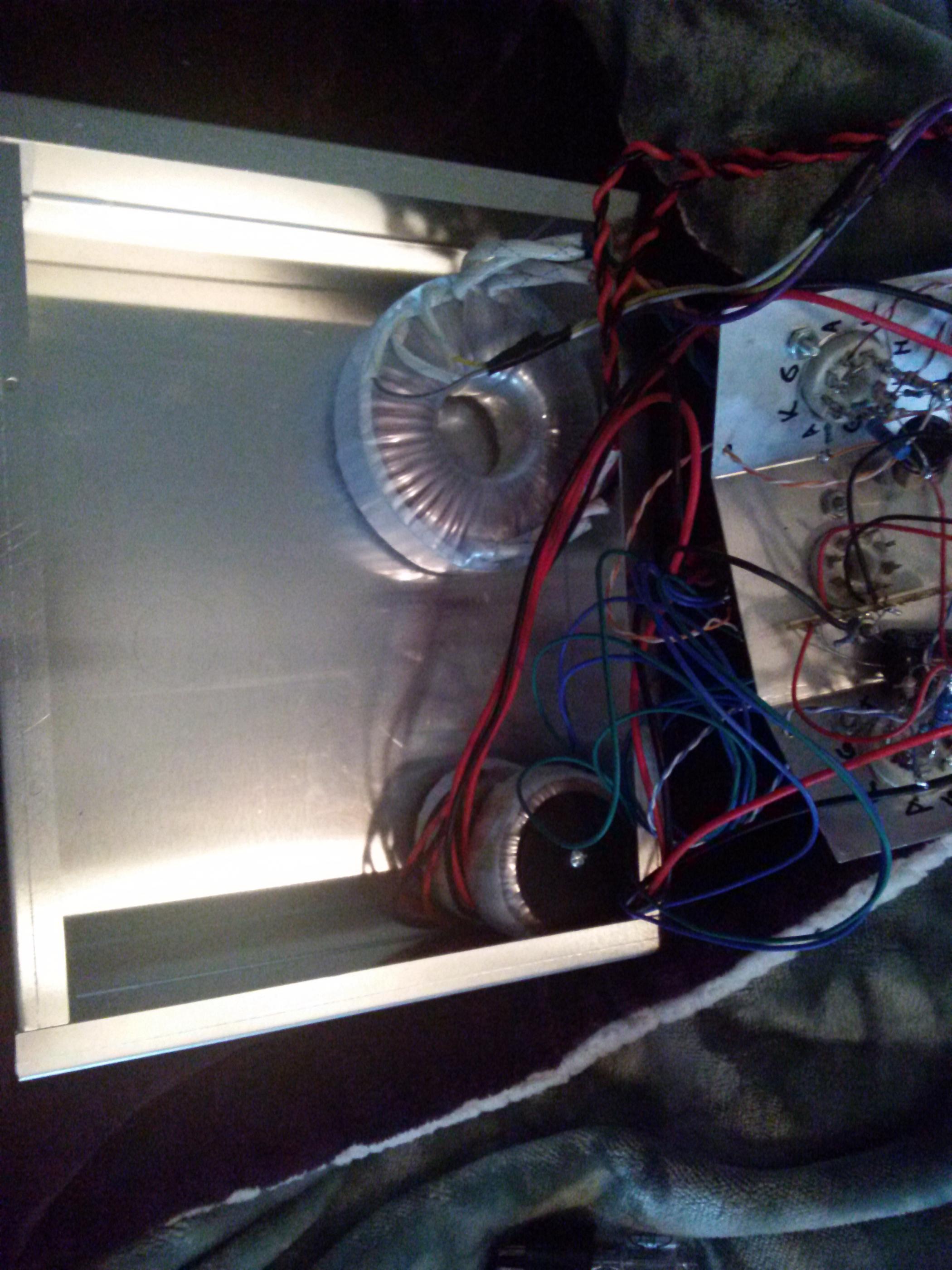

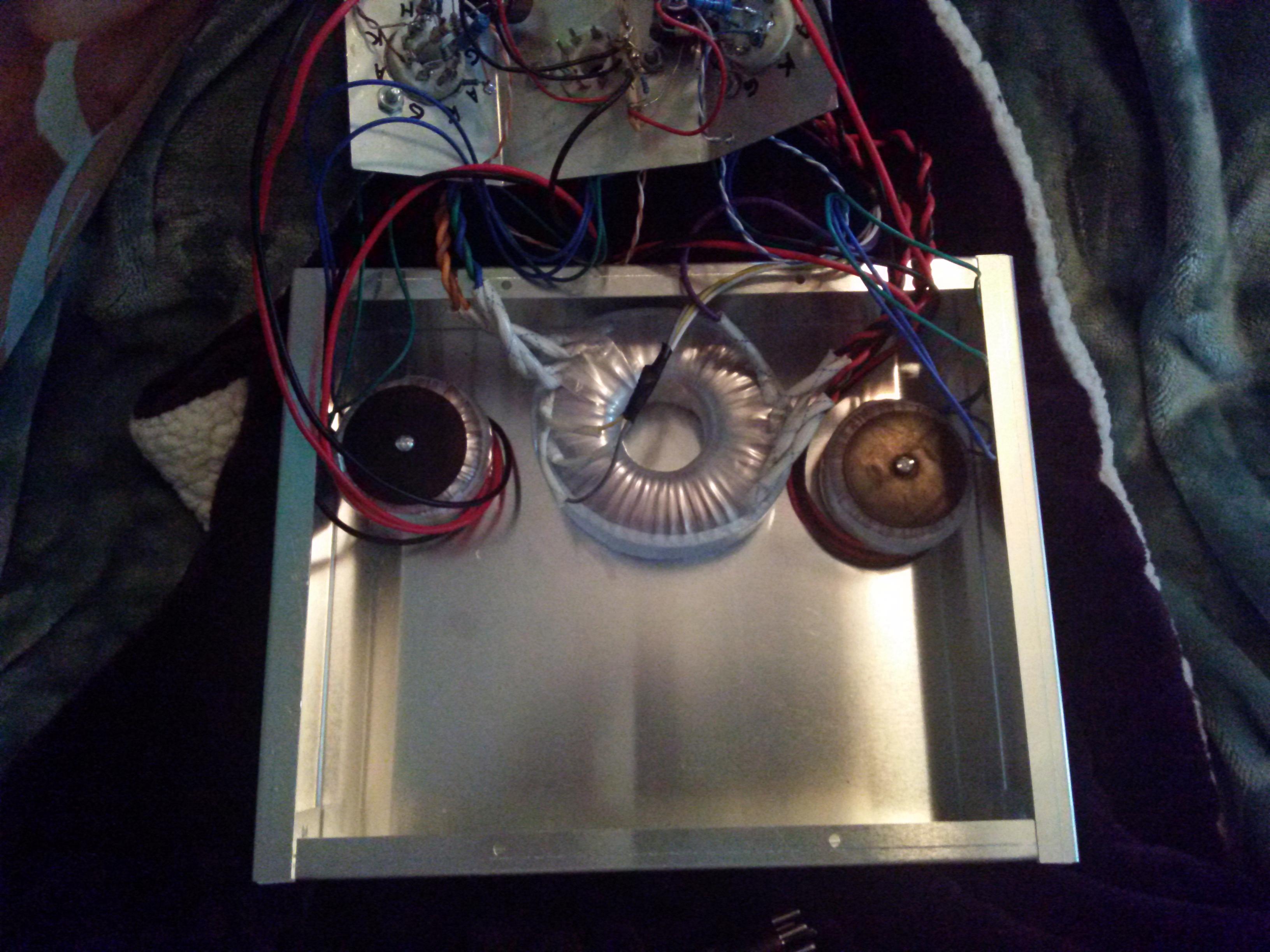

Got my chassis yesterday, and pulled out the tangled mess of wiring prototype to see how the transformers fit. The box is an aluminum 10x8x2.5" Bud industries AC-1418, I had some credit on Amazon, so I grabbed it. Looks like aa good size box, and if using smaller tubes with top mounted output transformers, you could probably squeeze an EL84 or similar push pull amp into it without too much fuss.
I see I will have enough room for sure, but unsure how to go with the transformer orientation. With such low power levels, would I be fine with the transformers all on the same plane, or should I plan on mounting the outputs sideways as shown? Sideways would be easy to do, and give more room.
Also, power switch will be one of these-
Would it be better to hug the chassis with the wiring the same way I would my heater wiring, tightly twisted, or would it be better to use shielded cable and just go straight to the front panel? I plan on putting the switch center left or dead center on the front panel.

In my spud I actually mounted the two OT on the same bolt stacked wise. No noticable crosstalk can be detected. These toroidals are robustly immune from stray pickups.
Shoog
Hmmmm, something like the attached picture then? Maybe I can squeeze an IEC inlet in the ccorner between the trafo and the chassis...

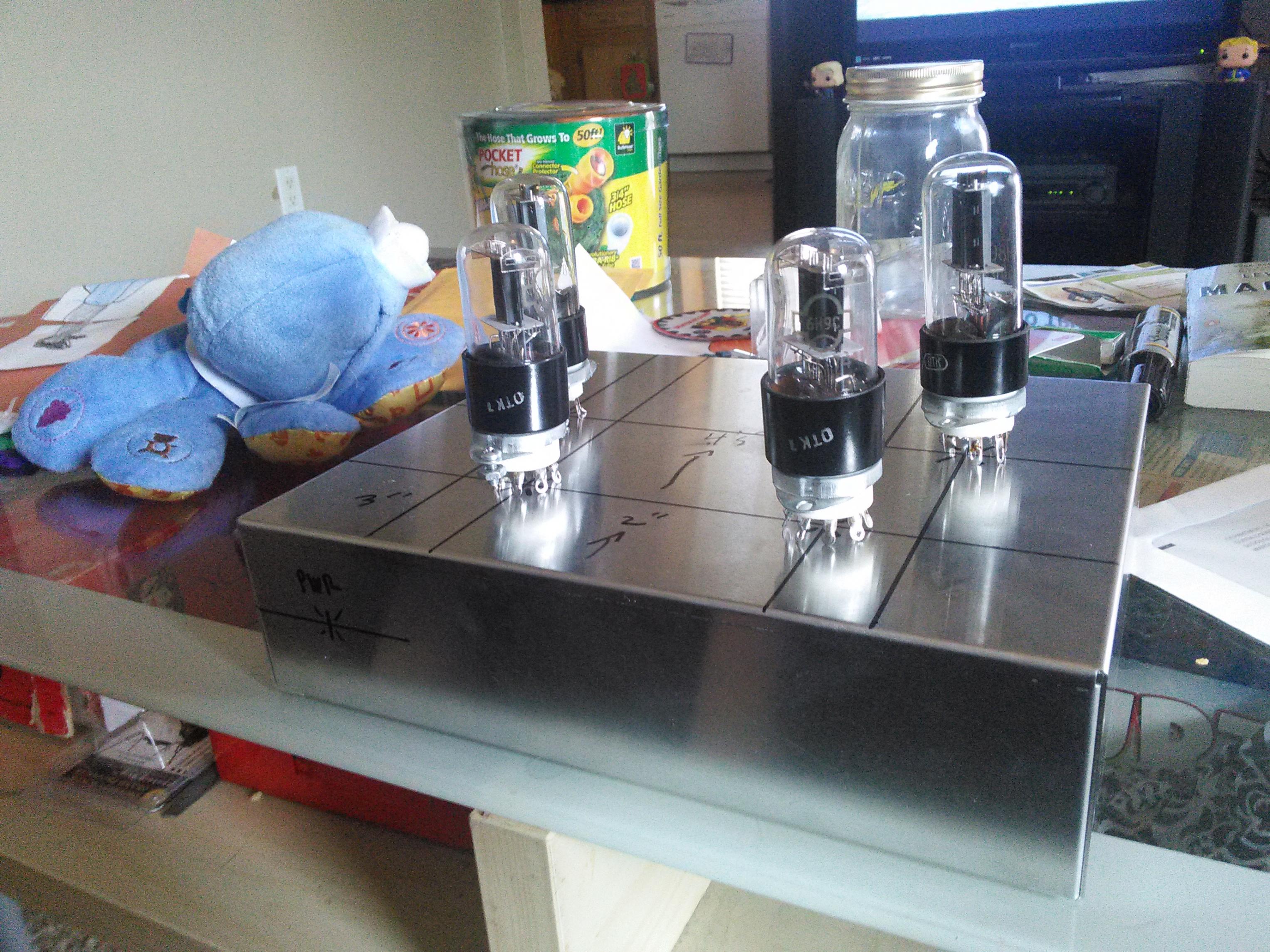

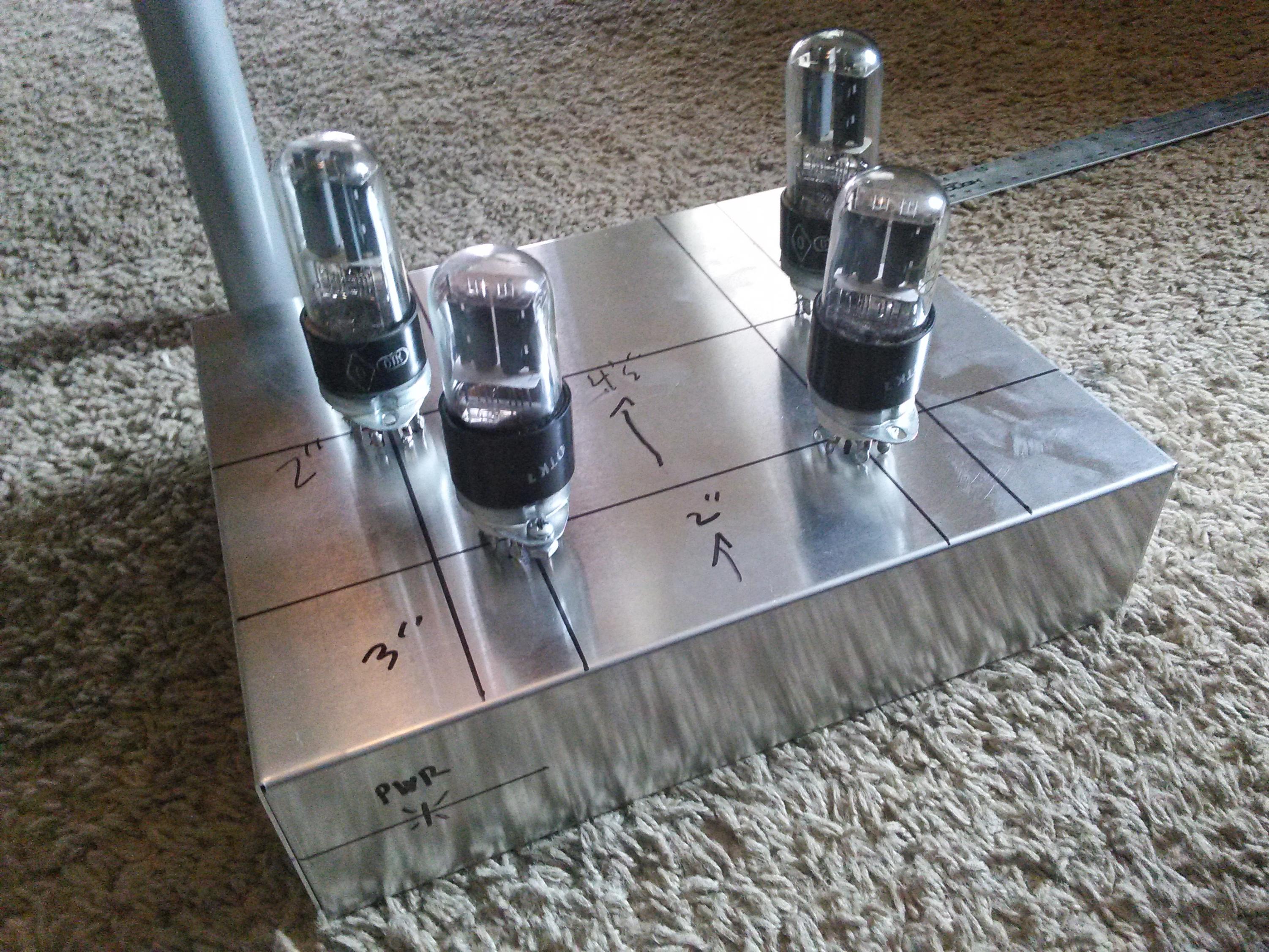

Quick layout for sockets and power switch. I like this size for the chassis. Definitely going to grab another one for another project.

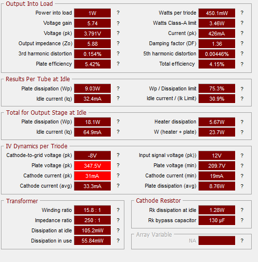

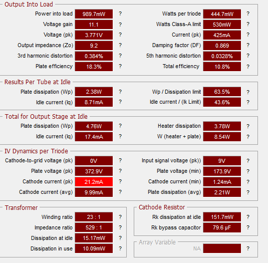

Bored at work, but have my laptop with me, so I spent a bit of time playing around with the Push-pull Amp Cad program from TubeCad. Interestingly, my estimates were pretty darn close! looks like just under a watt, and from previous experience, this program is surprisingly pretty accurate, usually gets most values within 5%. Both of these are running on 300 volt supply, and using a shared cathode resistor, but that shouldn't make a terribly large difference, and if anything the individual cathode resistors of the finished amplifier should give lower distortion than a shared resistor.
This was simmed using the 16928 ohm transformer values, and interestingly doesn't reduce 3H when doubling the transformer impedance. I of course will try to get real measurements once I am able, but it looks promising so far. I have a feeling once the feedback is wrapped around the little guy it will measure better than simmed. I've also attached the sim results from a 6V6 triode connected pair with an 8k OPT, and signal levels adjusted to give similar output power. Not too shabby for a single dual triode to do this well against the venerable 6V6 for a low power design. I will play with higher voltage too, as it looks like just around ~2 watt is possible with 375 volt supply. I might grab a pair of GTA type tubes to play with running them at higher dissipation, as the russian tubes are more or less equivalent to the 6SN7GT types, and not the higher spec GTA/GTB types.
