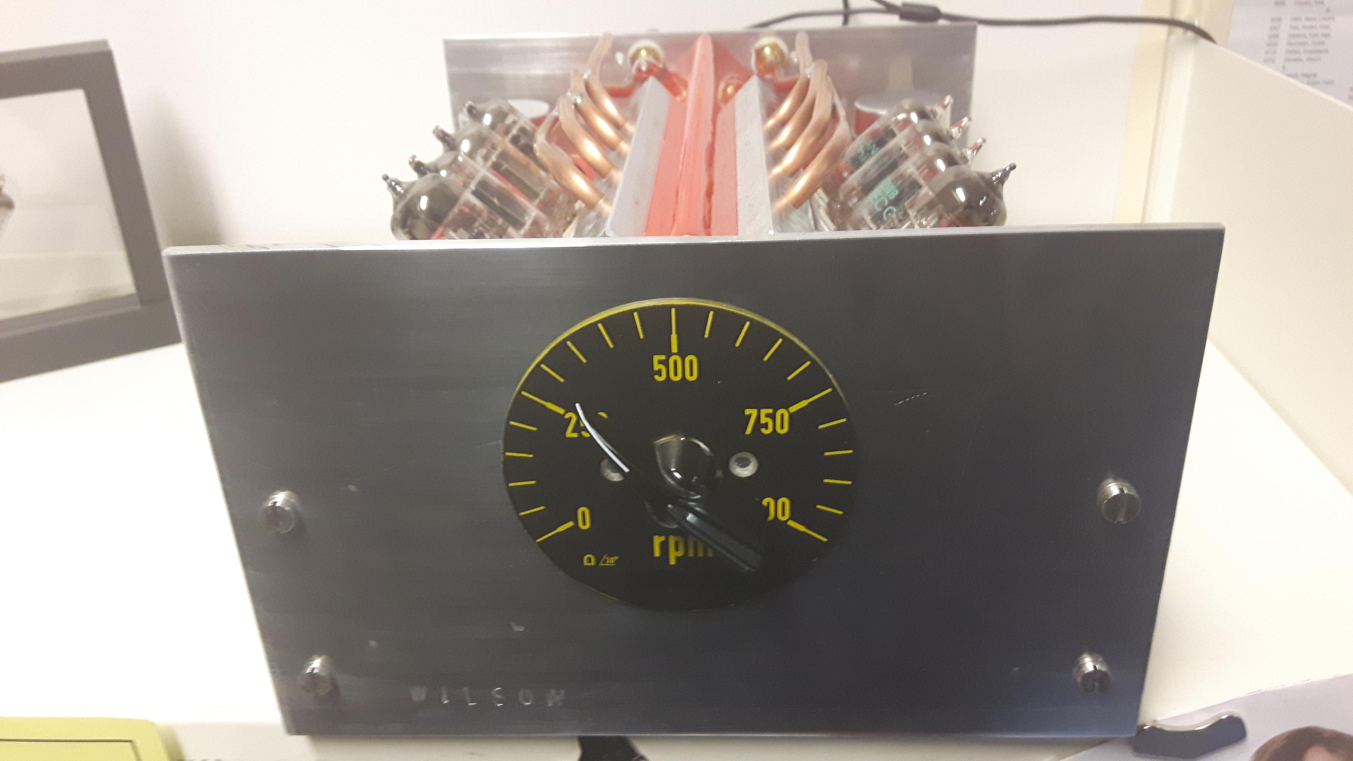

I can attest that garter bias is a great system for biasing up an amp like this. I build a PL82 PP amp with garter bias and it sounds great.
However 6AS7 project its going to be very wasteful. I suggest digging into the Tubecad articles a bit deeper because he showed another garter bias arrangement which used transistors which saved a lot on the voltage overhead. I built a 5687 preamp with wilson current mirrors for equal bias on both sides, and the tubcad article I mentioned is a hybrid of pure garter and current mirror.

Very little. Less than 1watt. That was another one of those 'use the parts in the bin' project and the b+ is a lousy 200volts. I have also built this pse with 3 5687 and one 6922 per ch.
That's effin' rad dude! Gives me ideas for parallel push pull designs now! Six bottles per side for a fancy V12 amp with something like EL84 or 6V6 would be sweet, and I just so happen to have a dozen of each on hand if I'm not mistaken...

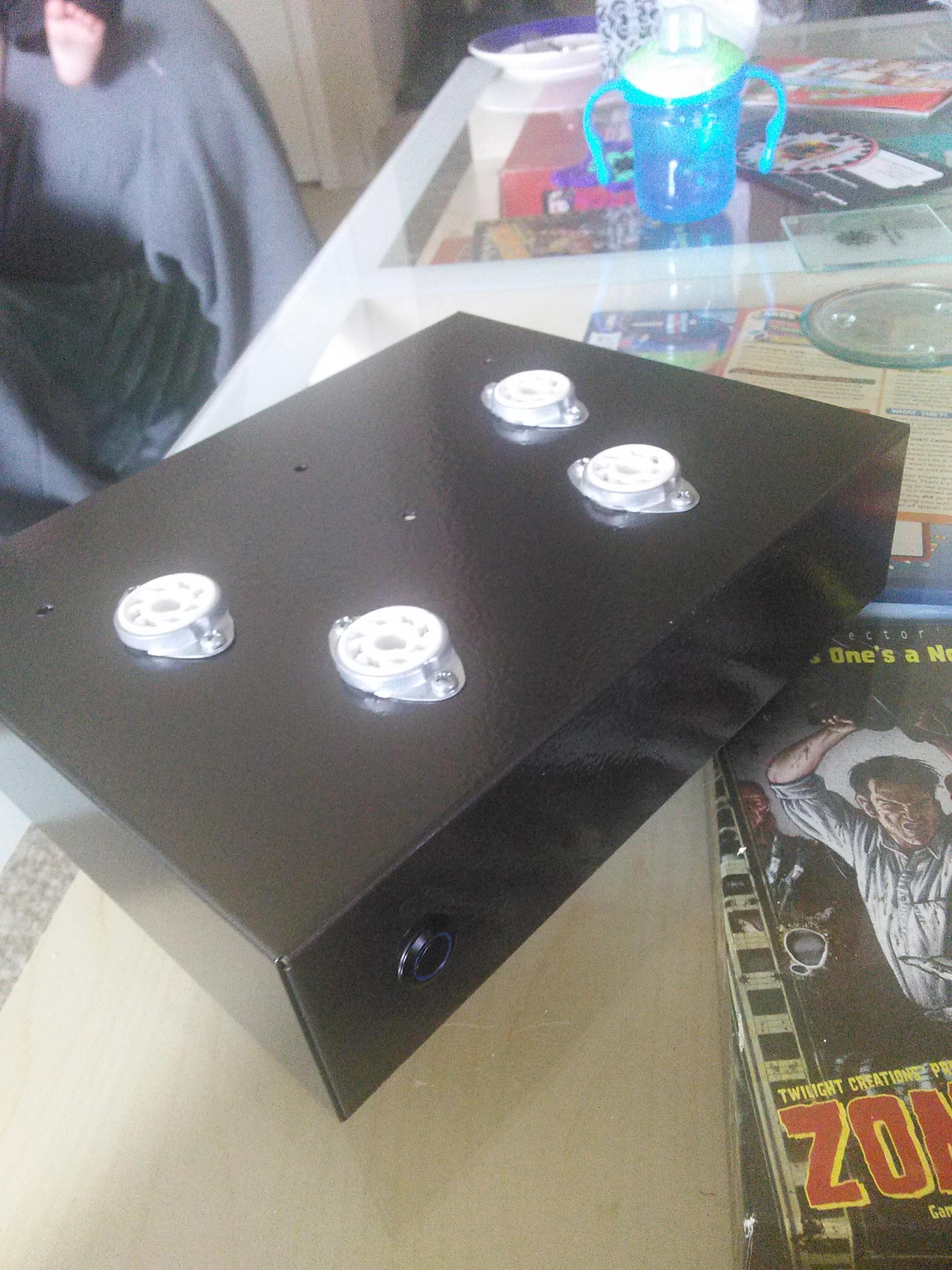

Got a few holes drilled, then had to do daddy stuff. Got a 9 volt on the power LED just to get myself some hype for the build. Should look nice once it's painted black.

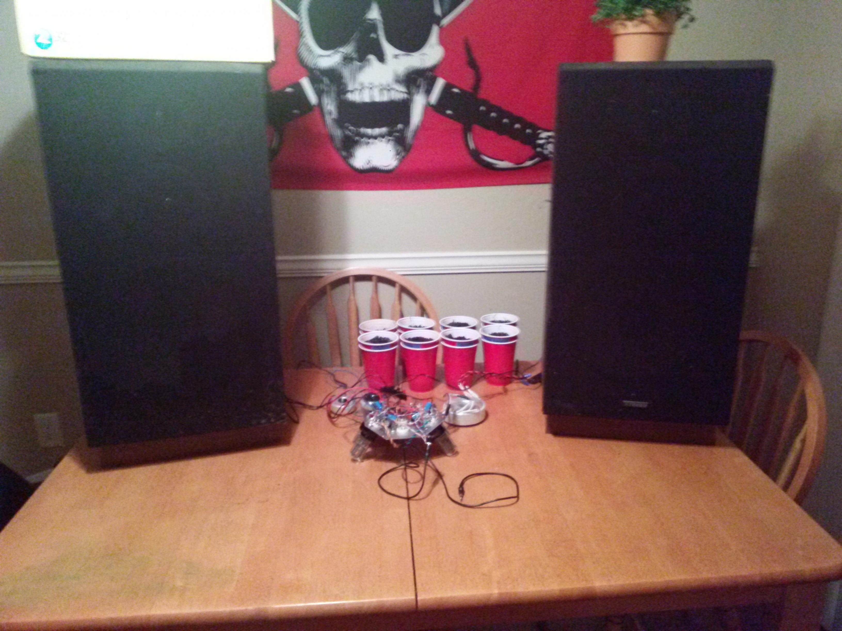

After the kids went to bed I dug out and hooked up the big Fisher 825 cabs for some more listening tests. This thing makes BASS! Most music sounds good in general, but anything with lots of synthesized sound is phenomenal, Depeche Mode in particular! I can't wait to get this thing finished up in the chassis, and start on another one for the garage.

Got it painted with some rustoleum hammered paint, this stuff is nice for hiding imperfections and scrapes, highly recommended. Also got the jacks and power switch in. I went with a center layout for the power transformer, otherwise the front of the amp would be cramped with all the sockets, and I wanted a wider layout. Hum shouldn't be an issue at such low current judging by past experience.
Now I just have to bolt down the transformers and start final construction!

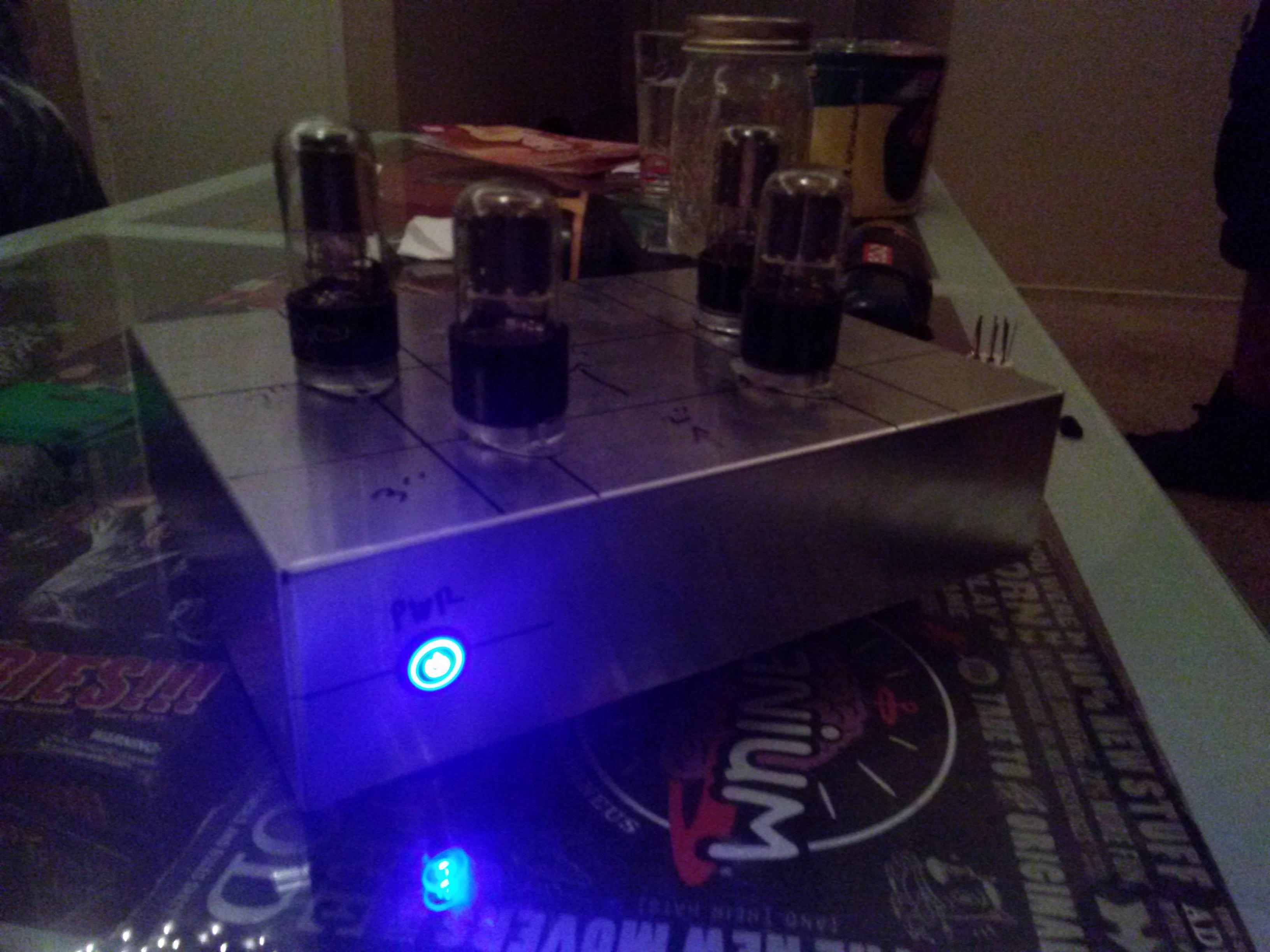

So, I've been so busy that this thing was sitting half finished for a good long while. We moved recently, and I just dug it out to finish it up. Just need to wire up the filaments, power jack and switch, and a few little things, and now I'm second guessing my power supply. I was originally going to do a CRCRCRC type of filter, but might go for a mosfet capacitance multiplier instead. Any thoughts? I'm thinking that an IRF820 and a single preceding CRC would be plenty, and drop less voltage.
