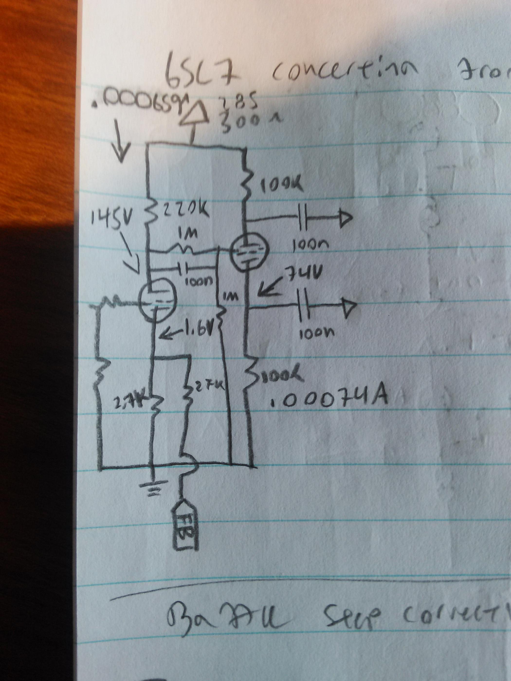

Minor changes to the schematic as well. The input stage (attached) now has my now customary concertina splitter arrangement, that uses the divided down DC bias voltage, with AC shunted to the grid. It works fantastic, and I highly recommend you try it.

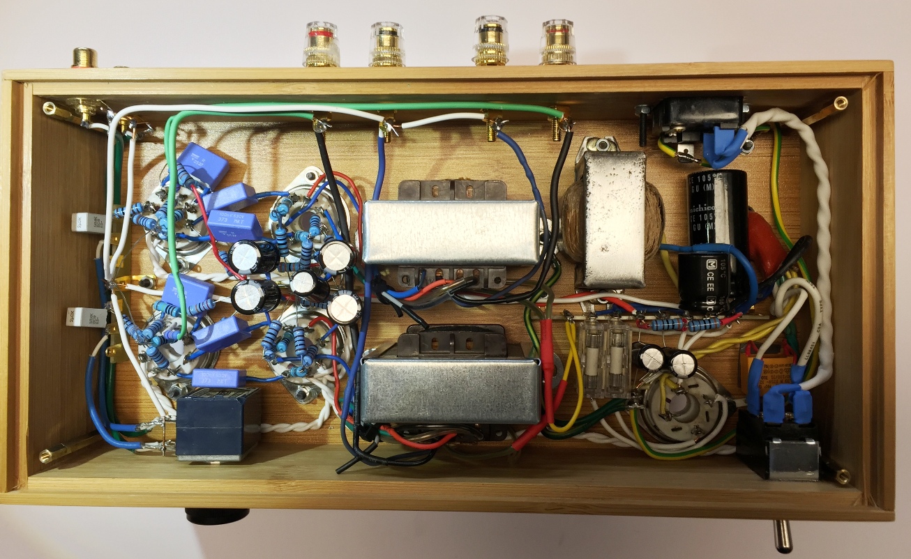

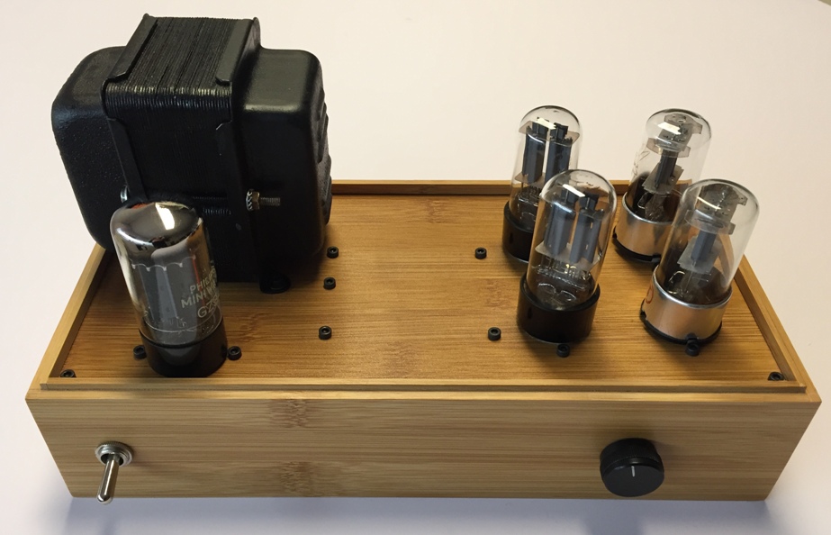

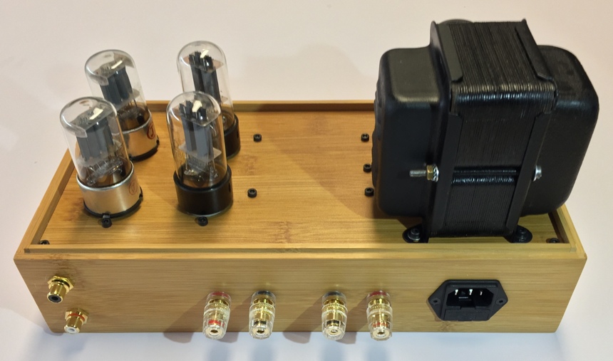

This is my version of the Lingwendil amplifier, with tube power supply. It works well, no hum and good stability. It is one of my best sounding small amplifiers: post #65 is not an exageration. Beside the power supply, the only difference from the original schematic is the value of the cathode resistor on the first 6SL7. I used 3K instead of 2k7, because this is the same resistor value I used on the power supply section.
It has been a no-cost weekend build, with parts I already had. The chassis is a repurposed Zeller 13333 box from Amazon (30x15x7cm), it is cheap and easy to drill. Heat dissipation is poor, but this is definitely not a issue here. I also needed a comparatively high chassis to squeeze the tubes in a small place, because this way I was able to arrange some resistors in a vertical fashion under the sockets. The power transformer and the filter choke are from a late '40 tube radio. I never used iron so old on my builds before, due to safety concerns, but this transformer was in great conditions and the total current drain is so low that it remains cold, so a paper insulation breakdown is unlikely. Of course it has been througly checked, repainted, opened, and all the failing rubber wires have been replaced. I like parts that looks old, and this one surely is.
Output transformers had come out from a late '60 Saba radio with push-pull ECLL800 output tubes. They are rated 11K primary to 4 ohm secondary, 8W. The primary is split on two (maybe four) sections, and there is an auxiliary feedback winding that I left unconnected. My speakers are rated 6 ohms so the reflected impedence is in the ballpark of the design. Ceramic tube sockets are reclaimed from old equipment. I was about to use new cheap chinese sockets, but after a ultrasonic cleaning bath with soapy water the old sockets came out as good as new, and they are far better. I had a 10K RK27 Alps volume potentimeter in the drawer so I used it; I would have rather bought a 100K one. All other components are new, the values are so common that I had plenty of them on my drawers. I used Nichicon and Vishay capacitors.
The build was easy and component placement straightforward. I rotated the socket key of the output tubes 90 degrees relative to input tubes, this way the coupling capacitors have a parallel arrangement. Looking back at other builds with unconventional designs, I put the finished but never turned on amplifier on a shelf for a few days, in preparation for a long fault-finding session. Well, the Lingwendil statement at post #18 is true: I turned on the amplifier ...and it worked. No oscillations. No hum. All the voltages are spot-on. Nothing else to do, just connect the good speakers and listen to music. I haven't been able to test this amplifier on high-end speakers, but it looks promising. Compared to other small amplifier with global feedback I have, it sounds better (to me) than a Mullard three-watt clone with ECL86 and pretty good output transformers. It even drives comparatively inefficient Q-acoustic 3020 speakers plus passive sub (8 inch driver) at the standard volume I'm used to listen. Low frequencies are reproduced just fine.
A big thank you to Lingwendil for this successful new twist to the PP 6SN7 / 6SL7 small amplifier design.

Minor observation, on your schematic, did you omit the 1M resistor from the concertina splitter grid to ground? It will work without it, but will work better with it in place.
Joined 2015
My bad, it was a drawing error, I re-uploaded the correct schematic. Your design really surpassed my expectations. By the way, what is the purpose of the parallel between 1M resistor and 100nF capacitor on the coupling between the plate of the first stage and the splitter grid? I haven't seen this arrangement on other amplifiers of this type.

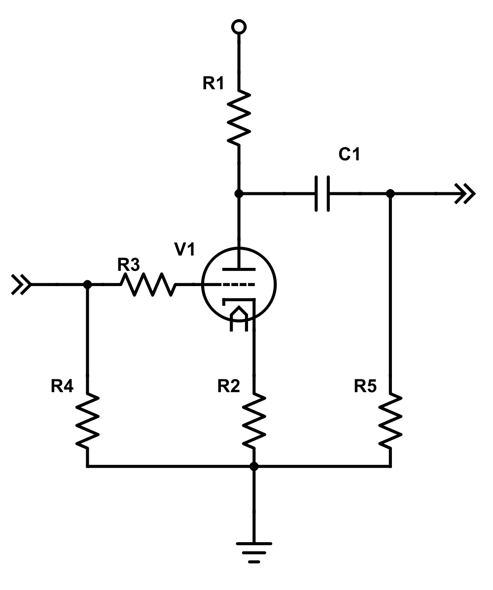

You could build this with a 6N3P for about $2 for stereo if you already have power :) Yes I know the PSRR sucks, but clean DC is less complex than good PSRR :)

Definitely something like that, maybe as a CCDA or with an IRF820 source follower. Could even crank up the current on the source follower to make a simple amp to drive tweeters, super versatile :) Good PSU's are super easy, so I don't fret on PSRR for such low demand circuits.
I've got a dozen 6CG7, a few 12SN7, and a few other bits earmarked for a preamp build. With such cathode degeneration, a 6SN7 type will do a gain of ~10 in such a circuit, which should work. I really want to do something with the subminiature 6N16B, but the gain would be more than needed for such a simple boost. I've even considered doing a triode connected 6V6 per channel as in Salas' thread for a nice little rig, or ordering some 6P15P since they have such nice triode curves. 6N3P is on my list too. Especially since I just came up on a chassis with a pair of big integral heatsinks for a potential Pass F4 build, I may start making up a few simple preamps to play with :) Too many options, just need to order up a couple more Bud Industries cases to knock out some more projects.

I especially like the 1 MΩ + 1 MΩ input stage anode output DC divider. It solves the “setpoint problem” for the following phase inverter stage nicely. The 100 nF bypass cap then delivers all of the signal. Again, nice touch: simpler than what I generally advise. Since its "all the same" to the finals, I'd be inclined to just double 'em up with separate 'garter' biases as pairs to double their current output and power. Still essentially flea powered. || tubes || are a good thing.

Thanks! Is has been a low effort build, two days start to finish. I exploited the circuit symmetry and low power dissipation; pieces fell into place with little planning. This bamboo box is a timesaver when used as a chassis. The wood finish is nice. Very inexpensive, no need to use extreme care: at the worst I would have simply started over with another one. The bottom (now the top) is thin medium density fibreboard with a nicely done photofinish layer; precision drilling and filing was easy and took a very short time. This couldn't have worked with a regular power amplifier design. I once tried and I got severe overheating. I already had a Hammond alluminium chassis ready, but ultimately there is no need to use it. The vacuum tube power supply works very well.
