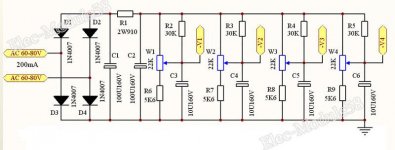

The 6AS7/6N13S garter bias arrangement I've mentioned previously (100mA,100v,-33bias) is about the furthest I would go in running garter bias, and this particular set of numbers just happens to use bog-standard common values for parts and voltage, so it's very easy to implement. Grab a sack of 10W, 330R wirewound resistors, a 120VAC transformer, a handful of 100V+ electrolytic capacitors for bypass and a couple 330k-1M or so grid resistors, PSU diodes/caps, and build it. Easy peasy and cost effective. Trivial to add a HV driver stage to. Possibly my favorite tube and operating point if running open loop, good for playing comfy music and smooching on your woman, too 🙂
Silent. And you can power it with DC if you like as the diodes will flip it the correct direction. I've even used an boost converter with great results.In any case, not sure I fully understand it but that's an interesting bias arrangement you have there kodabmx! Is it pretty quiet?

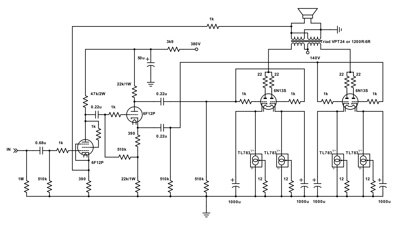

Then there is my other preferred cathode biasing: CCS bypassed with a large cap. It's basically a programmable resistor... LM317 for up to about 30V, TL783 for up to about 100V (I like to leave a safety margin on the max voltage of ICs).
Here's an example of what I did with the 6N13S (6AS7G, 6080) before I changed to the above fixed biasing circuit.
Yes, I ultimately plan to try the "CCS" bias approach too, and compare it with the garter. I hadn't looked into higher voltage regulators like the TLs yet but I know they are out there. I want to approximate the same operating points for a reasonable comparison. But I just love the simplicity of the garter and the minds that came up with it in the absence of transistors! I suppose I could even try a tube CCS...

I've never done an LTP, but I've used CCS for the cathodes before. I usually use LM317 or TL783. Wouldn't those work in an LTP?
They'll work, but a discrete CCS would work better. Bypassed they work well, but if running as a true LTP/Differential a higher impedance CCS is nicer to interact with things less.
