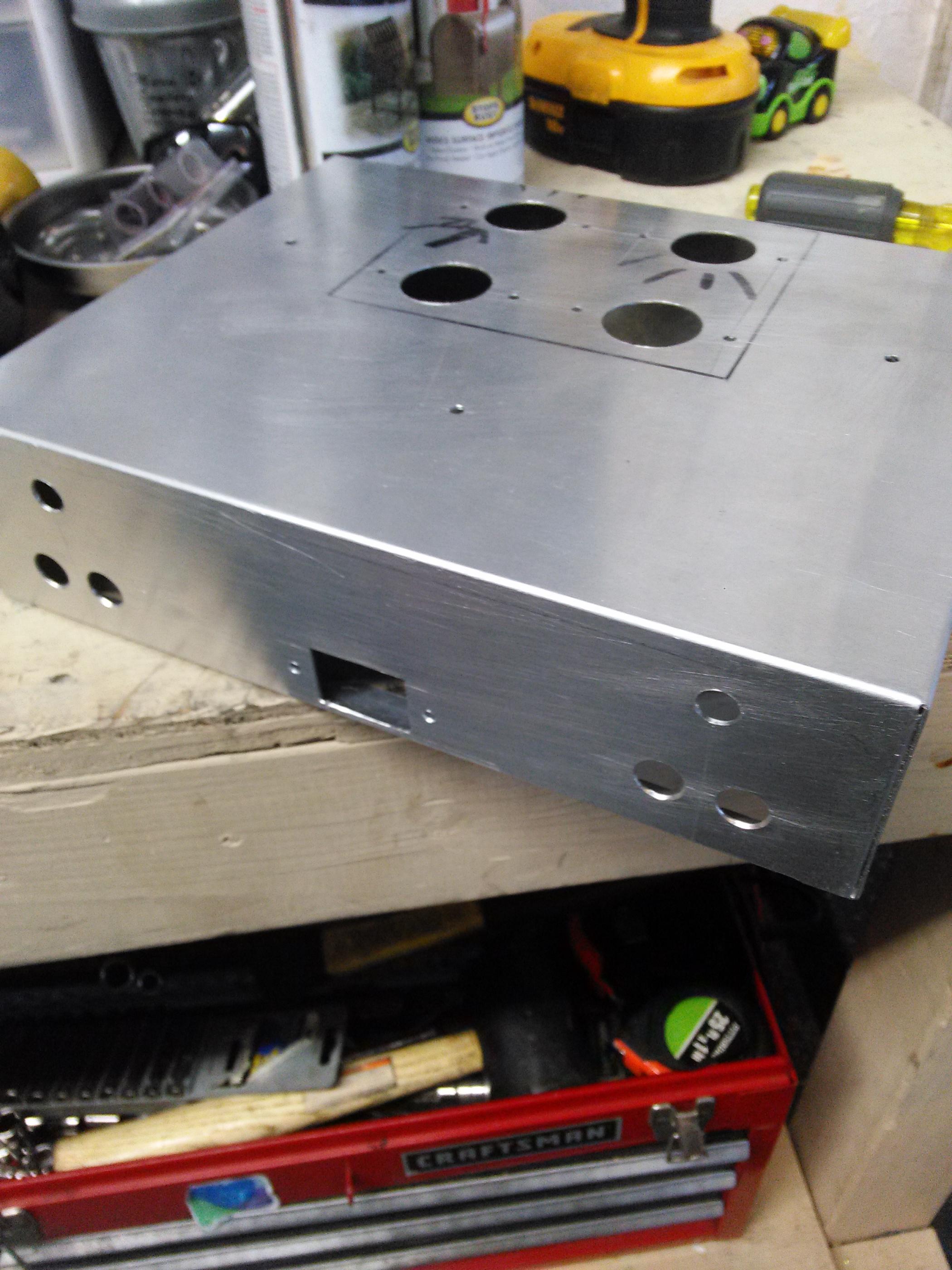

I need to clean up the holes in the chassis for the input tubes (the bit wandered, so i need to oblong the holes a bit, they are visibly skewed) and throw some paint on it. I still can't find my 12AT7 tubes to try out, unfortunately. This noval board build will use a small SMPS module set for 315 volts at the output tube plates, for 2.6W idle dissipation per 6SN7 triode. I have it all running off of a 4A,12 volt DC power supply, with series-connected heaters for the tubes. Dead silent without signal

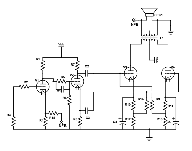

Since work is slow enough to give me some design time to play around, I'm working up a cleaner version of the schematic, and even a build guide to accompany the boards. I've been strapped for cash and have very little spare time, so I haven't sent any boards out yet, and I am sorry. The engine on my beloved 73 Super Beetle (daily driver of 160-odd miles a day, 6 days a week!) decided to seize on the highway on Christmas of all days, and this was just after the family SUV developed a misfire on cylinders 3 and 4. Luck has been my enemy as of late

Yeah, there's not really an "off the shelf" transformer to use here without some creative miswiring/load mismatching, or being creative with running alternative types like the toroids that I'm using. There are inherent issues when using any transformer at such high reflected load impedance, so they aren't very common at all for higher bandwidth applications, as there is often a rolloff at high frequency due to parasitic losses due to capacitance and other wonderful nonideal issues.
This design does not claim to be the lowest distortion and flattest frequency response, but due to the design goals of low average output/listening levels, a slightly lower than ideal load impedance, and the use of overall negative feedback it is drawn into a very useful and lovely sounding amplifier, that works out very well in spite of the nonideal issues. The amplifier is in class A up to about 1/2W depending on your chosen operating point, and this keeps distortion acceptable by keeping the reflected load higher than the overall ratio dictates.

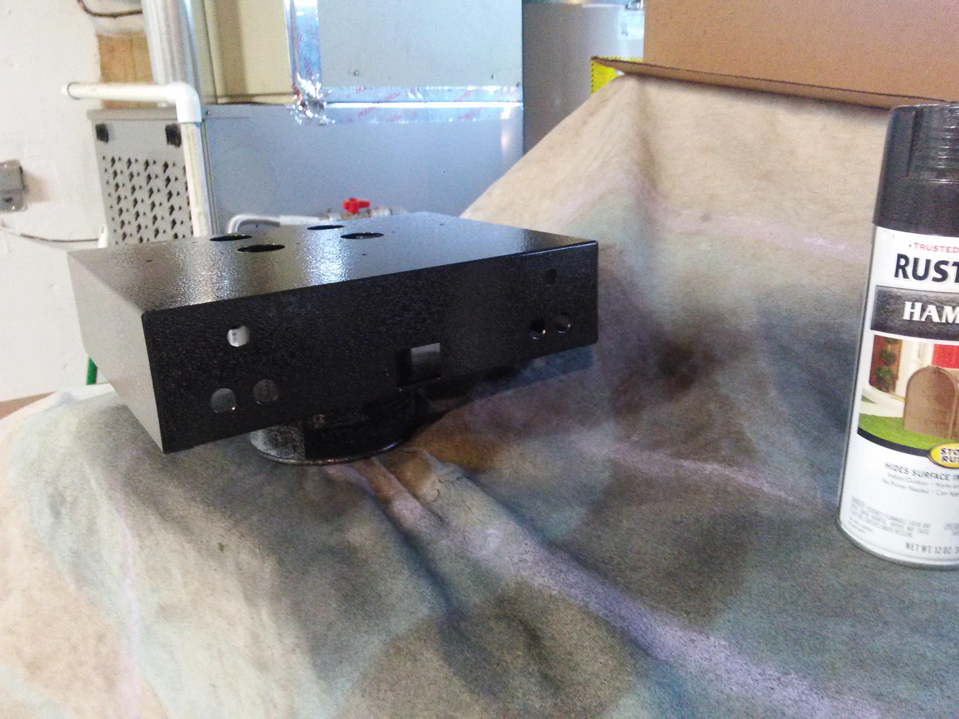

Small update on things, It was pouring and storming outside yesterday, keeping me from doing car stuff, so I was able to do a little bit of chassis work on the build using the noval board. Cut out the IEC inlet, and cleaned up the holes for the input tubes. Gave it a scrub with some sandpaper to take the edges off, and hit it with some hammered paint. I'll give it a few days to set (it's been pretty cold lately) and start on final assembly.
