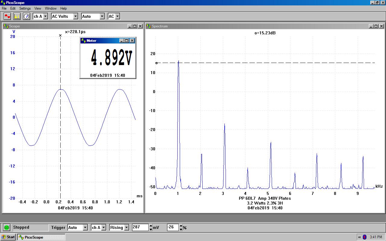

Betty Crocker Special PP 6BL7 3 Watts

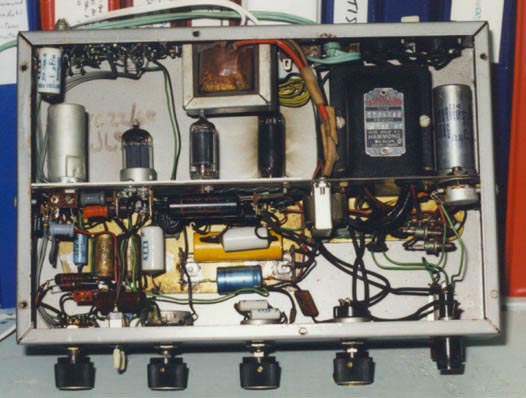

Finally got back on this one, been looking at the PPP6080 I built 20yrs ago.
This iteration of the Betty Crocker uses a differential driver, something I've preferred for more than 20yrs. Equalization to the output is straight forward.
On this one I used a NPN cathode drain, the balance is very good. The schema is attached, the full schematic to be posted later. The 6SN7 vers performed a little better with this driver.
More info to follow.

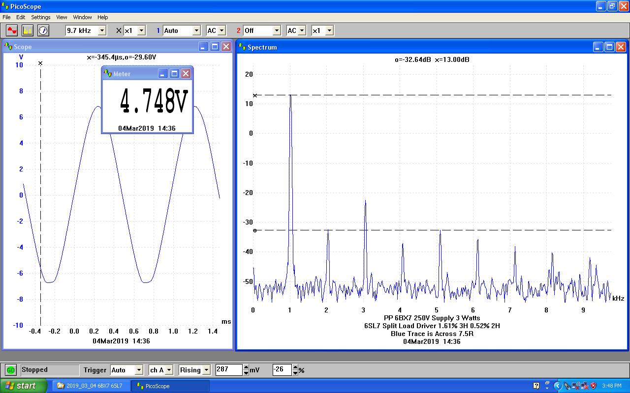

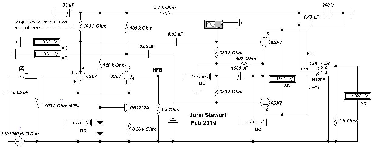

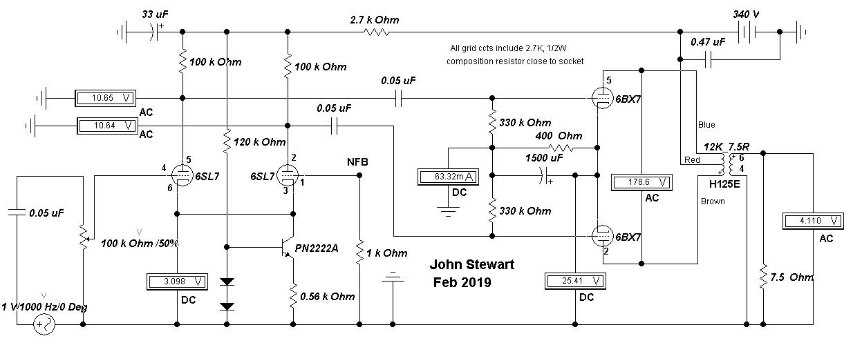

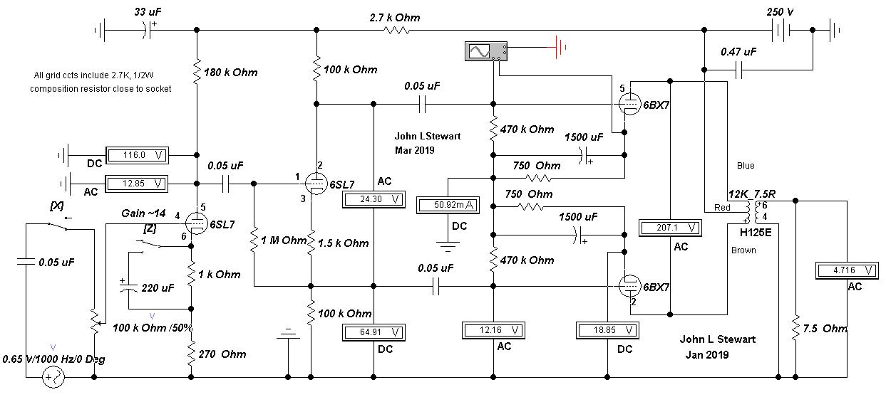

PP 6BX7 Amplifier

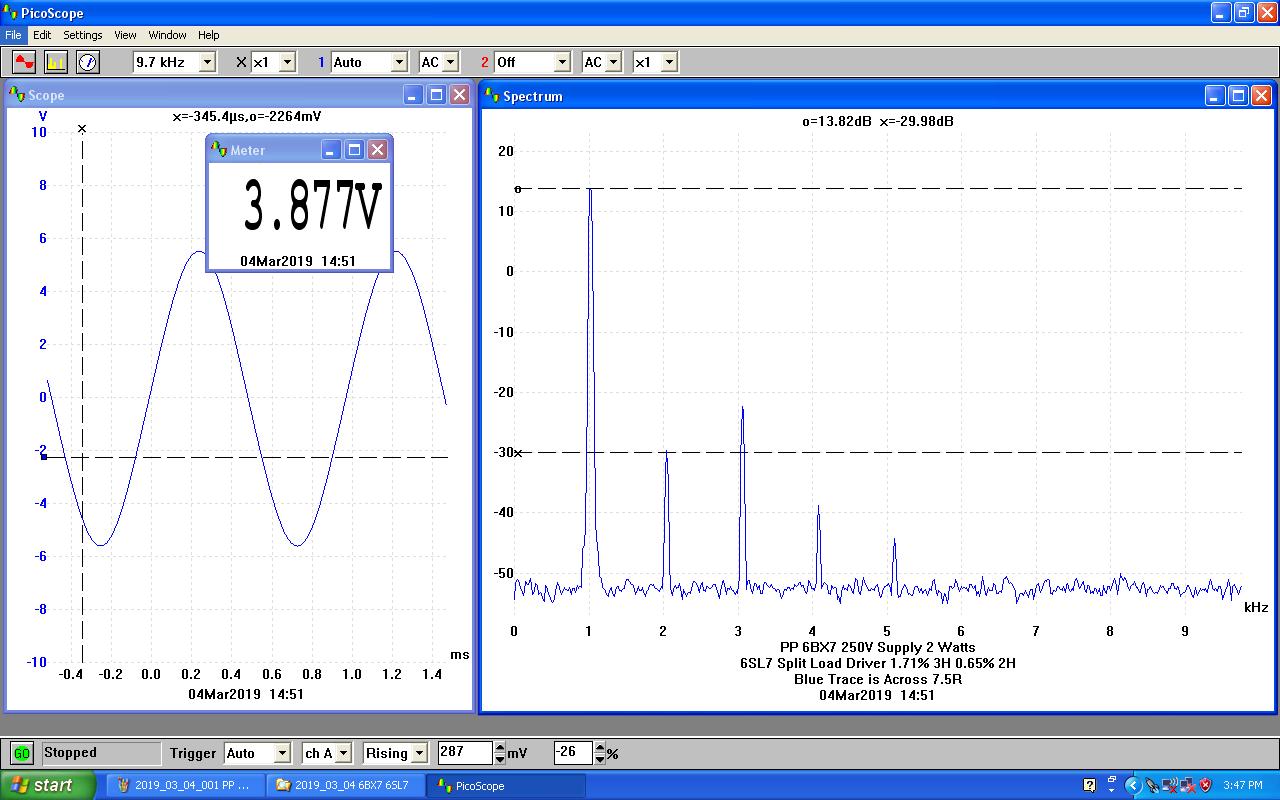

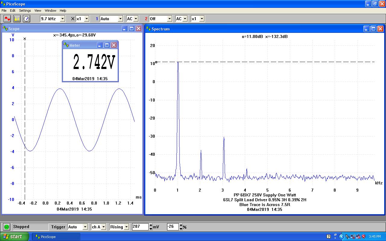

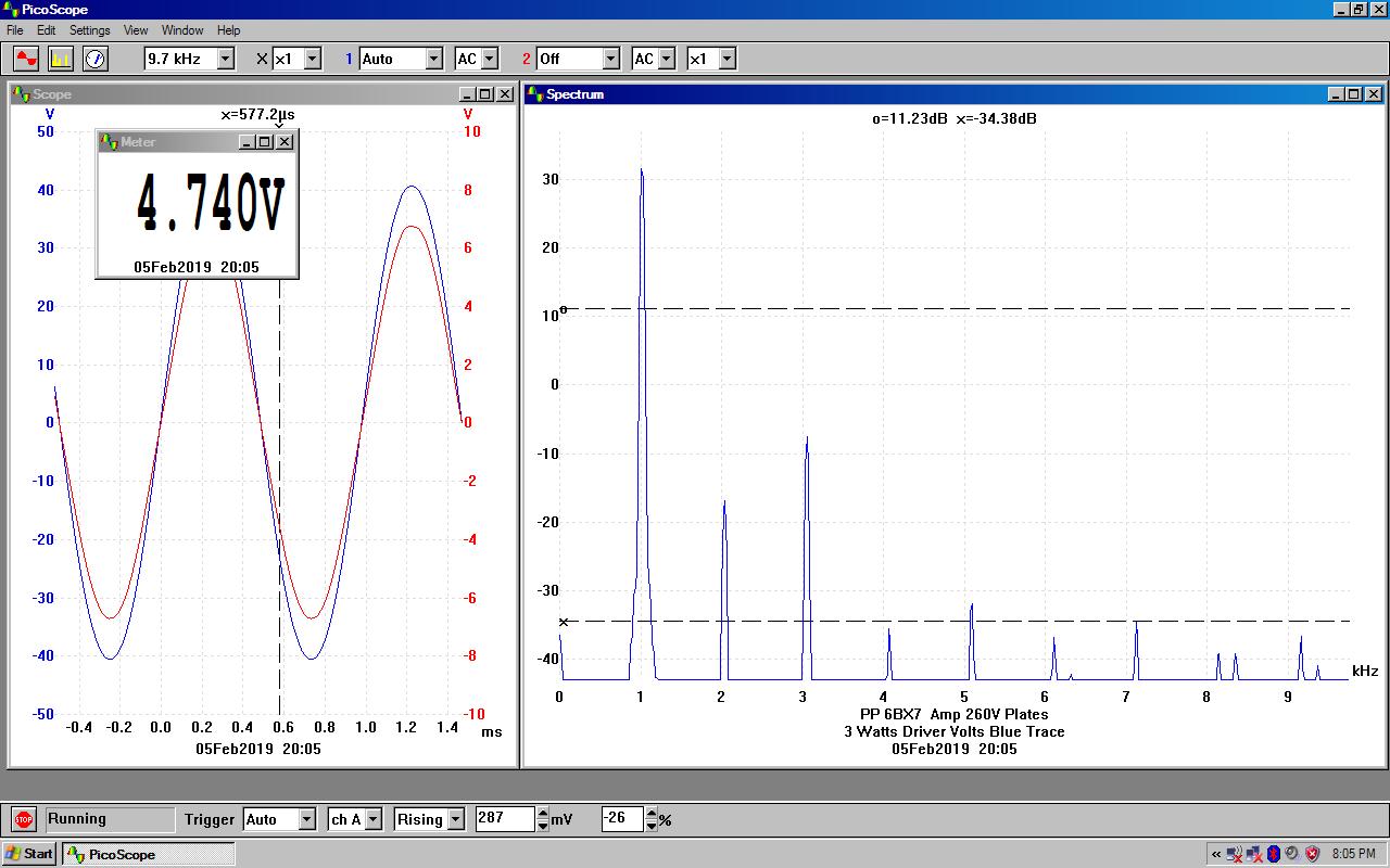

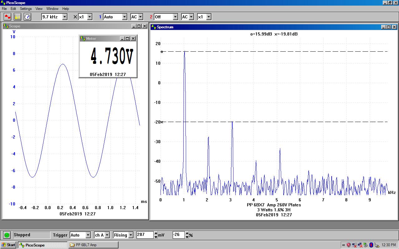

Here are the results for the PP 6BX7 version of the amplifier. Power output at clipping is just over 3W, same as the 6BL7 version. Both are limited by the maximum plate dissipation of 12W for these tubes.
Distortion results are shewn for both one & three watts into a 7.5R load resister. There are very few harmonics above the 5th all the way up to 3W. Clipping stars at about 3.2W. Another result shews the performance of the driver (blue trace) superimposed on the output (red).
I found the zero signal standing current measured was not the same as the simulation indicated. I believe that to be caused by the very simple model used by the simulation software to work as a triode.
The actual standing cathode current when running a 260V PS is 19.1V / 0.4K or 48 mA. That is the operating point set so that dissipation limits of the 6BX7 are not exceeded. Did the same thing for the 6BL7 version.
The internal resistance of the amplifier as seen by the speaker is 3.16 R. About 0.5R of that is due to the OPT. A different OPT would yield different results. As is, the Damping Factor is 2.37, typical for triode amplifier running without NFB.
With the Hammond 125E OPT the 3db down frequencies are 26 Hz & 25 KHz.
I prefer this version of the amplifier for the following reasons. Firstly, it runs on a relatively lower voltage power supply, a plus for reasons of safety. Rather than an expensive tubephile power transformer, one of the industrial 120/240V power transformers could be used to supply the B+. A full bridge rectifier of silicon diodes or half diodes & half FW vacuum rectifier are possible.
If a vacuum rectifier were to be used a 6X5GT would do. And has a similar appearance to the other tubes, some folks might prefer.
The power transformer in the bridge mod is somewhat more efficient then a CT HV supply. The entire secondary winding is used all the time. Not so for the FW CT version, something designers call ‘Utilization Factor’.
For a chassis built for stereo a 6AX5GT rectifier would work well.
Still need a heater transformer.

Somehow the schematic for the 6BX7 vers got left out. So here it is.

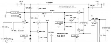

Just noticed the 6BX7 schematic posted is an older version. So here is the final.
I like this amp more than the others tried. Very straight forward. And it will tolerate a variety of OPTs that provide the correct loading. PS looks easy & cheap. 6BX7s used to be much cheaper than 6SN7s.

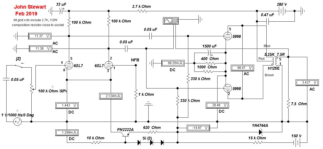

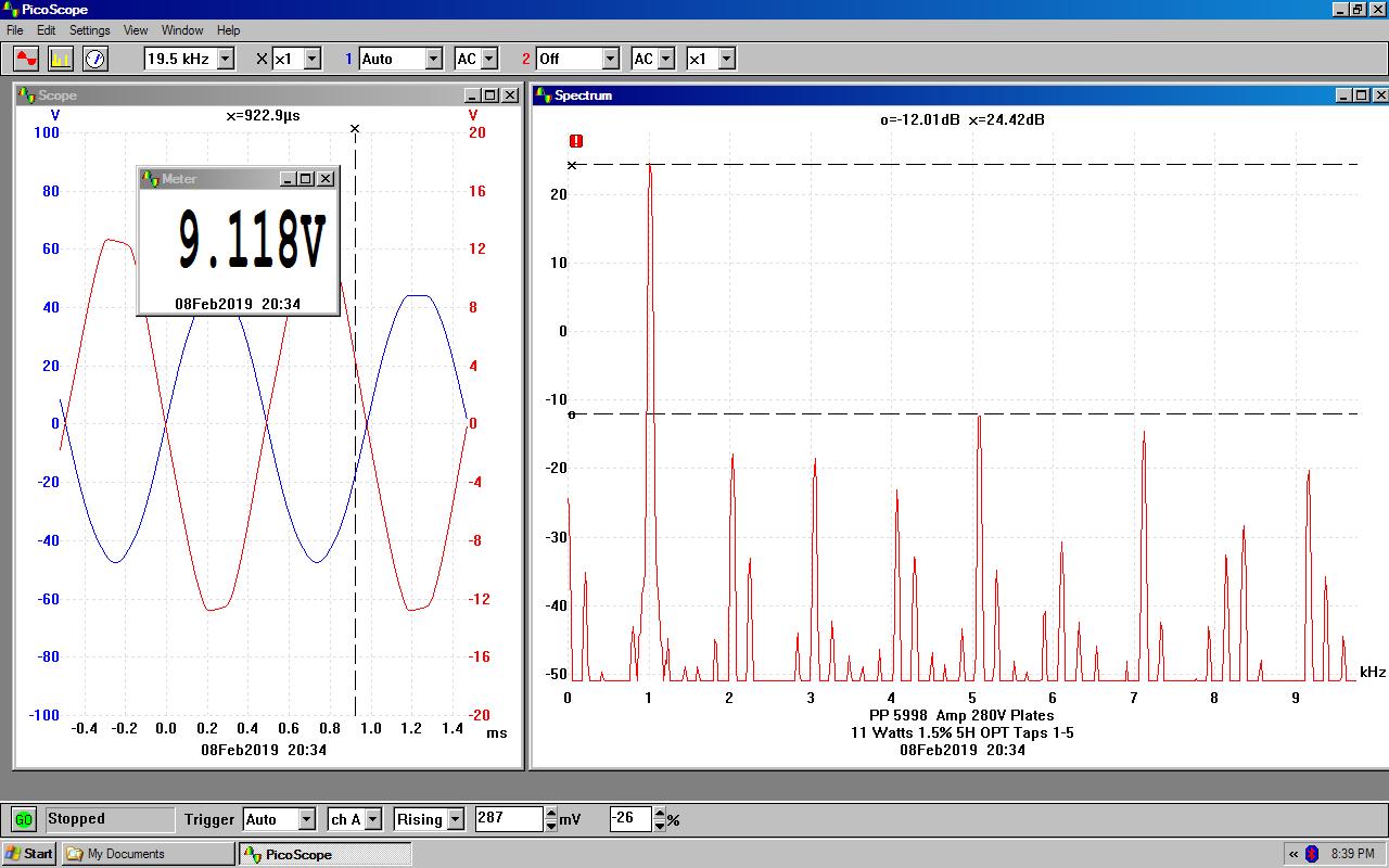

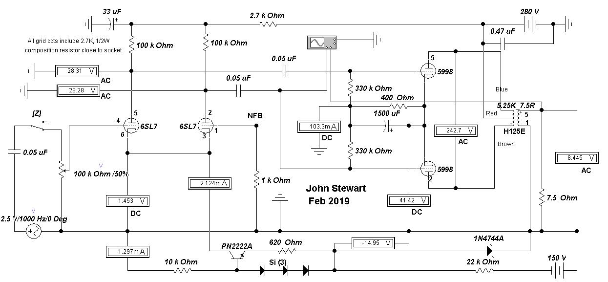

Betty Crocker Special with a PP 5998 Output
For the sake of completeness I've added this one for the curious. It clips smoothly at 11W. Needs a -ve supply for the 6SL7. Will add the info on how to do that simply later.

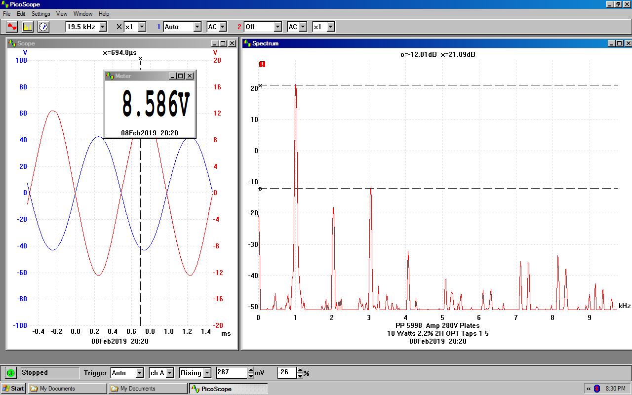

More on the PP 5998 & a Simple Negative Supply

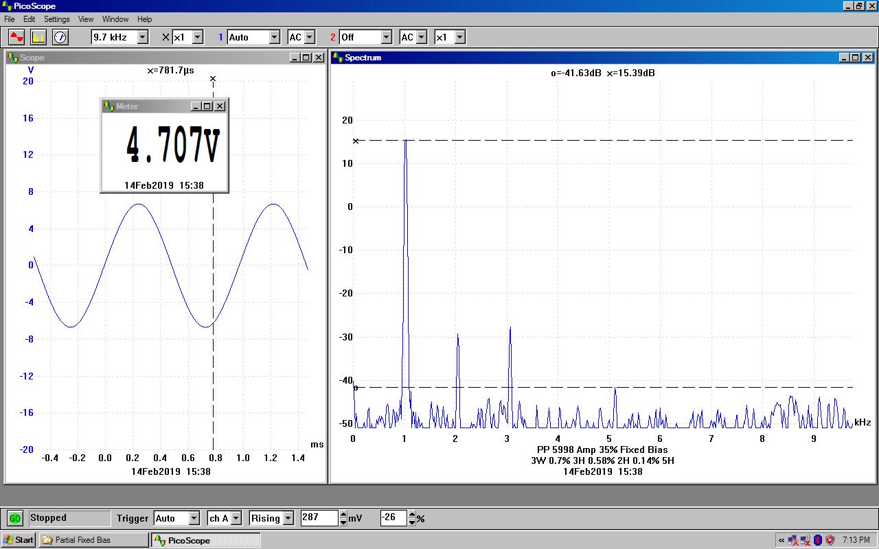

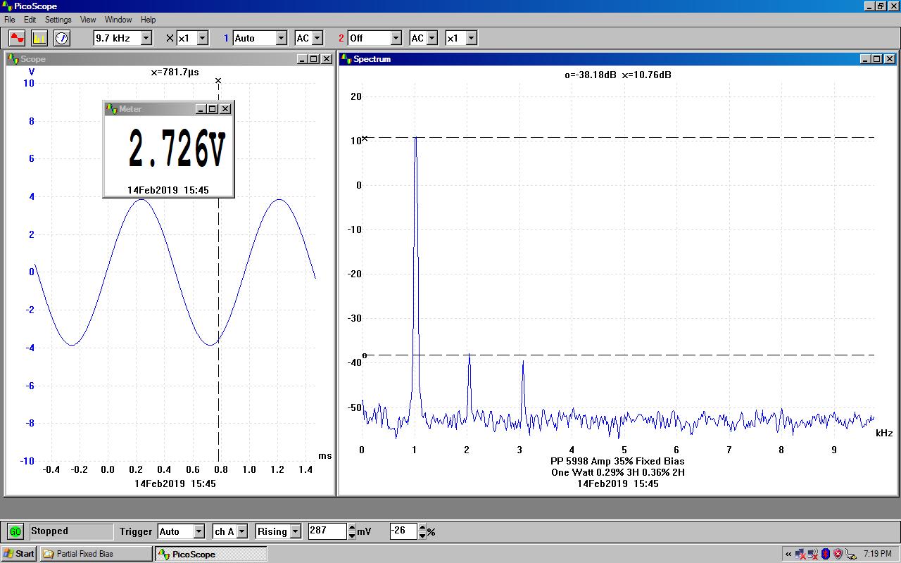

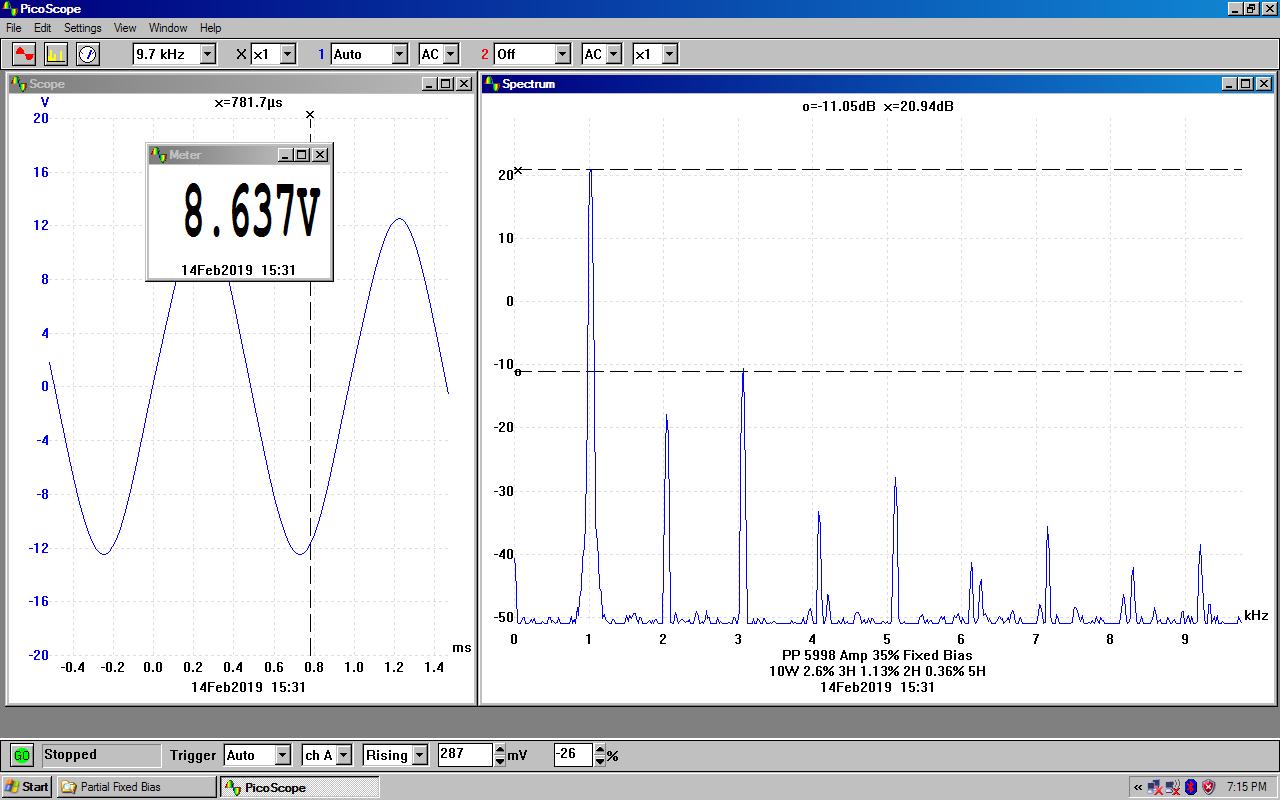

Partial Fixed Bias
I’ve been thinking about partial fixed bias for several years, so here it is. There was already a minus 15V zener supply on the chassis, so the 5998 grids have been removed from common & connected to that.
The power triode cathode resistor needs to be adjusted to 280R. A 1K connected in parallel with the existing 400R resistor adjusts the standing cathode current to 100 mA. Total plate dissipation is just under 25 watts, the spec limit for the 5998. A pair of separate cathode resisters of 560R properly bypassed would improve output stage current balance.
For the distortion tests I took the rapid increase of the 5th harmonic to be the limit. There is a smooth overload beginning at 11 Watts.
The partial/fixed cathode bias cct could be used with the 6BX7 version of this cct.
A survey of common high mu twin triode voltage amplifiers indicates a 12BZ7 would be an improvement over the 6SL7. I’ve put together an adapter to do that. And 12BZ7s are in my stash.

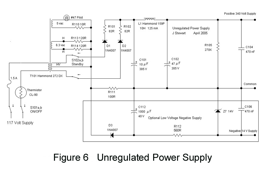

Negative Bias Supply Refer to Figure 6
A simple negative supply for the differential tail can be created by using the current pulses in the center tap negative return lead of the DC supply. For many years I had inserted a 10R resister into the lead to the HV CT in order to monitor peak current in the rectifier(s) & transformer.
By increasing the 10R resister to 100R, it is possible to create a simple negative supply for biasing & so on. In the schematic the voltage pulses caused by the current in the B+ supply to the rest of the circuit are picked off by the 1N4007 & stored in C112, an electrolytic capacitor. A small 560R resister & 14V zener do the rest in the example circuit.
More results in a few days.

Here are the results for the PP 6BX7 vers of this amp. Still using the Hammond 125E OPT it clips at about 3 watts on a 250V PS. OK for a small amp. At no signal the total plate dissipation is 11.5 Watts. The 6BX7 cathodes are separately biased. For out of spec tube sections of +/- 10% this hookup reduces the unbalance plate current to 2%.
The driver is still the 6SL7 as used on the original. But not sure if Ling meant the two sections to be direct coupled or cap coupled. For the direct coupled version neither of the triodes operates in the best mode. So to get large output to the following grids AC coupling solves that problem. Since this amp is not meant for NFB, cap coupling is not a concern.
Seems odd but looking at the distortion at clipping actually goes down a bit for 2H & 3H. But that is replaced bu a spectrum of higher order harmonics.

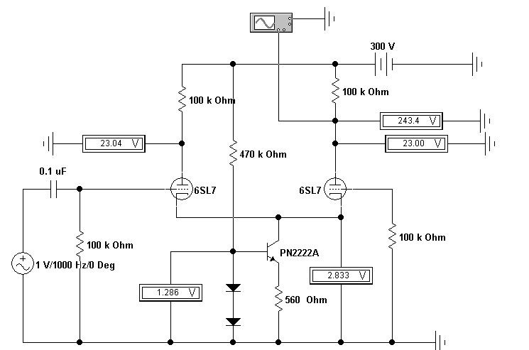

During work on the PP 5998 vers I tried the 6SL7 in a differential connexion with an NPN transister for the cathode tail. The gain was somewhat less, but the distortion was also about one half of this version. Gain shewn is from the 6SL7 grid to the 7.5R load.
Now *that* is a really nice circuit. So many of these threads seem to come from folks struggling to make a marginally designed circuit work well. We should be pointing to yours as an example of one done right. Perhaps you would share the differential input version as a modern improvement.
