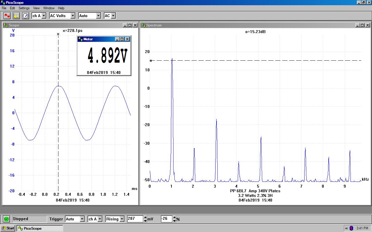

Here are the results for the PP 6BX7 vers of this amp. Still using the Hammond 125E OPT it clips at about 3 watts on a 250V PS. OK for a small amp. At no signal the total plate dissipation is 11.5 Watts. The 6BX7 cathodes are separately biased. For out of spec tube sections of +/- 10% this hookup reduces the unbalance plate current to 2%.
The driver is still the 6SL7 as used on the original. But not sure if Ling meant the two sections to be direct coupled or cap coupled. For the direct coupled version neither of the triodes operates in the best mode. So to get large output to the following grids AC coupling solves that problem. Since this amp is not meant for NFB, cap coupling is not a concern.
Seems odd but looking at the distortion at clipping actually goes down a bit for 2H & 3H. But that is replaced bu a spectrum of higher order harmonics.

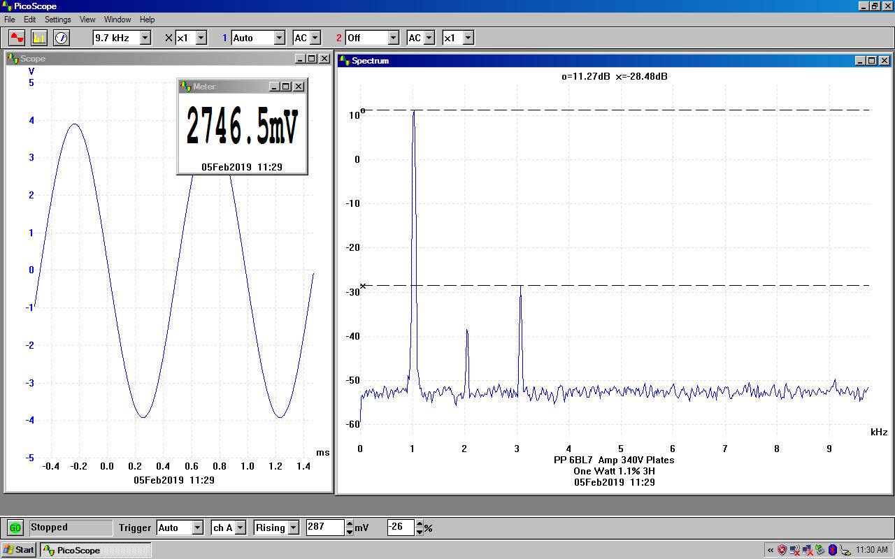

Attached some info on the PP 6BL7 vers. This one has an early variation of the Diff Amp front end.

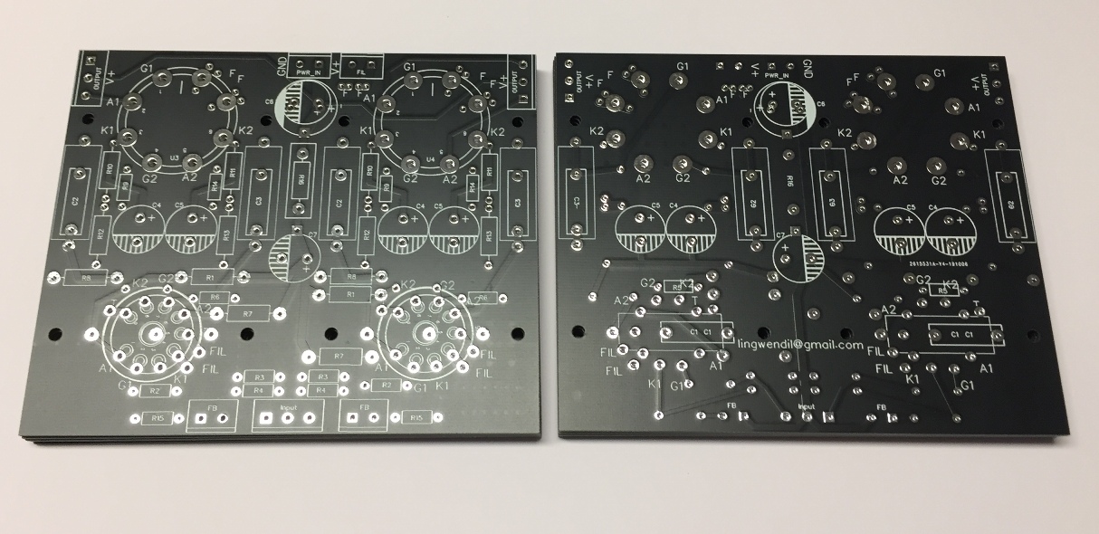

I didn't have any errors on the batch of each made other than a cosmetic spot where a trace went past the pad a few mm, and I think a couple minor silkscreen labeling issues. I built one of each and fired them up, no issues that I could find, both functioned correctly and sounded great. I would greatly appreciate if a second set of eyes could pull up the link to the project and give them a look, however. The EasyEDA page is easy to use, but a Gerber viewer should work too. I mainly wanted others to confirm that it all looked good and worked really.

Thanks to Lingwendil for the good work he has done. I've just received 10 noval boards ordered to JLCPCB with the gerber file on post #375. I now clearly see the many hours of CAD design poured on this PCB; it is still rough on some parts but it looks a quality part overall.
I selected the black finish because the holes on the chassis for the noval tubes must be slightly larger than the tube sockets: noval sockets are shorter than the octal ones, and will be recessed in the chassis. The black board is less noticeable while peeking trough the hole, and the white silkscreen is easier to read while assembling.
There are minor silkscreen overlap cosmetic errors already mentioned by Lingwendil, but they dont harm the assembly in any way. I have a few suggestion already for future versions.
On this board, the silkscreen does repeat the same component number on both channels. There are two R1 parts (for the left and for the right channel), two R2 etc. It is more usual to have unique labels for each component. A popular choice is to add 100 to the part number: R1 on right and R101 on left; R2 and R102 etc.
Another suggestion: mark the pin 1 of octal sockets on both sides, or make the copper square. I will mark pin 1 on the back side of my board with a spot of white marker.
I will place terminal blocks on the side opposite of the sockets, and they will cover the very small silkscreen labels. Labels would have been better placed behind the terminal block perimeter, instead of inside it.
The Lingwendil email address on the back silkscreen is near to the mounting holes and will be partially covered by the mounting screws.
I will start the assembly soon (hopefully!) and will post again the results.
