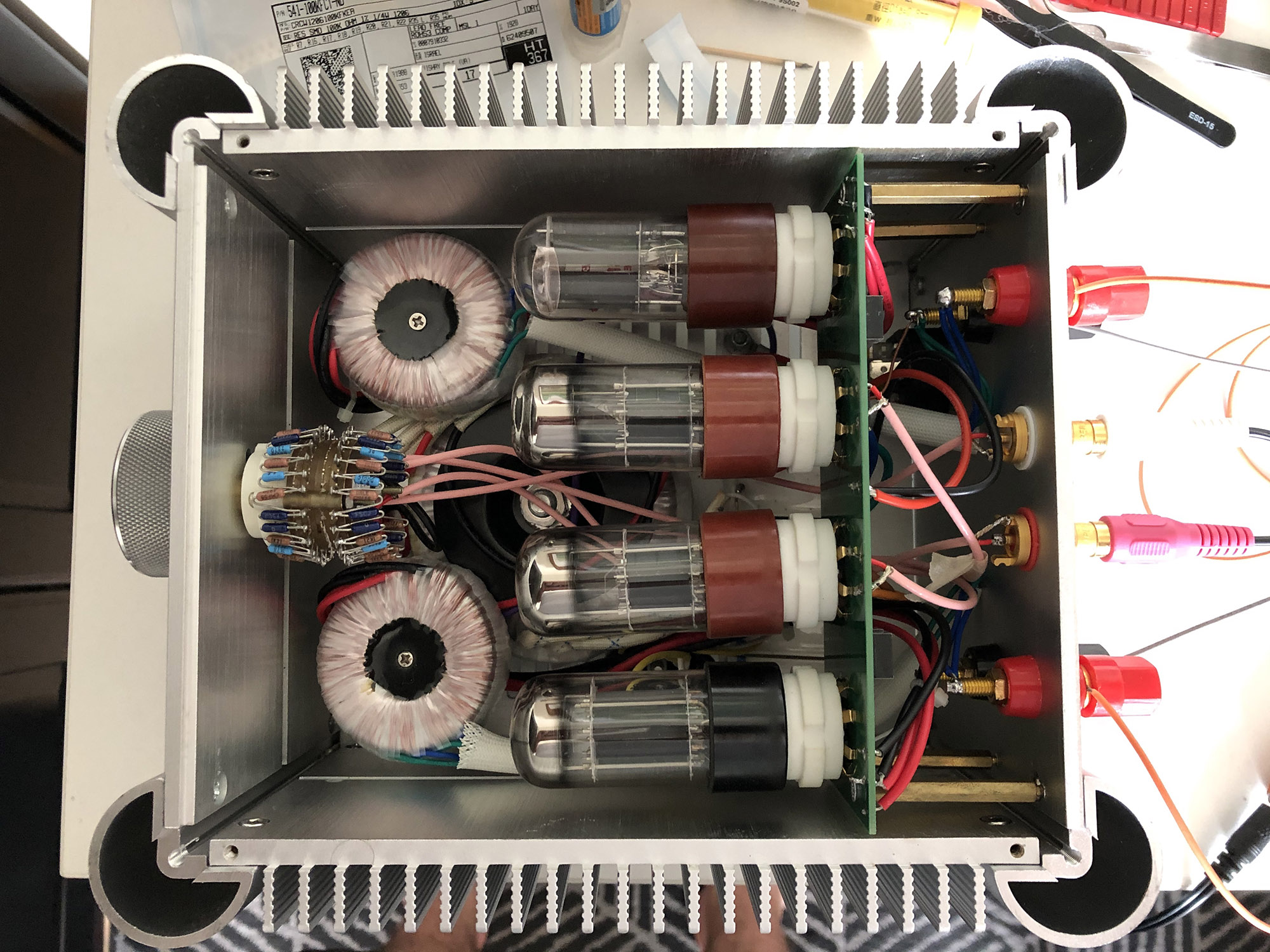

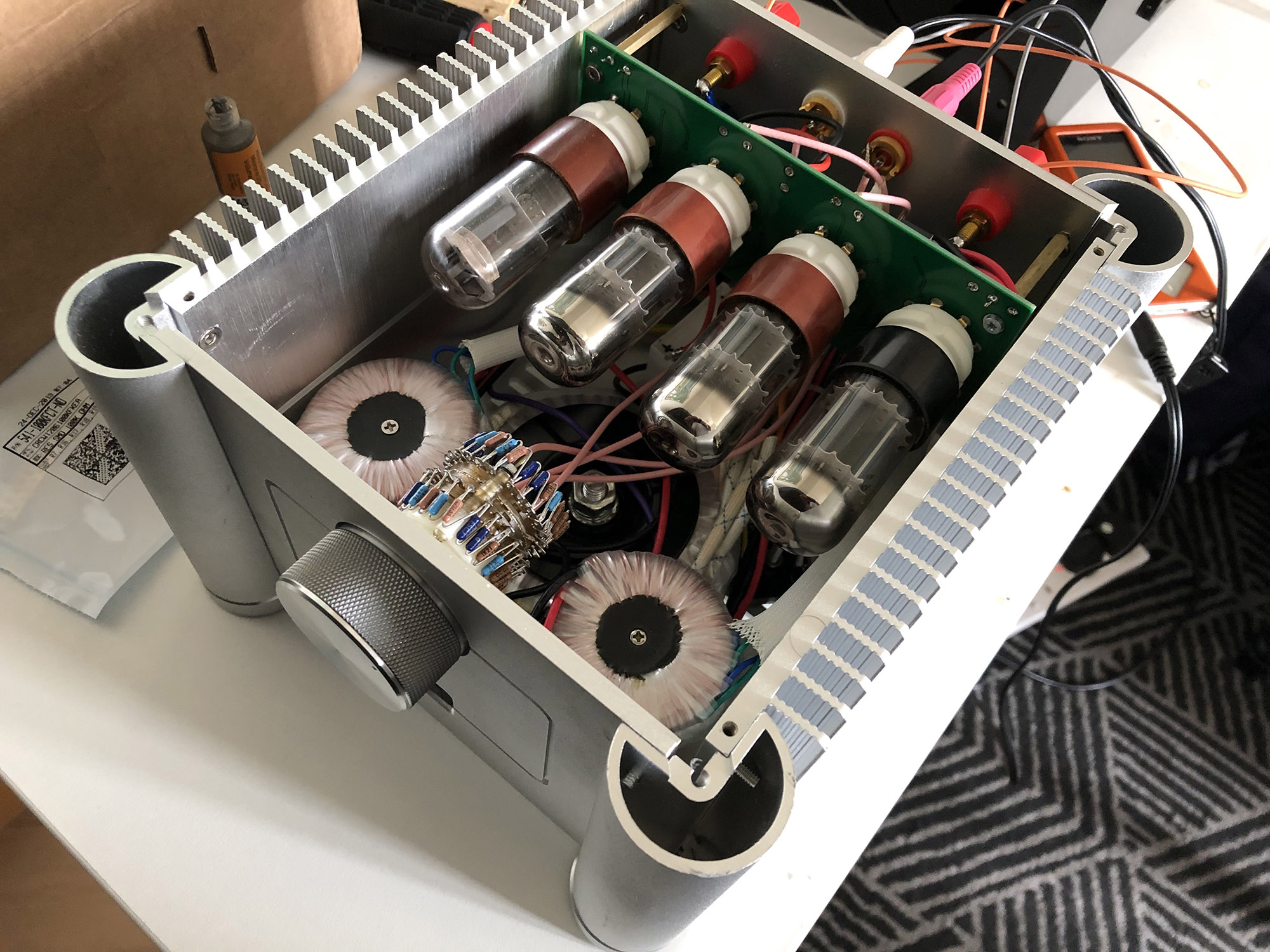

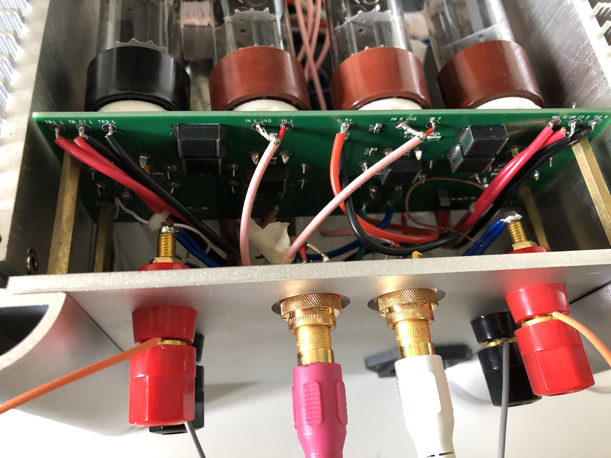

This is my take on the subject, all basic SMD parts, no matching of anything. Sounds very nice actually as desktop amp. I am planning to make another PCB for it with the nice THT parts, matched resistors, etc, and see what the difference will be
Thanks for all the ideas and inspiration!

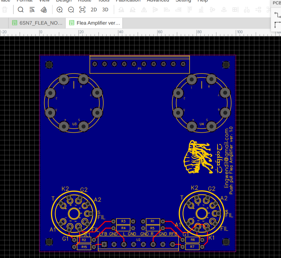

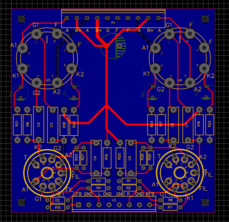

Sneak peak at the very early stages of the first revision... going to have a ground plane, more streamlined connections, and 100mm square. Noval only for the input tubes this time, and once this is up I'll work on noval output tubes, and a differential input version.
If anybody is interested in boards from the first batch let me know, I have several of each still left.
