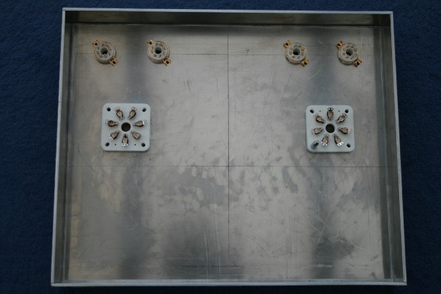

Hi all,
I am not in an advanced step like Gabriel, but here is my future amp:
José
PS: I am blocked by the power supply transformer.
In fact, if I understood well, by the fact that I am going to use a single power supply, I must double the currents indicated at the Borbely's PS schematics ..???
Yes double the current. In my opinion if I would like to make another power transformer it will be like this
Primary 0-220-230-240
Secondary anode 6c33c 0-10-170-200 800mA
Anode 6h8c 6j5 0-290v 250mA
6h8c 6j5 heater 0-6.3v 3A
6c33c heater 0-12.6v 10A
Bias 0-90v 150mA
Inside I would like to arrange the parts like this
If some one have any suggestion I am open for it.

Hi all,
Gabriel, you wrote:
"In my opinion.... Secondary anode 6c33c 0-10-170-200 800mA [Why 10? And 170-200 means between 170 and 200?"]....
For the rest, I agree. So what if I ask some company to build one like this:
Secondaries: 0-180V 600 mA (800 mA seems to be a very high value--> cost & size) for the anodes of 6c33c (the 2 channels, 2 tubes used in double triode)
0-290V 250 mA for the anodes of 6sn7gt and 6j5gt (2 channels, 4 tubes)
0-70V 150 mA Bias of both channels
0-12.6V 10 A heating of 6c33c (2 tubes)
0-6.3V 3A heating of the 4 other tubes.
Please tell me if you see any mistake on this.
José
Hi
About the anode windings
0-10-170-200 is made to play with the anode voltage Is one winding with different output voltage
But I make something interesting also I made the primary for 220-230-240 because you can play also with them. All the secondary voltage must be calculate at 230V.
At my home I have 238v my brother has at his home 230V a fried of mine has 220 so is better to have in primary winding 0-220-230-240.
After having put the question about the 10V, I remembered the PS diagram from Borbely; they explain why, I understood is something about giving time to the capacitors to charge and use a switch after 2 minutes. Isn't it?
I must say that I am not sure enough I have completely understood their objective. You can also use a temporisation circuitry with one shift (relay).
My second question is about the secondary for Bias: after rectifying 70V, you get something like -99V, so why a secondary of 90V?
Anyway, I am still stocked without the possibility of continue until I find the power transformer. Because sizes, location on the chassis and definitive voltages.
I am very happy with the enthousiasm of Gabriel and I will follow his feedback. I have a great confidence on this project, even if I also heard people complaining about this tube. But, as I said, I prefer a positive mind.
As soon as I can continue, I will give you regular feedback on it.
In the mean time, I will appreciate your feedback and experiences, good or less good.
Regards.
José

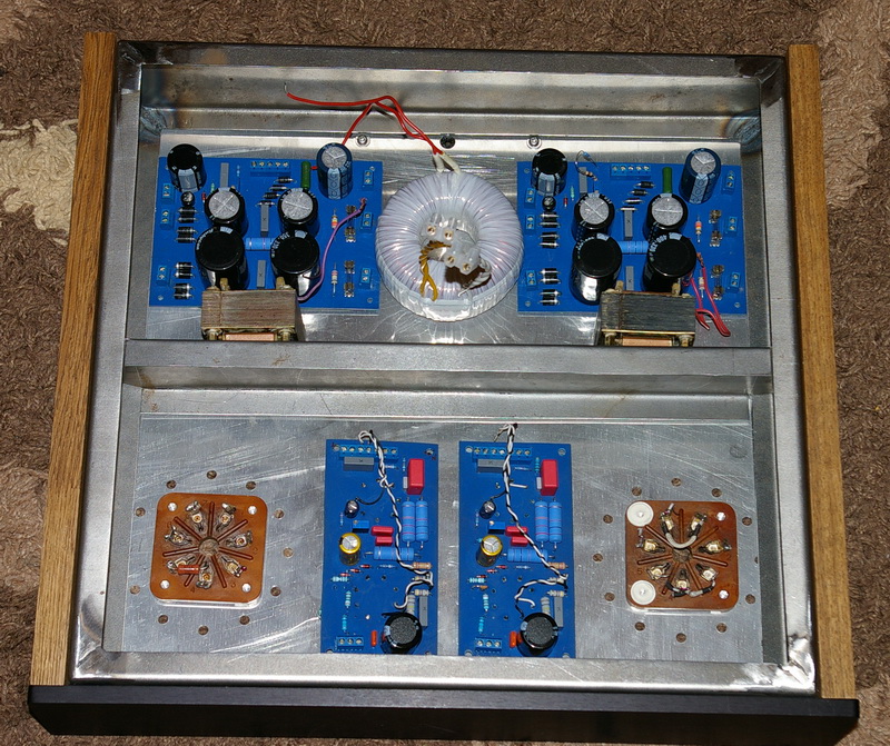

Hi Jose
For the 210v I use this module, is about 10USD
AD-044S8 MINI TIMER PROGRAMABIL-ON DELAY - ADELAIDA - Componente electronice
About the sound of the amplifier:
Until now I listen a lot of HI-End components (Accuphase, Luxman, Avantgarde, Ascendo, Neat PMC, Electrocompaniet, Triangle, VPI, Wadia, .and many more, so i think i have some experience with the sound.
This amplifier is unbelievable if you use very good quality components very well checked and also very well selected, with low tolerance. You will be surprised. I buy the parts from this vendors

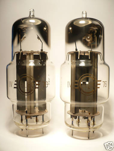

I read through this thread very quickly. I am building a 12HL7/GM70 at the moment. I like the looks of the 6C33C and hope you can post a good detailed discription of the sound quality of your amp. I do need one more amp to drive my woofers after I finish the GM70. This tube looks promising. Somehow, just for looks, (I am an artist) I would like to work in the 5C8S half wave rec tube. Below is a pic of two of them. You can see how they would complement the 6C33C.
Can you link me to your schematic? Cheers.
