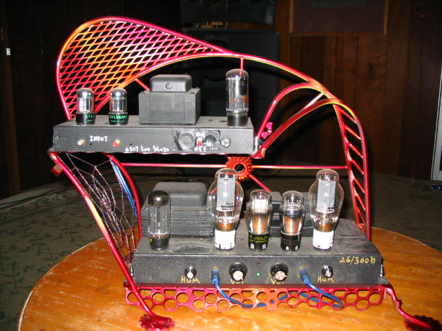

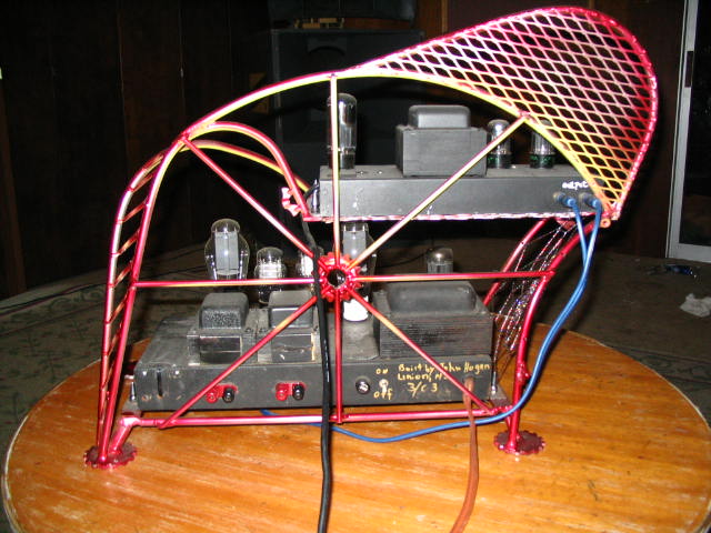

Thanks Dan. We were just talking about Concertina last night as a good approach. I am in the middle of an amp build right now, But this looks good for my next one. The tricky part will be stuffing it into this amp stand I build a could years ago. I would do the signal path on top with 4 6C33C tubes across the front and the power supply on the bottom. or vice versa depending on layout.
I sold the Hogan amps that were on there so the stand sits empty.

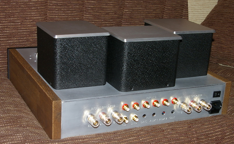

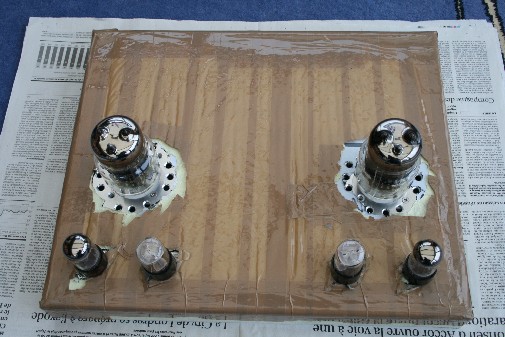

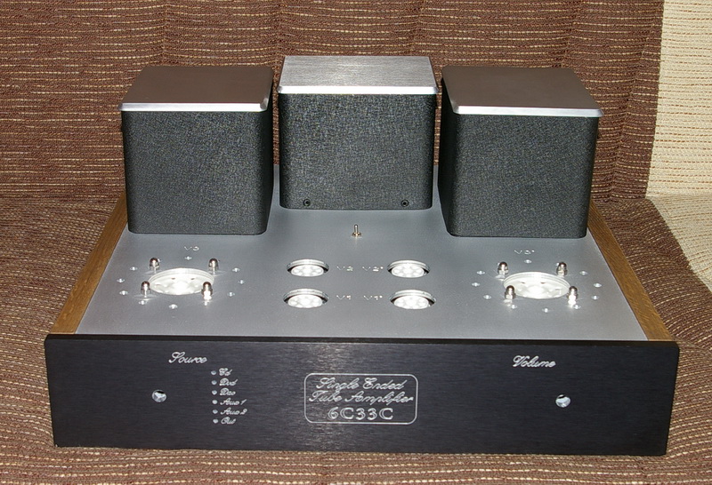

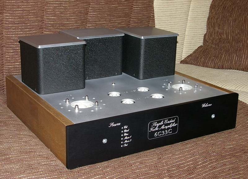

Hi all,
I've been away from the forum, waiting for my PS transformer, that is being built now. I hope to receive it next week.
In the mean time, I have made a picture of the chassis with the tubes:
Regards.
José

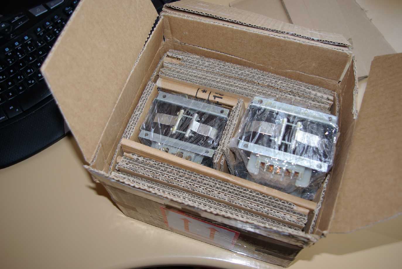

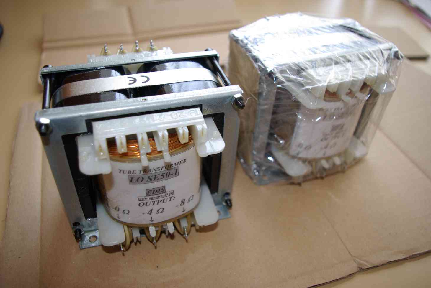

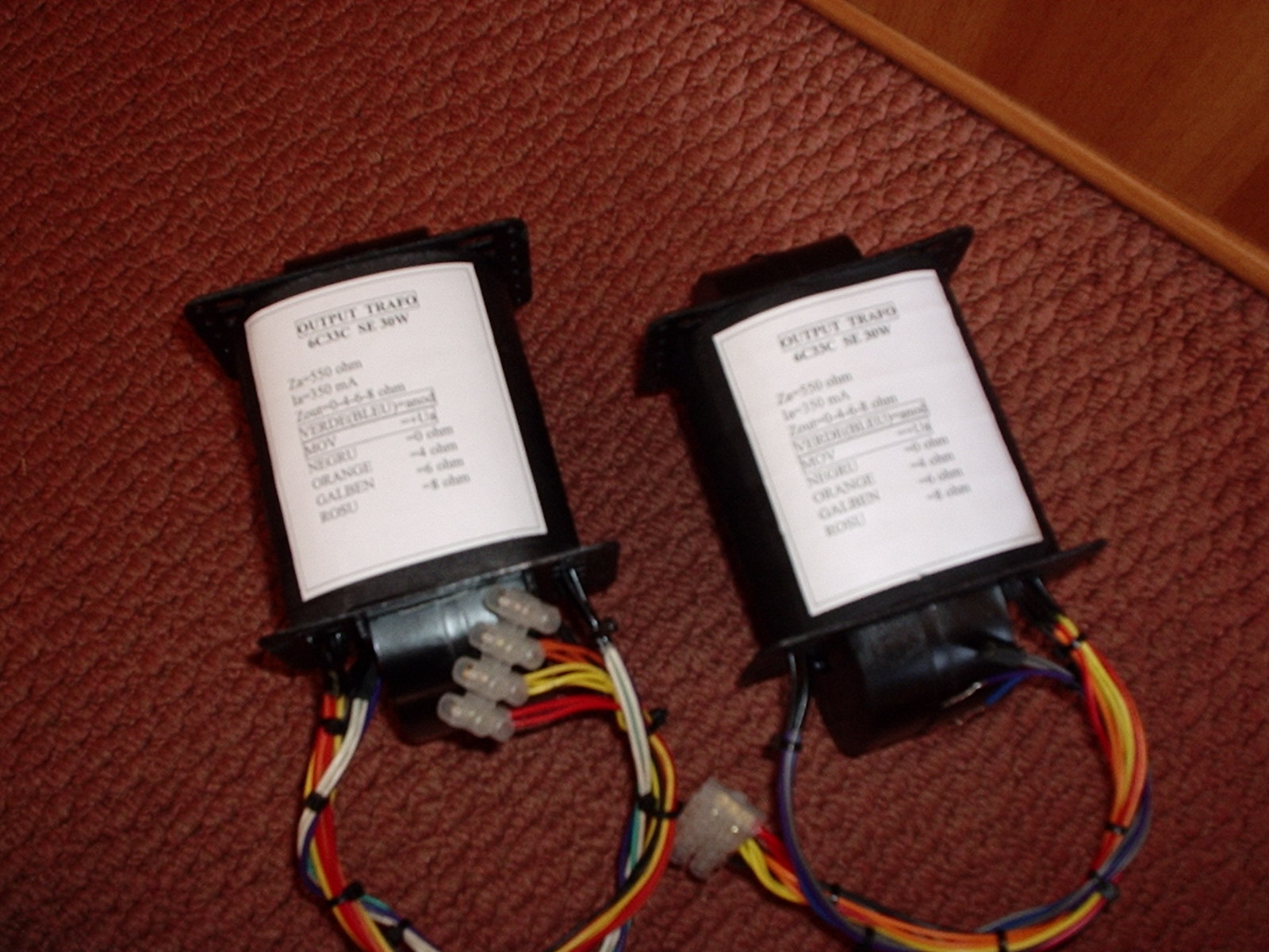

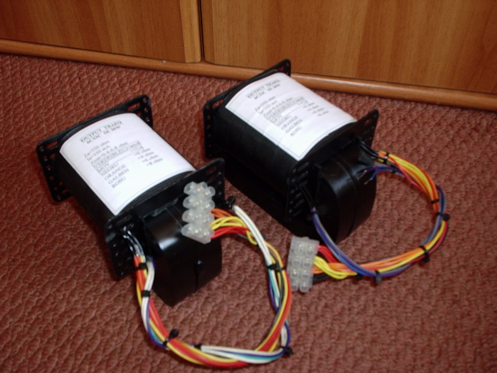

Nice transformers, can you tell us a price for a pair and also some specs?

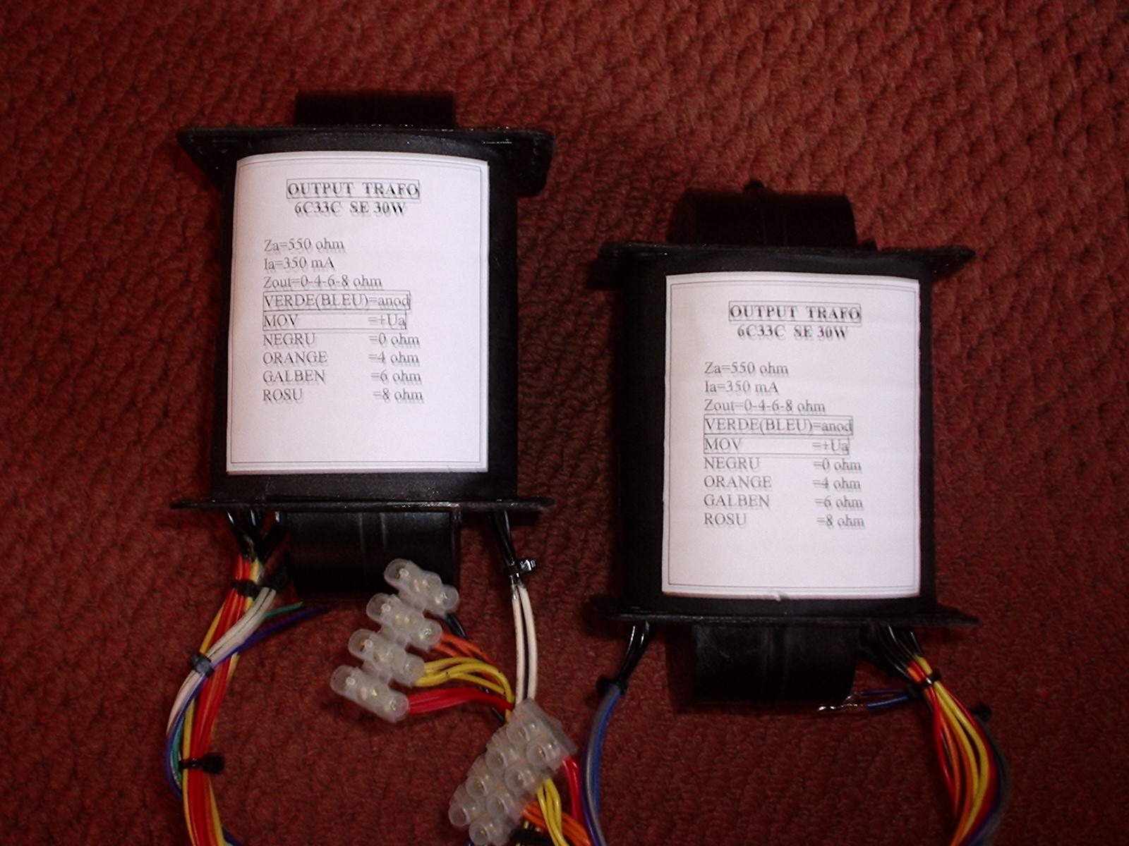

I will show you my brother transformers. those trafo are big 15.5cm height.

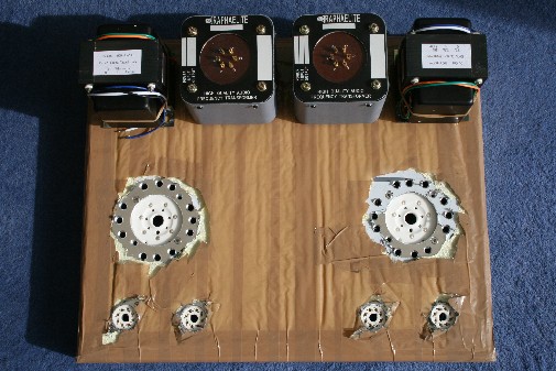

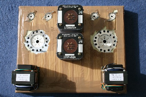

Hi all,
I have received the output transformers and the chokes (I put 2 chokes, even if I make a stereo configuration). The PS transformer will be ready next week.
I wantted to ask your opinion about the best location on top of the chassis. For this, I post 2 pictures and I would appreciate which one do you prefer to place the PST, knowing that the free espace for it is in the middle for picture one or in the back for picture 2.
In advance thanks.
Regards.
José

Thanks Trondareo for your answer. I appreciate very much.
So, you prefer the configuration of the picture placed at the right? In which the OTs are already placed at the rear corners, the chokes in the middle, between the tubes, and the fre space between the OTs will be occupied by the PST.
This way, the PST will have less electronical impact on the rest!?
Regards.
Jose
