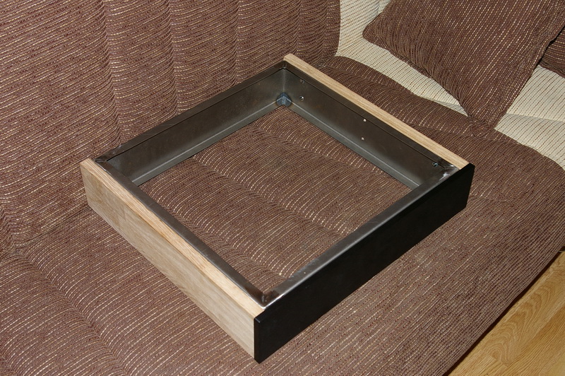

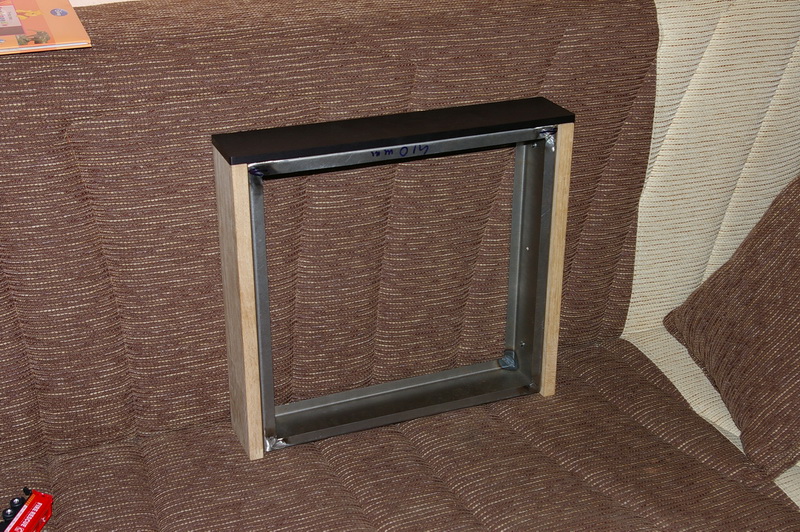

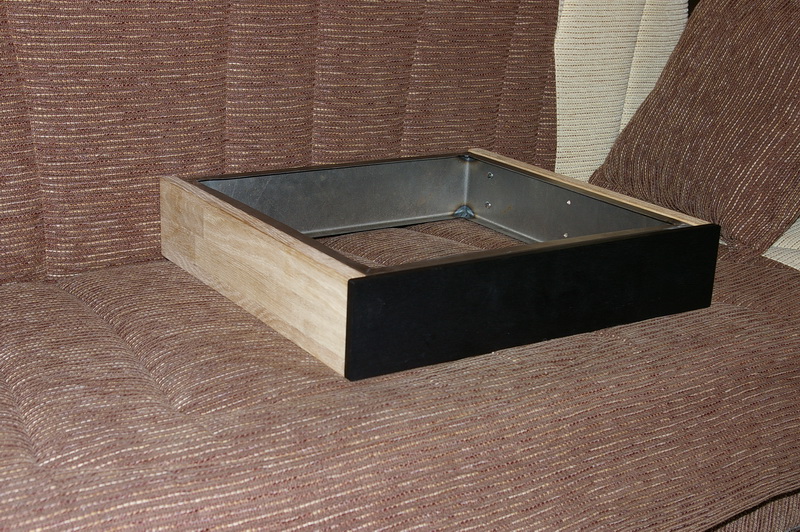

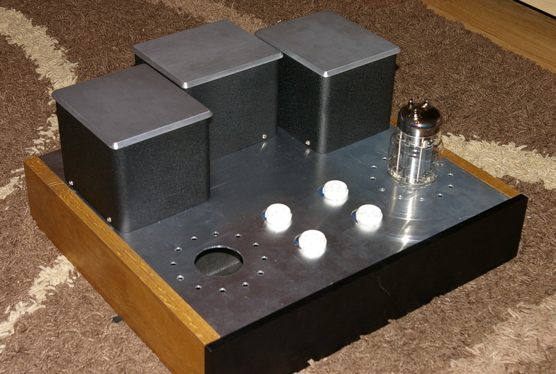

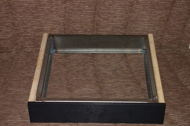

Some pictures with my case not finished yet
Hai Gabriel,
Thank you for your answer.
Your case looks very solid and really nice, I like it very much.
In fact, I am intending to do just stereo in one case, as you.
The OPT take a long time to arrive, maybe still one month. The guy said it takes 80 days because it's shipped by boat. Probably I will do as you said, to rewire the iron. Do you know how much it cost?
I have seen some people complaining about the tube 6c33c, but I have seen also many other saying that it is fantastic. I prefer to believe the second.
Best regards.
José

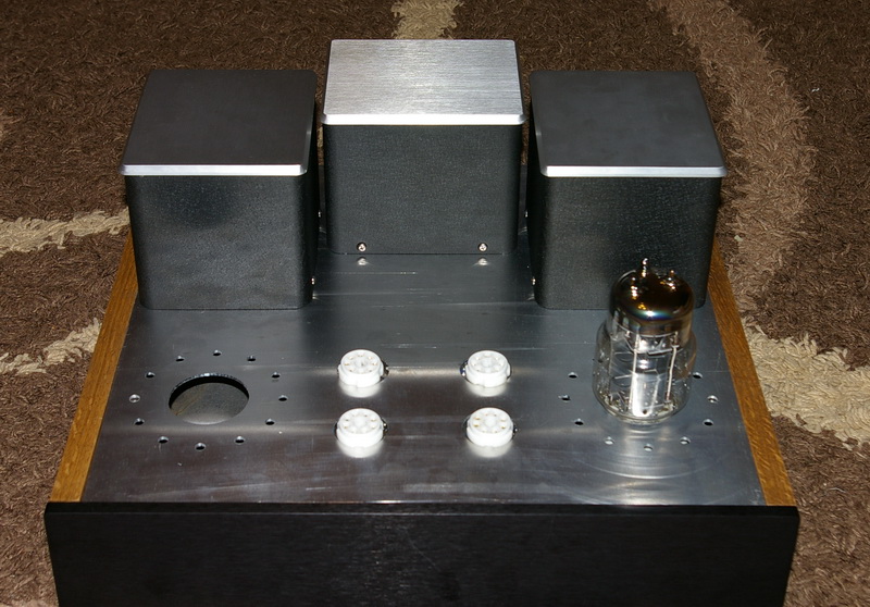

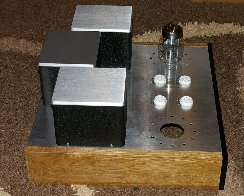

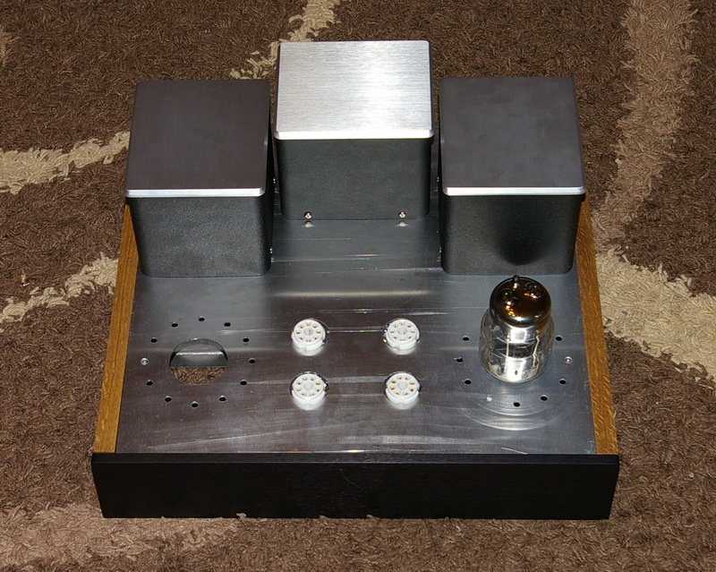

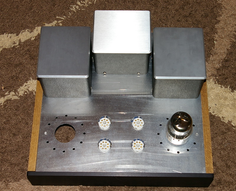

More pictures
