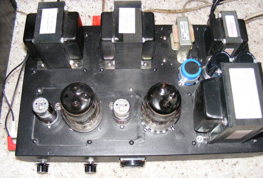

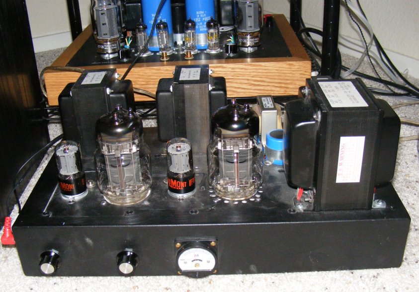

Cathode Follower 6S33S SE Amp.
Well here she is!!! I wound up doing zero feedback. At first the amp was rather flat sounding but after a few hours it has really shaped up nicely.
The sound is very clean and detailed, against a dead quiet background. This new build has easily 12dB better signal-noise versus the previous build that I posted previously.
And of course it is running an octal front end; also a great improvement over the miniature tubes used in the first build.
I will get the schematics posted soon. In the meantime I am just enjoying...

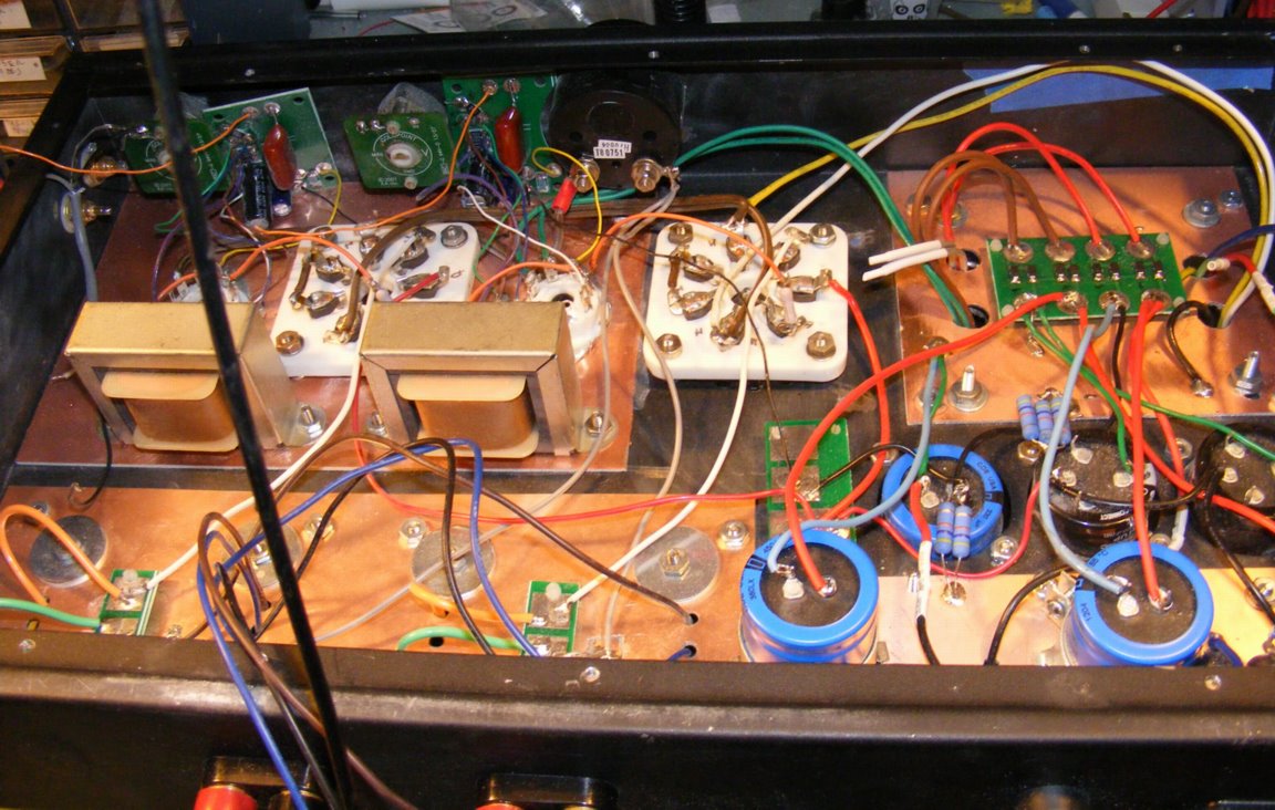

Hi Dave,
Talking from experience, you better put that blue cap on the top somewhere where the
6C33 heat does not reach it.

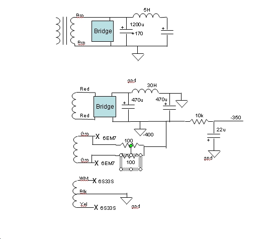

Here ya go...I checked the caps, after several hours running none are very hot. Tubes are running only around 250 mA so power diss is under 50W.

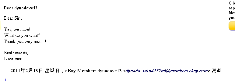

The last pic is the guy in China that has the transformers. They are very quiet and having the power transformer custom wound to run the 6S33S amp is nice indeed. Of course I have another set; they take about 3 months on that slow boat from China.

Congratulation nuvistordave, good looking amp.
Well done.
If you use another tube amps please share us your experience, and sound differences between 6C33C and the others amp.
Can you tell us the name of the speakers that you use?

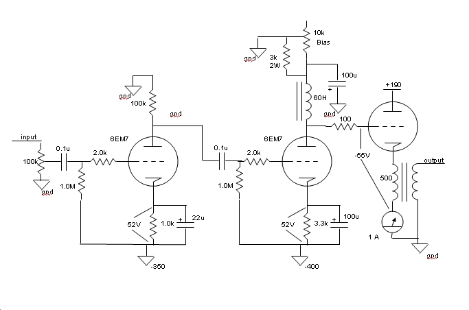

Very clever, Dave.
Could you please confirm that the 6EM7 are biased at 52 V ? This seems very high .

Congratulation nuvistordave, good looking amp. (THX; and the sound stage on this thing is really to die for. lots of effort and cost over $600 but well worth it.)
If you use another tube amps please share us your experience, and sound differences between 6C33C and the others amp. (That amp behind the 6S33S unit is a KT120 P-P driving Mesa Strategy 400 OPT's in UL configuration)
Can you tell us the name of the speakers that you use? 2 sets; the good ones are home brew 3-way rigs; bought the drivers and crossover components from Madisound. Also have a pair of Klipsch 8" bookshelf units; might have warmed over the crossovers.
The 52V bias on the low mu sections is what I measured and should be about right. The mu is only 5 on those units, so they are going to take a lot of bias with over 300V on the plates.

Had to look up that 'DCMB' That is basically what my amp is; it uses 2 stacked supplies and the drive stage is direct coupled to the output stage. BUT since 'Nuvistor Dave' dreamed the circuit up without consulting any references it has a few twists on it.
1) the output stage is being run as a Cathode Follower
2) BOTH supplies are ground referenced; one positive to ground and the other negative to ground.
3) The amp uses fixed bias and it is very stable because it is a Cathode Follower output.
4) NO 40W power resistors and...
5) no regulators; just tubes and iron, which is as thing should be.
