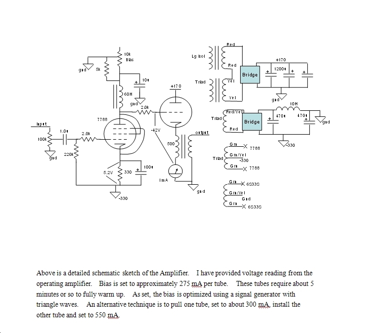

This is the schematic for the first amp that I built, using a straight isolation transformer with a filament transformer to boost the main B+ to 160V. OPTs were from Jack in Reno, as were the plate chokes. I sold that one on EBAY, to spur me to complete the second iteration which uses the transformer set from the guy in Hong Kong; I had received 2 sets nearly 3 years ago. Running 160V and 275 mA the amp is VERY linear and will do 15WPC.
As you can see it is a true ZERO NFB design, with NO TRANSISTORS. (use a transistor GO TO JAIL) Note the High S tube (7788) driving the CF output stage; the plate resistance is well under 1.5K on the drive tube for good frequency response.
The Hong Kong power transformer has 320V, 80V, and 160V secondaries, for bridge rectifiers, and 2 filament windings; 12.6VAC CT and 6.3V. Included in each set is a 5H 600 mA choke; I am adding a 30H 80 mA choke for the -320V grid supply. Plate chokes are still the Electra-print ones rated at 60H and 20 mA.
Since as pass tubes the 6S33S's were designed to run as CF's with fixed bias, this amp is extremely stable and well-behaved.
