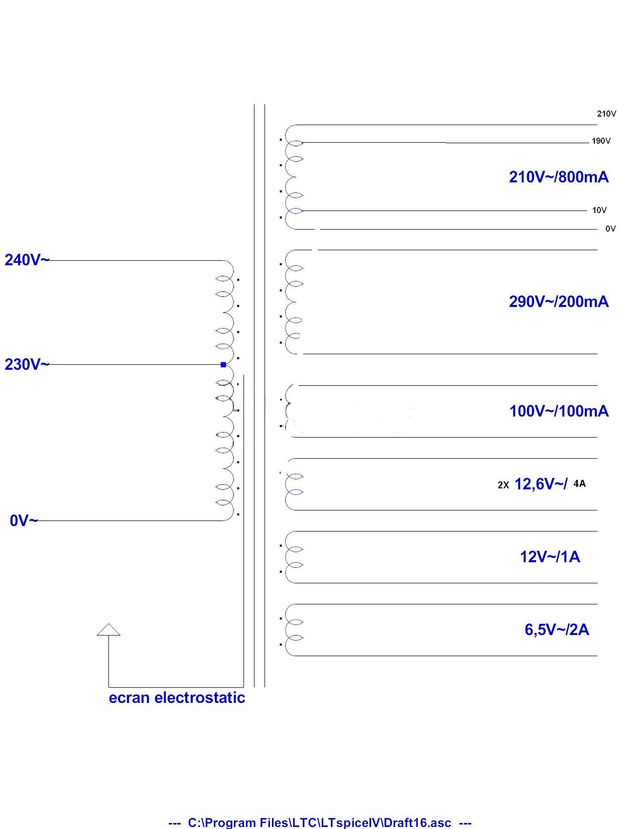

Good news, I heard back from Edcor yesterday and they can build a power transformer with the following specs;
700V C.T. (350 - 0 - 350) @ 50mA
600V C.T. (300 - 0 - 300) @ 300mA
6.3V C.T. (3.15 - 0 - 3.15) @ 7A
5V @ 7A
This will provide high enough voltages for tube rectification of both of the stacked B+ supplies, as well as enough filament current for the 6C33C, 6SN7, 5AR4 and 5C8S
I don't believe it should be a problem having both of the stacked, center tapped, supplies on the same transformer as long as they are rectified separately, anyone have thoughts on that? The top supply's C.T. would see the B+ of the other supply, will this matter?
They quoted me around $80 ea. for the transformers plus a $40 design fee. Not bad!

Here's what I'm talking about, note the center taps highlighted in purple.

Ari, I understand the function and design of the power supply. The issue is I only have room for one power transformer, so I would need the two B+ supplies on the same core and tube rectified, that's more the issue that I'm facing. I can rectify and filter them separately but I'm not sure how I can do that on the same transformer core and what will happen with the center tap for the upper supply?
Danny,
The power transformer and the schematic are OK and properly stacked in your drawing.
I don't see the filament windings. Kindly note that there is a big potential difference between them ( DC + AC ) and, if on the same bobbin, the insulation should be 2kV minimum, which is the current one ( and even 2,5 kV for a good quality power transformer).
Regarding the power handling capacity, I suppose it's 0K. Have you measured the DC resistance of the primary ( and possibly that of the secondary, but it's generally very low, less than 0,5 ohms ) ? Let me know please.
Ari

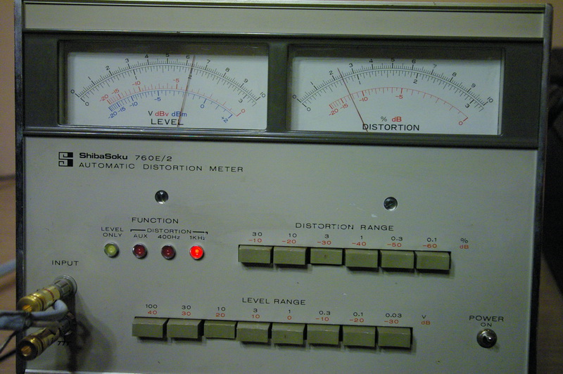

The power transformer and also the OPT was made by a user from elforum.ro, his nickname is Lazaroiu.

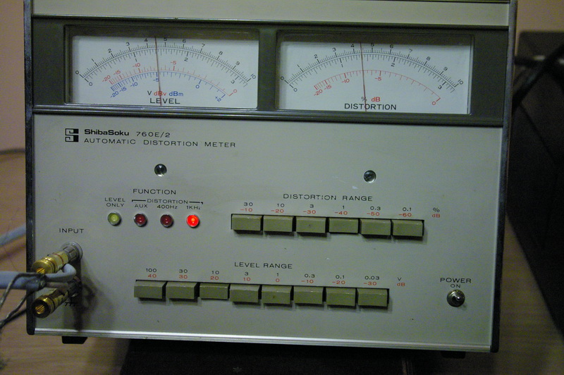

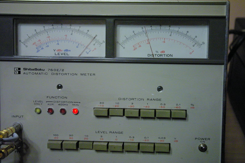

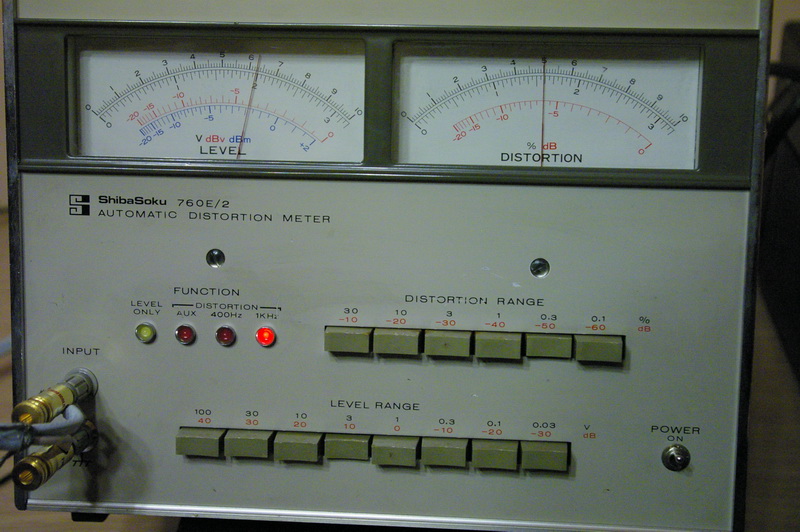

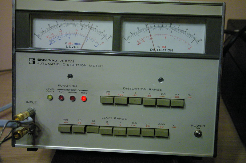

A few days ago i received from eBay a distortion meter.
I made some measurements,
Input 1kHz at 2.5v
4 ohm loading.
The last photo is the value without signal
Because this amplifier will go to a friend of mine i will made another one but the power transformer will have more Ua values (180v 200v, 220v, 240v, 260v) and at least 900 mA.

Hi Gabriel,
Your amplifier looks neat. Congratulations. Regarding the measurement I have some difficulties to understand the results. Could you please summarize with the following data:-
- Maximum power at 5% THD -
- THD at 12 W out put -
- Frequency range at 12W output.
- Also, are all the measurements made with a resistive 4-ohm load or 8-ohm load?
