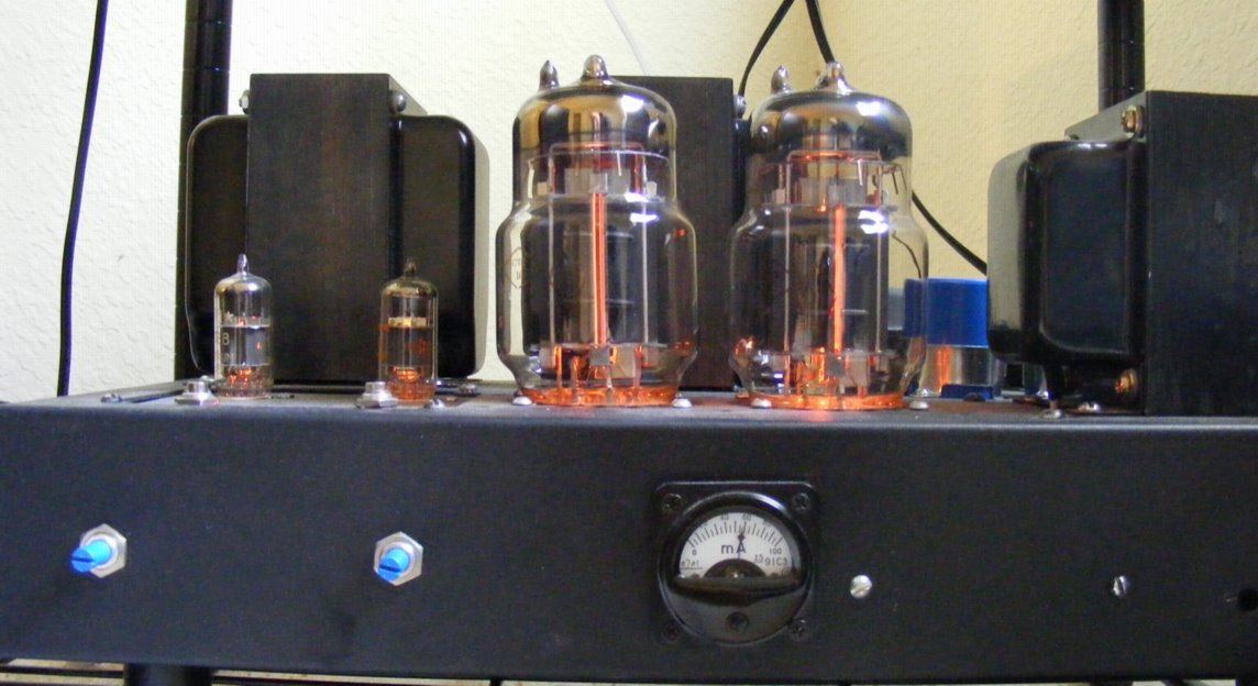

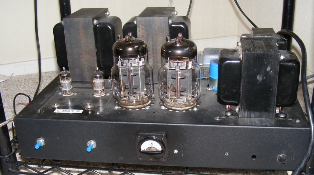

Dear Gabriel,
Could you also measure the voltage between anode and cathode of the 6C33s ?
Also the DC current at idle.
If you do not have a test point for the latter measurement, take the DC resistance of the OPT first and then see what the drop of voltage acroos the OPT is.

Hi Ari
I run my 6C33C at 210V and 220mA, at higher current I have less distortion.
I will like to try to use the tube at higher anode dissipation at least 56 58W to see the difference but the power transformer was not made for such test
The OPT Ra is 550 ohm.
Son I will make complete measurements now the amplifier is in the working position I listen music on him. I have a small kind and I can not open it all the time. I will make test when I will be alone. But son I will take the amp at my office for complete measurements.

Hi.
I am referring first to Gabriel's messages.
I know the 6C33 better than any other tube and have used it in many circumstances.
The anode/cathode voltage you stated is OK, maybe the best, and the idle current too.
To summarize : optimum use = 200-220V a/k and 200-220mA idle. Easy to remember.
This corresponds to a plate dissipation ( average ) of 44 W well below the max.of 60W.
With the single ended topology it is very hard to exceed, with single ended topology and triodes, an output power of 25% with respect to the plate dissipation, unless you add too much distortion.
Therefore 25% of 44 W means 11W only.
This does not match with the figures you stated in your former message ( 23,52 W at 5,2% ) as it would be an outstanding result never reached before.
The only explanation I can think about is that your distortion analizer could be wrong, either in voltage and/or distortion figures.
Also, it could give "peak" measurements and not RMS.
From the "Simplex" I get 12W ar 5% which I consider an excellent result ( in line with the software mentioned by Pidigi). At 15W I get 6,5 % distortion. The impedance of the OPT is 600 ohms and the DC resistance of the primary 40 ohms.
At 220mA the voltage drop across the primary is 8.8V meaning anout 2W of DC power dissipated, which is acceptable.
Please continue your checks and let us know. I have quoted above what I consider to be the best operational figures.

I am back with my SE 6c33c amp project, based on Borbely’s audio schematics.
In fact, I have just finished it some days ago and since then, I have made some tests.
I stopped the project in July 2010 because I had a stupid problem with the mains transformer that got burned. Unlucky a piece of leg of a resistor that I had cut off during the construction, kept hided inside, and when I moved the amp to connect to the rest of devices, the piece of leg made a short-circuit in the mains transformer and it burned up. I got so angry that I decided to stop it for a while.
I re-started last December with a new transformer and finished it.
This amp is extraordinary! Transparent, precise, with a perfect balance between the 2 channels. The sound image is perfect, just in front and in the middle of the 2 speakers. One can distinguish perfectly the different instruments of a big orchestra and the voices, men or women, are much more clear than with the other amps I have known. It is not much powerful, but it is enough for my speakers (92.5 dB) since I am able to run it without overpassing the middle of the maximum volume.
I am still on testing, and the only issue is that I don’t have a distorsion analyser. And I feel that there is a little bit of distorsion at high volume. I am wondering if I will manage to fine-tune it by ear, by changing slowly and progressively the resistance of P1.
I think that the distorsion impacts the high frequency sounds, which seem to me less powerful compared with other amps used for testing. Contrarily, the low frequency sounds are very strong and I do not like this. If any one of you can give me ideas on possible reasons for this, I would be very grateful.
Any way, I still consider that it is an excellent amp and I will find the solution to correct this “subjective” problem of lack on high frequencies.
Here you have 2 pictures (still remains to put it on a platform with spikes):
José
