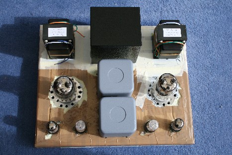

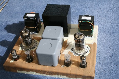

Hi
The amp is almost finished. I must install some source LED, the IR sensor and the foot.
All the adjustment are ok the voltage are correct like in the specs,
I love the sound of this amplifier.
Good luck to all who want to make this amplifier

Hi

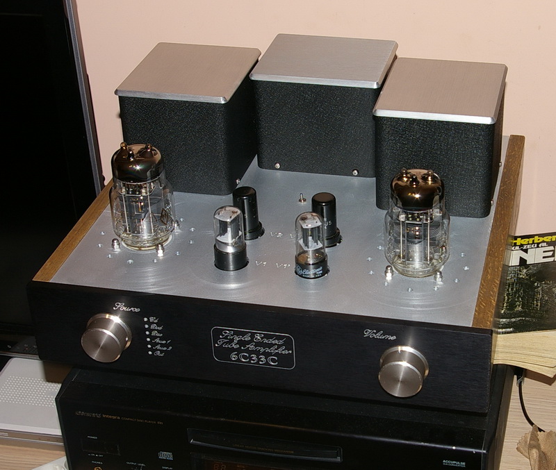

Hi Gabriel,
Congrats, nice work! Wish you to enjoy sonic beauty of your amp as much as possible.
And yes, since you finished first, now you are "prejudged" to be our "info-eldorado" 😉
Congratulations Gabriel. Excellent job!
Let us know how it sounds and give us more advise on the experiences you have had while building it.

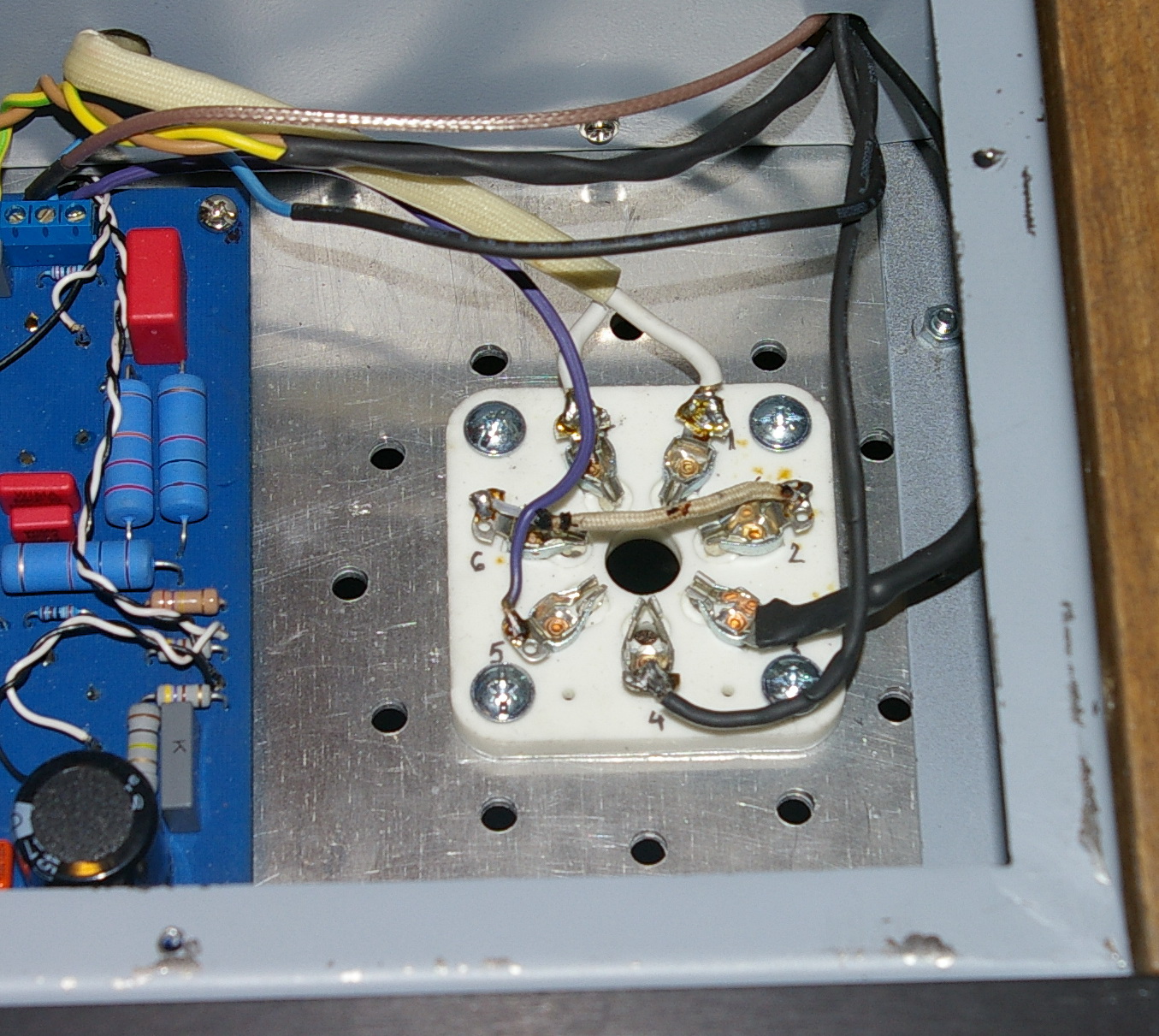

Hi
For this amp I use pcb design I don’t like the point to point system.
Those capacitors and zener diode are exactly like in the diagram to the ground of the amplifier. I use stellar ground. All the ground is in one point on the enclosure.

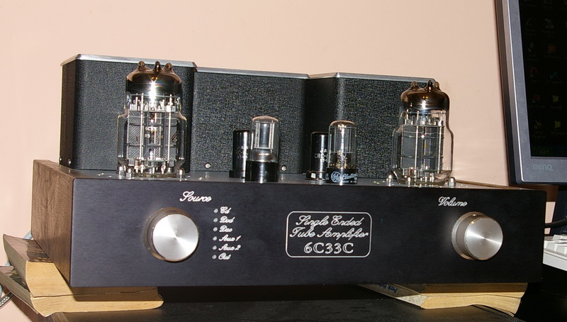

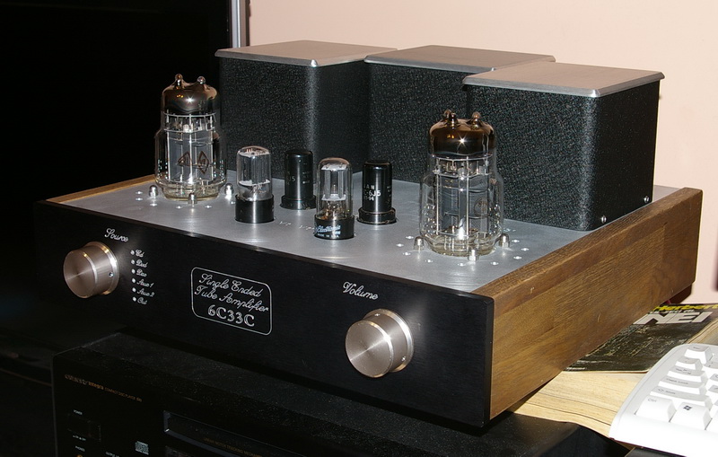

Hi Jose
My amp runing all day long I love it.
I have in mind to start the second project in the same design, maybe a PP with 6C33C or a paralel SE but i am not shure witch tube to use for the project.
