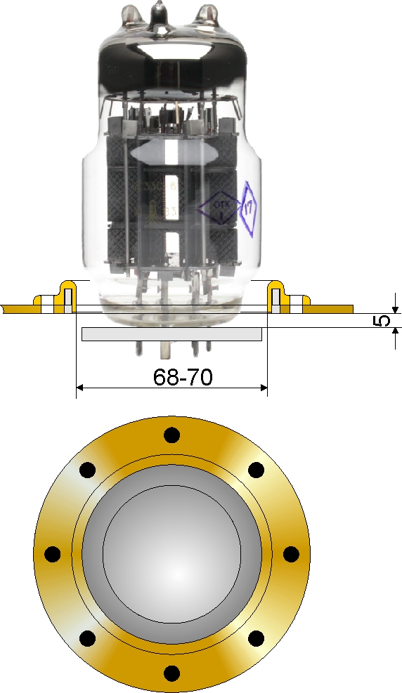

I've looked a bit in the first link you referred to and I have been tempted to change to get the chimney effect is still an easy way to solve the problem of ventilation.
My top plate is not yet water-cut so it can be changed so I have two questions.
Do you know what the diameter of the hole is and how great the distance must be between the top plate and the sub plate.
Anders

Hi Anders & others,
below is my "on paper solution", not finished yet. Maybe helps.
Further, why we don't take f.E. an PC fan, about 80x80 mm, with few hundreds rpm, mounted under tube socket - to have forced ventilation? Just slightly to move the air.
:cheers:

Hi Anders,
Klaus Barton wrote about the chimney effect, that we should drill a hole in the chassis of at least 75 mm, the hole should be 10 mm larger than the diametre of the tube. The subchassis is mounted 5 mm from the chassis. Holes are drilled in the subchassis around the tube socket to provide ventilation holes for the chimney effect. It goes without saying that the bottom plate of the amplifier should be a perforated material.
In another amp I built I used aluminium plate material with 4 or 5 mm square holes to provide ventilation.
It's true what Klaus says from a thermal point of view, 90% of the ampliers are designed incorrectly. And the 70 Degrees the tube runs cooler due to the chimney effect adds a few years to its life.

Hi Midlife,
I'm speaking about "few hundreds rpm" ... "Just slightly to move the air".
Not hard to find PC fans with less than 25 dB (at 1200 rpm, 100m³/h!) for about 12 EUR.
If your wife can hear that than... I can only say poor man, don't come home late! 😉 :rofl:

Hi Ma_Coule,
... and do you know what people jokingly say every poor soul with a midlife crisis wants?
Do you mean: "The difference between fathers and boys is the price of their toys"? 😉 😀
OK, joke apart!
BTW, what do you think about the (middle) point of my post?

Hi Ma_Coule,
The middle part of your post, the slow revving PC fan could just be what the 6C33C and the electronic components need. Most people worry about the tubes getting (too) hot, but tend to forget the other electronic components like capacitors, which do not like all that heat.
So if it gets too hot inside my new amp I will certainly consider your solution.🙂
